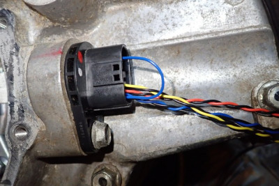

SciroccoEV wrote: Sun Mar 08, 2020 11:42 am It's a Hirose GT18WB-14DS-HU ....
Thanks, that must have been some detective work.
I can see me replacing it with a waterproof cable gland and feeding the cable up to the inverter.

Mouse wrote: Mon Mar 09, 2020 10:59 am Thanks, that must have been some detective work.
I just read the part number off the connector under my binocular microscope! That way I could see that the '6' was in fact a 'G' and got the right result.
It may come to that! I was about to place an order with Digikey when I remembered that the terminals are not included. Up until this point it looked like the connectors would have been quite reasonably priced. The terminals weren't expensive either, about 4p each...
But the order multiple was Ten Thousand!

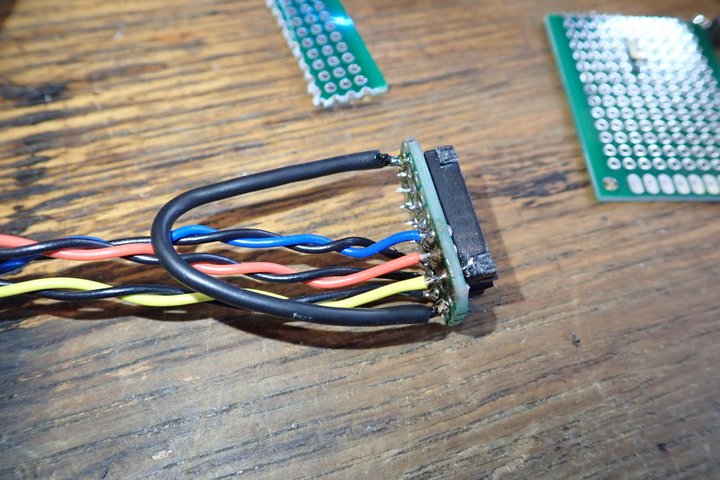

I'll add my resolver to the list,
35.7R Black, White
85.0R Green, Red
77.2R Yelow, Blue

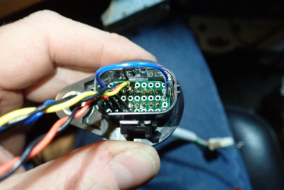

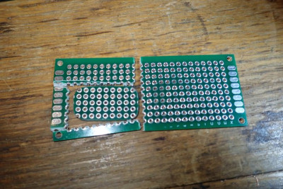

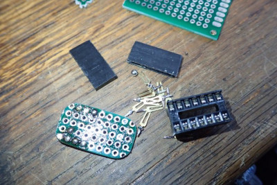

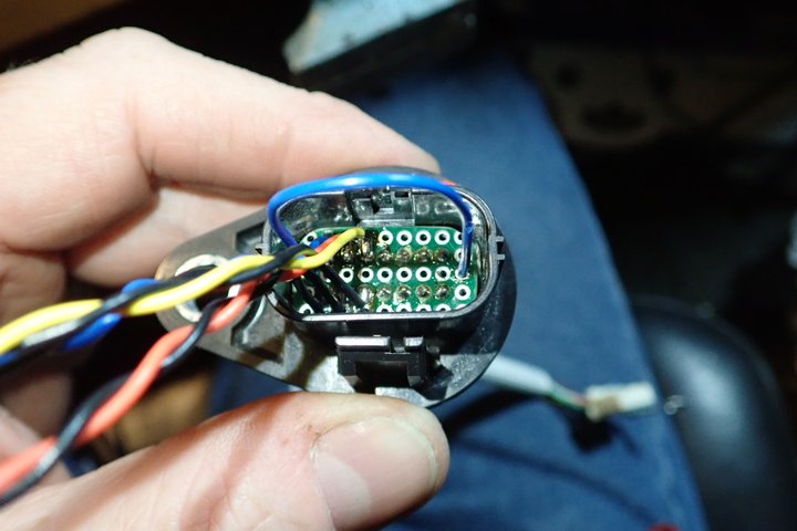

Sadly I spotted moisture damage on the resolver connector so I'll be abandoning it for some other solution.
The photo does not show up the tell-tale blue/green powder indicating corrosion of the crimp connector. This might explain why the motor was for sale on ebay without a gearbox attached.
Although I didn't spot that until after I bodged up a connector for testing and is not intended for any serious use.
I noticed the connector pitch was 2.54mm x 5.02mm which matches the holes in prototyping board and plenty of PCB connectors.
the pins are flat plate rather than a square pin so rather fragile when bodging anything to them.
An IC socket grips the pins whereas the other connector of the sort you have around the edge of an Arduino did not because the pins are flat plate rather than a square section pin.
I'll reinforce this is not a long term or serious solution and just for testing.
I thought I'd share this as no one has found a replacement connector yet.

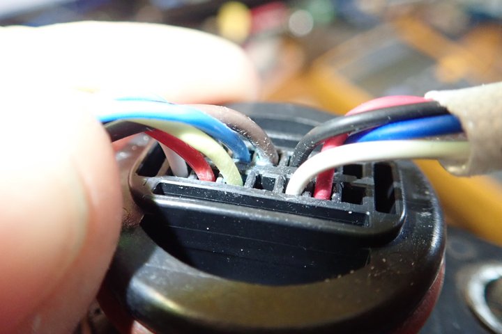

Has anyone found a source for those connectors so far? I just got quoted 150 quid for one by a breakers.
If not I'll try and look into it. Maybe get a bulk order for all those who follow.
Mouse
Posts: 138
Location: Wales
Been thanked: 7 times
Re: Mitsubishi Outlander rear axle
Post by Mouse »
LRBen wrote: Wed Jul 08, 2020 12:37 pm Has anyone found a source for those connectors so far? I just got quoted 150 quid for one by a breakers.
Have you tried the samples form I linked to a couple of posts above? (You might have to register an account)
Most companies are quite generous with handing out samples in 1s and 2s and I've been able to repair odd equipment using them including a smd 50way breakout connector for the Toyota inverter board, however not tried it with this company.
Personally I'm not going down that route as the connector on my motor is water damaged and I'm going to replace it with a gland and cable into the motor as I cant justify replacing both and keeping it standard for the sake of it.

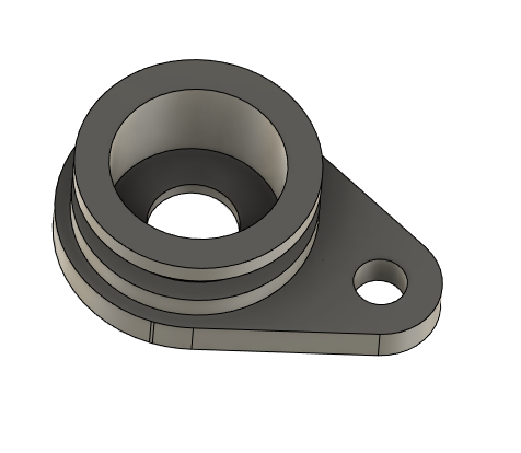

I went down the Liycy cable route in the end. Designed new cover to replace the original connector that will fit an m12 cable gland. Uses the original O ring to seal.
I'll test fit this on the weekend and update this post.
Edit: It fits really well!
STL file is here if anyone wants to try it first. https://www.thingiverse.com/thing:4557232

I Also hookup up my Outlander rear motor and Gen2 inverter on FOC, but struggling to get the resolverd wired correctly.
today the motor gives a shock one time and then inverter starts to make sound with drawing a lot of current from battery. I used the resolver pinout from Arber333.
How to determine the + and - so to say (or the right phasing) about the resolver?
for example did you tight green and yellow together on pin 2 or red and blue together on pin 2?
I'll take a look tomorrow when I am there and get back to you on that. I can't remember off the top of my head.
I found that on throttle my motor is a bit more unsteady, it will also sometimes not move and draw a bit of current. But I am not sure how much of that is to do with the PWM wires on the control board being wired wrong at the moment.
