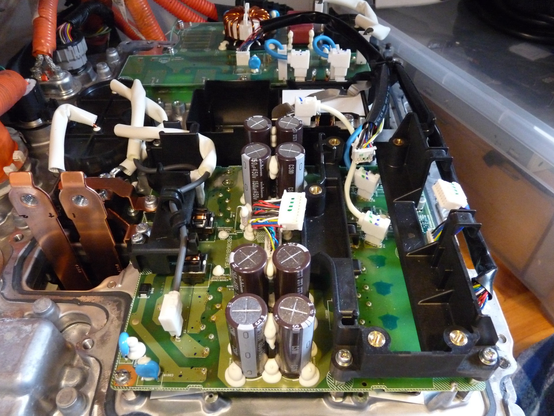

Just to clarify for all the newbies out there:
The problem with all power supplies taking in AC is that when you rectify 1-phase AC into a capacitor, there's zero current when the instantaneous AC voltage is below the capacitor voltage, and a lot of current when the instantaneous AC voltage is at the capacitor voltage. In the ideal situation (and which would be perfect power factor) you always want your device to take in current like a resistive load would, i.e. if you take 10A at 100V, then when voltage is 50V you take 5A.
Notably 3 phase AC largely doesn't have this problem because the voltage between the highest and lowest phase doesn't fluctuate that much, and certainly never goes to 0V. Using the prius inverter in the 3 phase input configuration isn't too bad for the grid other than possibly some switching noise entering the grid. Maybe someone with some experience can figure out what kind of filtering it should ideally have.
Commercial high power devices don't just have a rectifier, but they also have a boost circuit that synchronizes with the AC waveform and boosts the appropriate current into the capacitor when the instantaneous AC voltage is below the capacitor voltage. You can often see this stage quite clearly, as at initial glance it looks like it should be just a rectifier, but then you notice there are large inductors and transistors alongside a control chip in there before the voltage is fed to the actual switch mode converter.
EDIT: I've attached a photo of the Nissan Leaf 1 phase AC charger. AC comes in via the small copper bars to the left edge of the PCB, then there's a suspiciously long row of through hole transistors + 2 diodes mounted on the heatsink below the PCB, then there's the capacitor bank. The weird wires that attach to the PCB between the input copper bars and the transistors go to the plastic-encased inductors at the top left. That's the boost converter at the input.
To the right of the capacitors below the PCB that you can't really see are the actual transistors of the charger's flyback converter. The output of the transistors leaves the PCB via wires to a transformer and from there to another PCB to be rectified again.

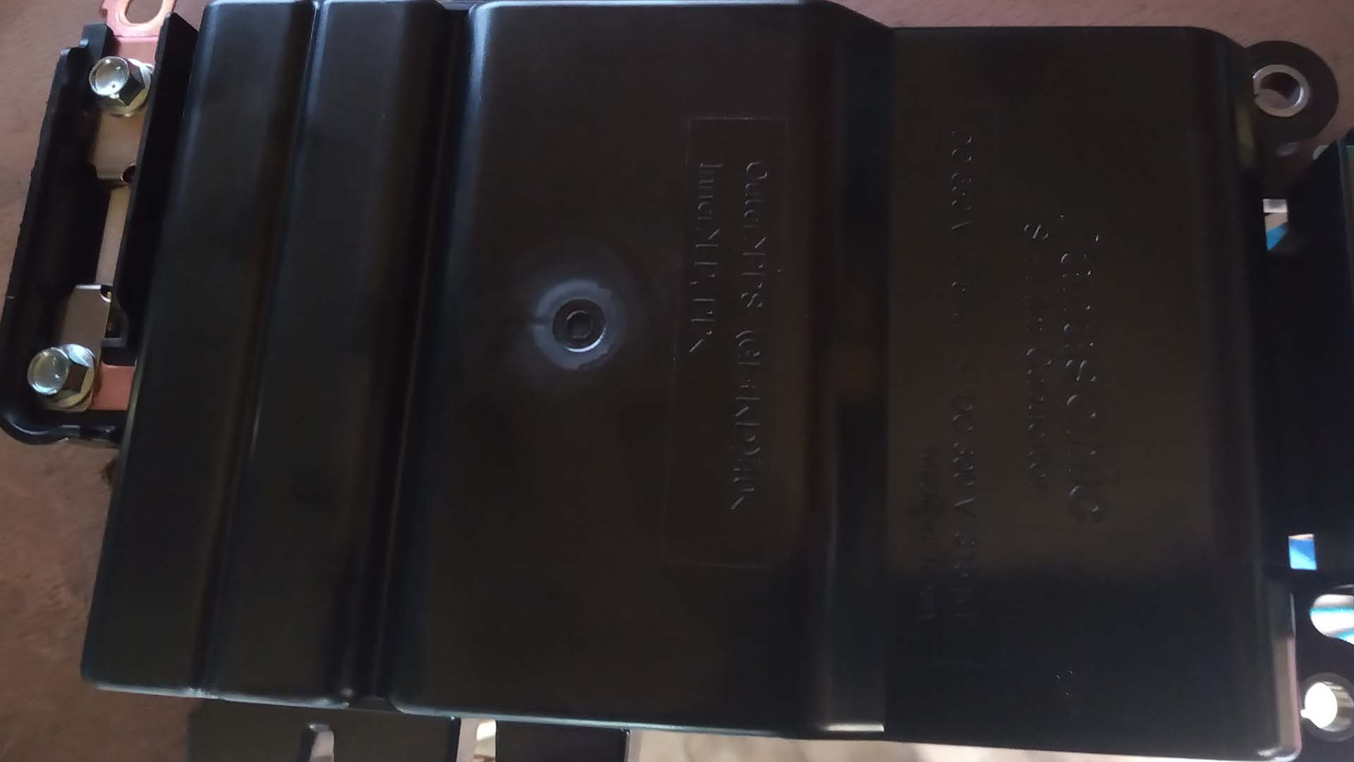

A (potential) warning to anyone who wants to use this a Yaris inverter (as stated in Celeron's GitHub) the dc capacitors are rated at 300v (low) and 650v (high) (as stamped on the capacitor casing - attached).
This does also beg the question that if the high side capacitor is 650v then it makes it highly unlikely that the inverter ever runs at 650v.

Good info thanks. The 650v thing is an internet myth that will probably never die. Along with the 100A "current limit" ....

I spotted that when I took mine apart. Making me a bit nervous about using mg* to boost to 400V...rstevens81 wrote: ↑Mon Jun 29, 2020 12:20 pm A (potential) warning to anyone who wants to use this a Yaris inverter (as stated in Celeron's GitHub) the dc capacitors are rated at 300v (low) and 650v (high) (as stamped on the capacitor casing - attached).

If you read any of Toyota's gen3 or newer publications, they do always say "650V maximum".
The IGBT driver board enforces that voltage limit. If you set the boost converter at a low PWM and just wait, it'll stop when the MG rail reaches about 650V. At high PWM it will overshoot and then you're watching it drain down from some semi scary voltage from 650V up to over 1000V.
Telling it's 650V could be a marketing strategy, or something lazily taken from their safety documents. I think it probably goes to 650V, but only when you absolutely floor the throttle, and their control system is accurate enough for operating right at the limit for brief periods of time.

It works fine as a charger. The MG side is still rated for continuous 650V, even in the Yaris one. You need a lower voltage battery for it of course. And if you feel you'd rather have more margin for error, that's fine, one can always use something else. But that doesn't mean it doesn't work.
I just did a 35 minute 18kW 3 phase charging session earlier today using the Prius gen3 inverter at 10kHz. Yes, it's still in one piece.

Very good!celeron55 wrote: ↑Mon Jun 29, 2020 8:08 pm It works fine as a charger. The MG side is still rated for continuous 650V, even in the Yaris one. You need a lower voltage battery for it of course. And if you feel you'd rather have more margin for error, that's fine, one can always use something else. But that doesn't mean it doesn't work.
I have tested Yaris control hardware up to 400Vdc on the battery side and up to 610Vdc at MG side. This is as far as firmware will feedback.
I had the cap off at the time true! While i could have it on i decide to leave off just because i had better access. I think i saved myself some magic smoke.
