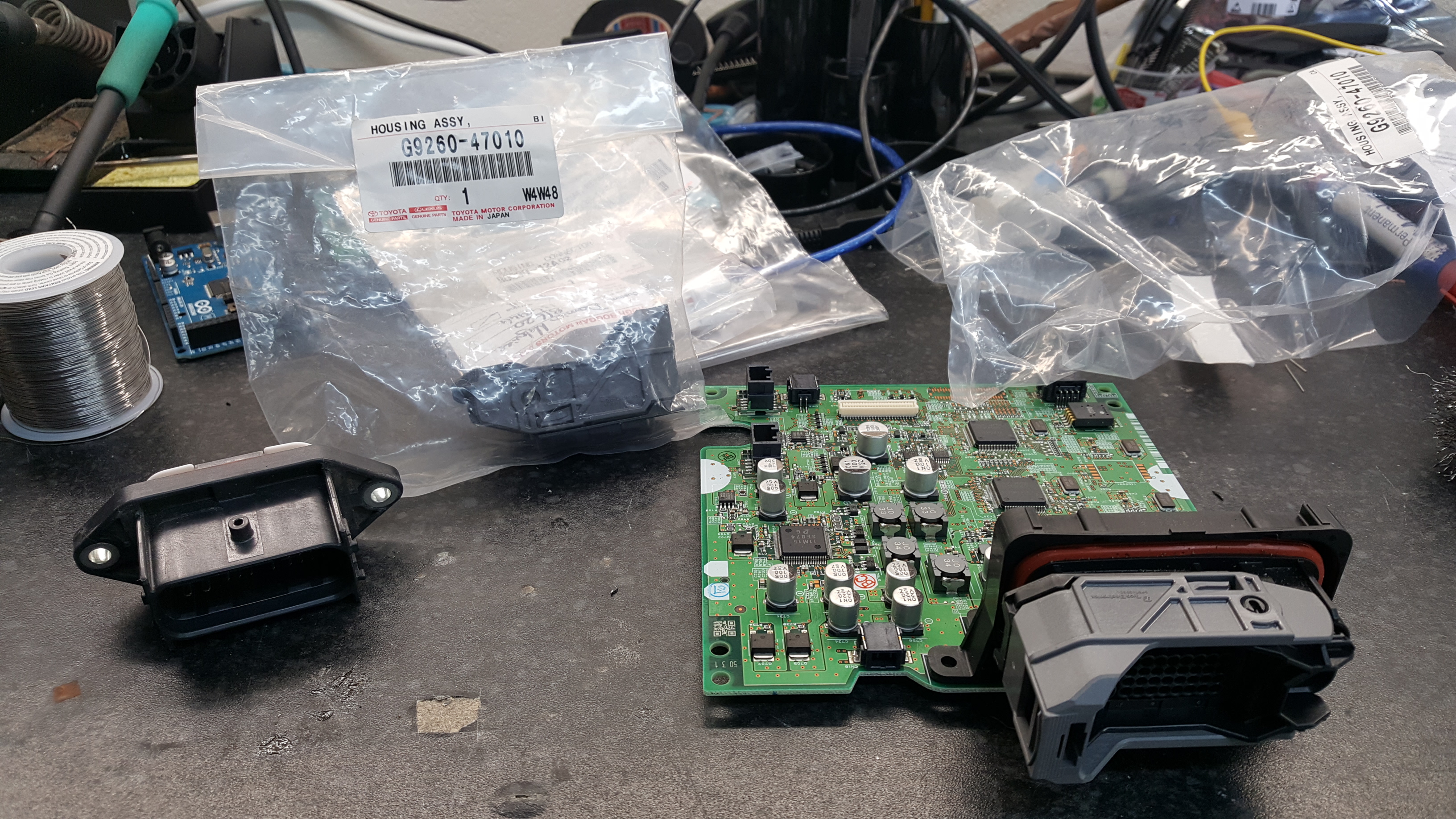

Success! Called my local Toyota parts guy just now.PN: G9260-47010 is indeed the connector housing for the inverter. 12.40 Euros each. Ordered from Japan so will take about a week to get here.

Are you sure the connector housing in the photo(pretty sure it's PN G9260-47010) fits the Lexus GS450H inverter receptacle? :https://i.ebayimg.com/images/g/jA0AAOSw ... -l1600.jpgJack Bauer wrote: ↑Fri Jun 05, 2020 8:21 am Success! Called my local Toyota parts guy just now.PN: G9260-47010 is indeed the connector housing for the inverter. 12.40 Euros each. Ordered from Japan so will take about a week to get here.
The outside housing indexing slots are in different positions and the small pin count may be different?
Do you have some photos of the connector that goes into the inverter? Also, could you look over the connector with some magnification for 10 digit part numbers (there might be several). The PNs are only 1-2mm high and may start with G92.Robbertjanzen wrote: ↑Fri Jun 05, 2020 2:10 pmDamn! i just paid 50 for a scrap versionJack Bauer wrote: ↑Fri Jun 05, 2020 8:21 am Success! Called my local Toyota parts guy just now.PN: G9260-47010 is indeed the connector housing for the inverter. 12.40 Euros each. Ordered from Japan so will take about a week to get here.![]()

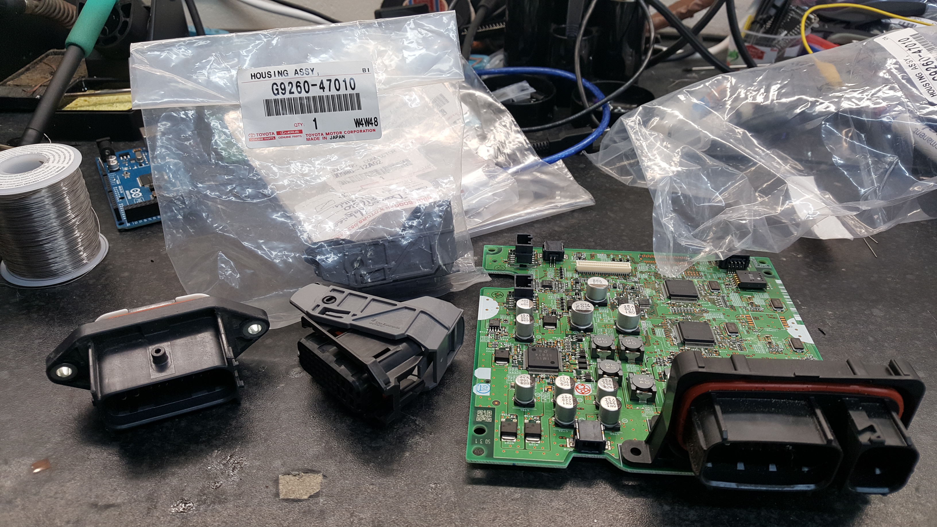

Well, collected my bits from the toyota dealer this morning. Bad news. Plug does not fit the gs450h inverter. Good news : its fits the Prius Gen 3
That's what I was afraid of. Again, if someone with a GS450H wiring harness could hunt for the tiny PN(s) on the plug, it might be available like the Gen 3 one Damian just received. Also, sometimes in the service/ part manuals drawings and PNs of the different plug types are listed. I found PNs and successfully ordered plugs for a Gen 4 inverter in service information that Damian posted in the Gen 4 thread some time ago.
Also, the PN for the smaller resolver/temperature plug that mates next to the plug Damian just received is G9266-47010.

Don't forget, the Camry inverters have this second connector for the resolvers and a perhaps a smaller data connector, while the GS inverters have it all-in-one.
So I guess that means we may need to find the part numbers for two connectors!
