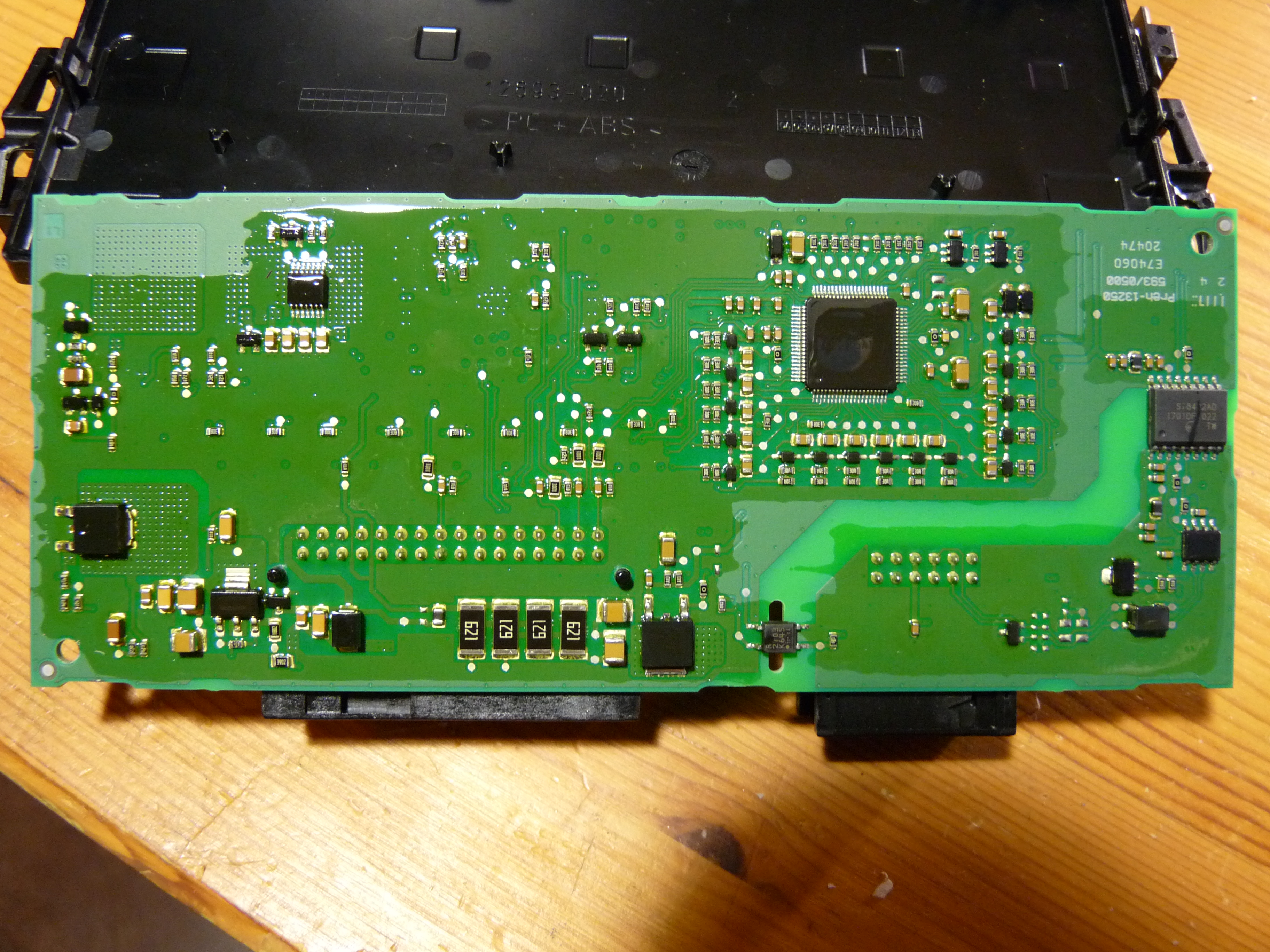

Better photos of the CSC juicy parts

I was hoping to power up this BMS slave without the battery module itself, but I guess it's not practical as the isolated module side is designed for 40-70V input and might not power up with anything lower. Not so easy to figure out where to inject 5V or something, and whether it will tolerate that. I'll get back to this once I move this laptop stuff over to the garage.
celeron55
Posts: 804
Has thanked: 38 times
Been thanked: 136 times
Post by celeron55 »
tom91 wrote: Wed Jun 03, 2020 8:02 pm Do you have a canbus sniffer hooked up and is it sending you any data? I need to determine ID of the module and the status.
you need to look for ID 1x0 x is the ID.
Well I decided to go for it anyway, and destroyed some VDD filtering choke in the process of soldering through the coating. A jumper wire will be a fine replacement I suppose.
On the module side, I'm only feeding 5V to the power rail that connects to the Si8422 dual channel isolator and that seems to power the MCU, as it transmits things. Nothing is connected to the module connector.

You can see those in my photo here:
viewtopic.php?p=11935#p11935
download/file.php?id=3719&mode=view
The cell connector on the BMS slave PCB is labeled "AMP 1-968720-2"
The bus connector on the BMS slave PCB is labeled "1-962750-2" "BMW 1383 737" "AMP 1-963541-2"
