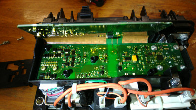

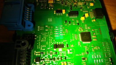

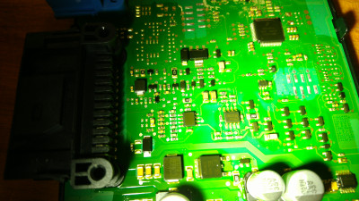

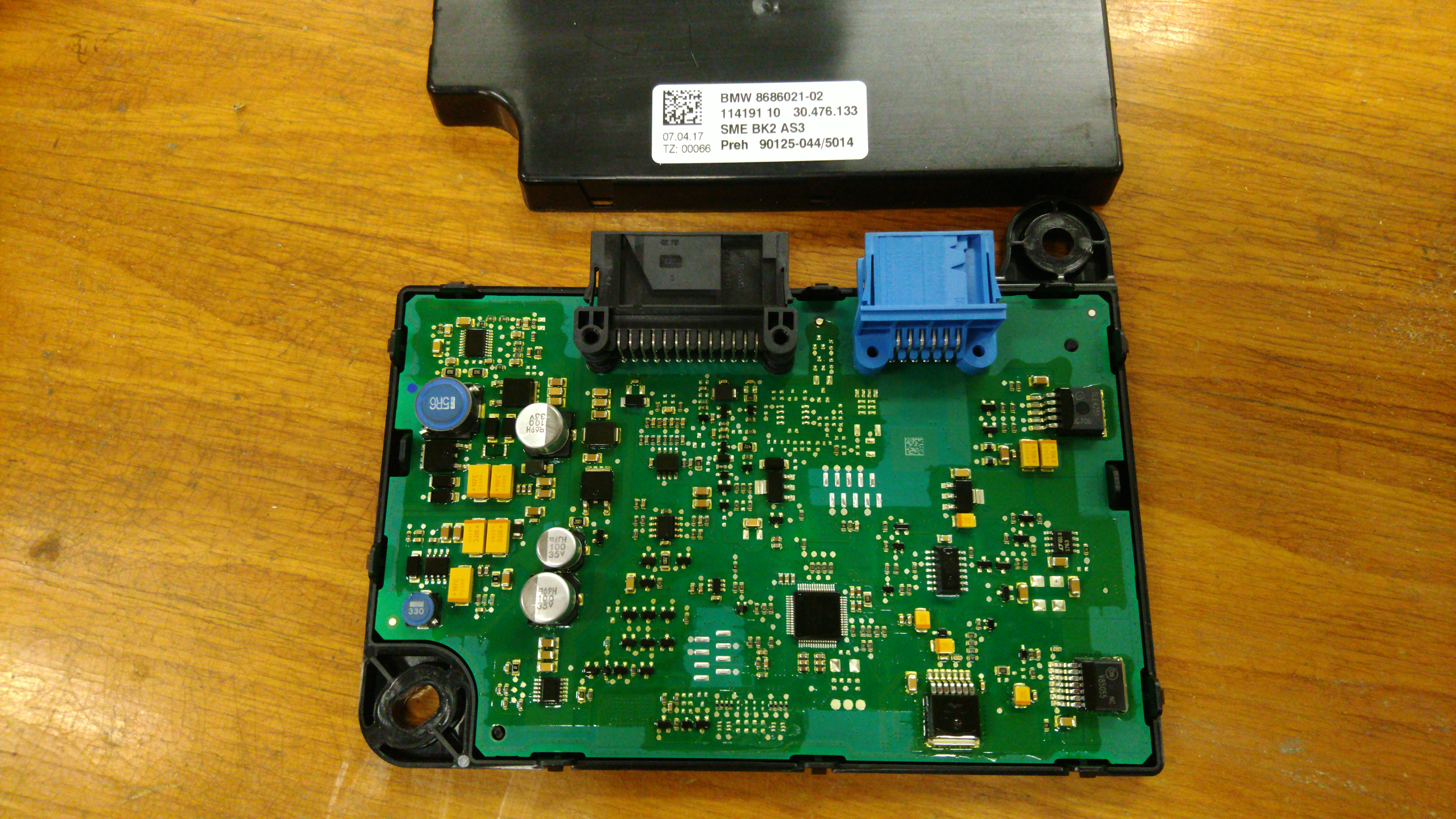

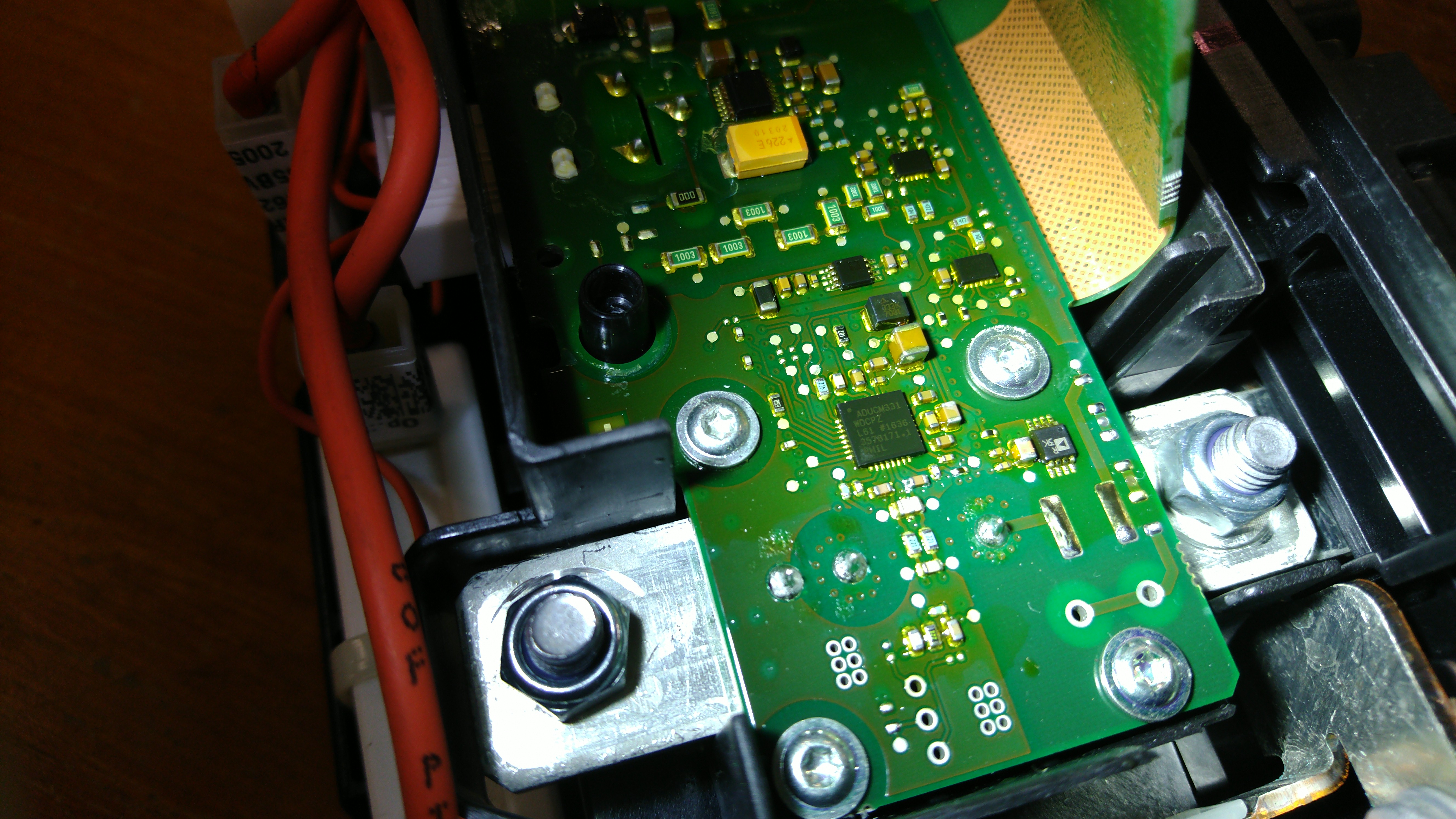

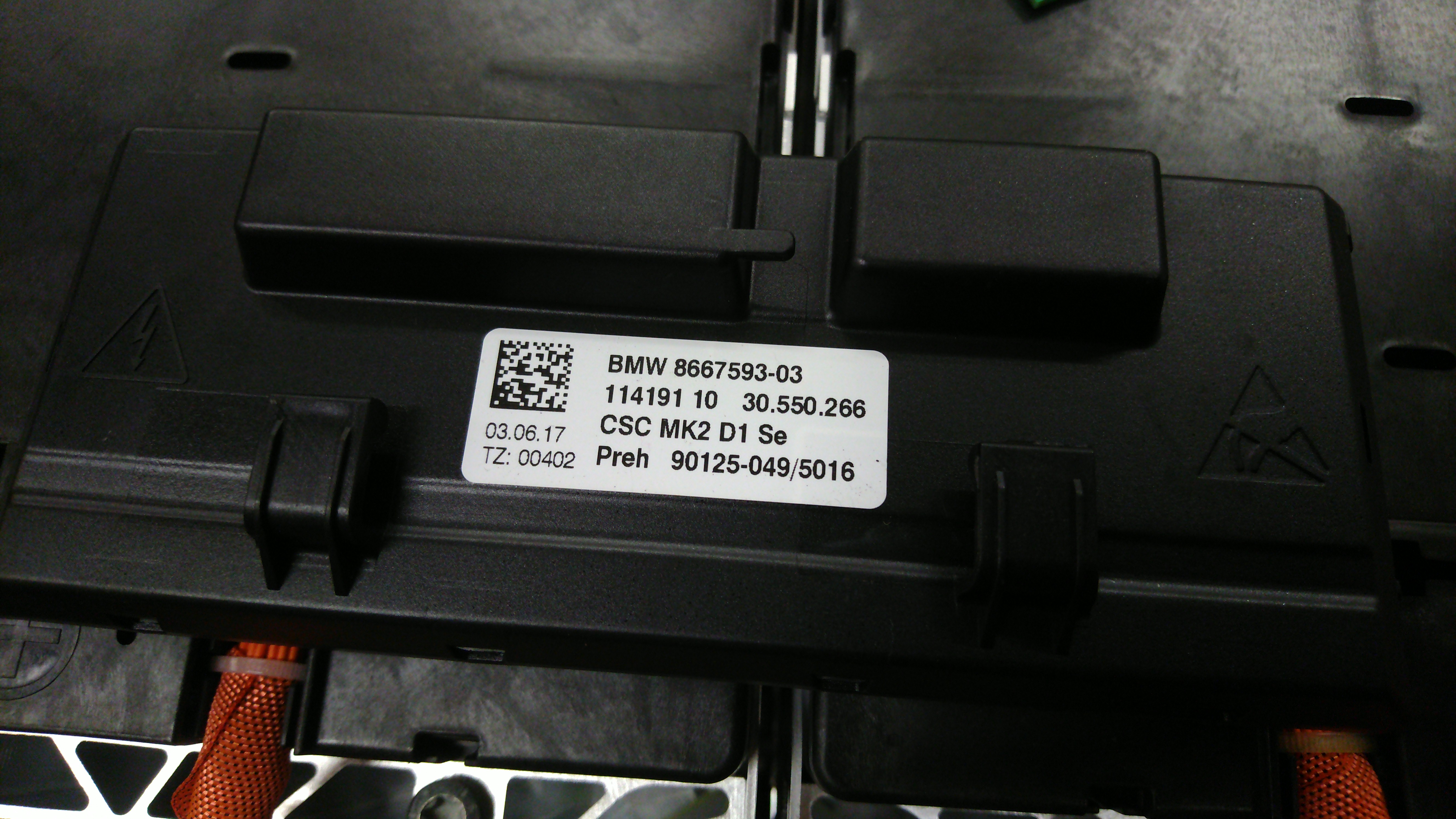

I took some photos of the BMS inside an x5 battery, which is the same stuff in yet another shape. If someone is interested about the markings on some of the chips, I have a larger set of photos where I tried to capture most of them (not easy because of goo) so just ask.
Also here's a video where I open the pack:

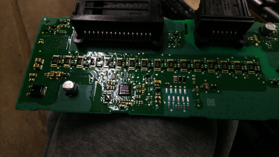

Post by celeron55 »

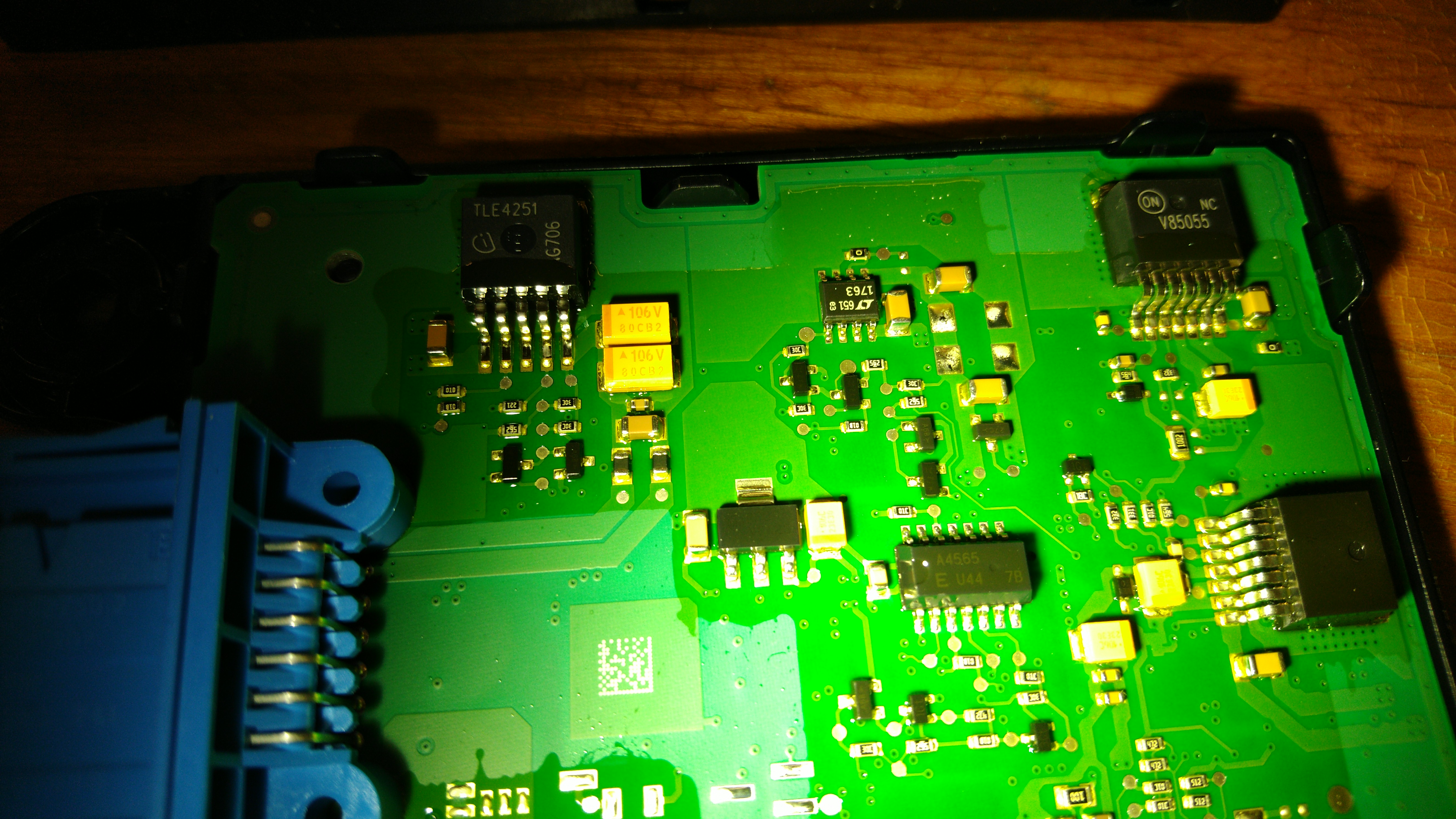

BMS module chips. Looks like it's using a TI BQ76PL455A-Q1 and is that Infineon an MCU?

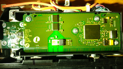

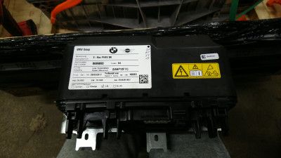

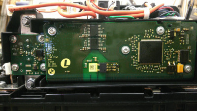

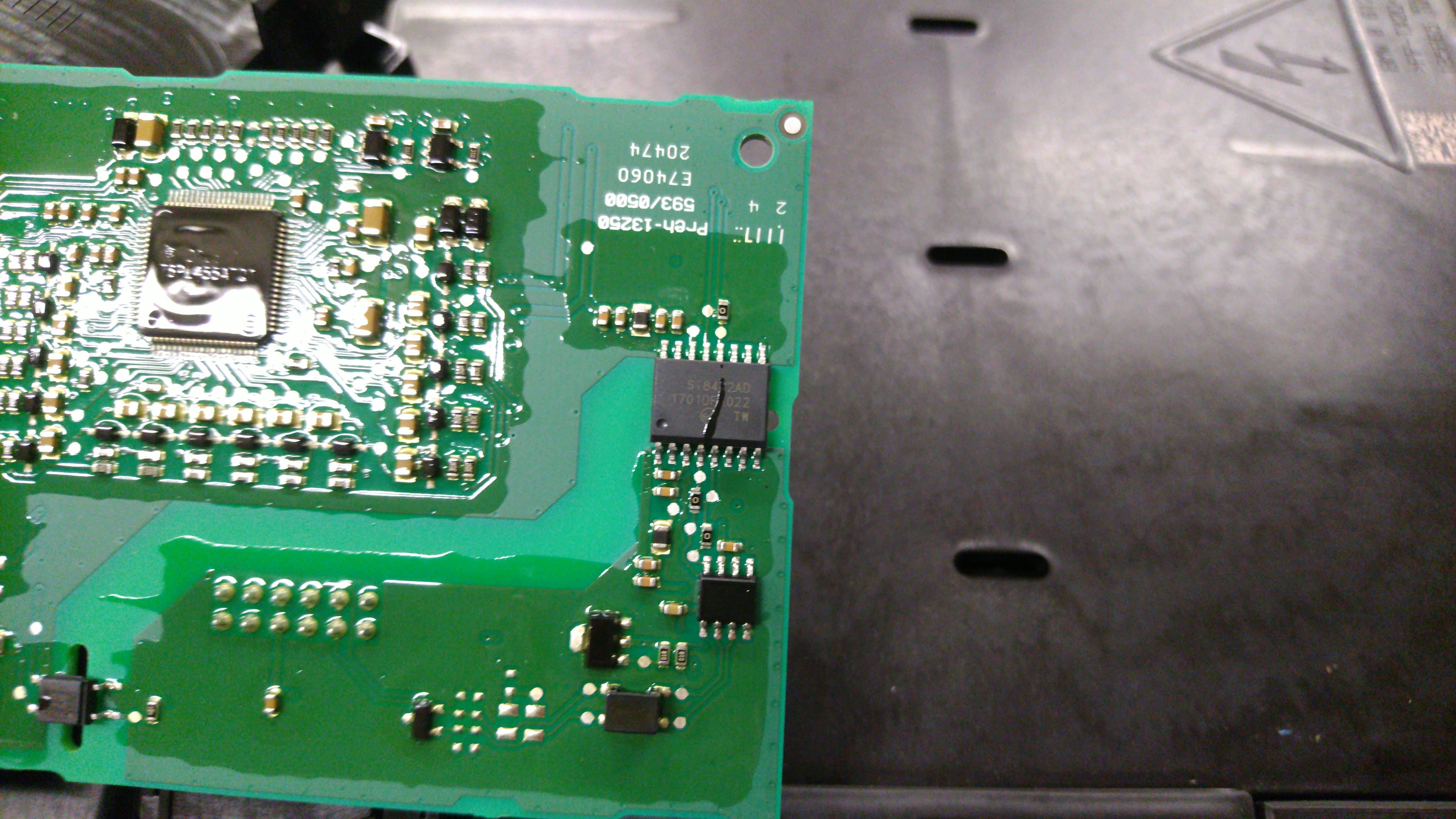

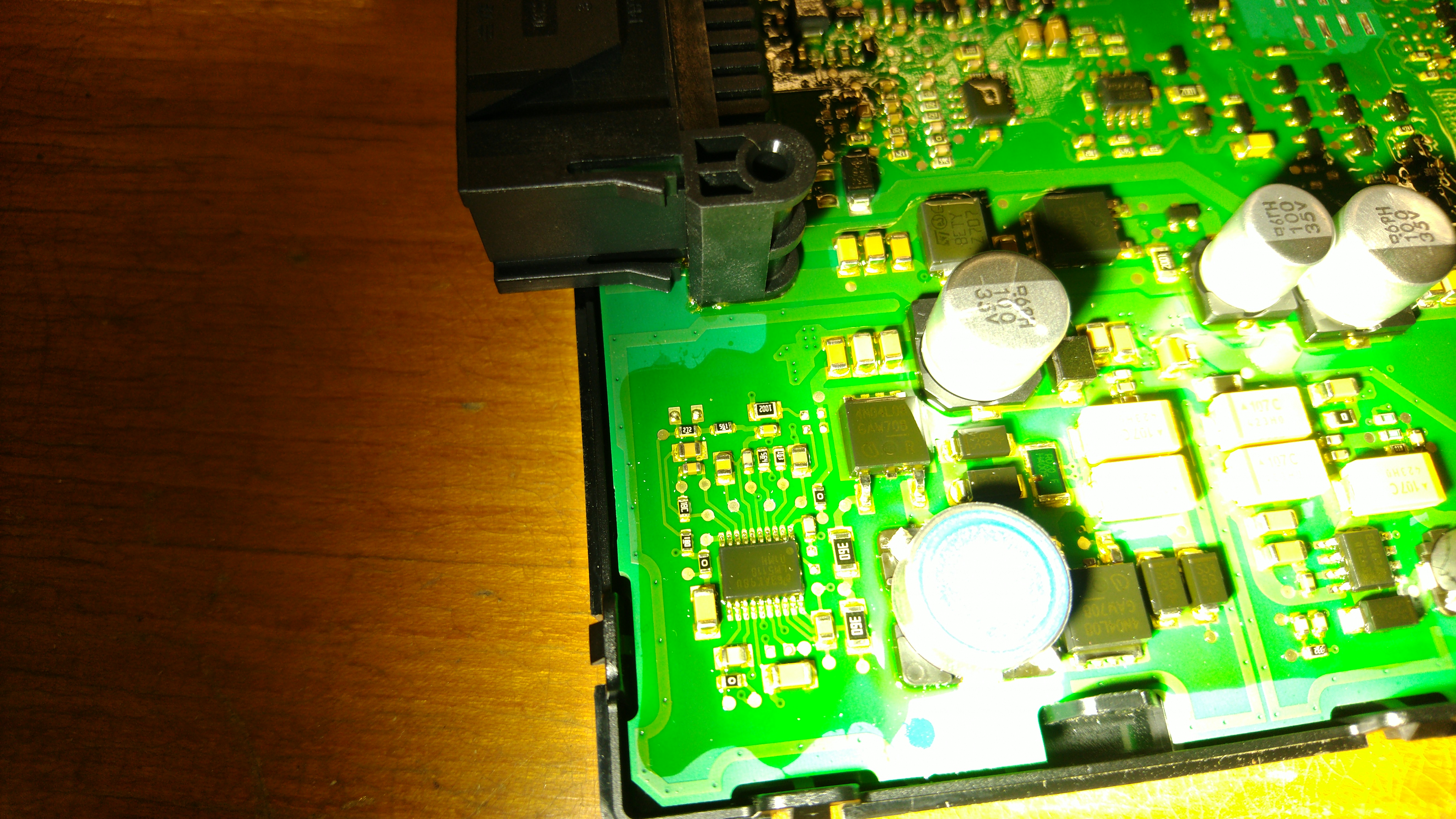

Post by celeron55 »

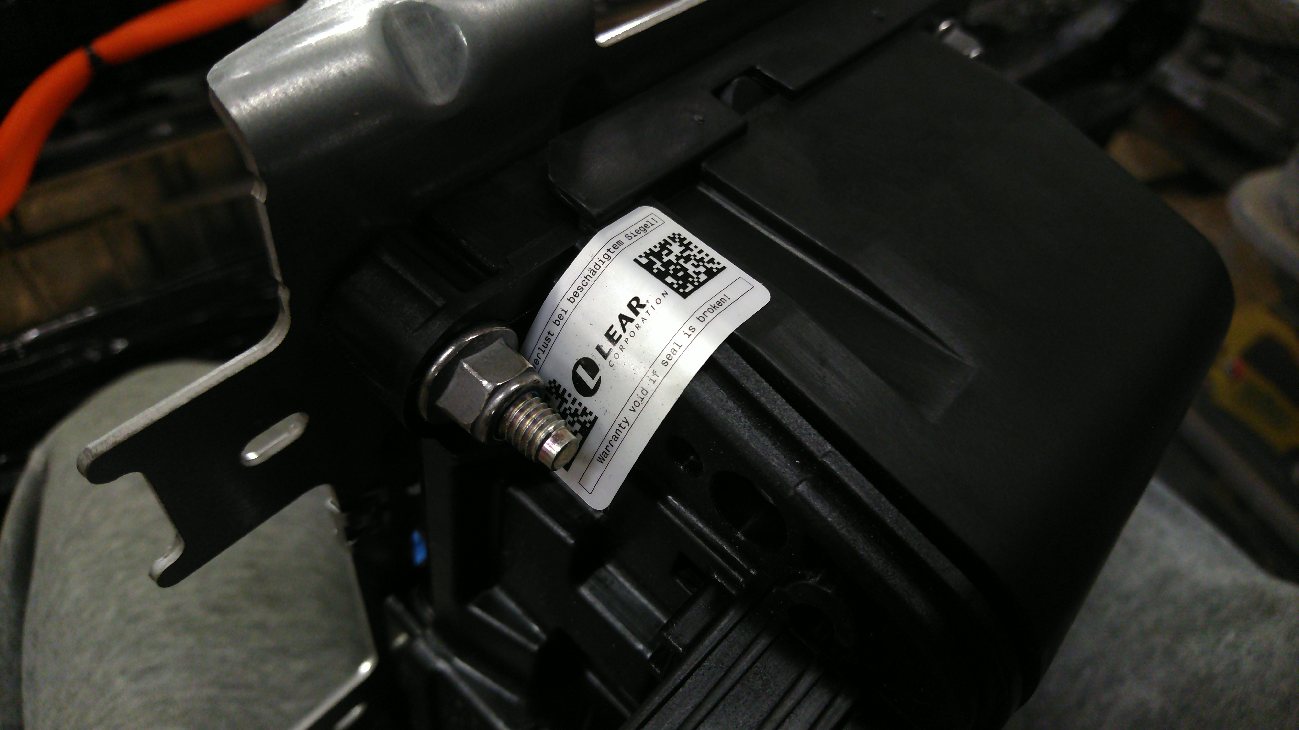

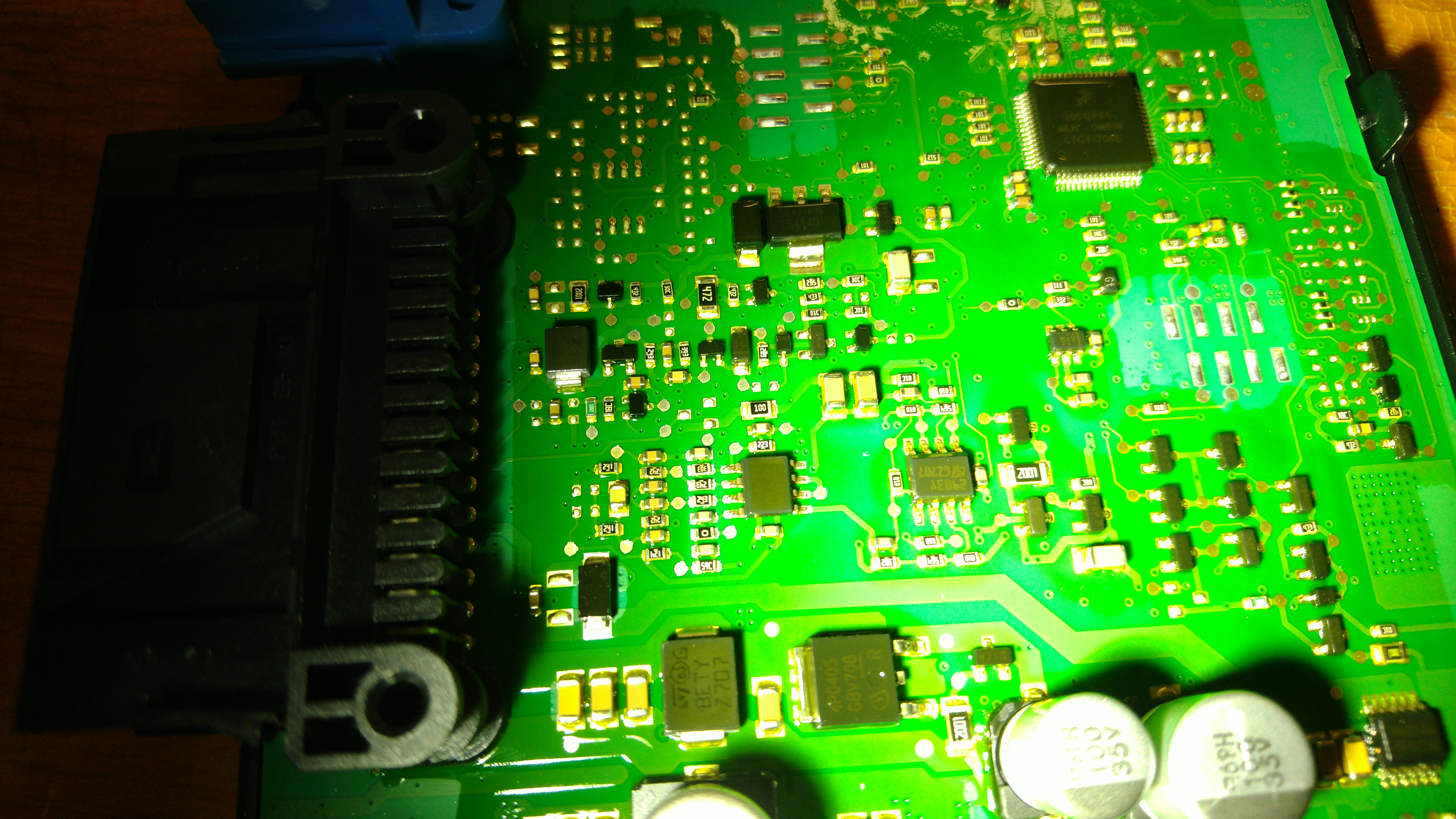

The contactor box has an ST SPC56EL60L5 MCU and an ADUCM331 as a current shunt amplifier. Some Si8441BB for isolation.
And there's a LEAR warranty sticker on it.

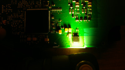

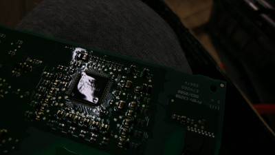

Post by celeron55 »

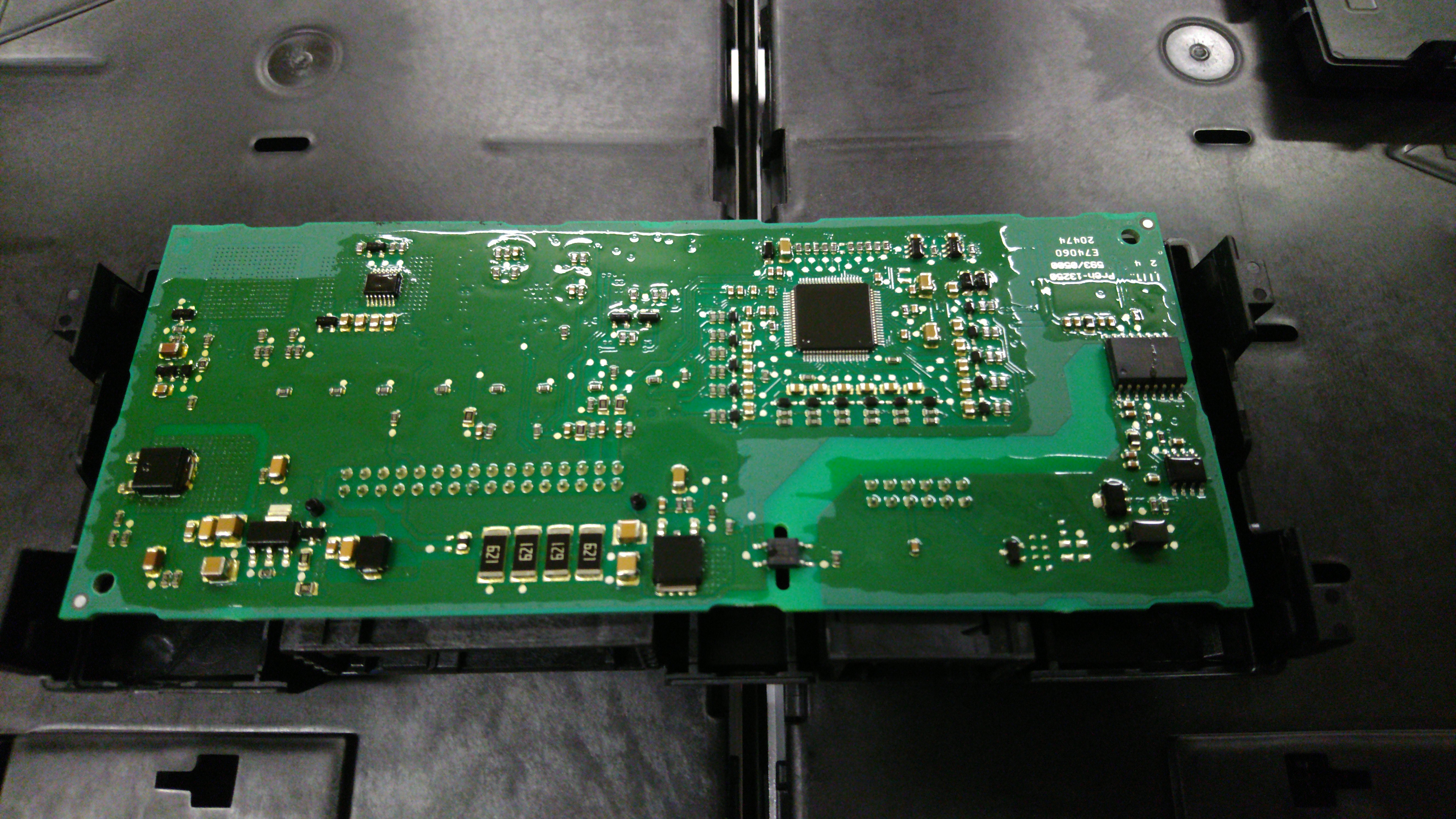

The BMS master has lots of goop and a ridiculously large Freescale chip underneath ("SC667333MLU1 OM14X XAA1708F"), and a Freescale HCS12 MCU on top with various little ICs.
Nothing says overengineered like a 176 pin mystery IC on a BMS master board!
EDIT: Oops, forgot the mystery IC photo
EDIT: Maybe it's an MCP5634M or similar

Do the CSC modules communicate via CAN or do they connect the BQ76PL455A chips together with the COMM/FAULT lines and then the BMS does the CAN interface? The wiring diag doesn't really give any clues.
Posts: 3661
Has thanked: 10 times
Been thanked: 334 times
The slave boards communicate with the master via can at 500kbps. Thats the captures I just posted on github.
