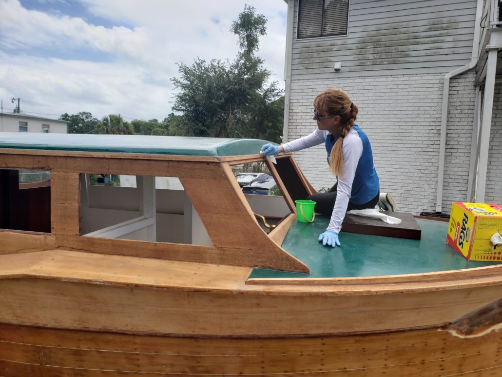

Here my wife is preparing for a coat of CPES ( clear epoxy sealer)

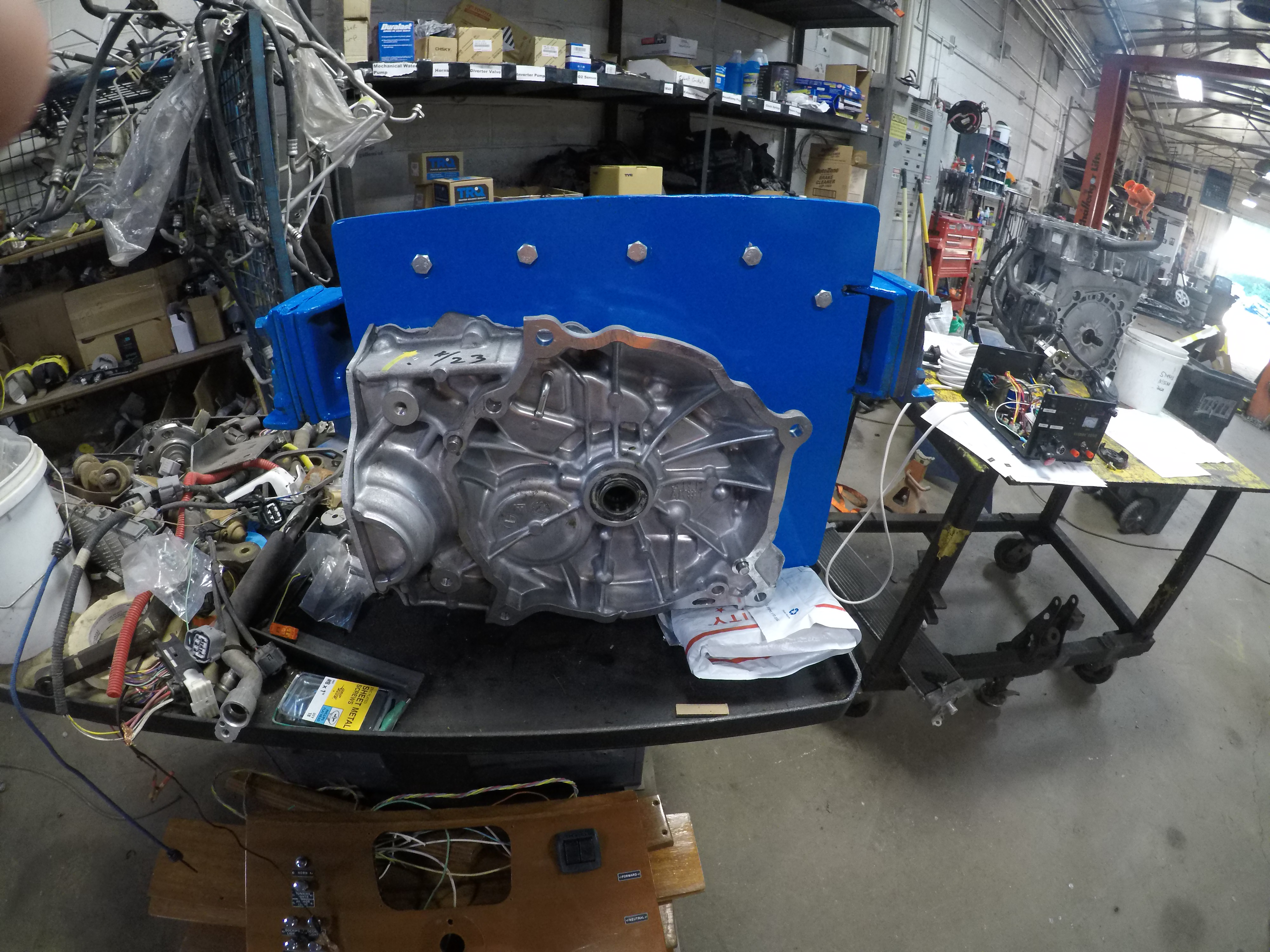

the donor vehicle, and the openinverter board in the nissan inverter

and a photo of the transmission adapter.
we used the original paragon transmission case for a thrust bearing and fabricated the plate to bolt it to the leaf motor.
we expect to fill it with oil
using a toyota prius battery pack and seeking assistance with throttle runaway.
that noise is the prop shaft rubbing the stuffing box, I fixed it when I mounted the motor more securely.

this should have been posted before now... but here are details on the transmission adapter
