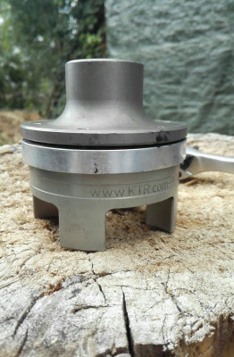

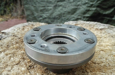

Today I had to rip gearbox and motor apart. I started out by investigating the increasing hum that now even started at 3000rpm. Stuck my gopro in the starter motor hole and a lamp in clutch hole and started filming. Wobble alarm
So turned out the screws holding Leaf spline and distance ring as well as distance ring and clutch had come out quite a bit! Added some Loctite, put it all back together, and - silencio

Nicely caught in time...

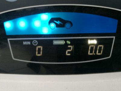

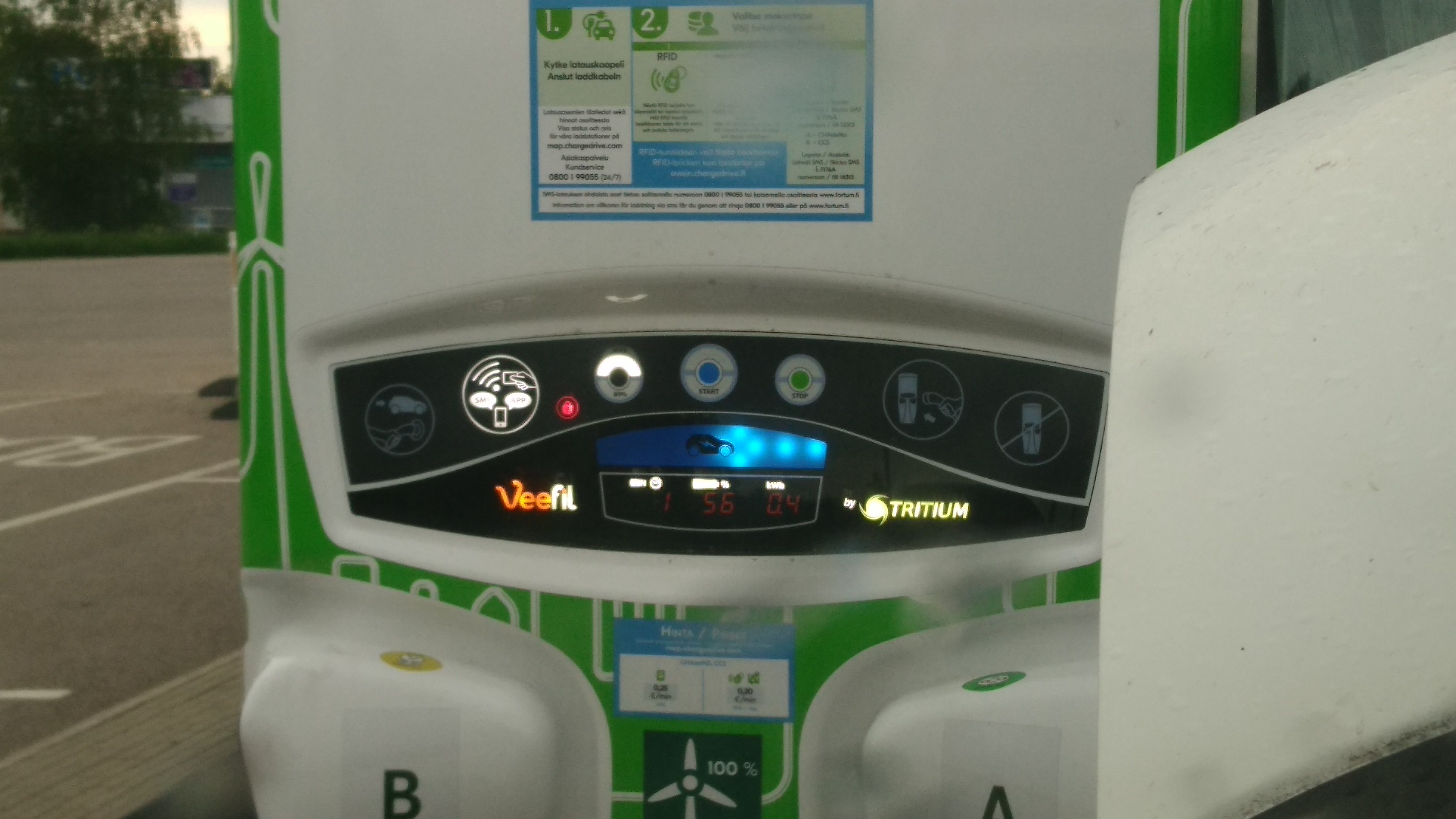

Did you charge at any Veefil chargers? Those slim, round, plastic looking ones. I've attached the best photo I could find from my collection, but just search the name on the 'net for a better one.
I've never been able to make one of those reliably charge for me. I've tried tens if not hundreds of times and maybe succeeded randomly once and I have no idea why. The charger's non-existent error messages and barely existing user interface doesn't help.
I'd like to know if this has been a problem for your DIY CHAdeMO system.

I can get an ABB to work no problem. It's an easy charger. 8)
I have ny controller's logs which don't include raw CANbus messages.
However every time i look at them I just get depressed. There are no clues there, and it logs every value there is in the protocol. If I recall correctly, when charging is supposed to start, the charger instead stops with no fault status.
I've been suspecting interference from the HV side to be the problem, but working around that is easier said than done.
Anyway, please go test one of those chargers yourself when you can. I think it's an Australian manufacturer so those could be anywhere. We have lots of them in Finland.

Would you be interested to test/canbus log the veefil/tritium charger with my leaf? Does it help?
- celeron55
- Posts: 805
- Has thanked: 39 times
- Been thanked: 136 times
I'm pretty sure the Veefil chargers work very reliably with Leafs so a canbus capture would be interesting. Capturing some of the 0V/12V signals would be useful also.
The chademo signal harness has to be cut open to capture the signals or a man-in-the-middle extension to the signal connector could be used. The chademo signal harness goes through a 10 pin connector (or something like that) some 20-40cm away to the left or right from the charging port if I recall correctly.

Yes they work fine, only one time in Norway it didn't work because the emergency stop was pressed by someone, called customer service and asked if there is any issues and they told all is good and I can pull it back on. Worked fine. They do often have some audible coil whine etc. sound.
