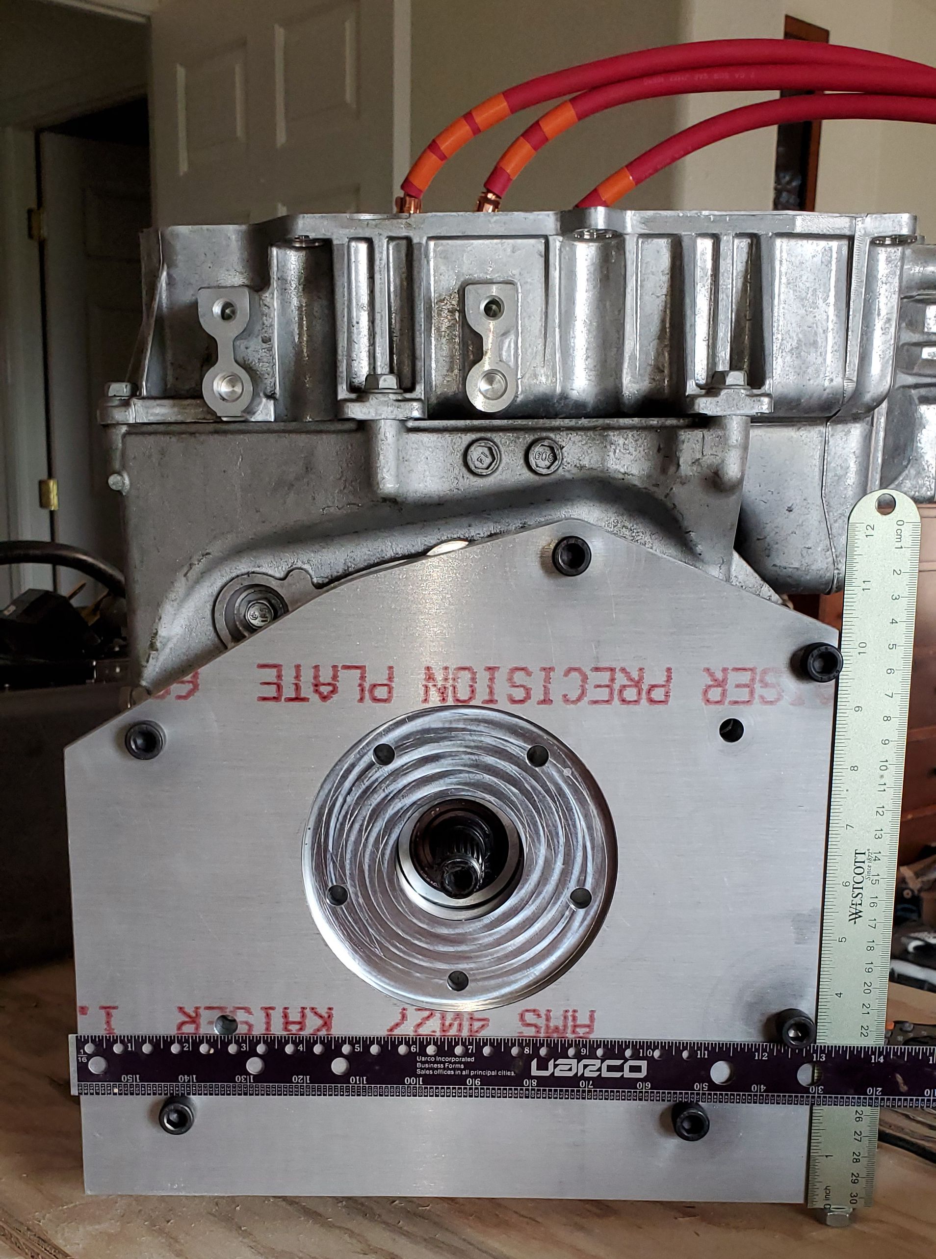

Have been slowed down on this project over the past year but I have made some progress and have some new things to report.
After the ICE removal, next was designing connecting the motor to the rear end.
First step: Adapter Plate. I started with Jeff Black's adapter plate and redesigned it to eliminate the transmission, mount to the motor and connect to the drive shaft. Working with Horizon Machining in Berthoud, CO this changed a little and I am working with them to get an updated drawing.
Suffice to say we decided to add a second bearing next to the motor so the drive shaft cant add aide forces against the motors shaft.

Next we made changes to the Adapter plate to have a ring connector (yellow above) that hold both bearings:

Re: '70 MGB Roadster - 2015 Leaf EM57 powered
Test fit of the Adapter Plate on the Leaf Motor
And next the complete adapter on the Motor, ready to put in the MGB to start the motor mount install.
