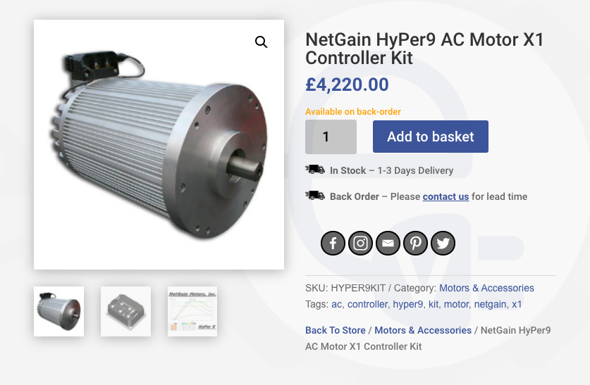

Edit: Here's a good example of the problem faced by 'old school' motor manufacturers

OEM's sell motors as spare parts. Damien had a quote for the GS450H CVT used in BEXUS (here) for 1500 USD shipped direct from Lexus in Japan within 10 days. Obviously that's much more expensive than recycled parts from crashed vehicles but it's an option if you want to guarantee spares in 10 years time.
One other thing to consider is that our warehouse is full of motors and controllers from small manufacturers who went out of business or stopped developing products in the last 10 years. AZD, CODA, and the HPEVS oil cooled motors are just a few examples.

- Kevin Sharpe
- Posts: 1339
- Location: Ireland and US
- Been thanked: 10 times
Re: List of motor manufacturer
This convinces most people
