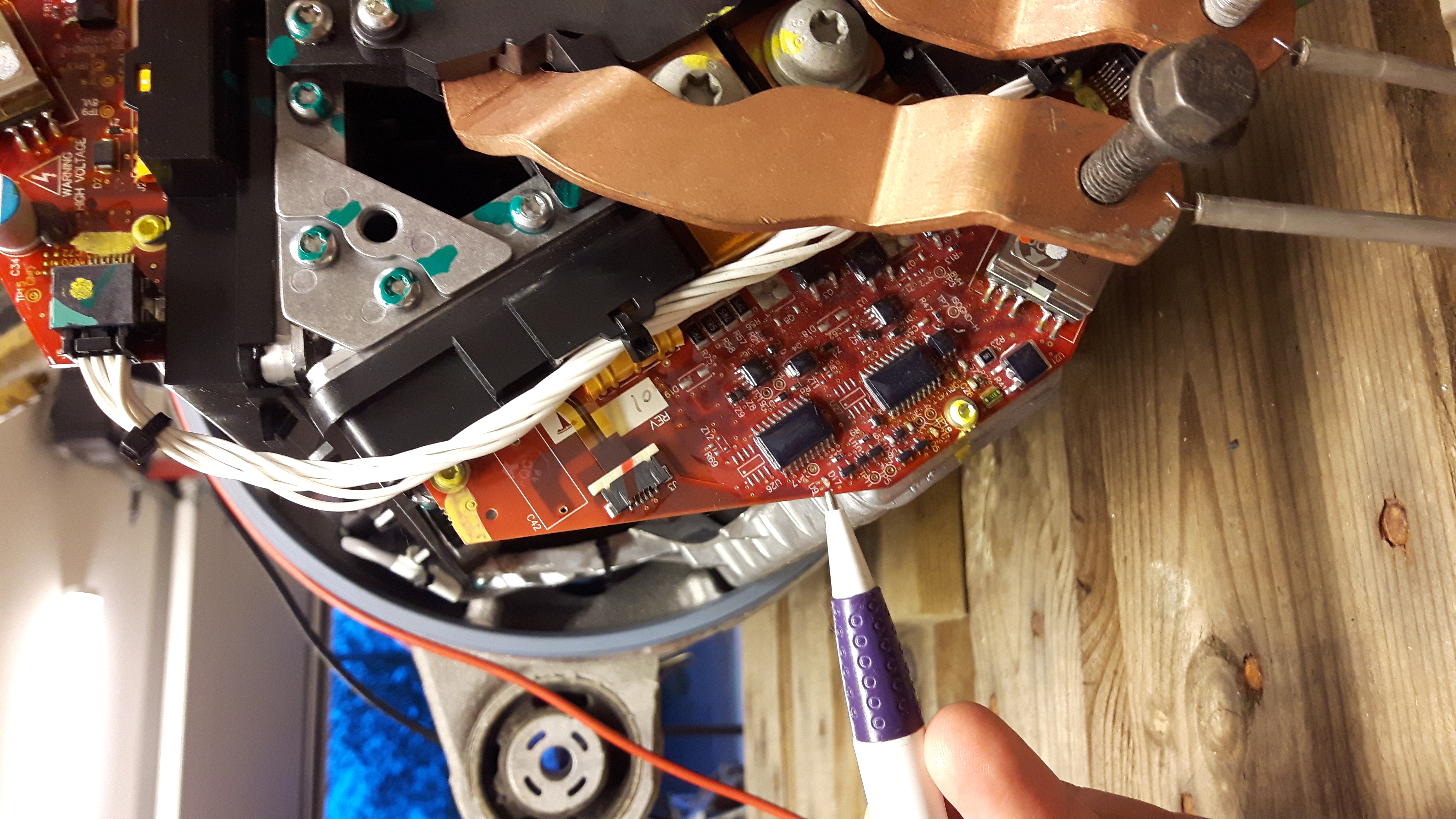

Tested 110Volt and got into a problem. At 7000rpm the DC minus cable fuse blow at 25 amp...motor made a jerk and stoped functioning (DC bus down). One led ( pen pointing at) on the inverter card on the picture lit up.
When I try to restart and set ut to forward the Lasterr flips to TMPHSMAX and Opmode go to Off...
Any idéer was is wrong...?
Posts: 4000
Been thanked: 1115 times
Sadly it looks like an inverter failure on the phase with the red led illuminated. We had another occurrence a few months ago with Jon Volk. Runs fine at low voltage but trips out as soon as the voltage is raised as you experienced. As best as we can make out it seems to be a weak or damaged igbt. I spent several weeks trying to replicate the failure on the bench without success. Where did you source the drive unit?

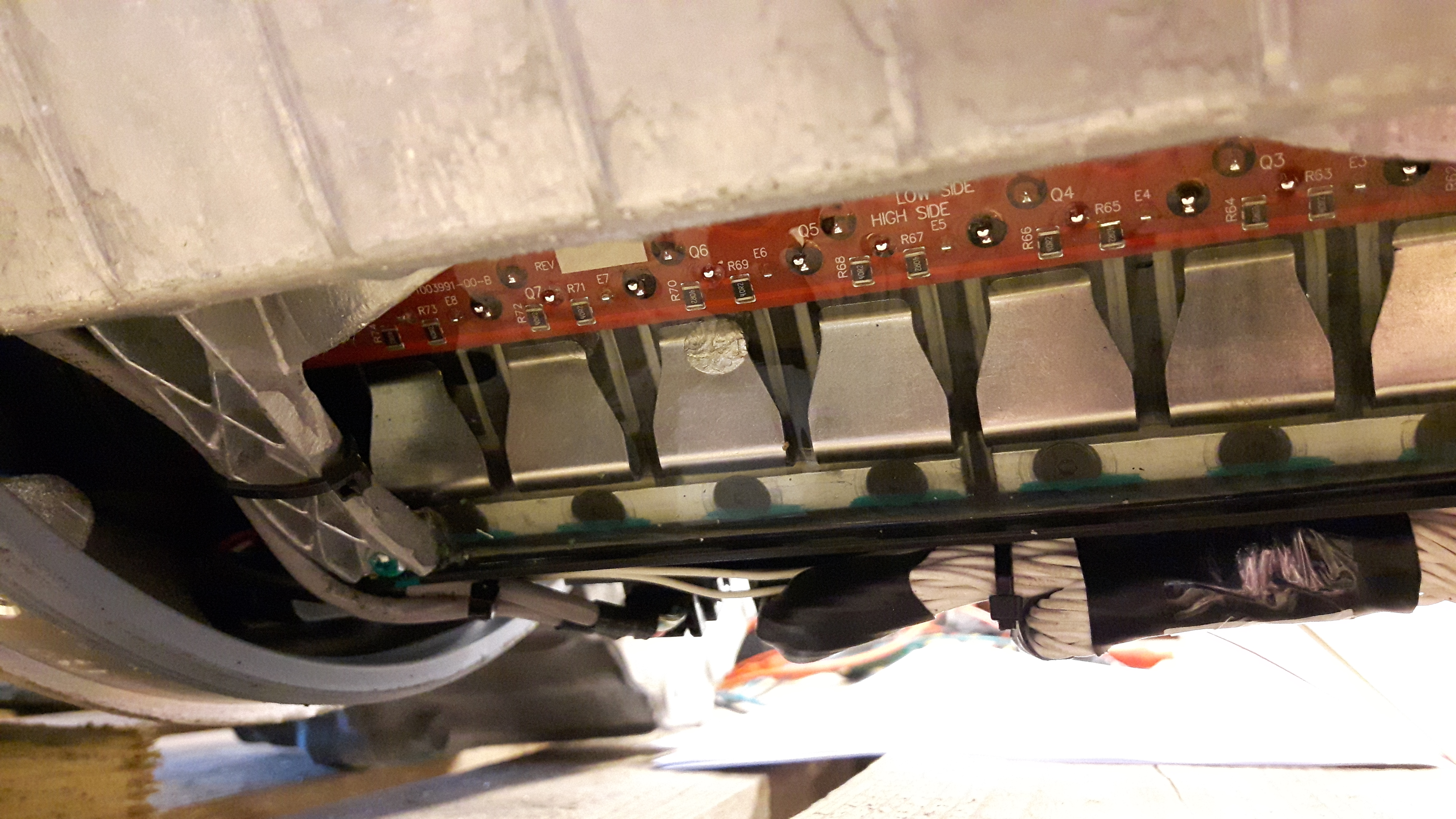

Found one suspicious igbt, see picture.
Anyone have spare igbt's or know where I can buy a new one? And any one know where I can buy the jelly...?
Posts: 4000
That's the exact same failure as Jon's. I'll see if i can find the igbt details.

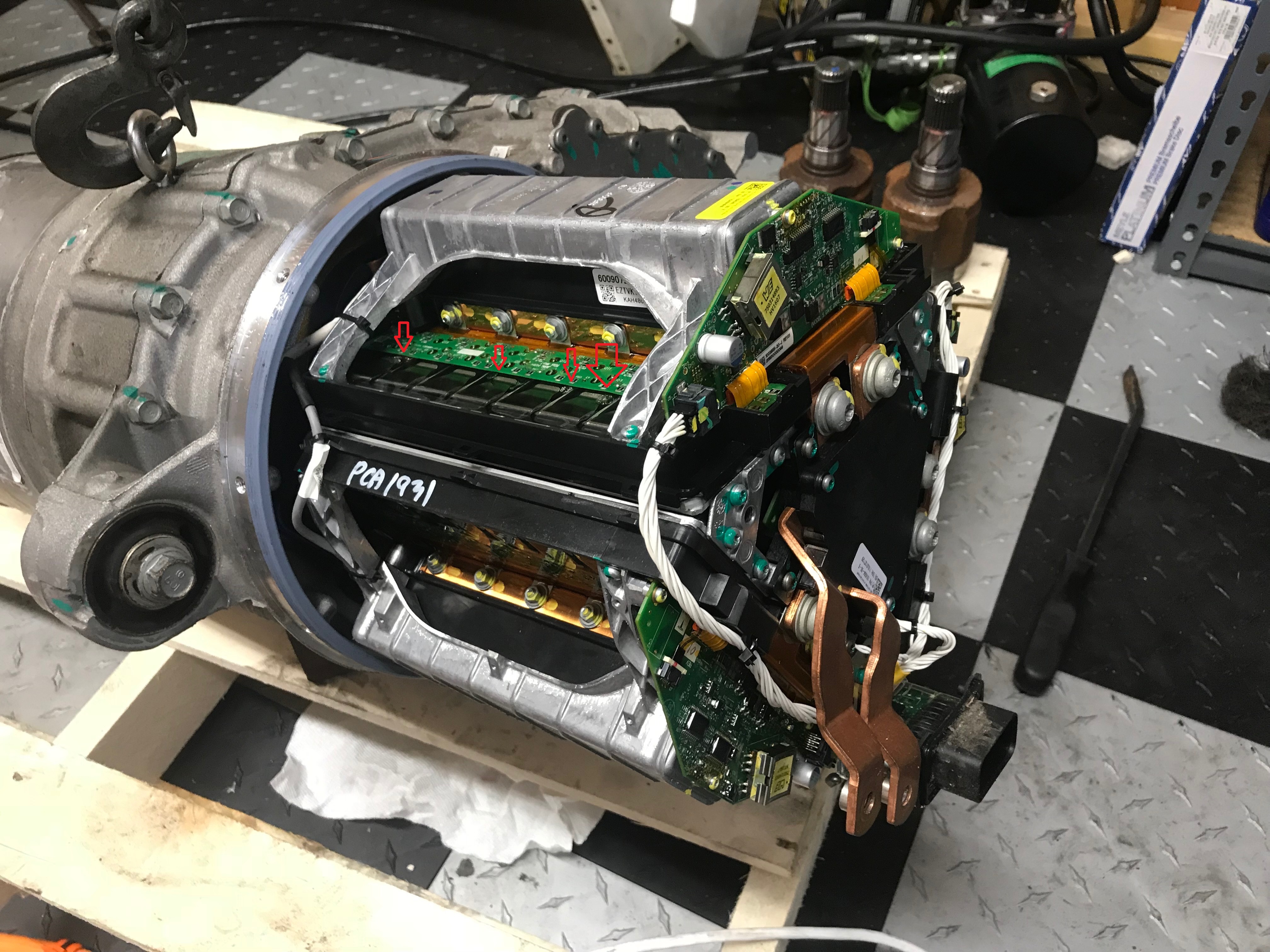

I don't know how common this is, but here is a photo from the first time I had the inverter cover off. Note that there were disturbances in the re-enterable encapsulant before I ever applied power to this unit. You'll need to click on it for better detail. I didnt pay much attention to it since it was my first inverter. I also dont know how much, if any, of this is "normal".

Interesting to see. I don't have a picture from the right angle before I tested it but the jelly has the same type of bubbles now :(

Its also worth noting that my current running motor had no such bubbles.
Posts: 4000
The fact both of the motors ran at low voltage and failed when the voltage is increased and have bubbles leads me to think the igbts may have been thermally stressed.

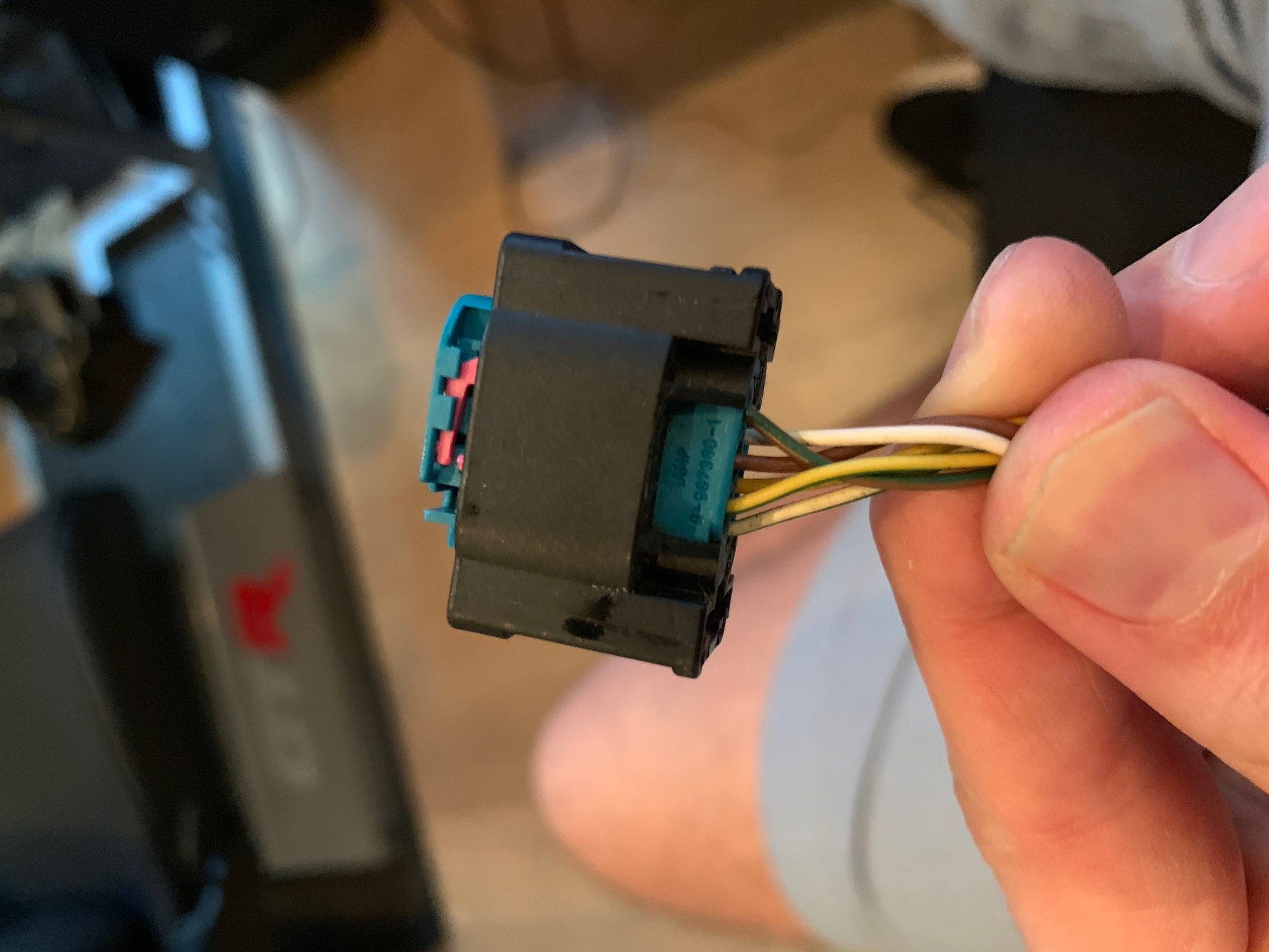

OK, lots of good progress tonight. Managed to get the harness in a good state so that I can continue testing. I also received my BMW pedal in the mail (specifically part # 3540 6762480-02). Only thing I'm struggling with now is to figure out the pin order for the connector there. It's a 6 pin connected harness and there's not much info on the web.
Damien, do you happen to know the pin order?
BlueHorizon
Posts: 25
Joined: Thu Jul 04, 2019 10:19 pm
Post by BlueHorizon »
Hold the press! I think I just figured it out..
Pin 1 = Signal
Pin 2 = Ground
Pin 3 = +5v
Let me know if that sounds right, Damien. Using the chart plotting it seems to respond and I was able to determine a min and max POT.

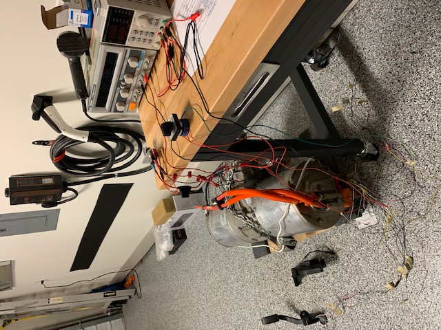

And more progress - I have the encoder wired up, a rotary switch that sets forward / reverse and I managed to get the Tesla accelerator pedal working like a charm. You can see the mess I'm making further below.
Now then - the low voltage test..
Currently don't have any batteries lined up nor do I have the various other bits yet (contactors, pre charge relays etc.) although could order these components today if needed. For the test I have a power supply that caps out at 60V (5A) and I was intending to have it provide about 50v DC for the test (to be semi-safe). Hoping that will suffice?
