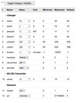

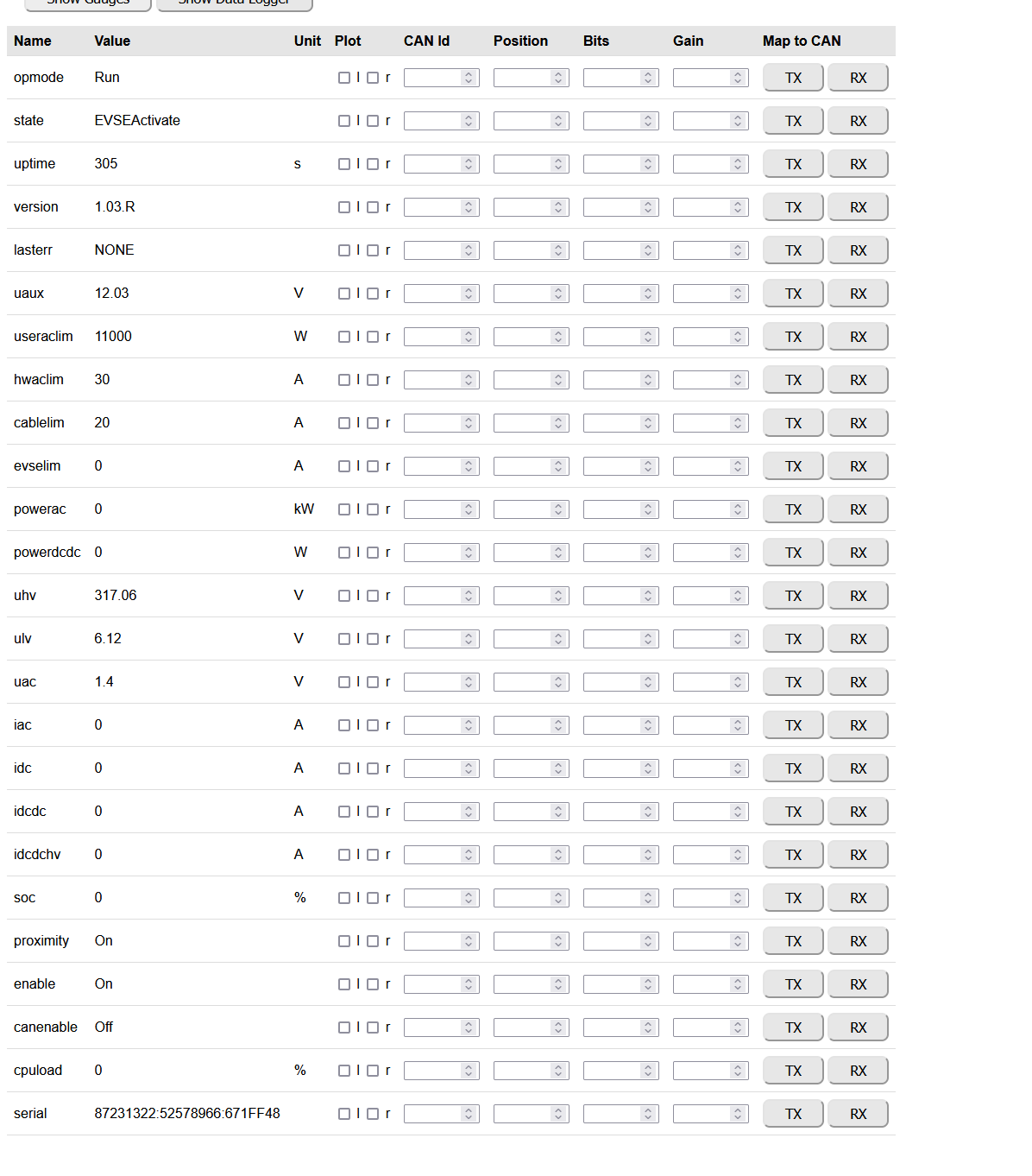

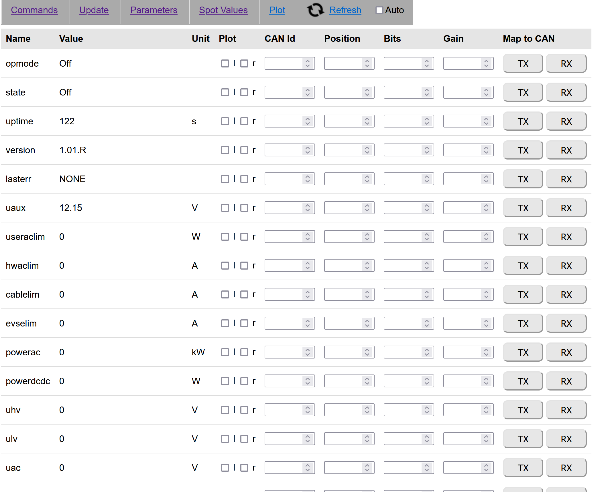

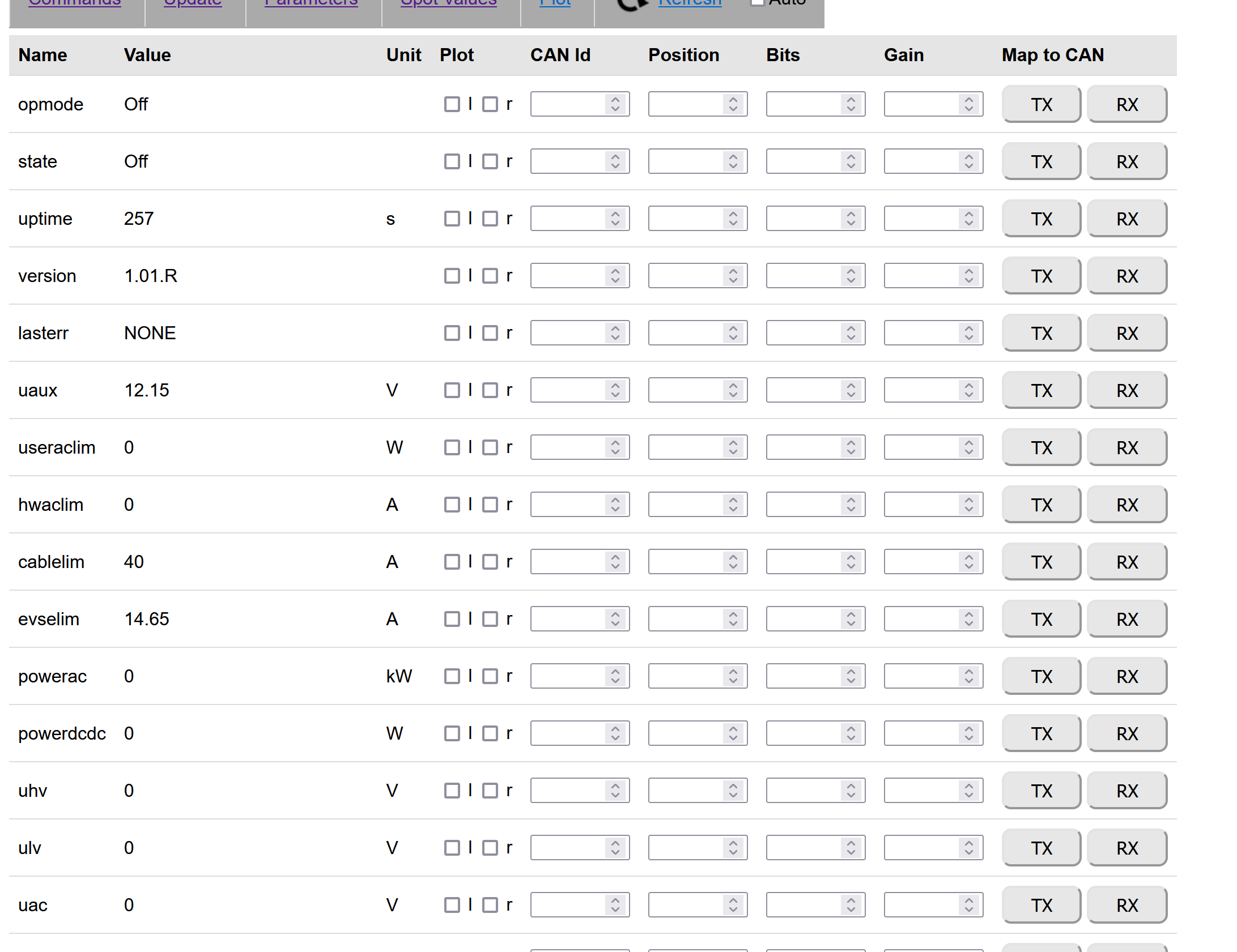

So here's what I have verified:
- HV is being supplied to the charger, after 12V and via a ZEVA precharge
- 12V is being supplied to the charger
- There are copious grounds - The charge port ground is connected to the case and the control board, the 12V ground is connected to the case, board, and plugs
The only potential install issue is the comms port to the PCS, I hate those little pins and I'm going to try rebuilding the harness today to make certain everything is connecting properly, but I'm fairly certain it is correct.

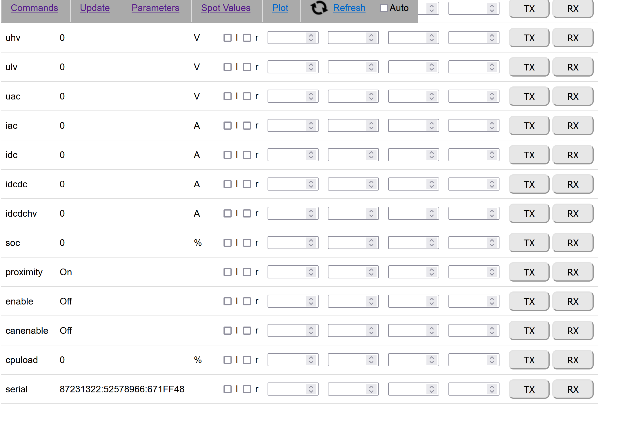

The captures attached to this post are without the charge cable plugged in.

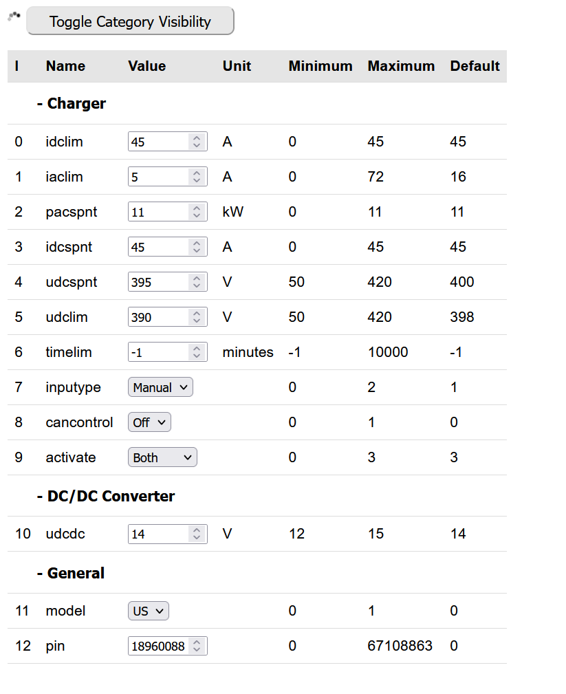

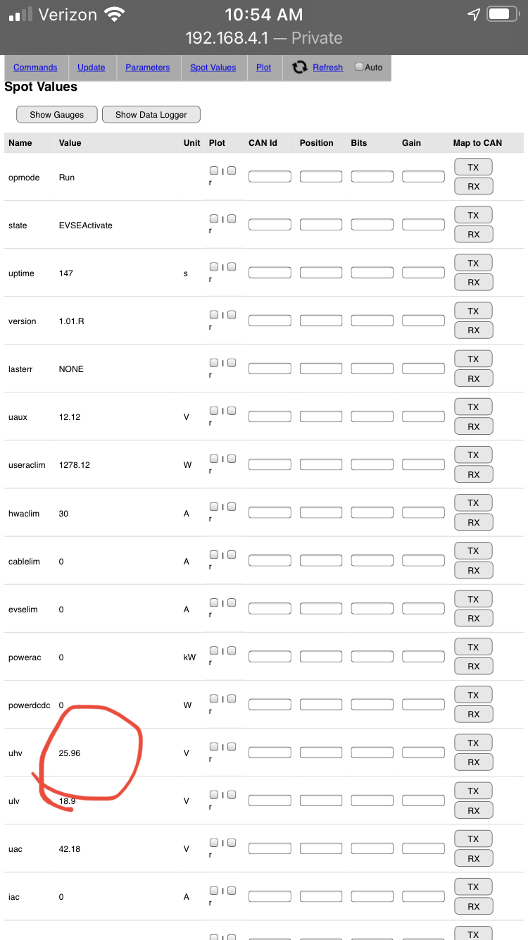

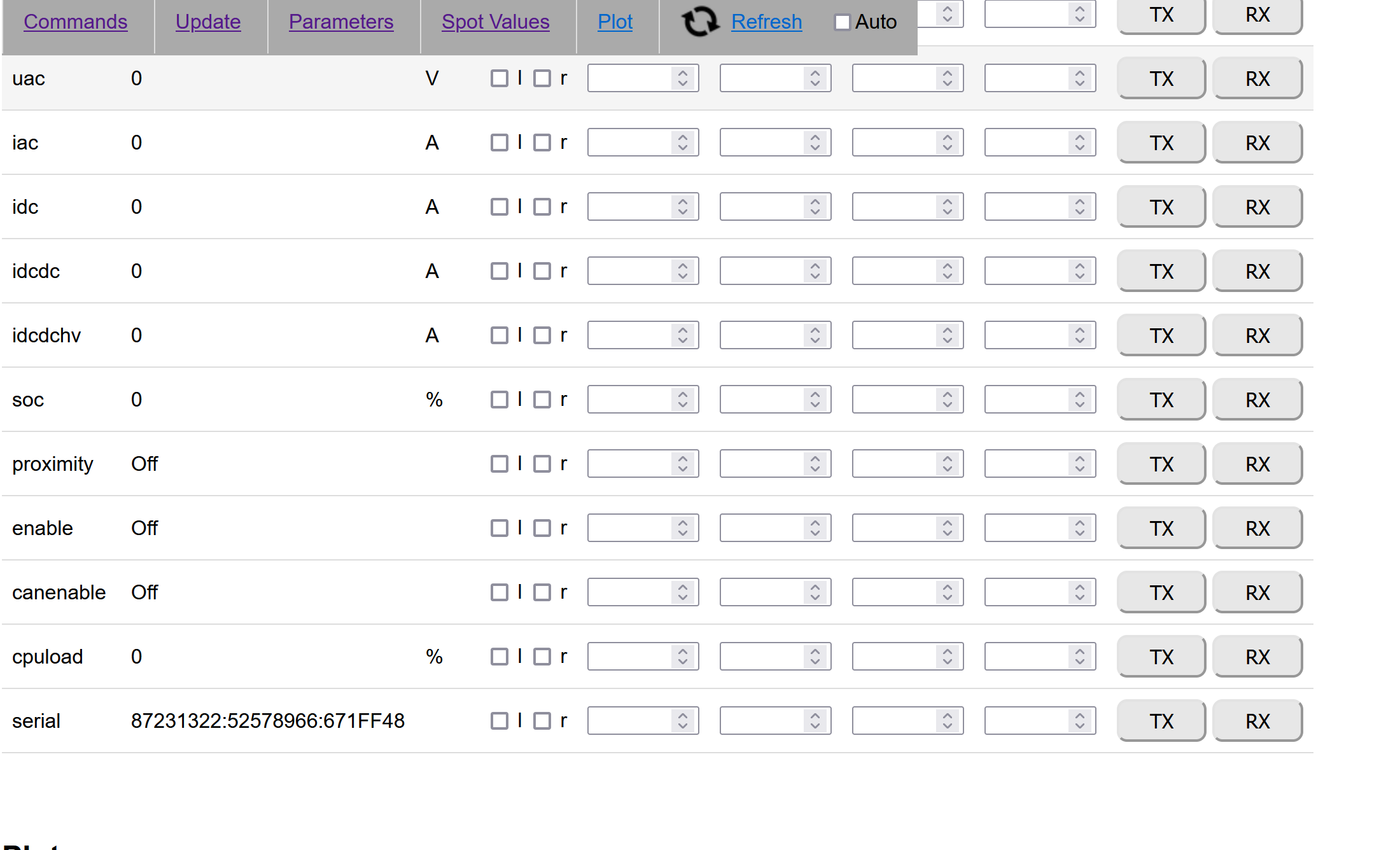

And here are with the cable plugged in:

It would appear to me that the board and PCS are not talking. Is that a correct diagnosis?
fredd90
Posts: 87
Joined: Tue Oct 20, 2020 7:36 pm
Post by fredd90 »
P.S.Mangelsdorf wrote: Sun Dec 12, 2021 1:48 pm It would appear to me that the board and PCS are not talking. Is that a correct diagnosis?

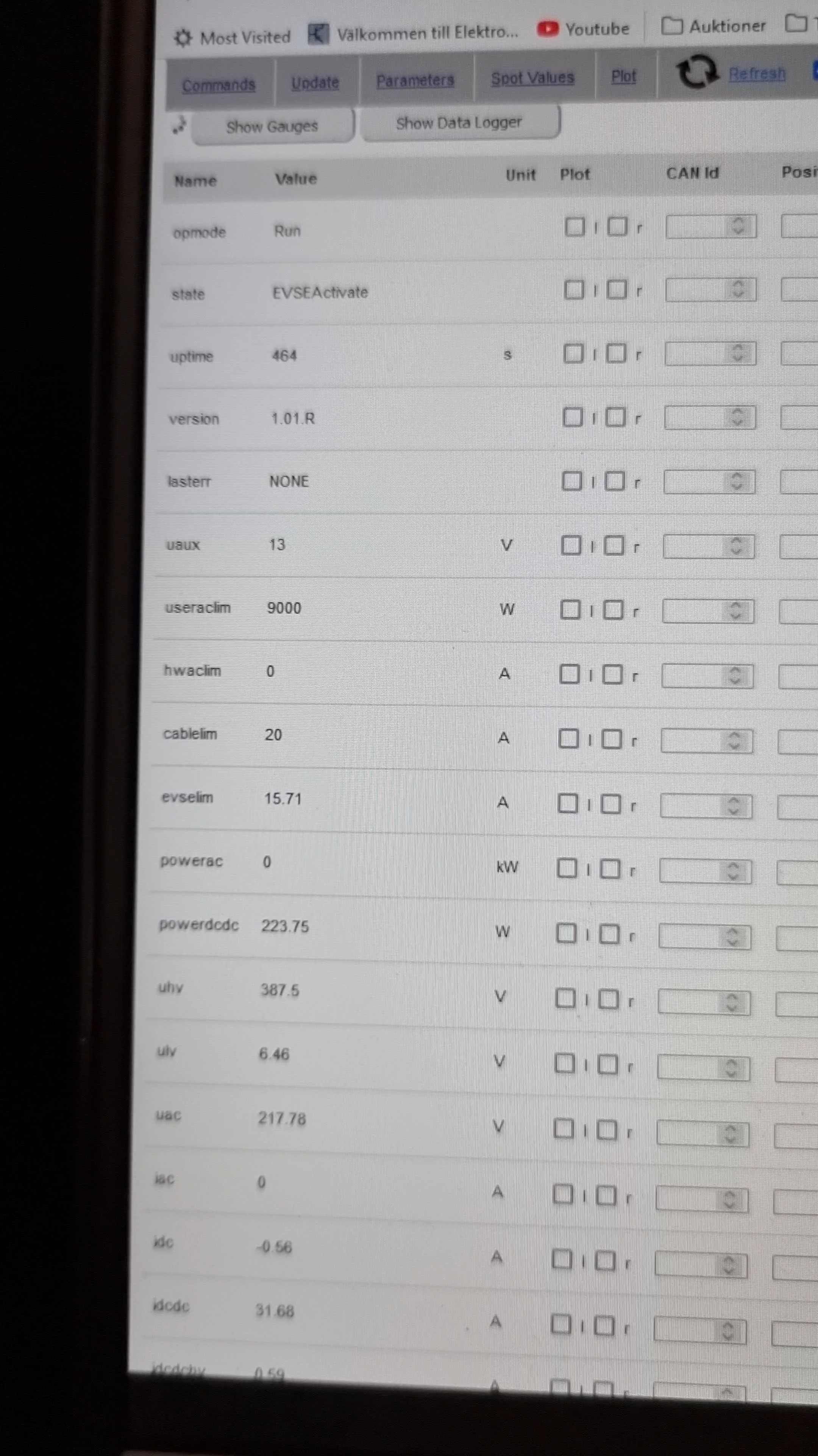

That's also how my web interface looks when it's not "enable"
As fast as i "enable" via input 1, all readings came up and the "Opmode" turns to run.
Attached picture from pcs enable.

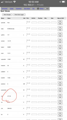

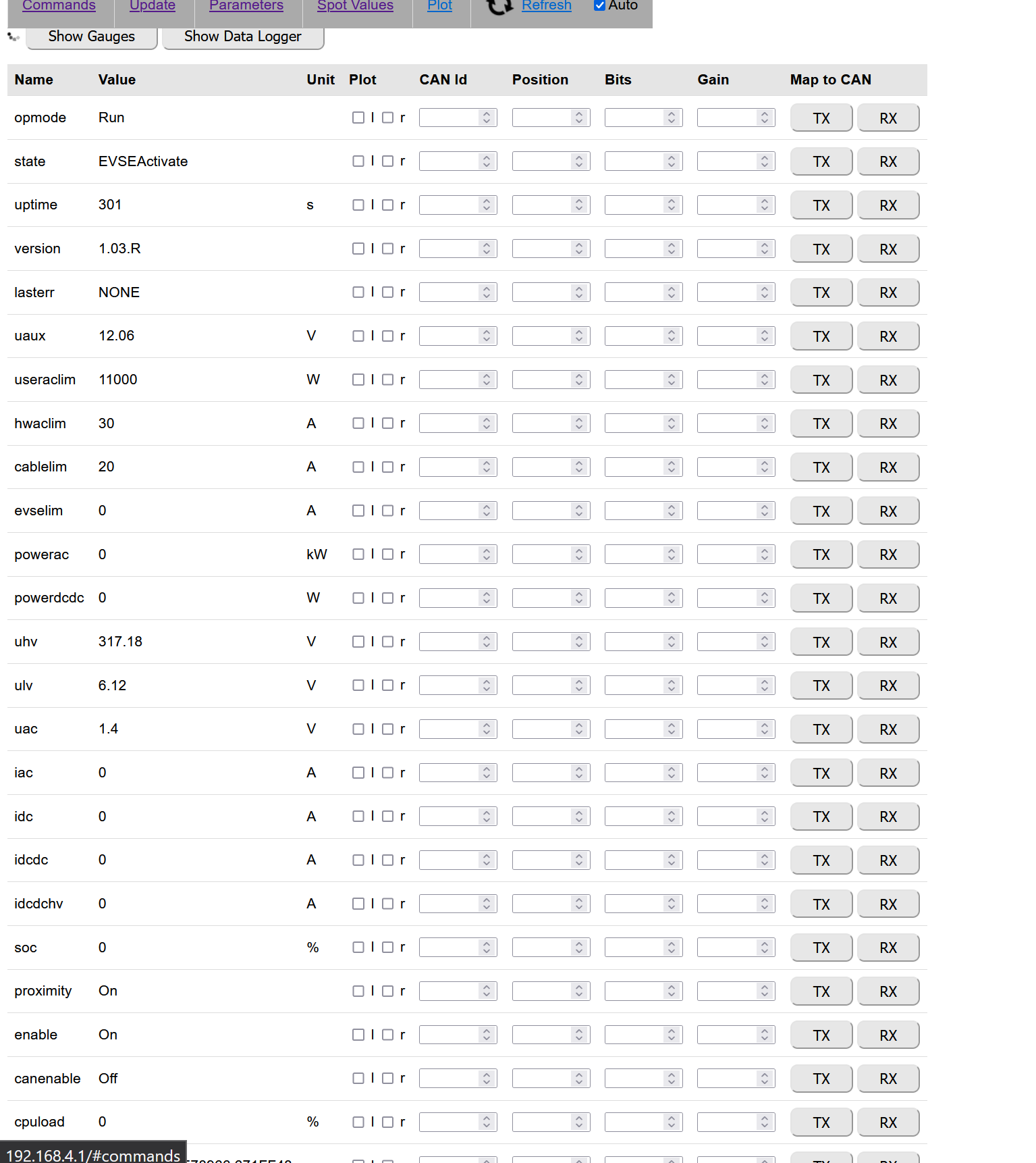

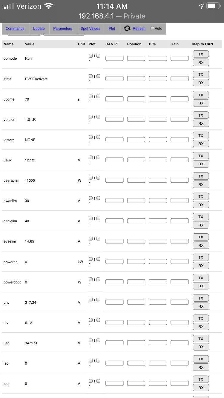

Ok input 1 helped, but still not quite there.
Its now entering run mode, but new weird-ness. When the car is plugged in, the charger report the correct voltage from the HV side (approx 317) but when it is not, its only reporting 25ish volts.
Its telling my evse to deliver power, but not drawing any amps.
Also dc-dc is not coming up at all.
Does input 2 need to be connected somewhere?

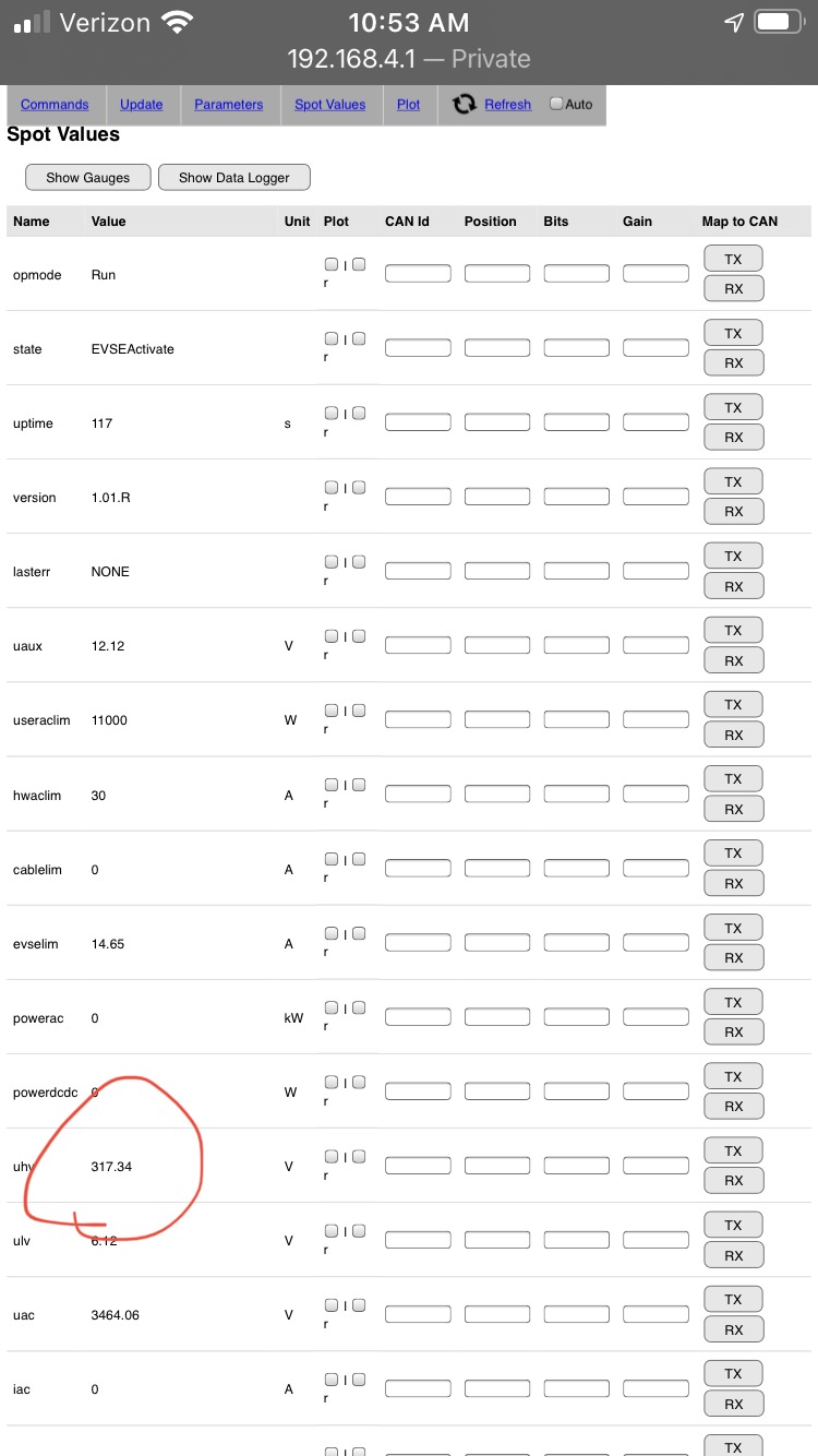

See screenshots of voltages reported
Posts: 6735
Has thanked: 378 times
Been thanked: 1559 times
Input 2 is currently unused. Have you set model to "US" ?
edit: cablelim reports as 0, why is that?

johu wrote: Sun Dec 12, 2021 4:05 pm Input 2 is currently unused. Have you set model to "US" ?
Yes model is set to US.
Not sure why it did that time, I just retried twice and it showed 40, but no change in behavior.
Right after plugging in I get a whine from the charger (clarification) the PCS for about 5 seconds then quiet.

Before we fixed the multiplexing error i also got very high acvoltage, and the uhv(dcvolt) switch between low and high voltage.
All this is solved in the last file Johu created, exactly the same issues that i got before:) (not yet officially released due to its not yet ready and fully working...)
When the whine is about 5seconds the pcs controller did my pcs not get the right values.

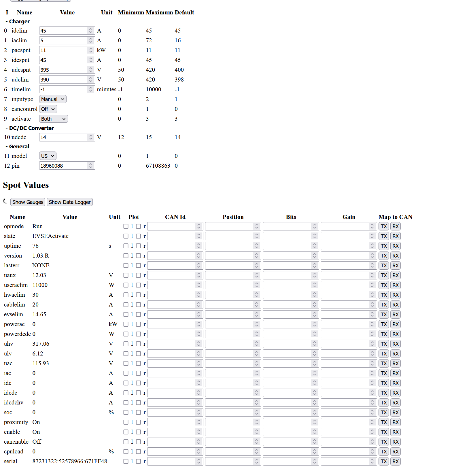

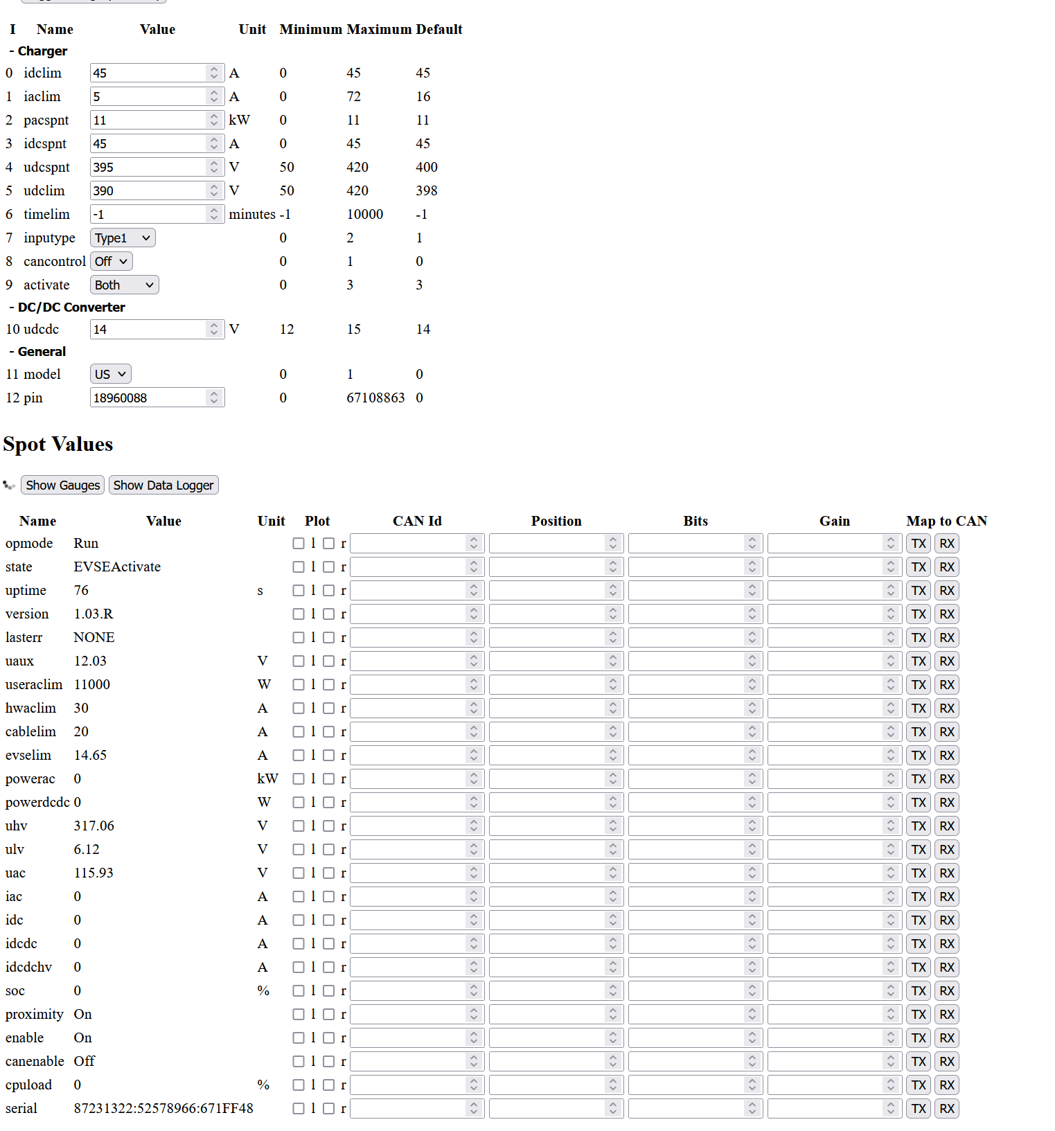

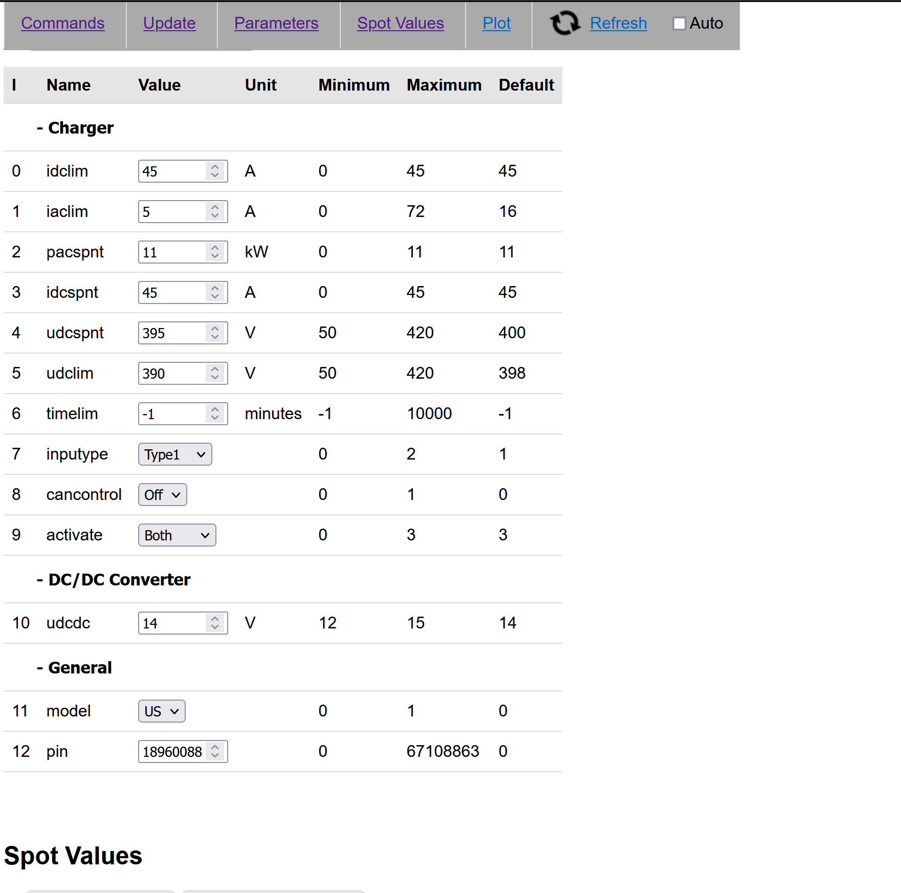

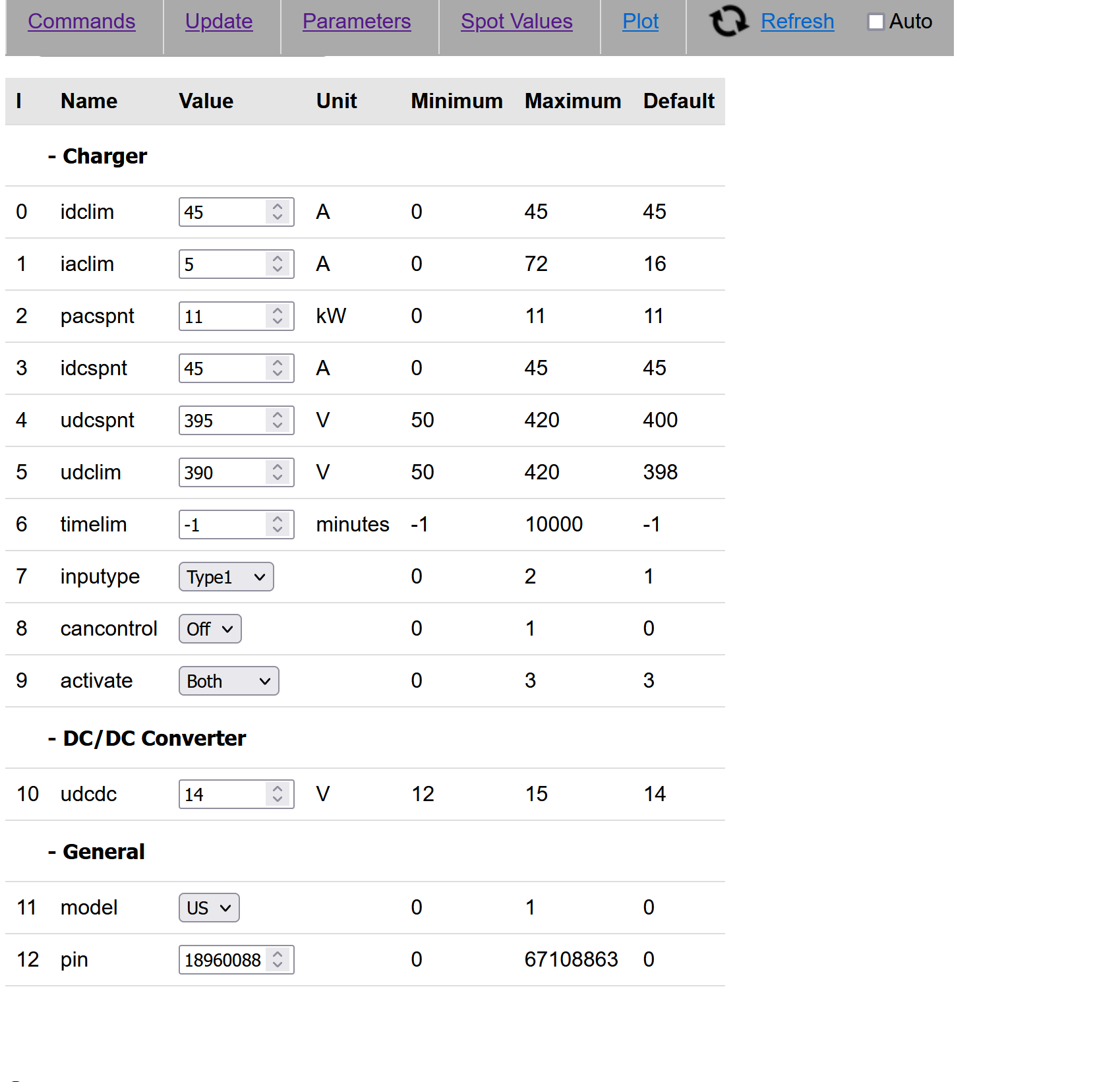

I tested with the new (unreleased) 1.03 firmware today.
This update fixed the bouncing around of the reported HV, but did not get the DC-DC or charging to function. Snips below of parameters, spot unplugged, and spot plugged in.
Any thoughts?

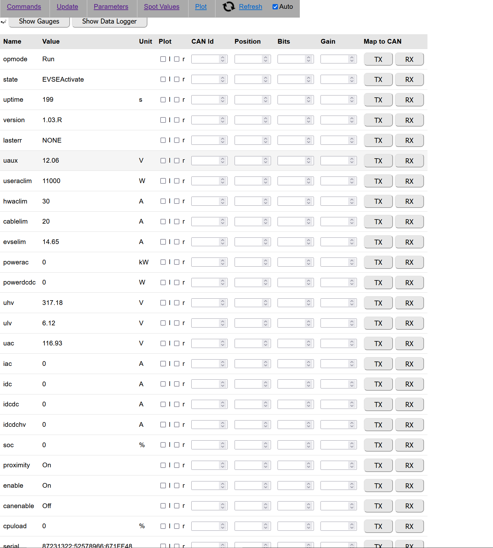

So after the update the version # did not change from 1.03, is that correct?
No luck getting dc-dc or charging
Screen shots below plugged in and unplugged.
