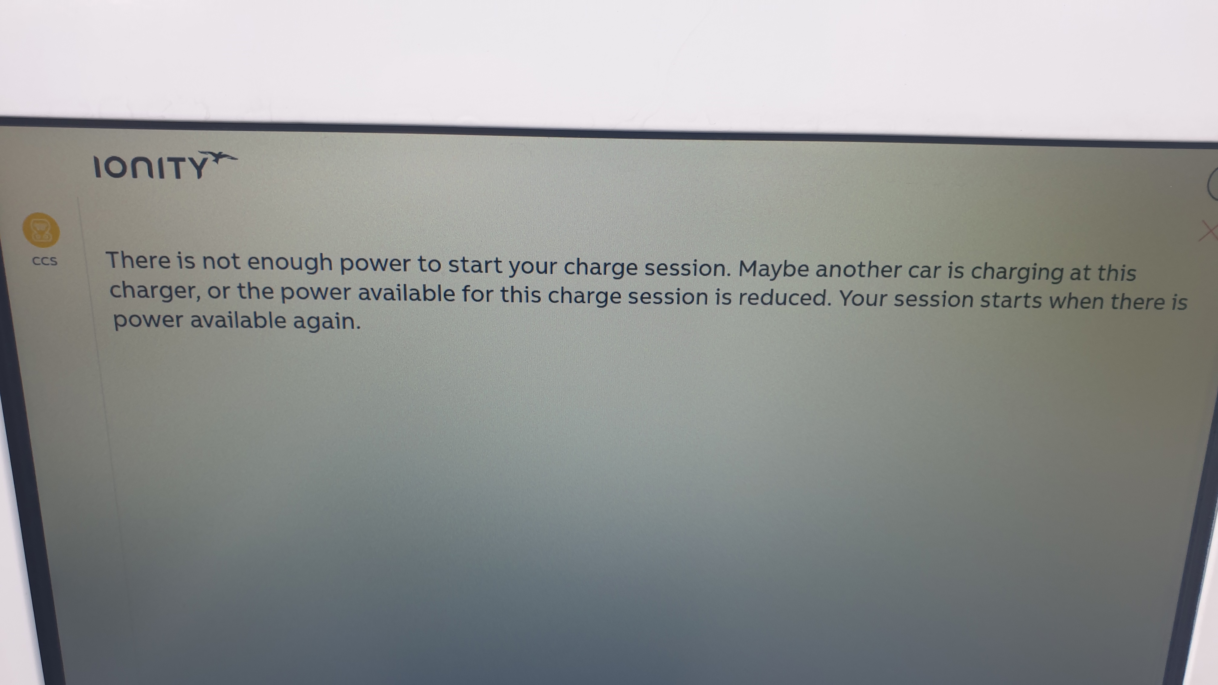

So today's exciting episode of can we charge at Ionity. Decided I wanted to rule out the possibility of a connection problem at the charge socket so threw my Hyundai port in the back of the car and wired PE,CP and PP to the LIM. No difference at all. While I was there decided to screw with it a bit and while it was sitting there telling me about charging will commence when power is available I pulled the cp wire and started flicking the ends together. Next thing the station bursts into life, my pilot goes to Ready and we go into cable test. I got such a fright that I dropped the cp wires and of course we shut down instantly. Try as I might I could not get it to do this again but did get a very informative message on the screen at one point telling me about lack of power despite there being no other stations in use.
What I cannot fathom here is the logic behind this message. What logic tree in the station is making it think there is not enough power available when we don't even have plc comms up.
Did a cold start of the LIM just in case. No different.
Authentication before inserting the cable results in our now famous message the second the plug hits the socket.

The "famous message" is a bug in ABB stations. I think the logic is, since the station hasn't hit charge parameter discovery (which occurs long after SLAC - they are not equivalent, bitterandreal), the station doesn't know how much power to allocate the vehicle. It's silly. ABB is... not great communicating issues to drivers via the screen.
At ABB stations (and many others) you actually don't need to authenticate *at all* in order to set up CCS communications. The station will present 5% PWM right away and get the process started. This is required for Plug and Charge with ISO 15118 so any station that supports that is going to do the same. So technically you don't have to authenticate at all to test this issue you are having. You'll just sit in the contract authentication phase until you authenticate. This phase is just a ping pong to keep the connection going while the user fumbles for their RFID card or credit card. I'm not sure if the LIM alerts you to this state, hopefully it does. If I ever get access to an i3 again I have a way to test how long the LIM will allow waiting in contract authentication before timing out. Most others are around 2-3 minutes. After authenticating, the process continues with charge parameter discovery, cable check, power delivery, then the current loop (actually charging).
Other stations tend to just show 9V with no PWM until you authenticate, then send the 5% duty cycle once you've authenticated. I suspect the LIM is operating just fine with those.
So, lets recap:
ABB sends 5% PWM right after plugging in (might be a good idea to try a logging scope, if you have one, to see the bit of time before 5% starts, you should see steady 9V for a short bit of time).
LIM is not sending PLC packets to start the SLAC process.
ABB times out after what is probably 30 seconds of sending 5% duty cycle. Please ignore the text of the status about no power available and just trust me that it's just unhappy about not setting up PLC.
You made some progress in discovering that disconnecting the pilot and reapplying it figuratively kicked the LIMs butt into starting the SLAC process.
Gotta be something in the startup routine of the LIM that is somehow unhappy, I think.
Keep looking...

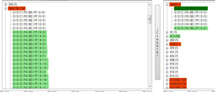

Ok so went back at the can logs and something rather obvious jumped out : Message 0x112 from the bms is always live and showing the hv system punched up and ready in the i3 before even opening the cp door. In the E46 I use the plug detect feature in the LIM to wake the car and thus populate 0x112 with real battery data. So in my car the LIM is looking at a disconnected HV pack until plug is inserted and pwm is detected whereas in the i3 its all ready to go. Off I went to Ionity land. With HV on BEFORE plugging in things get a little interesting. No more timeouts! I went for a nice 5 minute walk and sure enough when I get back we are still receiving pwm from the station. Now of course when I authenticate the famous message of course pops up.
So I get some tea in the service station and start making some mods to the state machine so that it waits for actual events before moving on and will now move back to state 0 if pilot goes static. Over to Efacec. With HV off before plug insert Mr.Efacec not happy. With HV on before plug insert Mr.Efacec very happy.
More coding and we now wake the car on opening the cp door. On Efacec I can now do the plug / card swipe / app dance anyway I like and it just works. Plug in swipe or swipe and plug in its all good. Even if I let the Pilot time out to static and re authenticate it picks up and away we go.
Over to Mr.Ionity. Plug in, swipe, "charging will commence blah blah", pilot to static. Reswipe, pilot wakes up, "Initialising" pops up on screen pilot goes ready, I'm about to jump out of my skin and then pilot to static and ... yeah you guessed it! "charging will commence blah blah"
Now thing is this is totally repeatable and we are getting a burst of pilot ready so I think it might be time to break out the logic analyser and get some pcaps.
So closer but still no cigar.

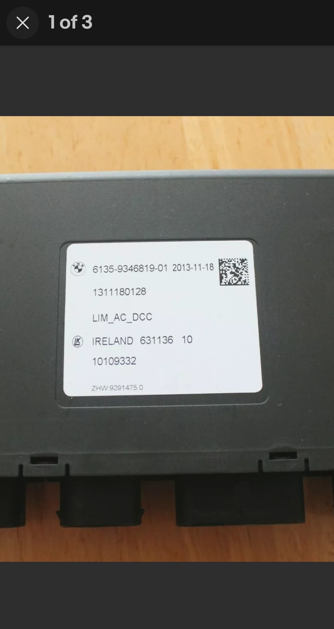

One way to see if this is true is to follow the part numbers and see if you needed to order a LIM for a vehicle for say a 2014, what part is current? Then see what years are compatible with that part. Do the same for 2015, 2016... all the way up through 2020.bitterandreal wrote: ↑Sun Nov 07, 2021 3:58 pm But the CAN communication to the car could be slightly different too and we compare the messages with a 2019 i3 which probably runs a newer VCU and LIM firmware.
Taking my own advice here, looking at bmwpartsdeal.com for the LIM, it appears for the part number 61-35-9-454-319 is good for BMW i3 model years 2014-2020, meaning there is likely minimal CAN side differences, hopefully? I suppose a 2014 could get a software update for the VCU when the new LIM is coded... Someone could spend the $30 for a 24h access to https://www.bmwtis.com/#/login to see if a VCU update is required. No guarantees of course, but if say a 2014 doesn't require one when installing this new part, the CAN commands are likely the same.
Also stumbled upon a slightly useful resource: https://cdn.jack.sh/2014/08/06_I01-High ... onents.pdf
Looks to be a training manual for the i3. Others can be found here.. The above goes into some detail on the LIM, but probably nothing earth shattering. Some stuff would have helped a few months ago though (like which CAN bus the LIM is suppose to be on).
Also in the Wiki -
While it could mean that time is the changeover to supporting ISO 15118, DIN does support 0-1,000V (at least communication wise, CCS is suppose to be 200V minimum), +500A. The reality is that V2G DC via CCS is still in draft form. If we get some PCAPs of some running sessions with the newer LIM, even if the station doesn't speak CCS, I can see if the LIM is offering to speak ISO 15118.The limits for pre 2017/26 (Week 26 of 2017) are 0V-500V 0A-250A, post 2017/27 (Week 27 of 2017) 0V-1000V -500A-+500A. This probably indicates when they moved from DIN 70121 only to ISO 15118.

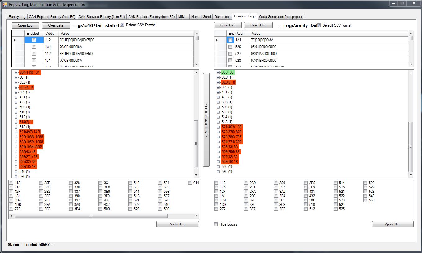

Damien can you send me links too 2 canlogs working and non working? I have a nice log comparator and wanna try it for you.
One of the things I fear is that we are asking for 500amps instead of let's say 10amps for a split second just after init.
Then the power message makes sense. I see in your video that CCS_I is quite high, in the web GUI, for a split second on commence.
Maybe as a test fixate that value too 10Amp and check?

ok now if there are checksums point me to where there are because the tool (if i load a definition) can compensate for that.Jack Bauer wrote: ↑Tue Nov 09, 2021 10:44 am In this log we get to contactor close request but fail there as I had the contactors wired wrong but setup worked fine :
https://github.com/damienmaguire/BMW-i3 ... ionity.csv
In this log we don't get any setup :
https://github.com/damienmaguire/BMW-i3 ... _e461.2csv
some messages are hot because they are completely different.
White means no difference between left and right.
Red means different [ (Amount of messages with that id) How many are unique compared to other side! ]
Green means unique id on one side only found.
The tool only compares raw messages so not the order of appearance //timing. But if there is stuff different we can try to find out why.
So i would start with the LIM messages for example.
If you give me in a small list the LIM numbers i can make a definition. The names then appear in the tool.
If we have counter bytes and or CRC bytes it eliminates those differences too.
Let me know if this makes sense.
Then i can show you the results of some numbers.
- EV_Builder
- Posts: 1205
- Location: The Netherlands
- Been thanked: 37 times
3B4 is it possible that its status from the LIM?
In my car / project i think it was a status / warning from the MCU too.
If you see the right side: a good/working session on the right only has 6 Messages and one is different to the left.
But the left side kinda has 139 of them and 134 are not present on the right.
(Ignore the dark green line, it's the light one what is unique on the right side).

Coudn't resist and looked it up:
WIKI: 0x3B4 EVSE info CP, PP & inlet voltage LIM
I bet we don't wanna see F4 and don't wanna see BD and 9 and a counter?
I need to check if the order of MSG's in the list is the order in the logfile , first appearance, but i think it is.

EV_Builder wrote: ↑Tue Nov 09, 2021 8:05 pm Coudn't resist and looked it up:
"F4" means charging flap unlocked, plug locked, no Cademo data.
"9" means charging with CCS2 via the DC pins.
"BC" means 5% pilot, no chademo plugged in, charging cable plugged in during the last parking process!

Hi everyone I've been watching development for a bit. I would like to know if this module is DC fast charging capable.
bitterandreal
- Posts: 56
- Joined: Fri Jan 15, 2021 2:30 pm
- Location: Netherlands
- Has thanked: 3 times
Yes I've seen the wiki before but I'm wondering because it has AC_DCC instead of AC_DCO is that for chademo?
