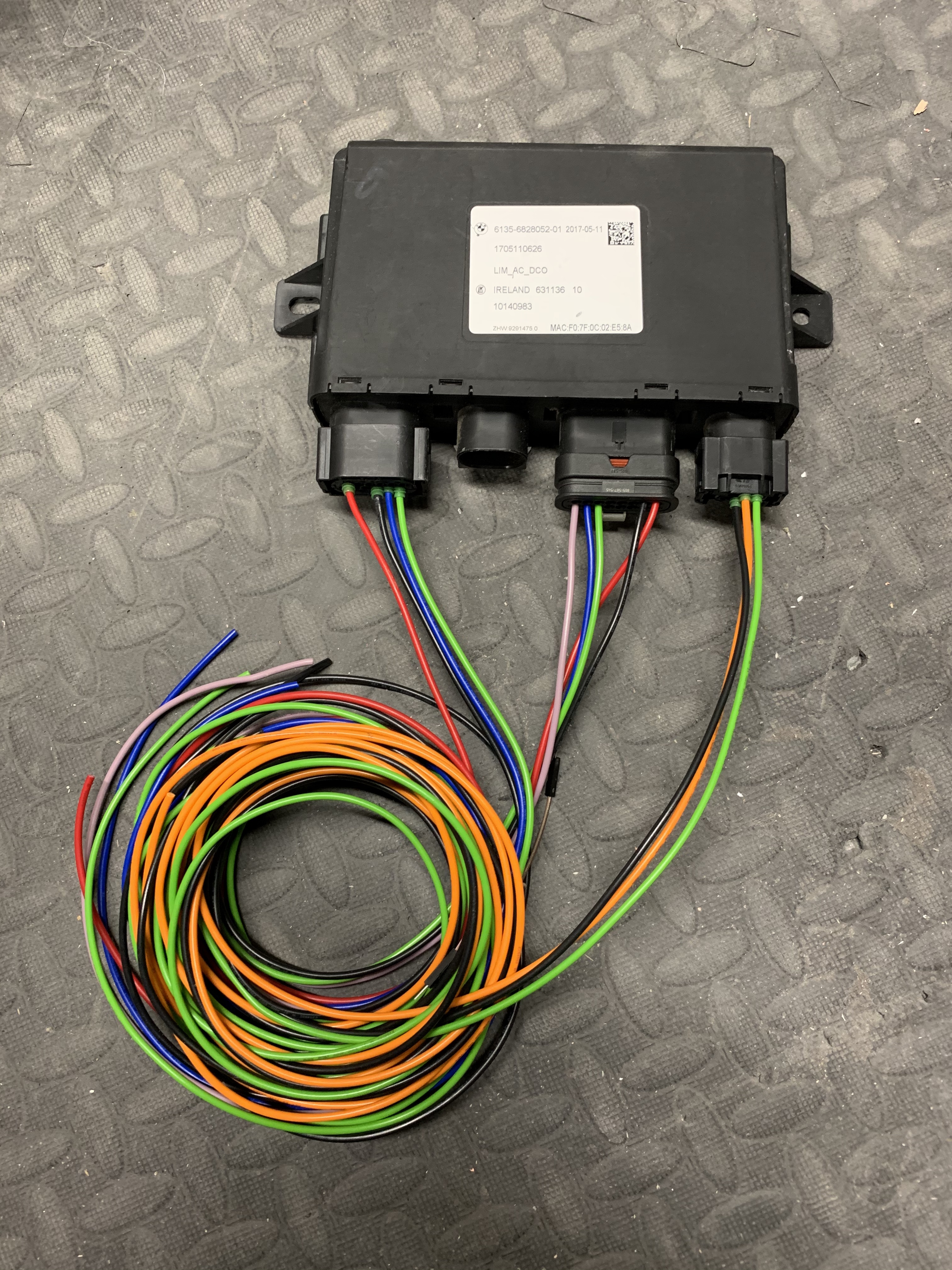

Small bit of progress. Connectors have arrived. Thanks to muehlpower for sharing the details. I hate searching for connectors:) almost as much as I hate crimping them ....

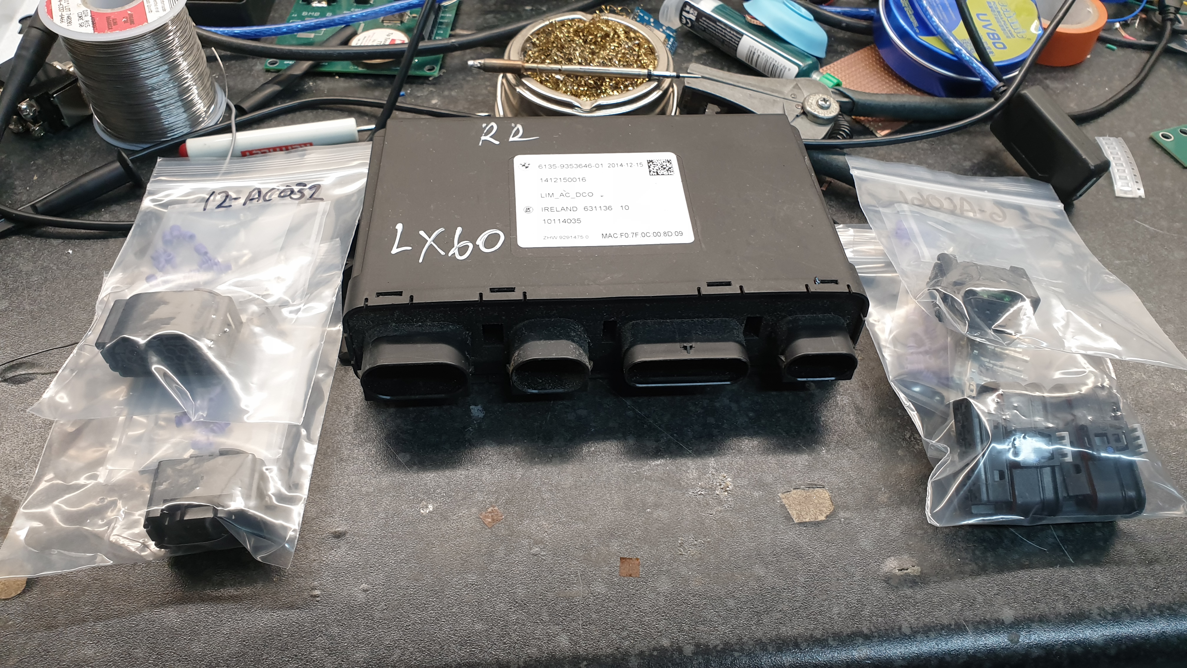

I've got one of these too. Would love to help out with this.
Was planning to try and do something with it a bit later. I don't have a car to test it in yet, so, a bit hamstrung for now. Unless someone knows of a CCS DC EVSE that's reasonably priced to test against that I could use at home? Or is the only practical way of testing this at a public station? I suppose I could chuck some bits into a box temporarily and bring it to a charging station in my ICE car.
This is what I've managed to find out so far.
From left to right in that picture, the ports are
4B : 12 pin (plug : 1534151-1)
3B : blanked out on my unit
1B : 16 pin (plug : 805-587-545)
2B : 6 pin (plug : 1-967616-1)
pins : 5-962885-1
rubber seal thing : 1-967067-1
1B pinout
1 LED_S (lighting charge socket)
2 ZV_LKL+ (charge door lock motor)
3 LED_M (lighting charge socket)
4 ZV_LADE+ (hood/bonnet lock)
5 ZV_LADE- (hood/bonnet lock)
6 CAN
7 CAN
8 wake up signal
9 power
10 ground
13 SENS_LKL (charge door lock sensor)
14 ZV_LKL- (charge door lock motor)
15 CHARGE_E (goes to the KLE) guessing this is charge enable signal for the in car charger
16 ZV_LADE (hood/bonnet lock)
2B pinout
1 pilot
2 proxy
3 diag? looped back to pin 4?
4
5 gnd (charge socket)
4B pinout
1 HV+_SZ+ (contactor control)
2 HV-_SZ+ (contactor control)
3 HV+_SZ- (contactor control)
4 HV-_SZ- (contactor control)
5 U_HV_DC
6 LED_RT (charge status lights)
7 LED_GN (charge status lights)
8 LED_BL (charge status lights)
9 BR_GND (charge status lights)
10 ZV_LS- (charge socket locking)
11 ZV_LS+ (charge socket locking)
12 SENS_LS (charge socket locking)

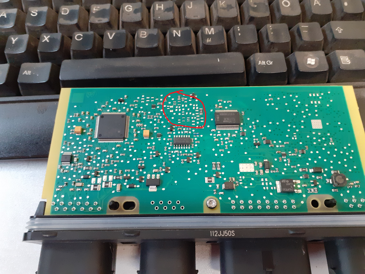

- muehlpower
- Posts: 807
- Been thanked: 186 times
Jack Bauer wrote: ↑Thu Mar 11, 2021 5:48 pm No idea on the model year of my unit. Worst case can get another as they are not expensive. Savvycan would be great:)
yours is from 2014, you can read on it! According to the part numbers, there are probably different ones before and after the facelift 2018.
the marked area is not populated at the newer ones
