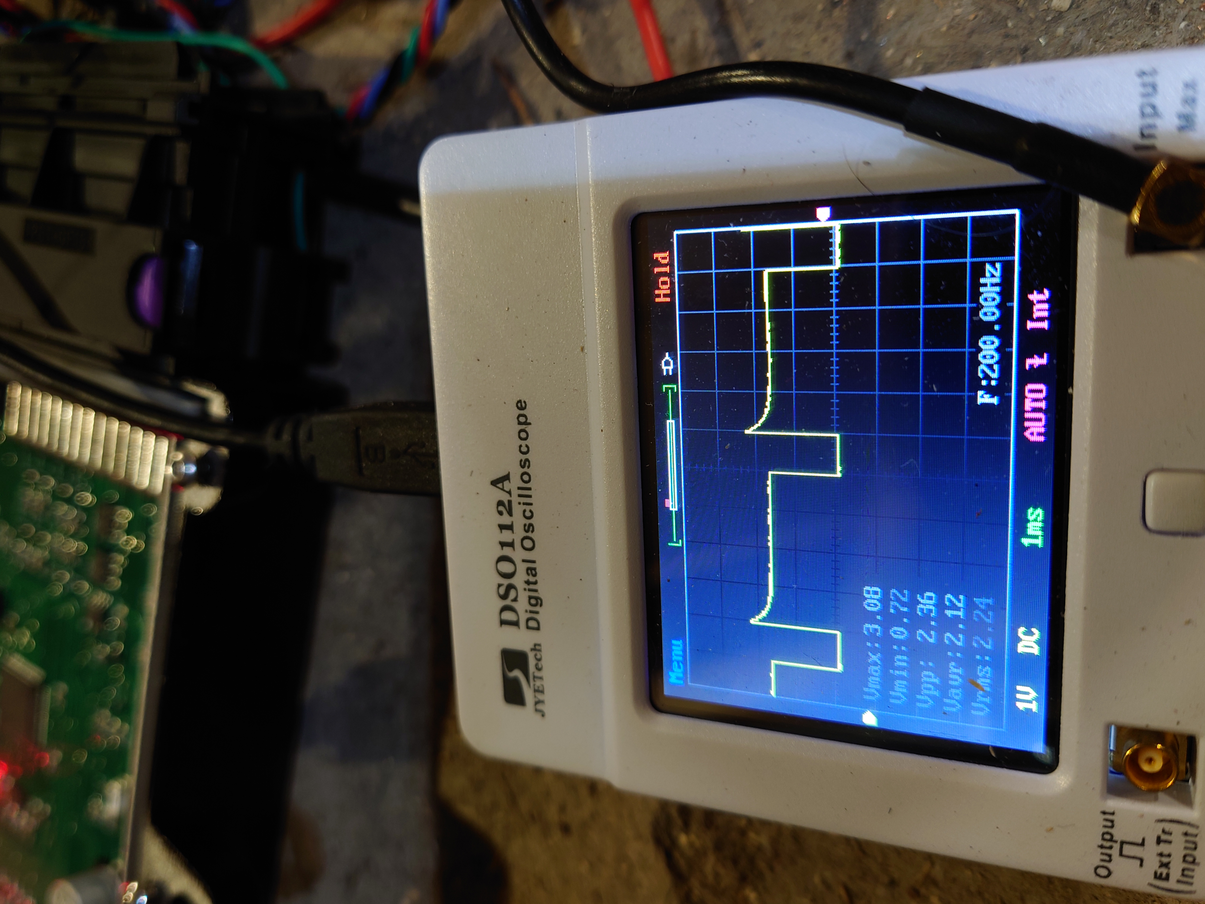

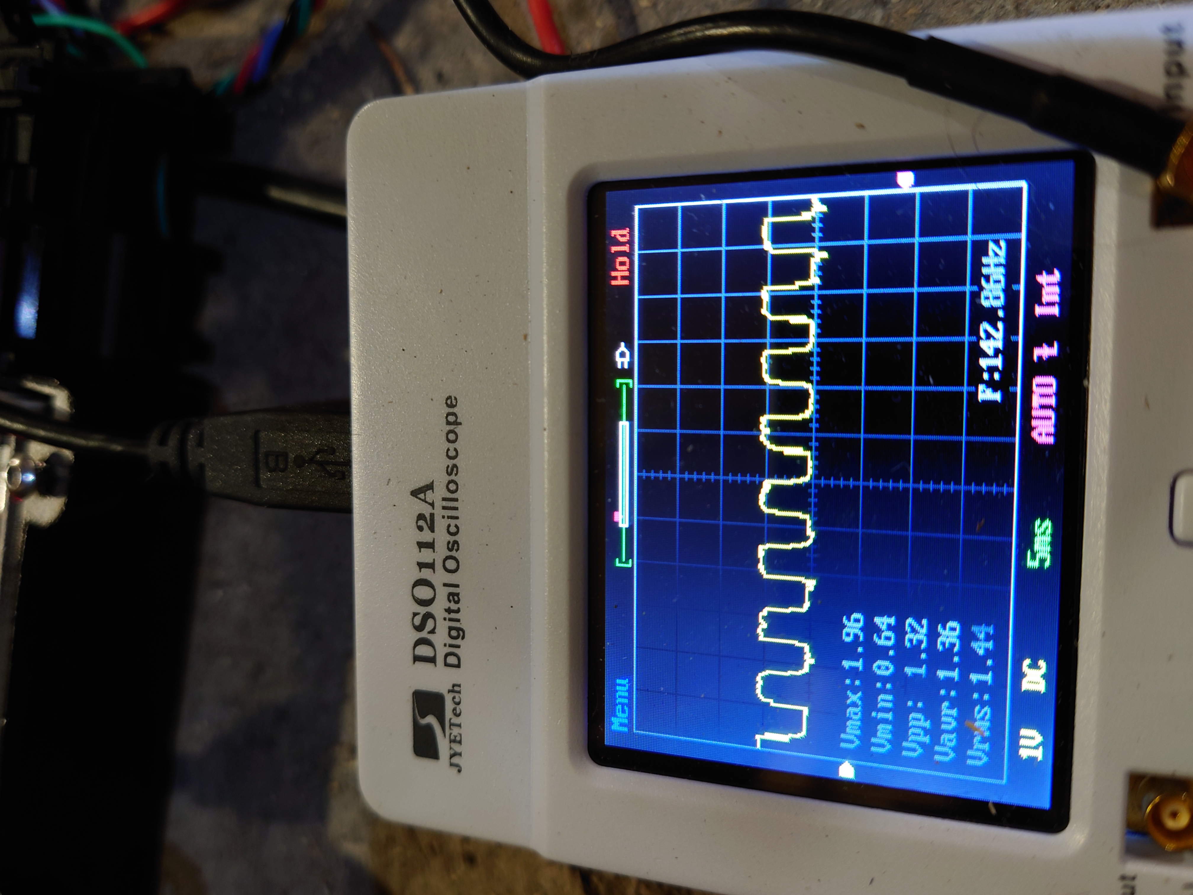

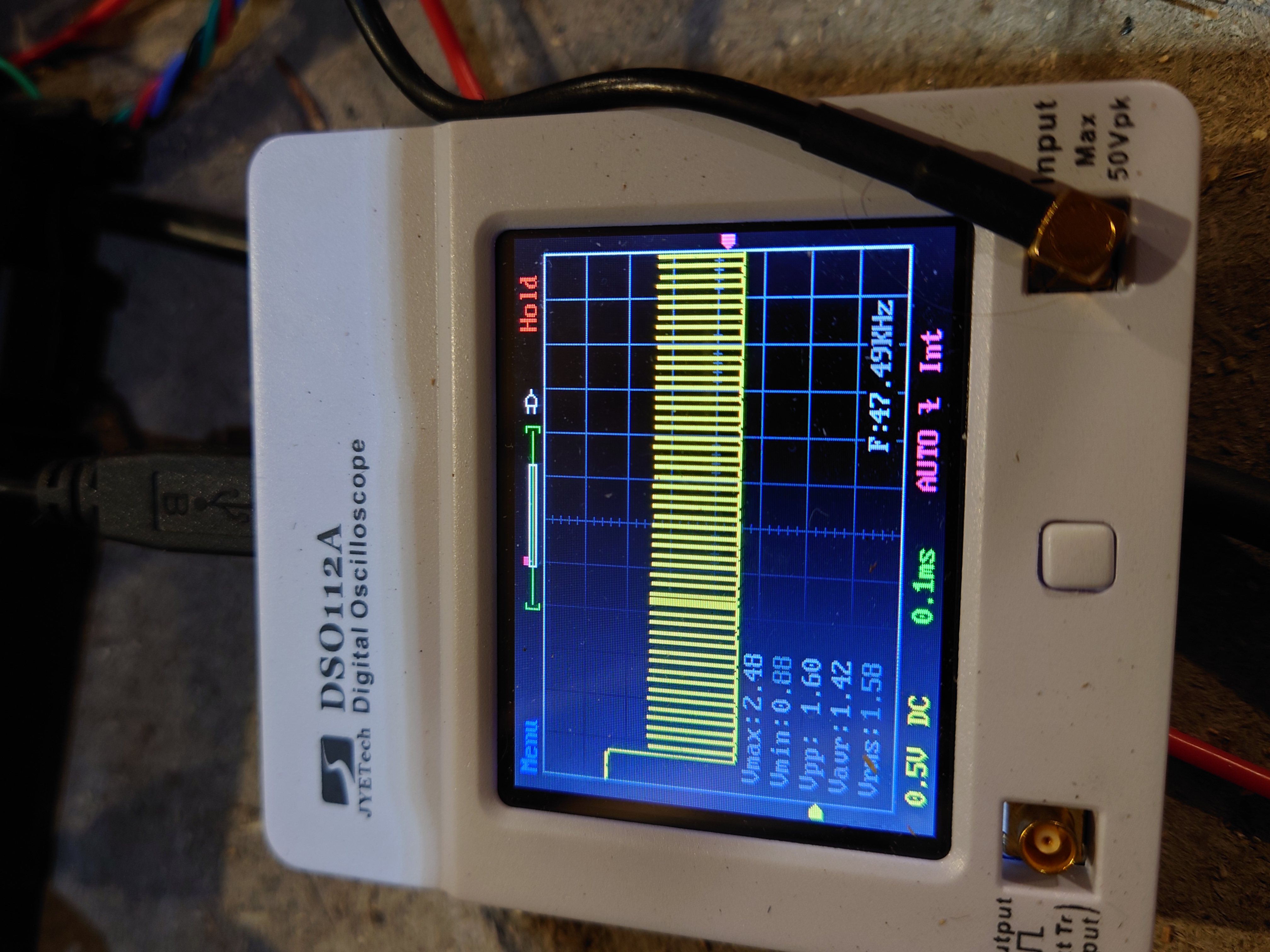

Jack Bauer wrote: Thu Jun 10, 2021 5:57 pm Have you selected GS450H from the inverter menu?
Of course. I've choosen GS450H and E46.
It was my fault with serial wiring (+/- swap). Now pulse seems similar with yours.
But still no data fron inverter in web interface and inv status is "off".
I'm going to try with another Lexus inverter tommorow.

Dilbert wrote: Sat Jan 02, 2021 3:50 pm OK, i can select GS450H now and i'm seeing HTM / REQ & CLK being generated. All 3 signals look good.
I'm not getting anything back from my inverter on the bench on the MTH line, so i'll need to investigate that a bit more. I have flipped REQ and CLK in the harness, so that should be ok. I'm going to scope the inverter connections and see if i can spot anything.
So, I have exactly the same troubles with serial communication between the inverter and VCU. HTM / REQ & CLK being generated and nothing on the MTH line.
Should every line be connected to negative pair contact on the other side, right? like REQ+ -> REQ- ?
And also I don't have any voltage on the "Inverter power", "Precharge" and "Main contactor" pins in the "Run" opt mode.

Sorry i thought he wasn't seeing any mth data at all from the inverter on the scope.
Ok so he needs to capture the mth data on the scope so we can work out the length and see if it's similar to prius / auris etc...

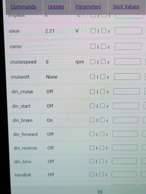

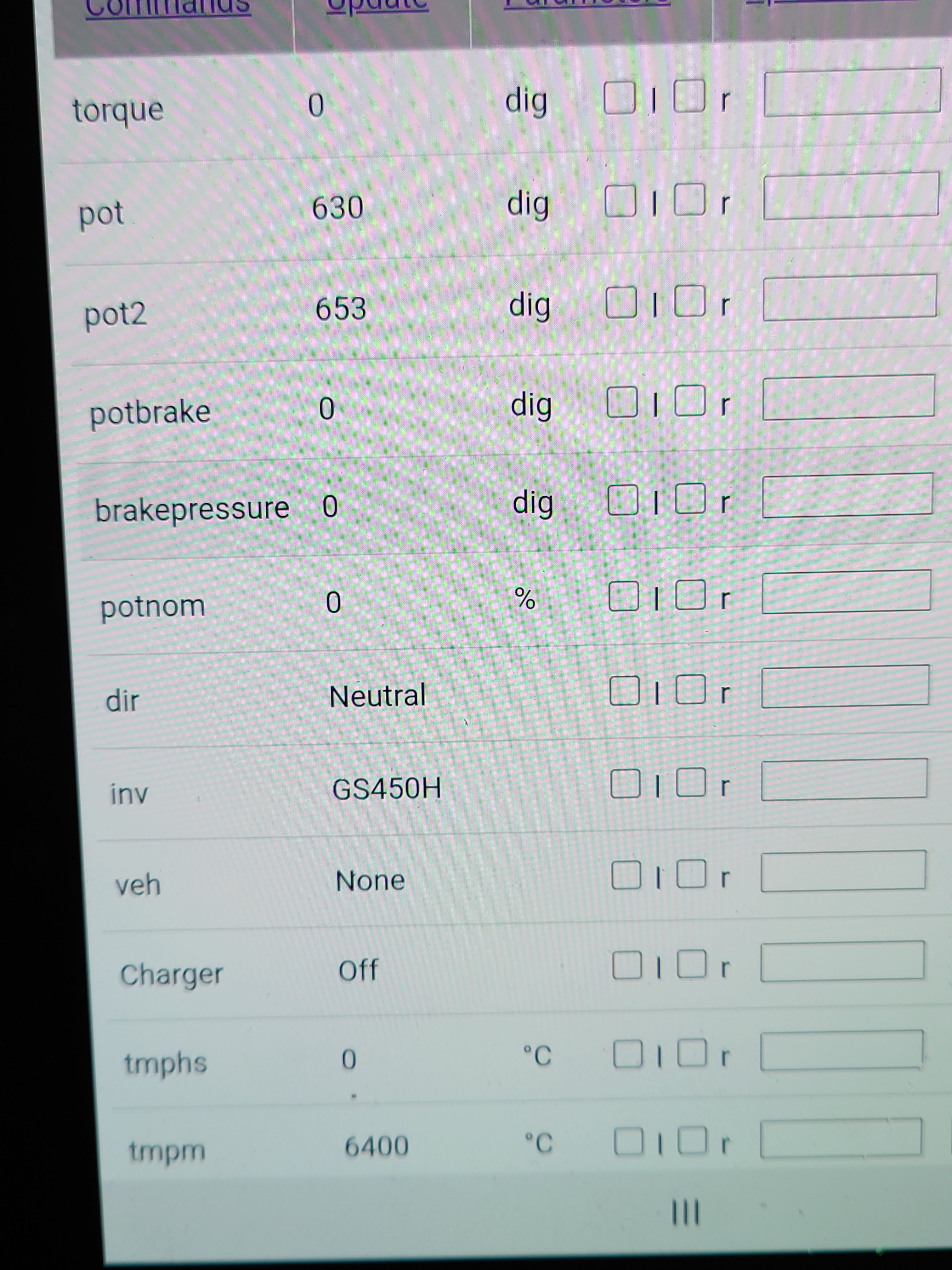

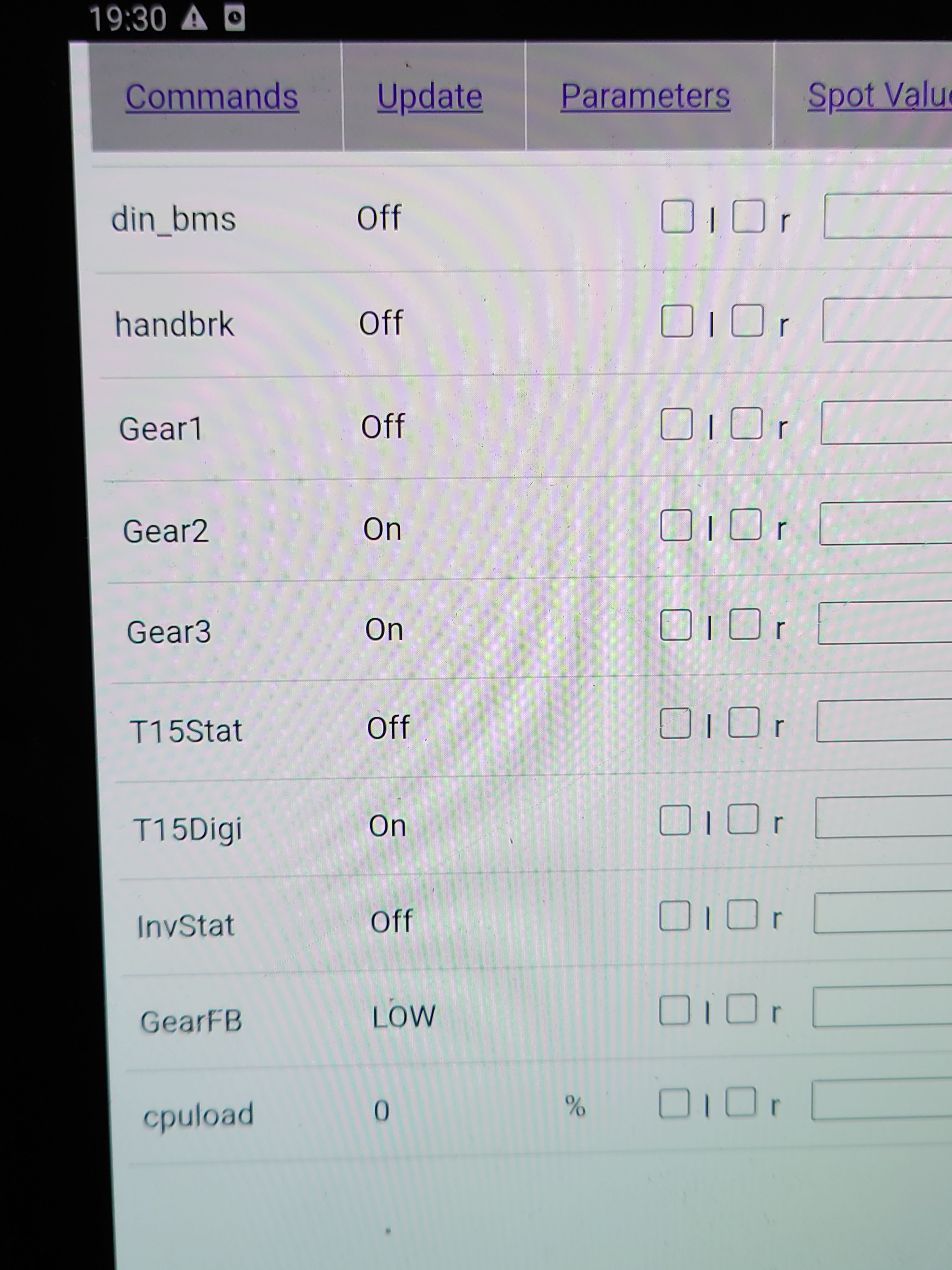

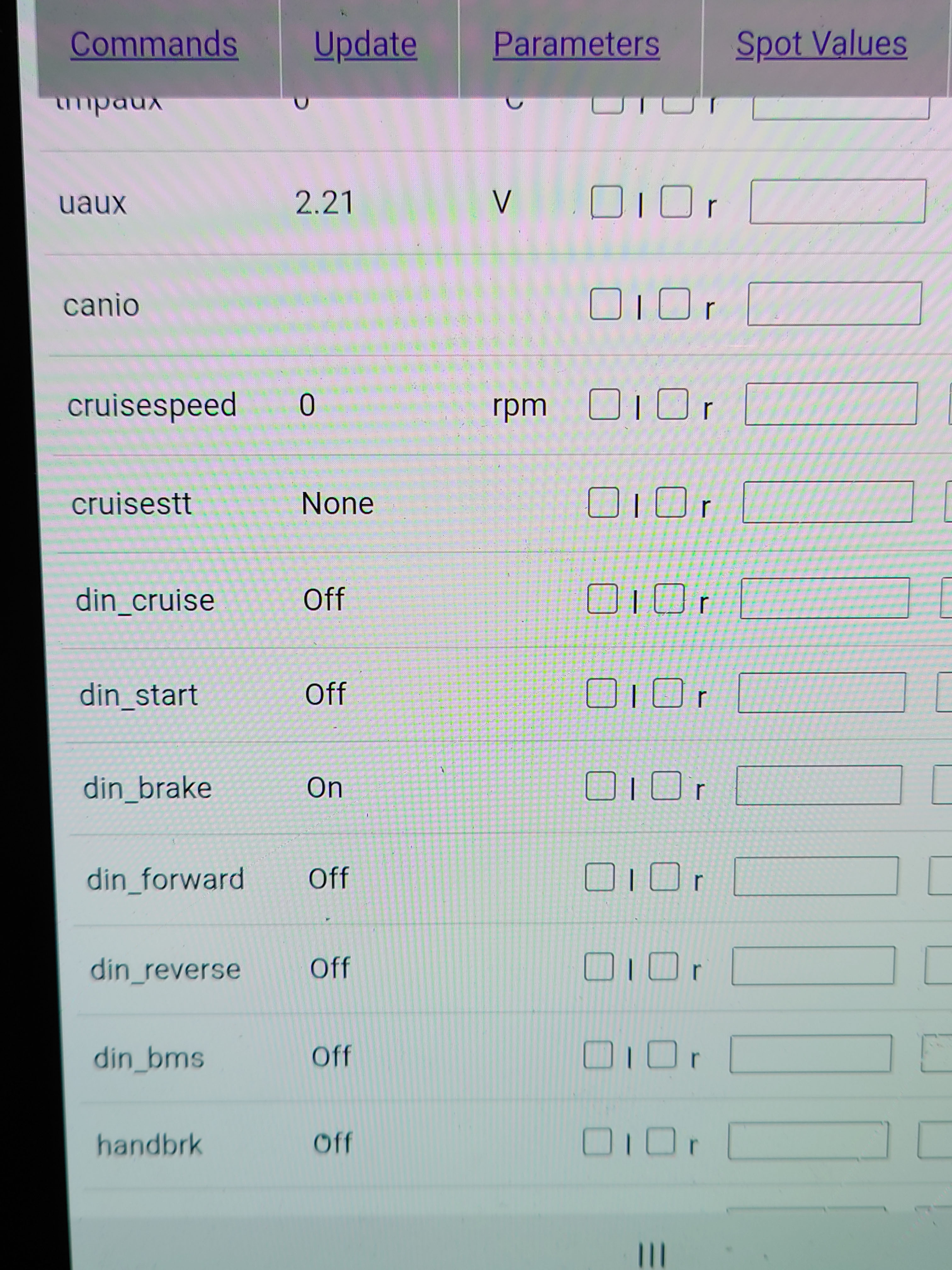

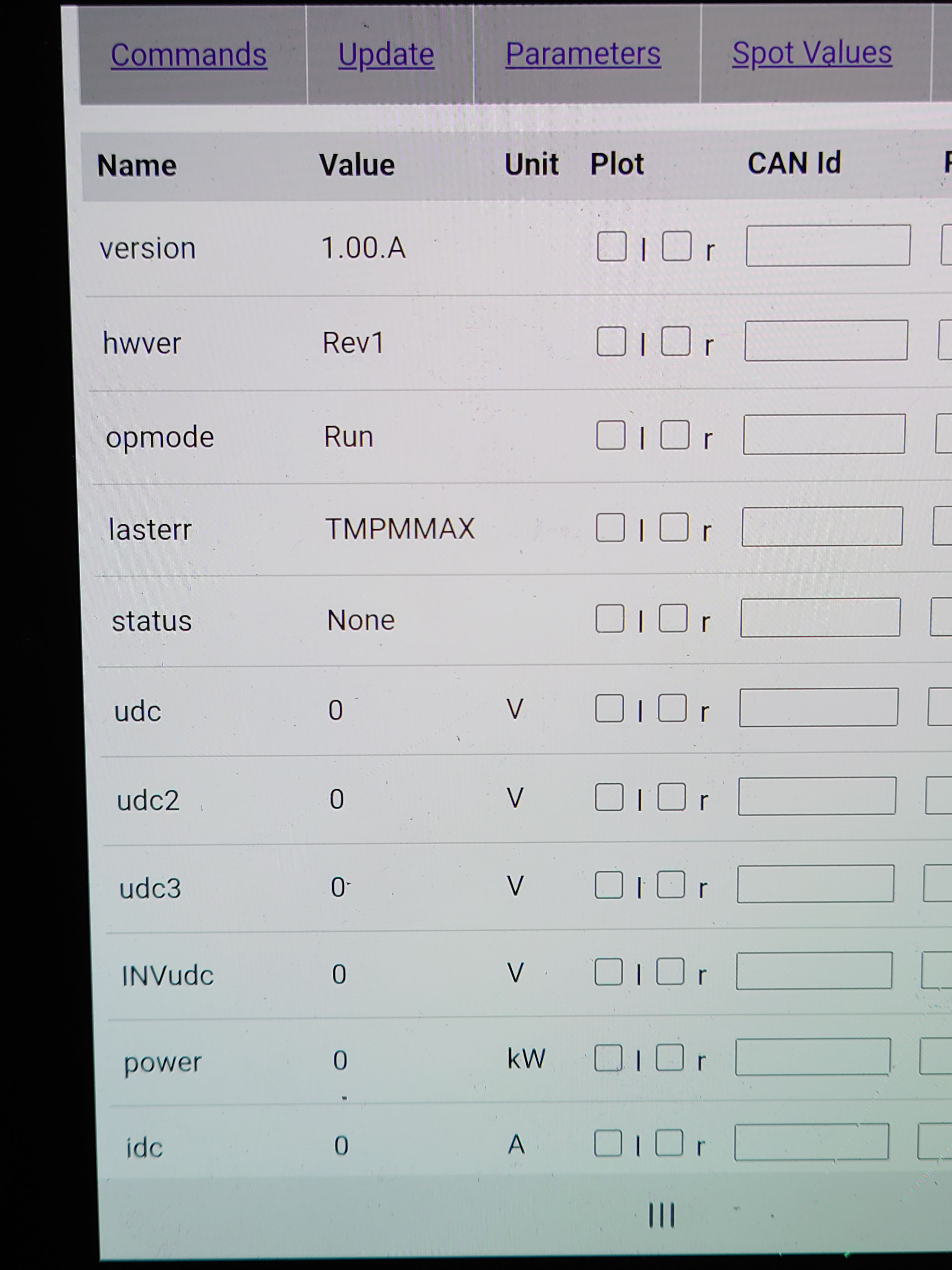

I've checked the serial lines wiring on both ends by buzzer and all looks good.
Now I try to understand the order of status changes and switch outputs activations.
1. Ignition On = Pin "Ignition T15 In" +12v = optmode "Off" = status "WaitStart"
2. Push Start button = Pin "Start" +12v momentary = optmode "Run" = status "None"
but switch outputs: "Inverter power", "Precharge" and "Main contractor" are still 0V. I've understood "low side switch" meaning now.

I've tried to get MTH signal from 3 different inverters with the same results: Camry 2013, G9200-30070 (Lexus GS300h I guess), and Toyota Aqua (I choose Prius Gen3 in the web interface with it).

chuuux wrote: Wed Jun 16, 2021 4:30 am I've tried to get MTH signal from 3 different inverters with the same results: Camry 2013, G9200-30070 (Lexus GS300h I guess), and Toyota Aqua (I choose Prius Gen3 in the web interface with it).
When you look on the scope at either of the MTH pins (+/-) are you not seeing any data?
That is very strange that no data is coming out on MTH, I've worked with the GS450H inverter and a range of Yaris/Auris/Prius boards, once they get a valid CLK and REQ signal, they all output an MTH data frame.
To answer your above question, no shielding won't make any difference in getting this to work on the bench.
I'm not sure which board you are using, but on the STM32 based Zombie inverter board, we flipped the REQ and CLK pins, as there was no timer available on the CLK pin, so we made that the REQ pin. I would disconnect the connector at the inverter end and verify CLK and REQ are on the correct pins.

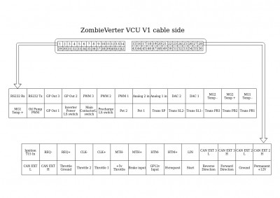

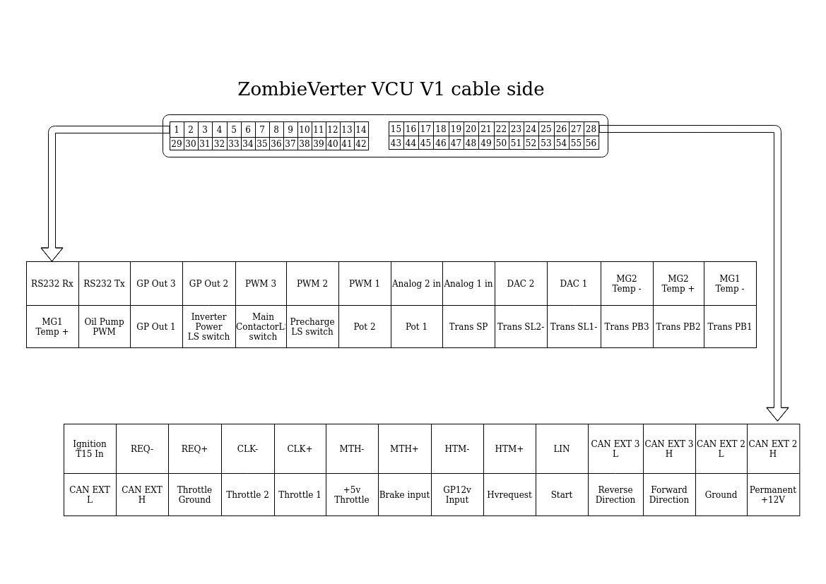

I've drawn the pinout from the table. It can be useful in the wiki.
It's how I connect serial lines to the VCU.

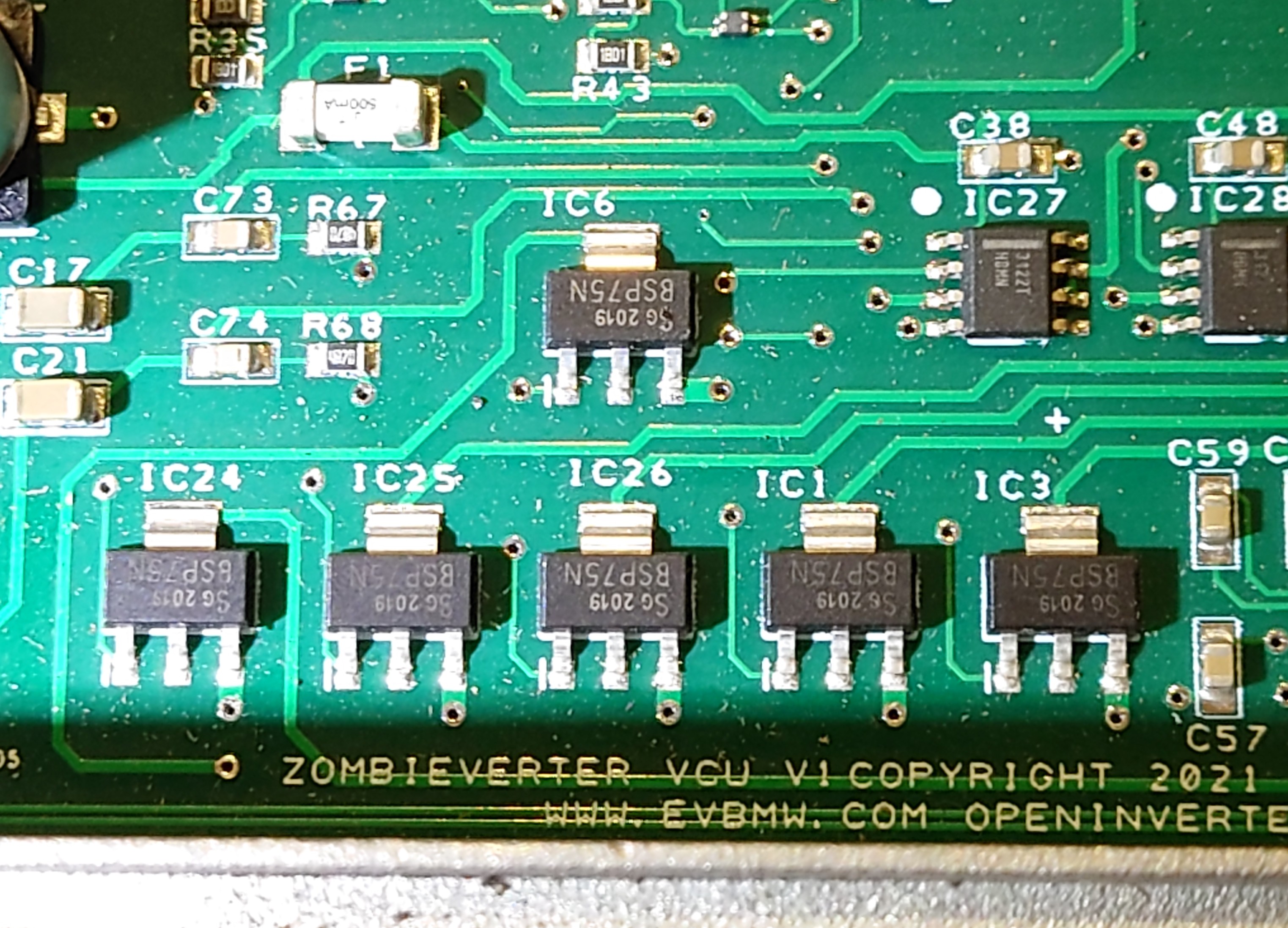

There is the same NCV8402 issue with ZombieVerter V1 boards.
So I'll buy and resolder them.
