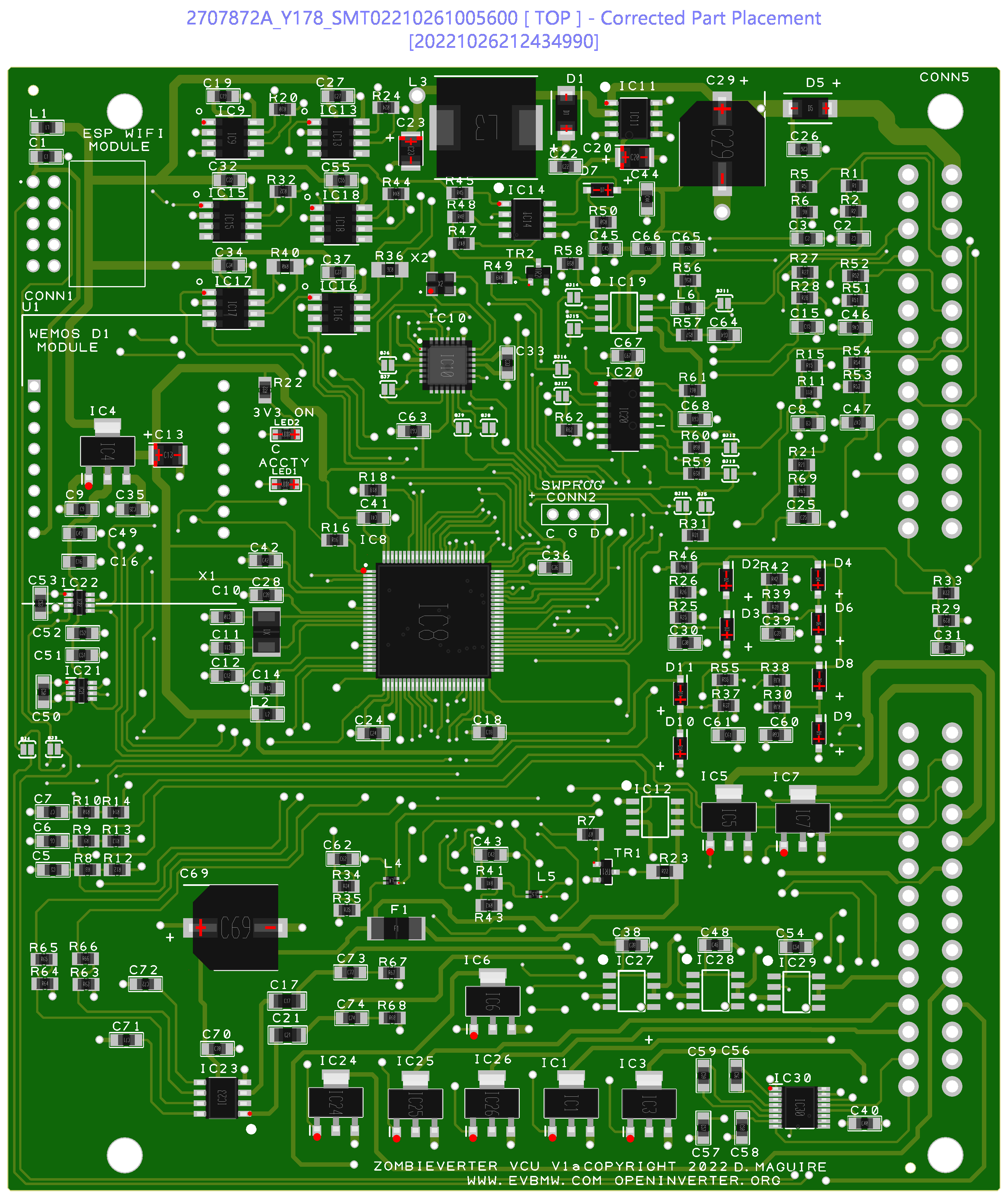

Re: ZombieVerter VCU Support
So new batch of VCU boards on the way from JLC. I have upreved the board to V1a to cover the following changes :
-Add footprint for Wemos D1 wifi module
-Move C71 and tracks to better clear mounting holes
-Remove I2C EEPROM and associated components as is unnecessary and just ads cost.
I'm also pleased to announce that as of this batch ALL parts will be included in the kits and the MCP25625 is now available from JLC for the first time since this chip shortage nonsense began.
Any suggestions for an unlucky individual that is trying to program a board with the GD chip? I'm sure in the end the answer will be... replace with an stm32, but due to the chip shortage here I am.
I am using an stlink programmer in win 10, passed power test with 12v but have solid "3v3 on' LED, no blinky "ACCTY" LED
I tried uploading the .hex that Damien shared in this thread for the GD chip (GD32F107VCT6), stlink utility shows program uploaded and device memory matching the .hex file
After much hair pulling, I was able to program a bare esp12f with the esp8266 web interface, so maybe I can try that after I get it connected to the zombie
That's awesome they finally got stock, I'll grab some THANKS!!
I still want to try and program the GD chip if it's at all worth it... it IS already soldered onto the board
I was going to try and clone the repo and make the edits listed in the wiki, but I got a permissions/password error when I tried cloning it from git.
STlink utility "fails successfully" showing the code uploaded, but the board only shows the 3v3 LED solid, and ACCTY LED unlit
I still have to try the OTA update, but I need to curl the file system files to the esp chip before I can attempt that
You need to flash the bootloader too...
Thanks... I just saw that re-reading through the wiki/forums! I was thrown off as I was able to just upload the .hex to my tesla charger board. STlink utility seemed to give the same success messages as well, adding to the confusion.
