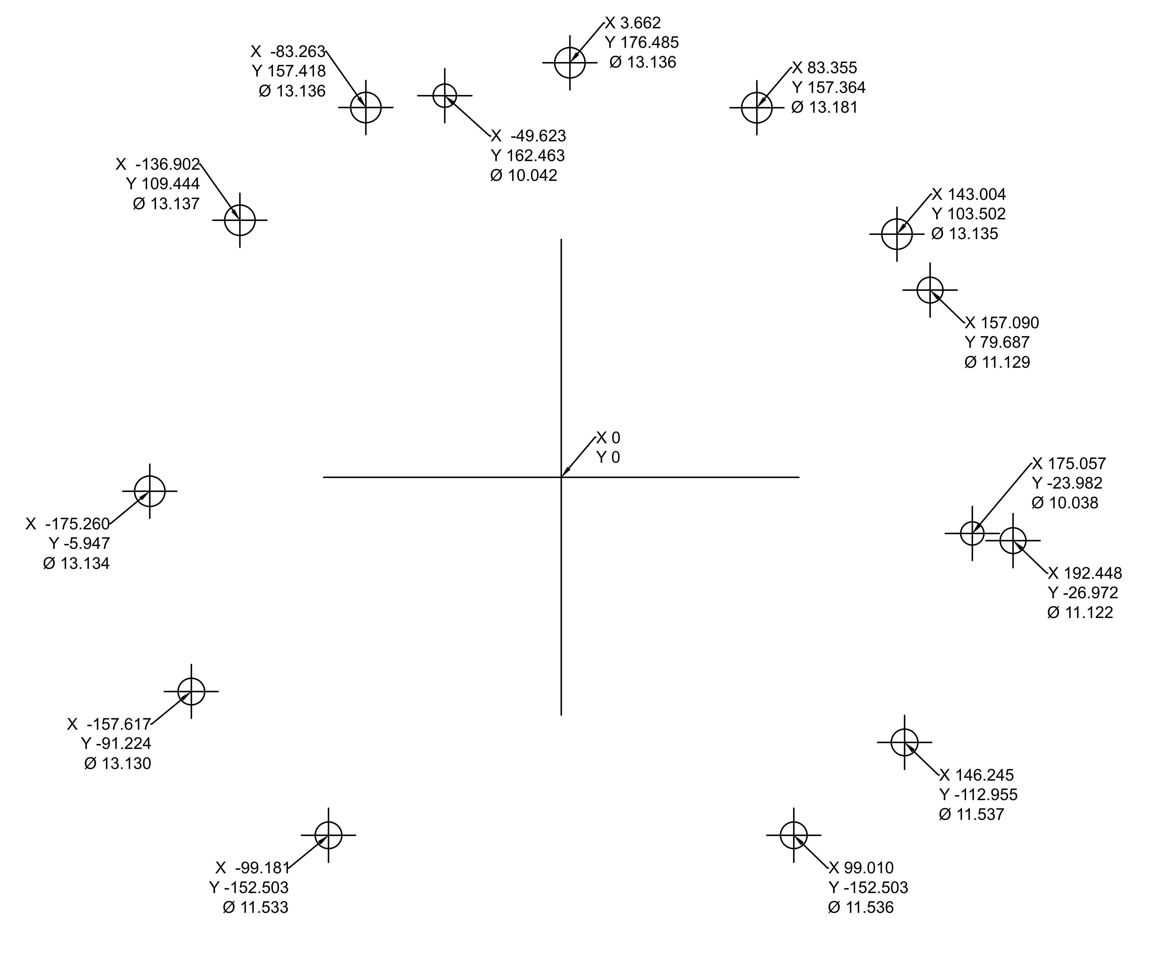

Mobert
Posts: 7
Joined: Wed Jun 03, 2020 6:11 pm
Location: Austria
Post by Mobert »
Today i measured the bellhousing bolt pattern.
For those who want to add a third mtor or want attach a ICE as Range Extender or want to use the transmission as e-CVT.
Accuracy should be within 0,02 mm.
Kevin Sharpe
Posts: 1339
Location: Ireland and US
Been thanked: 10 times
Post by Kevin Sharpe »
Mobert wrote: Wed Jun 03, 2020 6:53 pm Today i measured the bellhousing bolt pattern.
Fabulous, thank you :D
mdrobnak
Posts: 692
Post by mdrobnak »
Awesome! Thanks! Definitely will be useful for me.

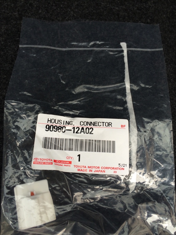

Posts: 4003
Been thanked: 1122 times
So the unobtanium inverter interface plug is actually available from Toyota. Just ordered two from my friendly main dealer parts dept. 8.34 Euros each. Will have them in next week. Toyota part number : 9098012A02

Posts: 442
Location: UK
Been thanked: 15 times
Post by xp677 »
That's great news. Do we have a part number on the pins, gaskets, etc as well, or are they included?

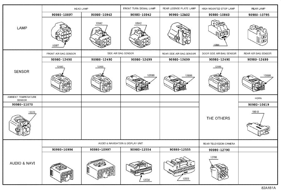

xp677 wrote: Thu Jun 04, 2020 11:48 am That's great news. Do we have a part number on the pins, gaskets, etc as well, or are they included?
Just to save Damien some time answering your question I tried entering the part number on www.toyota.com and that lead me to this info after a few seconds :)
Posts: 4003
Ok so bit of confusion here. Seems the part number we want is 90980-12630 according to this manual :
https://www.toyota-tech.eu/wire_harness_rm/RM06H0E.pdf
Page 127. Problem is my toyota parts guy says its an unknown number. The hunt continues ...
Posts: 4003
Slow progress. Toyota part number : 82998-12440 gives a 160mm long pre crimped wire with gasket to fit the plug. Is available from Toyota parts.

Post by xp677 »
Kevin Sharpe wrote: Thu Jun 04, 2020 12:11 pm Just to save Damien some time answering your question I tried entering the part number on www.toyota.com and that lead me to this info after a few seconds :)
This is very interesting, I did not know that you could search for parts on the Toyota website.
Jack Bauer wrote: Thu Jun 04, 2020 2:10 pm Slow progress. Toyota part number : 82998-12440 gives a 160mm long pre crimped wire with gasket to fit the plug. Is available from Toyota parts.
Also to note is that there are two sizes of pin used in this connector.
90980-12630 is discontinued, 90980-12A02 is available from Japan for approx £3.
Eflyers
Posts: 26
Joined: Thu Apr 11, 2019 4:08 pm
Location: NW USA
Post by Eflyers »
TFirenza wrote: Thu Jun 04, 2020 4:32 pm Is this the one? been searching with no luck atm
Imaged
In the USA, it looks like this is PN: G9260-47010 (check on the back of your plug for the PN). It might be available in the USA, at least, through Toyota dealers online parts departments, like this one: https://parts.lexusofpembrokepines.com/ ... g926047010
I've located plugs like this one as a repair part for an otherwise damaged and unusable $500-700USA(new price) wiring harness. They were not that common, but they were available. This plug may also fit the Gen 3 inverters used in the Prius C (USA), Yaris, and others.
