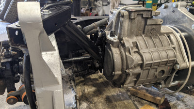

- Zombieverter: I was going to do a redesign of my VCU to fix some of the beginner mistakes I made. However it quickly started to look like a paired down clone of Zombie. So I might as well switch over properly. It also has native support for the rest of the work planned
- BMW Hybrid batteries: I'm going to swap the batteries out for a 12kWh BMW hybrid pack. They should be smaller, which I, am hoping will mean I can get my passenger seat back. Either placing them in the engine bay, fuel tank area or front tyre compartment, or a combination of some kind. It should still give me the range for the driving that I do. Currently I don't use any more than 8kWh on any one trip.
The kokam battery pack can then be used as a test battery pack for the tractor. BMW S box also frees up my contactor box for test bench purposes.
- QoL upgrades:
I would like to swap out my pedal input, currently using the TPS from the original ICE air intake, which is not amazing from a smoothness or safety perspective, as they are a single pot sensor and are known to fail open.
Might look at cabin heating.
I would like to redo the coolant loop.
Wiring Clean up

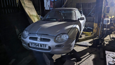

Re: [Driving/WIP] MG F - Outlander Rear motor and inverter.
Upgrades are pretty much done now. BMW hybrid battery sitting nicely in the front subframe, freeing up space in the cabin for a passenger seat yet again.
Zombieverter is in running everything, had to make a few additions to the charger module to run stand alone but it's working great now. I'll submit those changes to the main Zombie release once I've had a chance to test it a few times.
Didn't end up making much in the way of QoL upgrades, wiring is still a mess, still no heating, still using the original throttle sensor for now. But I did redo the coolant loop which has made a noticeable difference to charging temperatures at least.
Just need to pump up the suspension and then it's road worthy. MOT booked for the 18th November which gives me some time to tidy it up a bit.
Here is it looking a bit dirty again after four months in the barn.

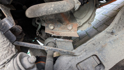

Re: [Driving] MG F - Outlander Rear motor and inverter.
Another MOT passed last week. A couple bits of work but nothing too major, a front wheel bearing and CV boot. It's covering allot of miles though so wear and tear is to be expected. It's been much more reliable than the backup ICE vehicle we have, which in the space of a few months and a few hundred miles broke down twice and caught fire once.
It's been great fun during the summer months, the addition of regen earlier in the year makes it really nice to drive and gives some pretty decent driving economy. Up to 4.5 miles per kWh on mixed roads.
Now the nights are dark again it's a bit less fun! The lack of heating is again noticeable, eventually I might reroute the coolant loop through the heater matrix. I'm not expecting hot but some luke warm air would be much appreciated in the cabin. Unfortunately a HV heater isn't an option as the battery capacity is needed for the range during the cold weather. Although this might be different with regen putting some energy and heat back into the pack this year.
There are some future upgrades planned, planning to go Foccci in every project now so there will be some CCS implementation on the way. Not planning on high speed CCS for this one though, just something a bit quicker than 3kW.

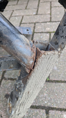

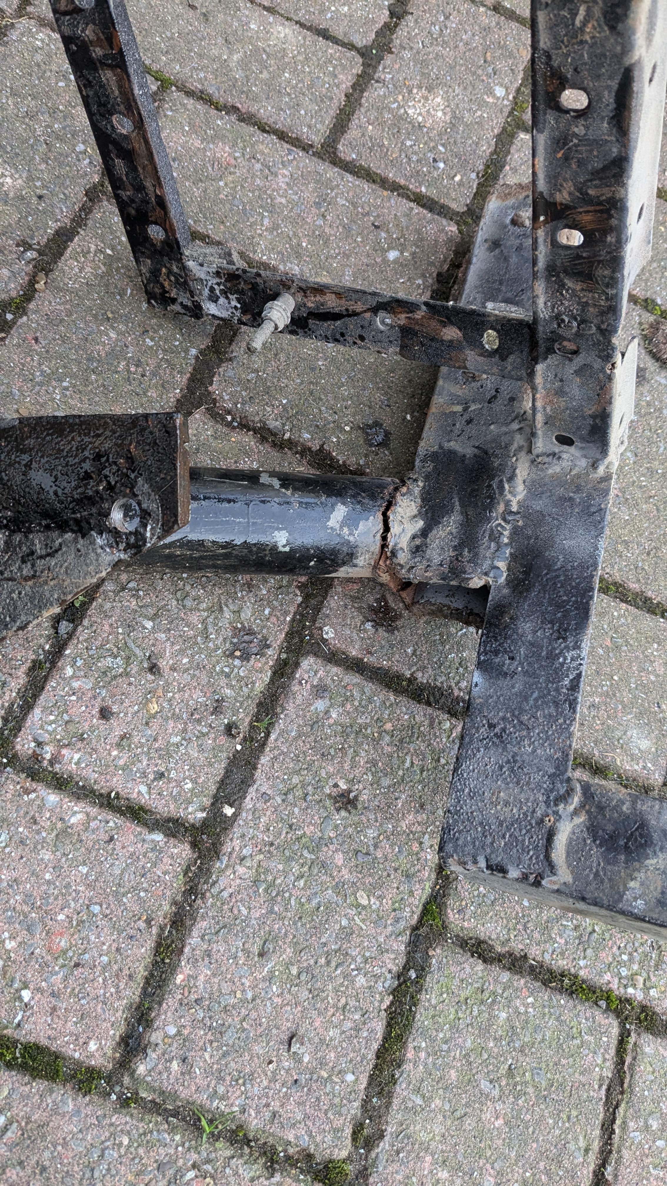

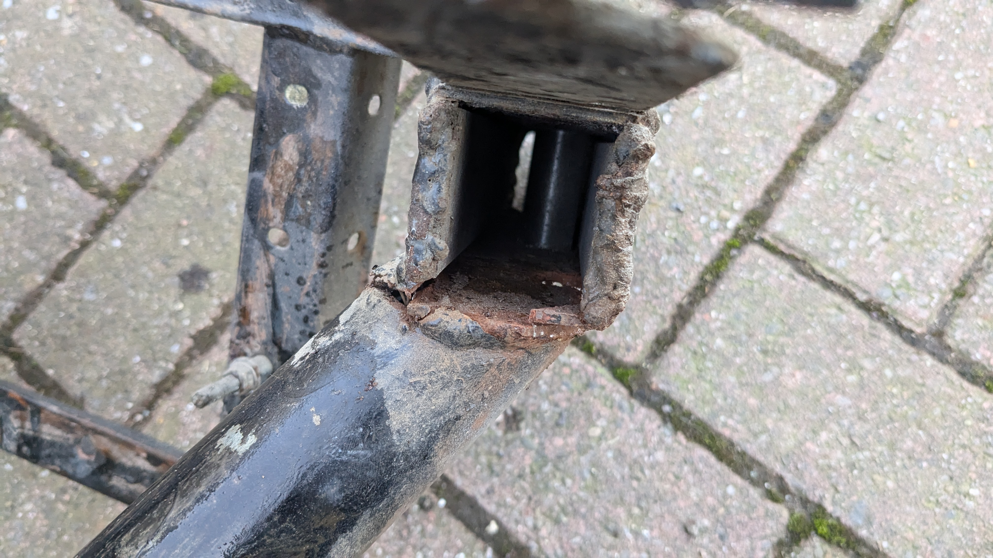

So I had to jinx it by saying how great everything was running. Driving home Monday evening there was vibration under acceleration. Closer to home that turned into a clunking noise on accelerating or regen. Upon inspection I found the motor torque rod had broken free, it was dark so I assumed my shoddy welding had given out. I had recently replaced the worn tie rod bush with a Polybush, given vibration wasn't an issue I figured the Polybush would be nice for a bit more durability. Although as much as I can try to blame the polybush, it was poor fabrication work that failed.
I switched off regen and nursed it home before the main mount failed and the motor fell out.
Managed to get some time to look at it today. Removing the wheel and side cover it was looking pretty obvious and maybe quite an easy fix. Just unbolt that bracket, weld it back up with some reinforcement and we are back on the road. However on that evening I was worried about how much the motor was rocking under load, especially with a hard mounting on that side. I was quite worried it would give out before I got home. So I took a look at main motor bracket on that side and saw some further weld failures.
For reference here is the bracket all nice and clean and new a couple years ago. Here it is now. I wasn't 100% happy with it at the time. Even less so now. I'll get it to the farm this weekend and clean it up, redo those welds and add a ton of reinforcements. I would ideally like to redesign the main mount from scratch, but I don't really want the car off the road for too long.

Even OEM's can "under engineer" engine/motor mounts.

Back on the road again today. Forgot to take any photos but I just cleaned up and redid the welds, then added a few more supports. Seems to be running well so far. Much less movement under load than I ever remember seeing, so I think these mounts were giving out for quite a long time.
I'll come back to this if I ever get around to mark 3. I have some rough ideas of using the MG ZS drive train, then potentially I can fit the batteries in the engine bay with an MG charger in the fuel tank area. Would be quite cool to EV an old MG with modern MG parts. In all likelihood I'm not sure I'll ever get around to this though. Maybe in another 10 years when I can fit 24kWh into a suitcase.
