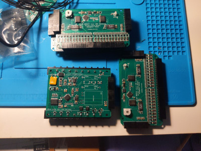

First batch of BMS12v3 arrived from JLCPCB today.
The missing parts should arrive this week also so they can be completed and tested/programmed next week.

Post by Dusty4 »
Hey prensel, how are you getting on making the bms boards? I'd be interested in buying some off you.

Dusty4 wrote: Fri Oct 22, 2021 12:32 pm Hey prensel, how are you getting on making the bms boards? I'd be interested in buying some off you.
Ready to go (almost) !
I have about 12 boards ready to be programmed.

Cool, I have ended up having a go myself, I have made the bms24s. I am hoping to test in the next few weeks. :)
