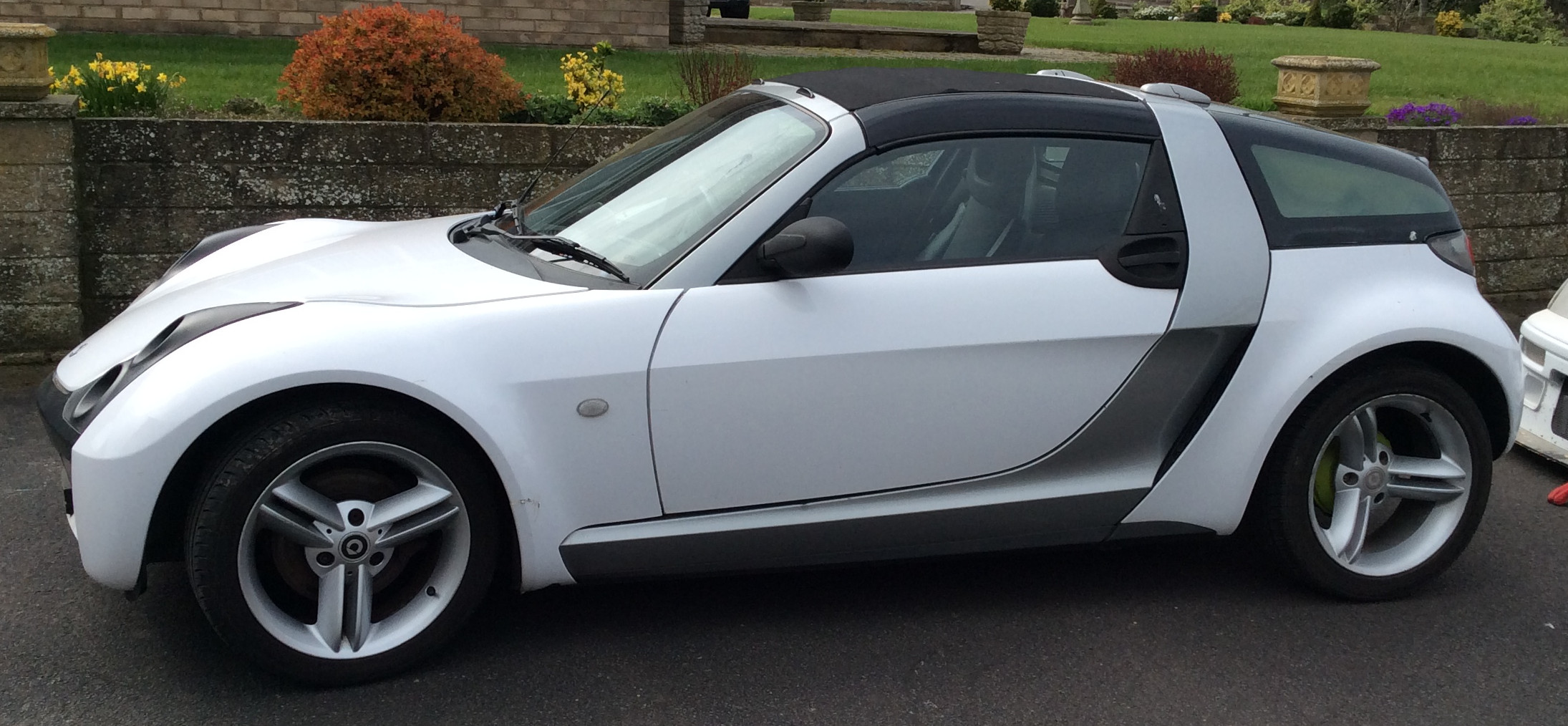

Hi, I'm new to this site, and new to the whole EV bit but have been reading though everything here and have been inspired to start an EV project of my own.
Over the years I seem to have moved from small fun cars to larger comfortable ones, and in the process lost a lot of the enjoyment in driving, so the plan is to get back into something small and light that is fun to drive. The search for a suitable car led me to a Smart Roadster, not something I had ever considered before but a but of research convinced me it could work. The main problem with the roadster seems to be the terrible gear change and weak engines which led me to think about an engine swap. A bit more research, finding this site and realising just how far DIY inverters and control software have come has convinced me to go electric.
So far I've got the car, it's a but tired and needs some work for the MOT but should form a good basis.

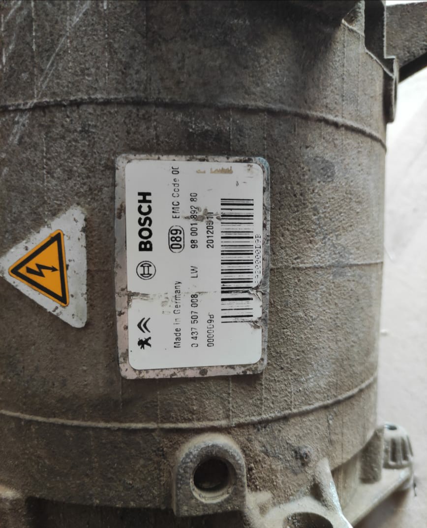

Why is no one using a gearbox from a Peugeot 3008 hybrid. Power declared 80kw built-in gearbox with differential

midway wrote: Tue Apr 05, 2022 6:32 am Why is no one using a gearbox from a Peugeot 3008 hybrid. Power declared 80kw built-in gearbox with differential
Dont confuse old 3008 and new 3008
Old smg180 motor is 27kw power the one you have in the pictures.
I dont have details of the new one right now. But when i considered it. it was axle rpm limited.
as in 10:1 ratio as an exampl and a top speed of 140-160km/h using a 19-20" wheel same as used in 508 pse where it then decouples.
Also 166nm torque i believe outlander can command 300nm for short periods.
So when you work out using smaller wheels the motor and gearbox was rpm limited. also the price of 3008 hybrid motors and 2 series are far more expensive along with also considering xc90 t8 rear axles or v60 d8.

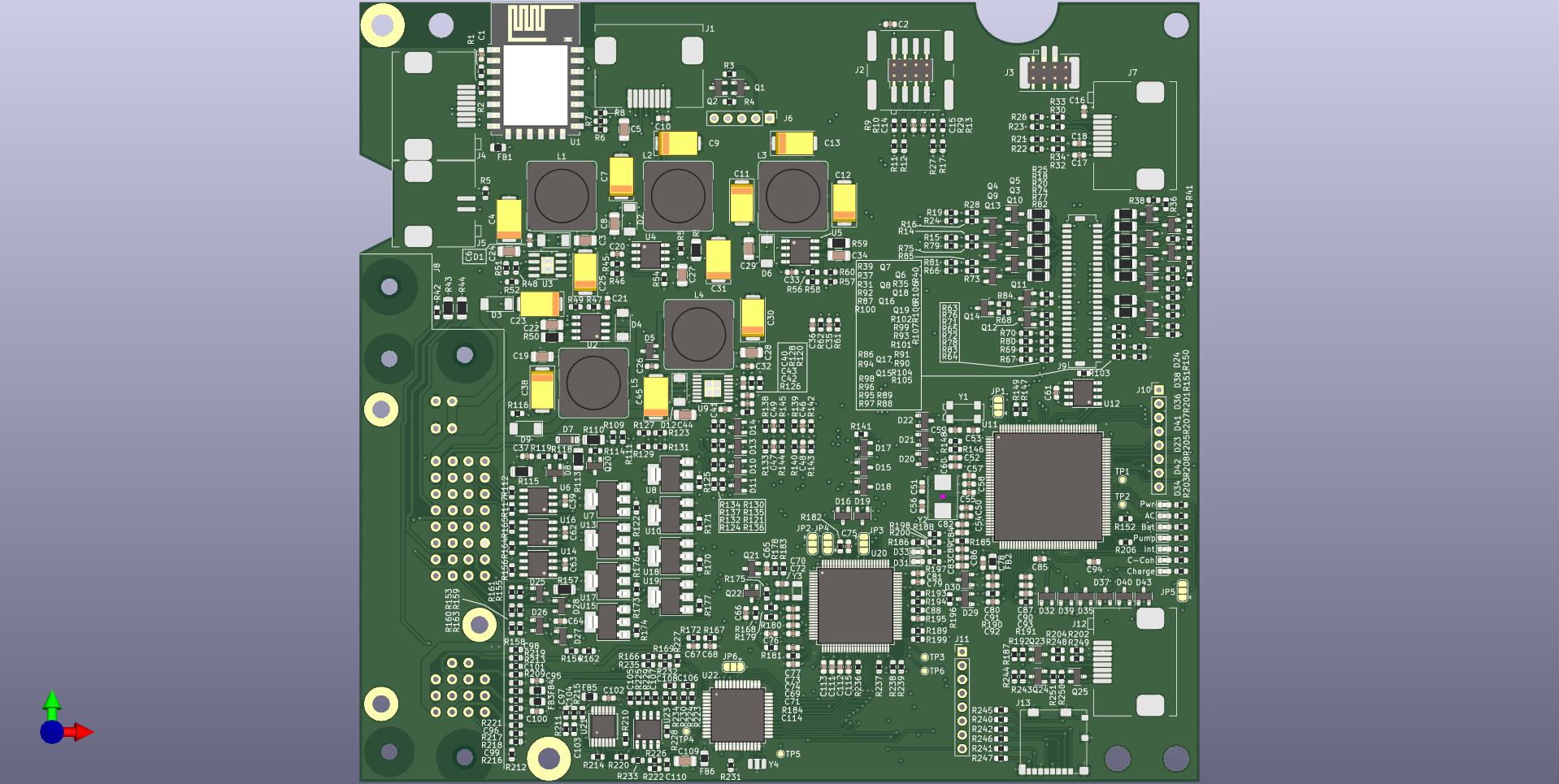

I still haven't decided on how many battery modules to use. The standard 6 BMW modules would be easiest but is a little limited in capacity. Increasing to 8 modules would get the range to where I want to be and improve performance/reduce battery current but is pushing the voltage limits of a few components (the contactors in particular). It also puts a lot of weight in the back of the car. I'm starting to think that a better compromise would be to start with a 6 module battery pack in the back where the engine used to be. The car can then be used like this to see how well it works. I'll also include an extra set of parallel battery connections so that a second pack could be fitted in the front in the future. The second pack would have a separate set of contactors within it so that they could be used/charged either in parallel or independently under control of a board I've been working on.
Below is the board:
The original plan was to go with Damien's dual controller board but I decided that I'd like to include a few custom features and tweak a few things (with hindsight I should have stuck with Damien's - I'd heavily underestimated how long it would take!). The main changes are:
1. It has a dedicated resolver to digital IC (recovered from the Toyota logic board) to read the motor position. I know this is probably unnecessary, but I'm more comfortable with it in terms of accuracy and noise immunity. I'm just hoping I've got the circuit right as otherwise I'm going to feel a but stupid (as the board doesn't have support for the ADC based resolver solution)
2. I've tweaked a couple of the timer lines on the F103 and I'm hoping to use the spare channel on the main PWM timer to trigger simultaneous bursts of injected ADC conversions for the two motor phase currents and also trigger the sampling of the resolver data. This should give synchronised data for the motor current and motor position.
3. It uses the 100pin version of the STM32F103 to drive MG2, partly because I found one left over from a previous project but also because it allows a faster parallel interface to the resolver IC and adds an extra ADC which gives a little more flexibility in software. The board should also support the STM32F405 chip if needed in the future.
4. MG1, the DC/DC, charger interface and all comms are handled by a STM32L496. The STM32L series are very low power devices and the intention is for this section of the board to be permanently powered. This chip is connected to a 10Mbit RS485 port and a SD card which will be used for high speed data logging - ideally logging all the motor data on every pass though the control loop (so that if anything misbehaves it should be possible to figure out exactly what's going on).
5. The F103 (MG2 motor control) is held in reset if the ignition isn't on.
5. The L496 has no resolver or encoder input so won't be able to control a motor. Instead it will use the 3 HV bridges to supply HV loads (AC compressor, cabin heater and possibly a battery heater). This processor also has an input for an isolated current input (charger input current) and an isolated 4-channel ADC (for measuring the MG1 HV output voltages).
6. There are two CAN ports. One goes to both the L496 and the F103 while the second only goes to the L496. The port on the L496 will be permanently powered and the intention is to dedicate it to the BMS.
7. Moved to an ESP12F WiFi module to save a bit of space and improve robustness. It's shared between the two processors and has an on board programming port.
8. It still uses the Toyota connector. Two reasons, I liked the separate dedicated sub-connector is has for the resolver connections and it has more pins than the ampseal alternative. The ampseal would have 34 pins, as standard the Toyota has 40 pins and I'm hoping that I can increase this to 50 by adding extra ways to the unpopulated positions. Should still be OK if I can't but the extra ways would provide extra grounds and a few extra spare inputs/outputs which would be nice.
The schematic still needs a thorough check over and the board a full design rule check but hopefully it will be going out to manufacture sometime in the next week or two. If anyone fancies having a look though the schematics for problems let me know and I'll put them up.

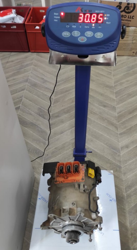

Look what arrived this morning :D

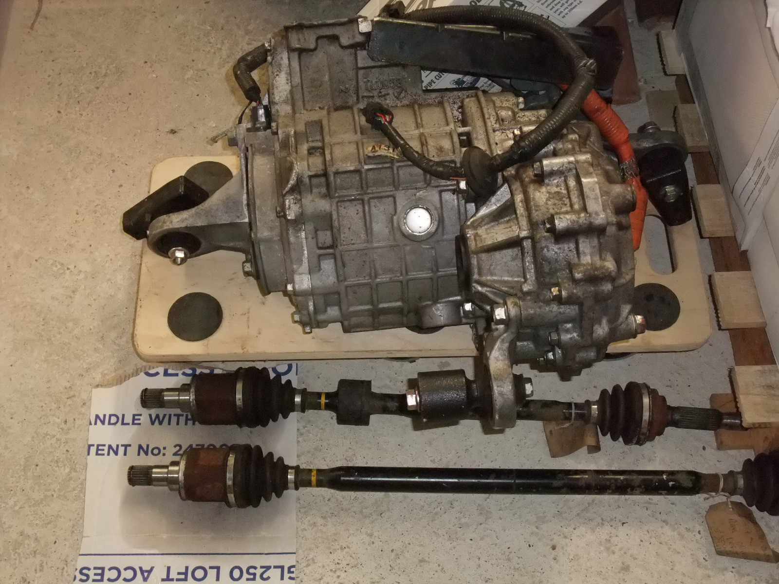

Hadn't been planning on buying the motor yet but one came up at a reasonable price complete with the mounts and the HV and LV cable tails. The place selling it also had the driveshafts so was able to do a deal on combined delivery.
Probably a bit late to be asking this question given that I've now bought the driveshafts but - is there any real benefit to keeping the original manual gearbox and mating the Outlander motor to it?
The Plan had been to use the Outlander reduction box but now looking at it using the Smart box would put the motor lower down and in front of the rear axle - exactly where I would like it positioned from a weight balance and handling point of view. It would also allow the gear ratio to be tweeked to find the best compromise (or compromises, sport and economy modes?) Downside is the added complexity of the motor to gearbox adaptor and the extra weight of the gearbox (say an extra 20kg). I have a reasonably well kitted out workshop so can handle the engineering side of either option.
What I don't want to do is complete the conversion and then find the car feels a bit sluggish at some speeds, is this likely to be an issue or am I overthinking it? I do have the option of running the motor at a higher voltage than standard which might help here?
What I'm really after here is views from anyone that has a relatively light car running the Outlander rear motor/box on how the package performs and what kind of acceleration is seen, particularly at say 40-60mph. Also interested in thoughts from people with gearboxes on their cars, do you ever change gear or does it always get left in the same one?

Dont forget the Outlander sums were made with OEM battery which is really the limiting factor for the motor-inverter combo. I suspect you will be able to get more torque out of the motor than OEM.
Now that i tried the leaf gearbox with my Pug i will never go the transmission route again. Transmission is noisy, it is worn out or has other issues.
By far the only factor when choosing transmission over OEM gearbox are the driveshafts. Some people are afraid to cut/splice the driveshafts and with good reason.
But if one has a good machine shop available than this is not a problem.

I've not done driveshafts before and modding them does worry me so I'm likely to outsource them. On the other hand I've outsourced a prop shaft in the past and not been happy with what came back! I can handle all the bits involved in a gearbox adaptor myself but it would take more time.
Still considering battery options. Really need to corner weight the car to see how much weight can be added on each axle before making any decisions on pack sizes. I'm also wondering how high it is safe to go with battery voltage. I'd like to go to a 128cell pack, but would only charge to 90%, giving 500V. Is that too high? Either way I should be able to get to 90kW.
How does an electric motor feel when it starts to go into field weakening, how noticeable is it?
