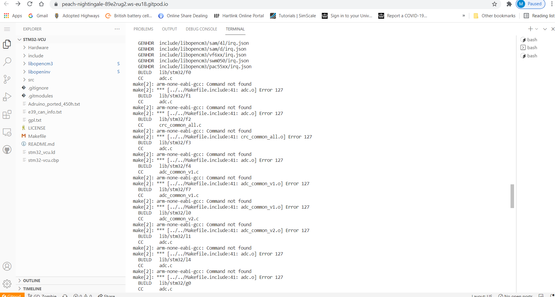

Hello again, well I managed to install Ubuntu but couldn't even get away from the command prompt Doh! The gitpod seemed to work for me after a bit of mucking around I seem to have complied and downloaded a bin from Johu's git. so I installed the gitpod extension and tried on Damien's - once I'd eventually worked out how to get a terminal I tried "make get-deps" but it only got so far before coming back with the error "arm-none-eabi-gcc: Command not found" I think I've installed the arm-non-eabi-gcc toolkit on my machine but perhaps not or does it need to be included with the git? Sorry for all the silly questions and thanks for your patience.
- Been thanked: 1914 times
Re: ZombieVerter VCU Support
you need to add .gitpod.yml to the repository. I might do so later.
File added to master branch
Thank you Johu, can I just copy and paste these to the GD-zombie branch or is it a bit more complicated than that?
- Uppertown
- Posts: 73
- Has thanked: 174 times
- Been thanked: 36 times
Had a bit of a play this evening and I seem to be able to create a Bin in Master via Gitpod

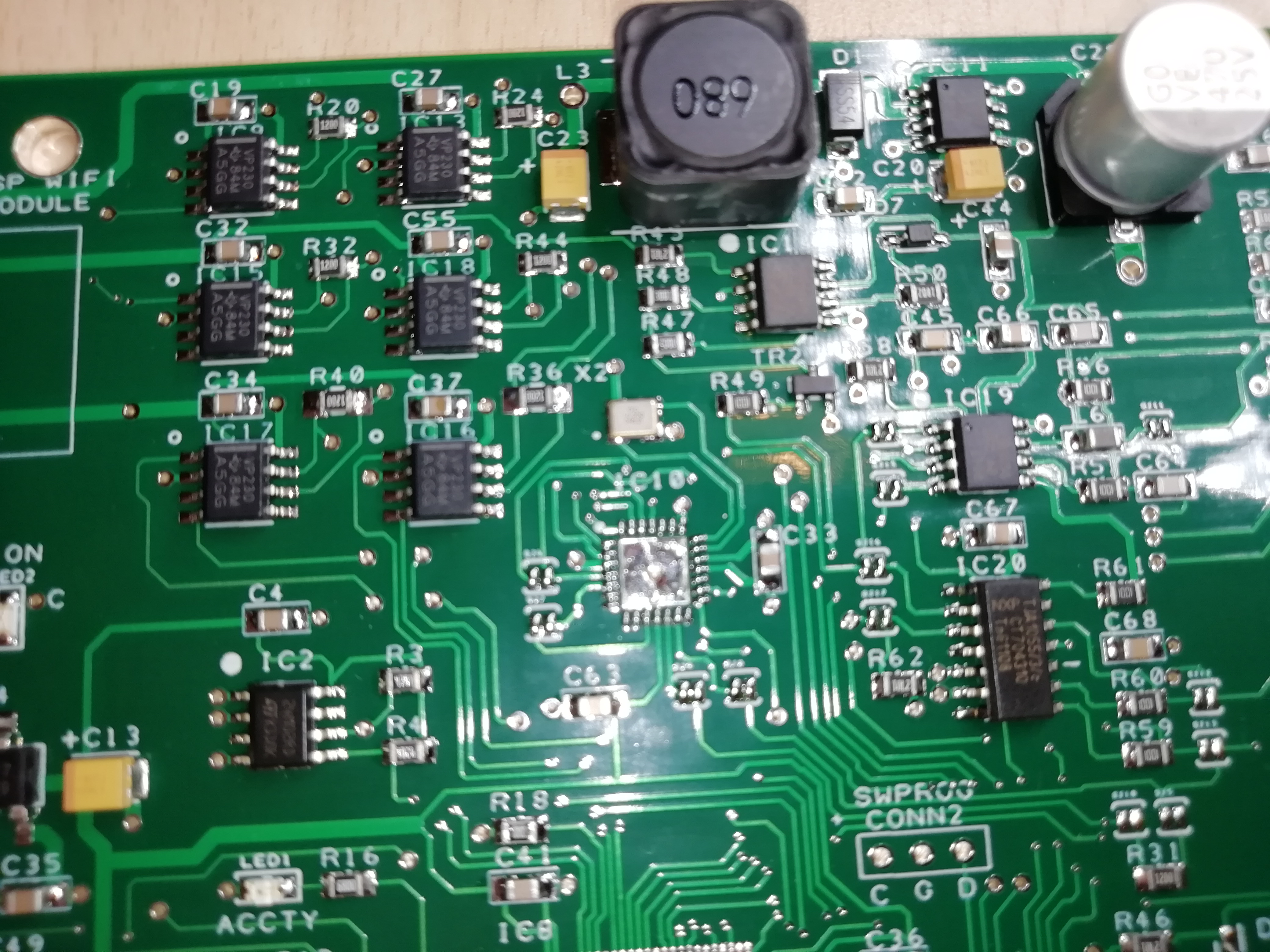

I am about to assemble the zombieverter board and I have trouble finding out which chip goes where.
I have:
3 x 3122C HAJA
1 x TJA 1055 /3/c NXP 5120006B TnG2122
1 x V7356 PUGB
1 x 2004AE SN 141 8PT
1 x MCP25625 E/ML 212296E
2 x 600
but no idea where they go / to which IC number they correspond
I hope someone can help me out here

I found that IC10 = MCP25625 and IC20 = TJA 1055
IC22 and IC21 are clear, they are the two very small ICs with 600 on them
The 3 x 3122C could be IC27, 28 and 29
Not sure where the other ICs go

I manage to find out the IC14 and IC19
IC14 looks like it is the 2004AE SN 141 8PT
IC19 looks like V7356 PUGB
I hope this is correct

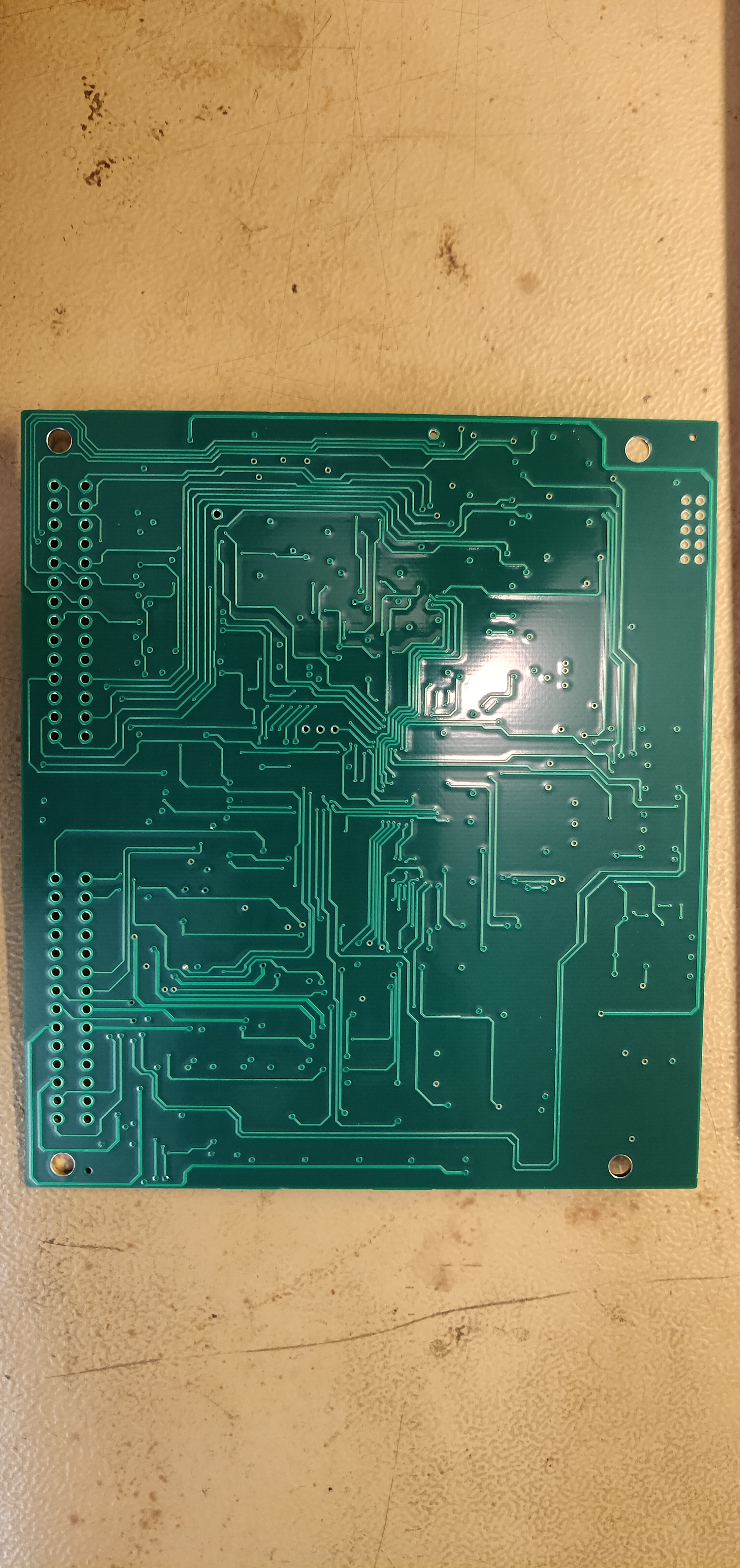

I've had my ZombieVerter sitting on the shelf for a couple of weeks, but now I got around to start working on it.
I see in Damien's assembly tutorial video that the bottom pads of the connector are clear of solder mask. However, the board I got has the mask extending over the pads. The top side is totally fine with pads clear of mask, but unfortunately there is no way to solder the connector on from the top side.
I am guessing there are other boards out there from the same batch. If so, let me know how you managed to solder that main connector on.
I have this same issue.
IC14 should be TJA1020, but what I have has got the same markings as stated above.
I cannot find anywhere the information whether this really is the correct part. Maybe some kind of second source?
Google picture search suggests that a legit TJA1020 actually has TJA1020 written on top of the chip.
In the mean time, I guess it's time to tackle the IC10 "reflow" soldering process.
Edit: Okay. I actually noticed that the Wiki page lists a second source for IC14 which is the MCP2004. I am going to assume that this is the part, so everything fine.
I also managed to solder the IC10, so everything fine in that department also!

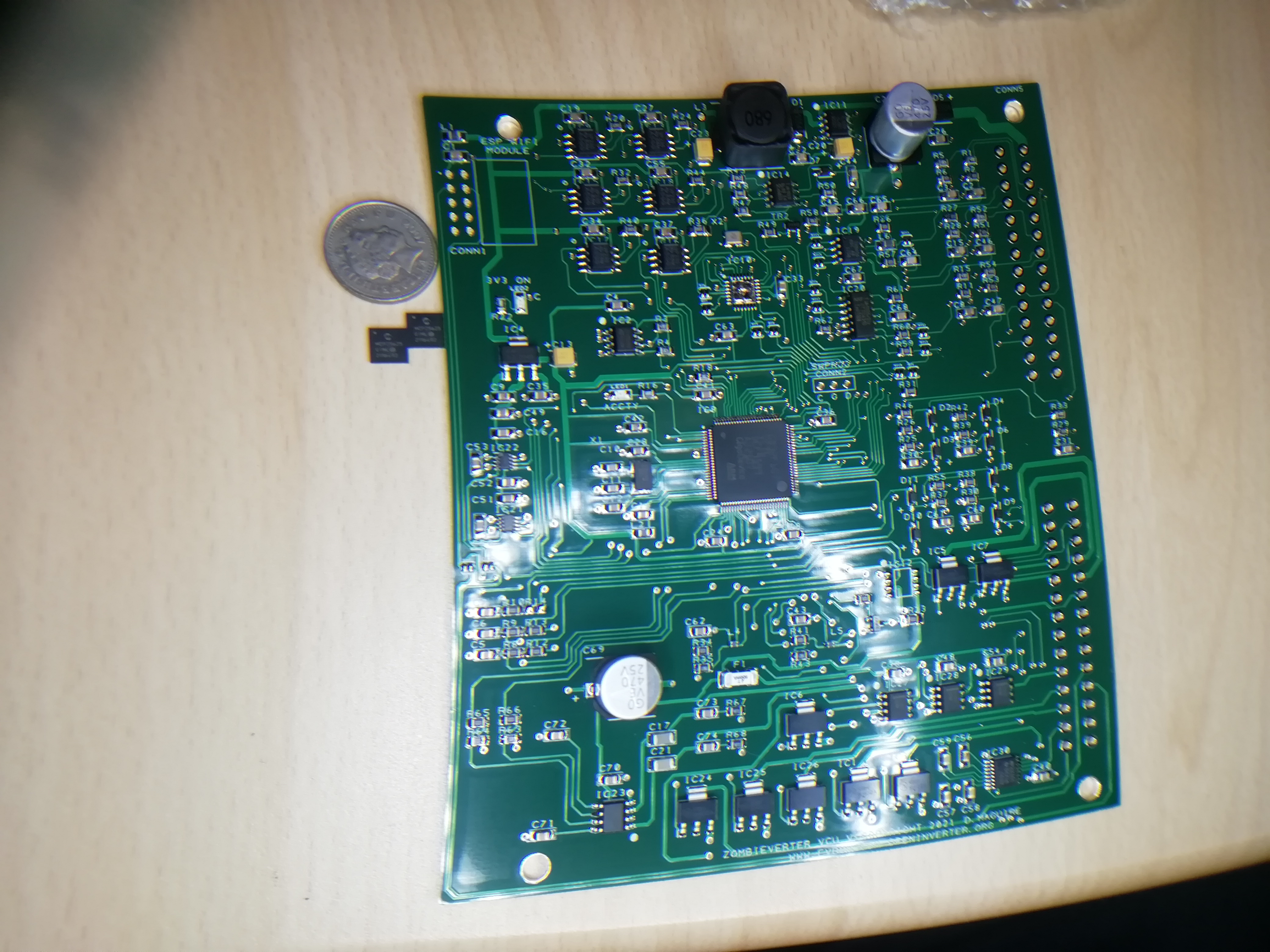

ok, here we go... I installed the ICs and connected the board up to 12 volts power. However nothing happens, no LEDs flashing or anything.
How can I tell if it is working? I measured the voltage coming in to D5 and IC11, but after that no measurable voltages coming out of IC11.
Anybody had the same issue or is just my board or ways how I connected it up?
What is the maximum voltage for input?
Check voltage on L3. Should be 5V there, if not, check resistance to ground on L3. Did You correctly soldered D1 and D5?
Hi Deeamon,
No voltage on pin 2 of the XL1509 IC11, nor on L3.
The diodes where pre-assembled when I received the board.
What is the best way to check polarity of the diodes?
... with the diode function of a multimeter.PaulHeystee wrote: ↑Sun Nov 21, 2021 3:13 pm Hi Deeamon,
