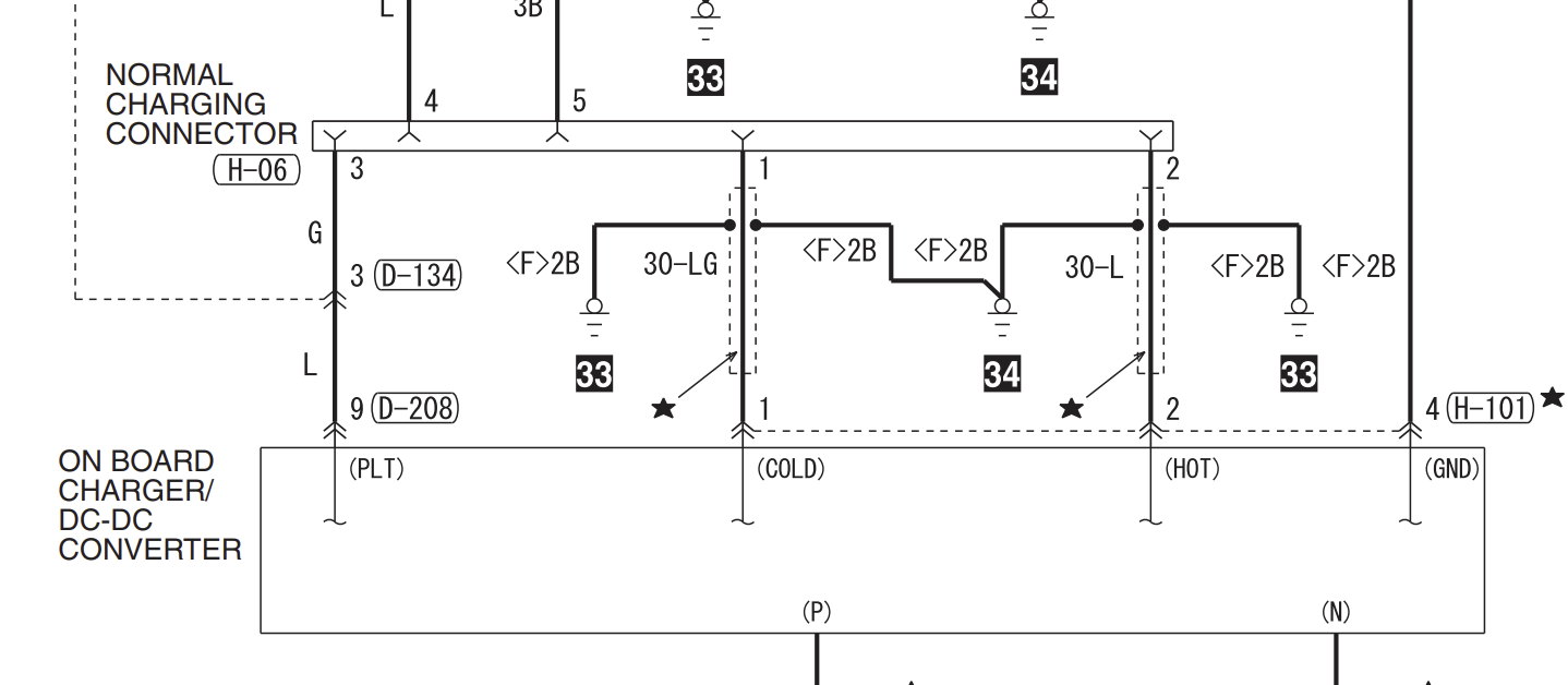

Well Outlander charger is very specific about start protocol.
1. you need to provide 12v on charger input LV signal pins
2. you can start sending both CAN telegrams 2
3. when you show 12V pwm CP signal of say 25% duty it will pull it down to 6V
4. now when that happens charger will expect AC to show on input AND pull its AC relay in
otherwise it will ignore AC input. What you need is circuit like open EVSE t regulate your AC protocol from the wall side.
1.Plus connected to pin 8 IGCT main power
Minus connected to pin 11 GND
2. Both tested wirh my ecu and an arduino.
3. Did see a 27% signal in can message i think. But i maybe need to measure with scope.
So when it apears 6v on cp the EVSE cable should enable ac output from cable.
This stage is not happening i Think.
4. Have looked at open evse solution but i bought a prebuilt cable wirh 16A Cee connector.

I have seen DCDC work with 14.4V in Mazda and 15.2Vdc in my Pug. No idea why.
Your cable is quite adequate, as long as there are PP and CP signals present. I use PP signal to start CAN bus flow. Did you by chance swap PP and CP pins? PP pin is the longer of the two because it needs to signal state change before/after CP is active.
The way i see step 4 to happen would be to connect AC directly and use a PWM signal 12V with 25% duty while CAN bus is broadcasting 2 IDs! I think you are missing something here...
msg ID 0x285 data 00 00 B6 00 00 00 00 00 every 100ms
B6 is charger enable request to pull CP in
msg ID 0x286 data 28 0F 78 37 00 00 0A 00 every 800ms or so
28 0F is voltage request 390V
78 is current request
37 and 0A i am not quite sure what they do
Since 0x286 does nothing to control output voltage (strangely because it needs voltage request quite explicitely) i used ID 0x396 to snoop for votlage and reduce charger after 390Vdc. BMS input is used to stop charger with 0x285 msg.

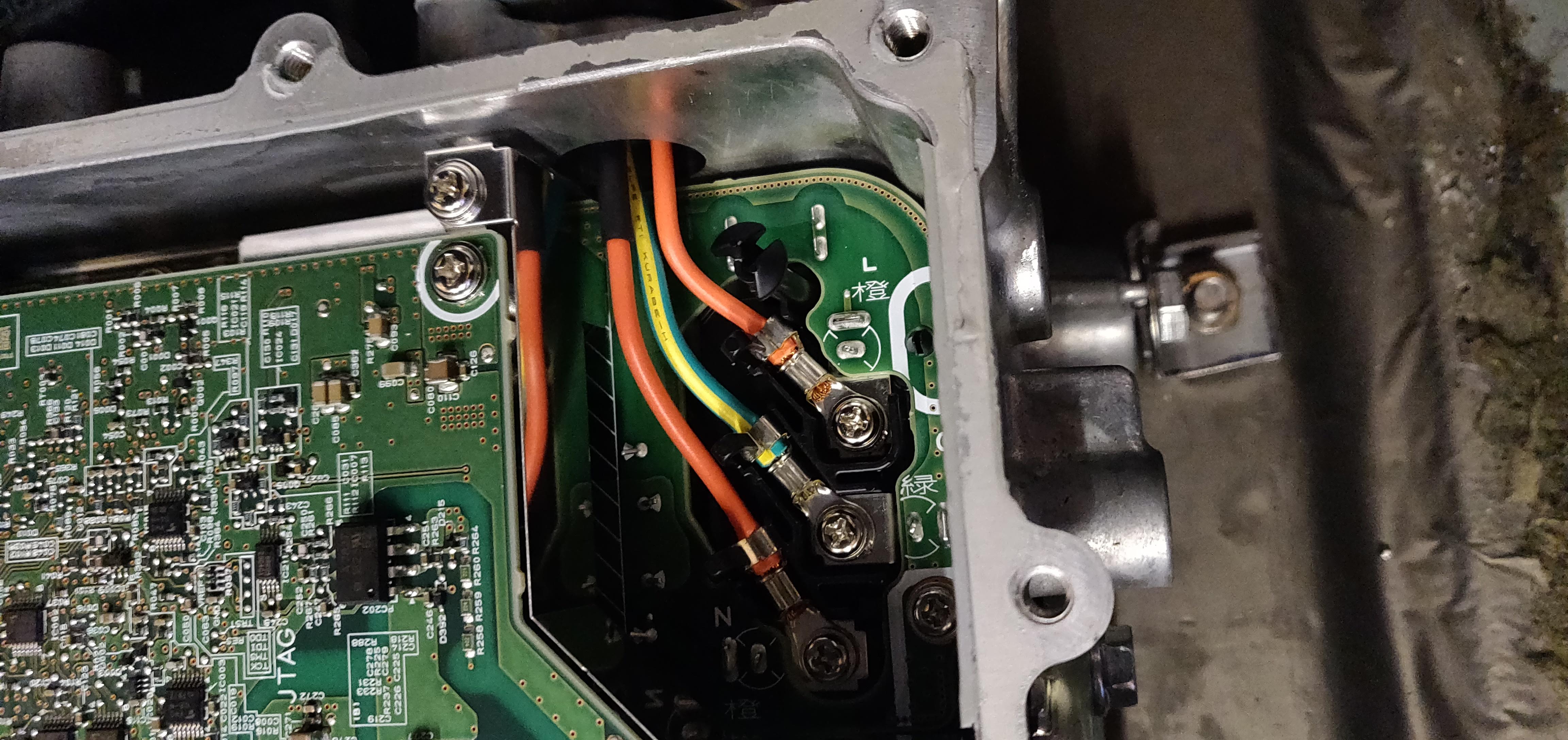

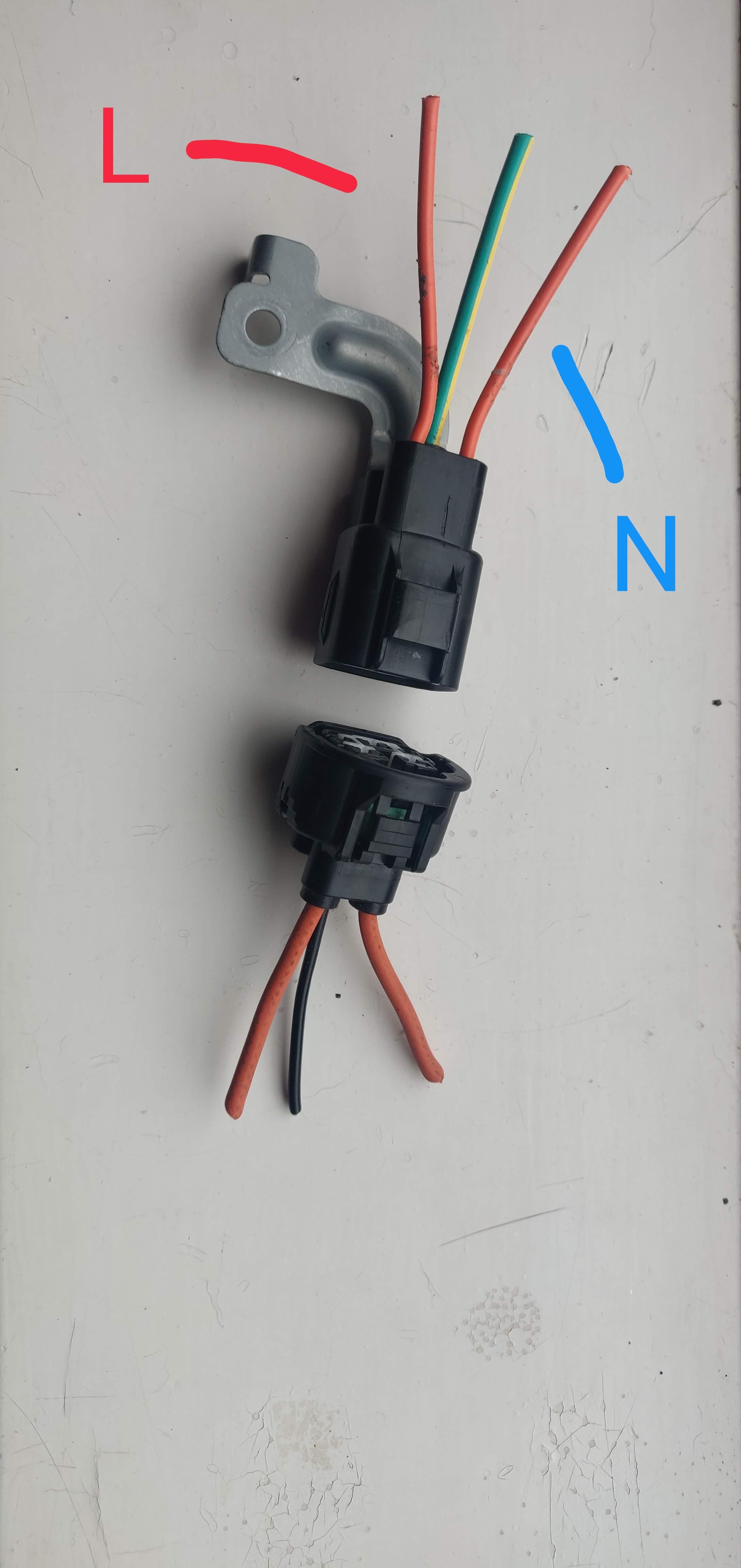

Can anyone confirm which way round neutral/live is on the AC input plug? Thanks!

cloudy wrote: Wed May 25, 2022 12:06 pm Can anyone confirm which way round neutral/live is on the AC input plug? Thanks!
it does not matter

Whilst it might work, it's generally a good idea to follow the markings. The neutral is usually at ground potential, so swapping them over might affect safety protections. The PCB is marked with N/L, its just not clear without opening it up and tracing which is which as the wires are both orange.

Ah - understand your question better now. I traced it with a spare Type 1 charger cable which had the sides labelled. Can't remember which way around it is now but will try to trace when I finally get back to the workshop.

From the service manual pin 1 is cold - (neutral) and pin 2 is hot (live / phase) Both are helpfully coloured orange with no other trace:
They are clearly labelled on the inside of the charger though:
The OEM plug should look like this, personally I swapped this for a different mains connector (powerCOn true1):

Thankyou! That's fantastic :)
