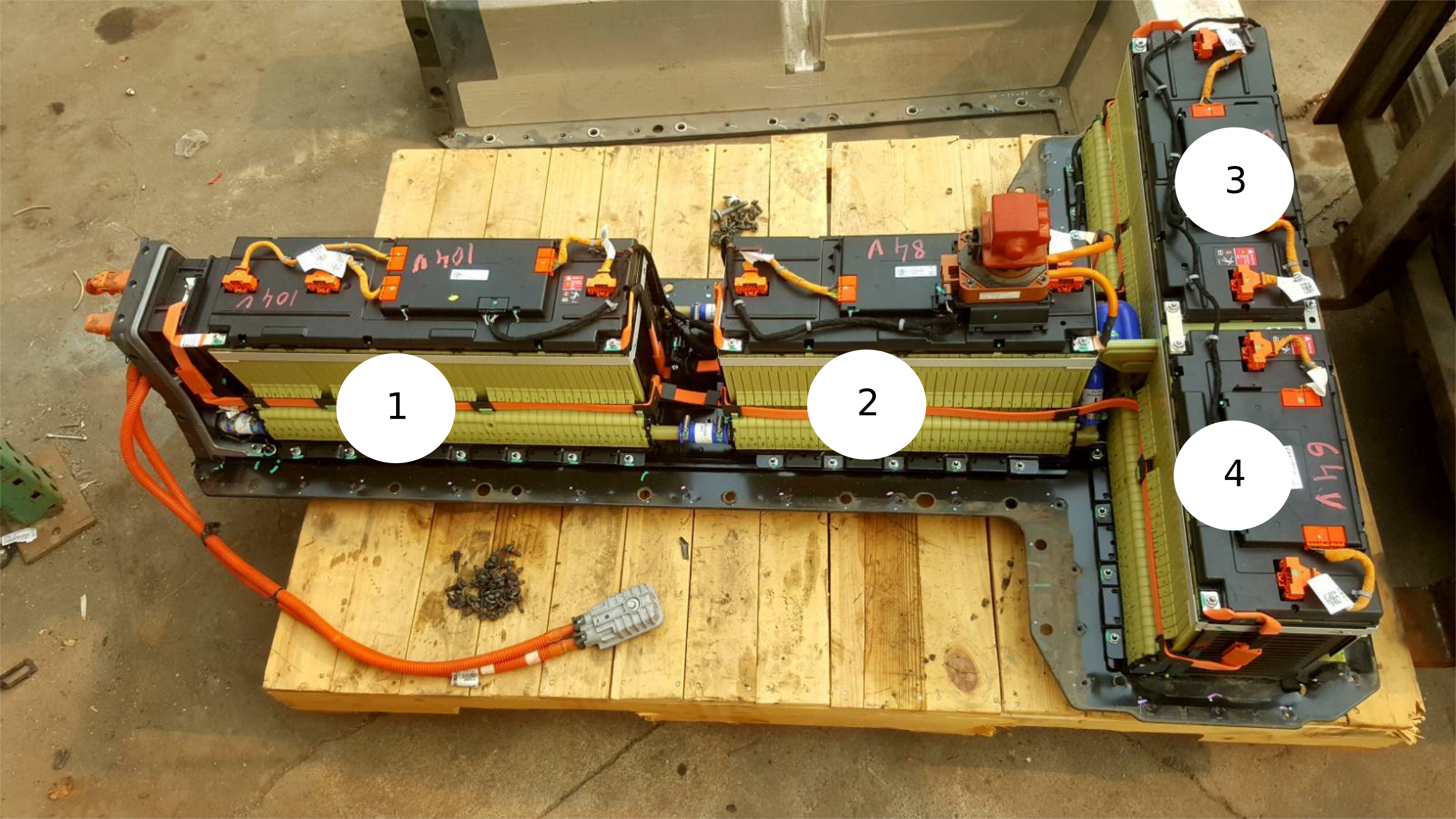

Did this and had some strange results. Still not quite sure which one would be defective...
Per the attached image, when I disconnected pack 1, I got the following

pack 2

pack 3

pack 4

Pack 3 as it only shows 8 cells but the module is monitoring more.

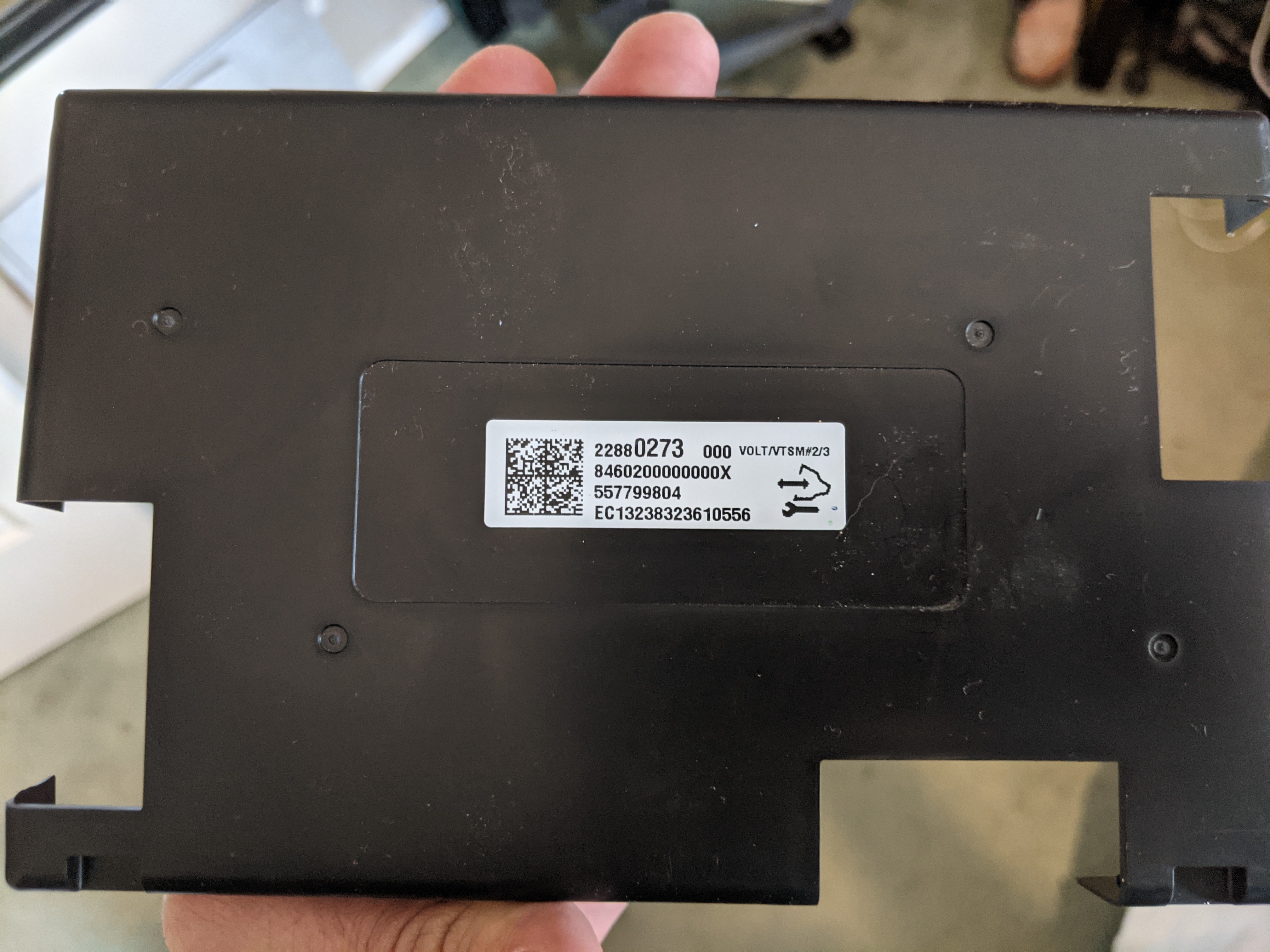

Nice! Now the question is how to fix it? I suppose I could try finding a
bms slave somewhere? I found one on ebay, but its part number is 22911432 and mine is 22880273. I highly doubt it's a good idea to mix and match like that...
I suspect opening up that
BMS to see if anything is obviously broken is also a lost cause.

Mind doing the following, unplug the HV sense wires one at a time till you find one that causes no change.

Thanks Tom. I did this, and although there wasn't a connection that had no change, pack 2 did drop out module 6, which is the one we were looking for. I pulled out that
bms , opened it up, and, well, I think the attachment speaks for itself. Note that this is the one that I mentioned that had the water stain on it.
Anyone out there have a replacement?
