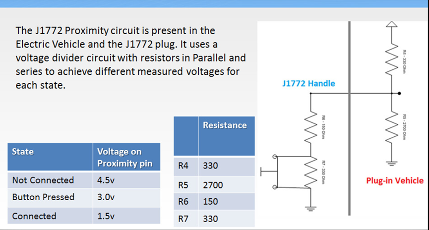

Looking at the wikipedia page I used to implement J1772
https://en.wikipedia.org/wiki/SAE_J1772
https://en.wikipedia.org/wiki/SAE_J1772 ... ircuit.svg
Only the car is looking at the PP signal, though maybe some untethered EVSE's might also look at it to adjust the PWM accordingly?
Does the socket have any resistance between PP and PE?

Do you have a type one port to check if it has a pull down?

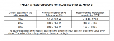

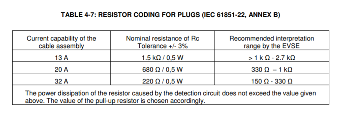

Type one reference found online. Type 2 cable plug resistances What you need to do is spoof the resistances so it ends up matching the type 1 values.

Type 1: 120Ω = connected, 480Ω = disconnect switch pressed
Type 2: 220Ω = 32A cable, 680Ω = 16A cable
So I'd have to consider a circuit like this to spoof a 120 ohm load when any EVSE is connected. The charger is represented by +5v and the EVSE is represented by the 680Ω resistor.
