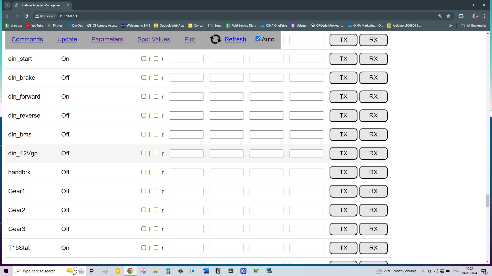

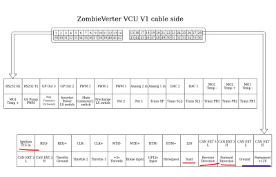

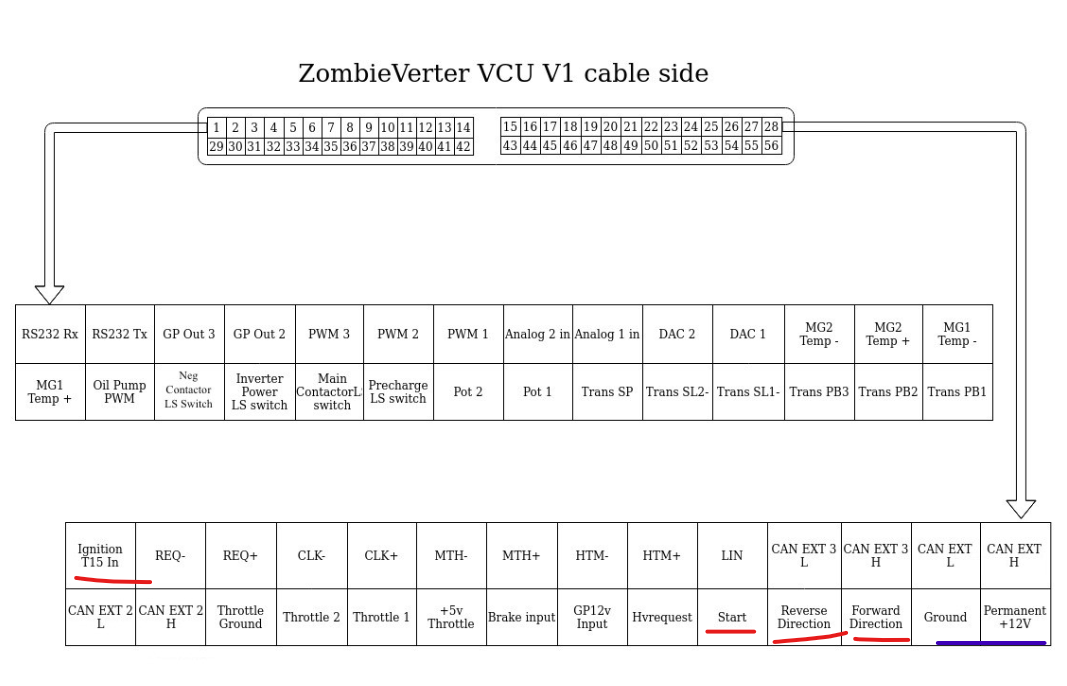

I am testing Zombieverter VCU and I am having problems with VCU not switching into the Run mode. I currently have only Ignition on connected on Pin 15 Forward and reverse on Pins 53 and 54 and start on pin 52.
I can see that all abovementioned buttons are registered as dinstart and dinforward etc.

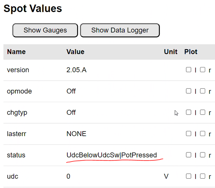

I have found a screen recording when I did testing And can confirm that status was set as below

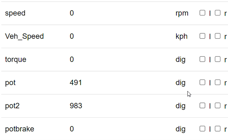

and throttle reading when not pressed as below
Could this be the reason for not going into the run mode?

Yes, as already explained in at least three posts above. You are not meeting two of the three conditions that must be met to go into run mode, as indicated by "status". Set udcsw to 0 and potmin to 500 ( i.e. >491 ) and it should work.

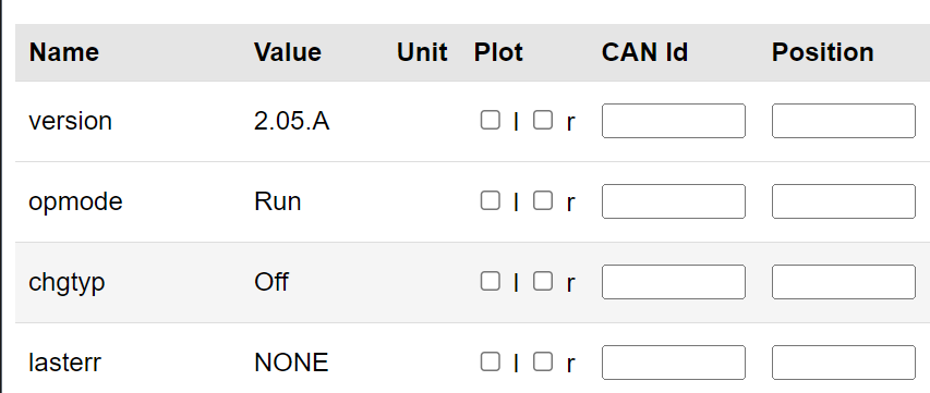

royhen99 wrote: Thu May 02, 2024 2:37 pm Yes, as already explained in at least three posts above. You are not meeting two of the three conditions that must be met to go into run mode, as indicated by "status". Set udcsw to 0 and potmin to 500 ( i.e. >491 ) and it should work.
Sorry royhen99 you were absolutely right the issue was because I had potmin set to 300. And of course as I had throttle connected it was reading around 500. I set potmin to 600 and it went straight into the Run mode. I had udcsw set to 0 previously so this was not a problem.
