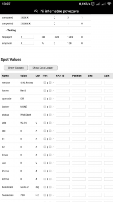

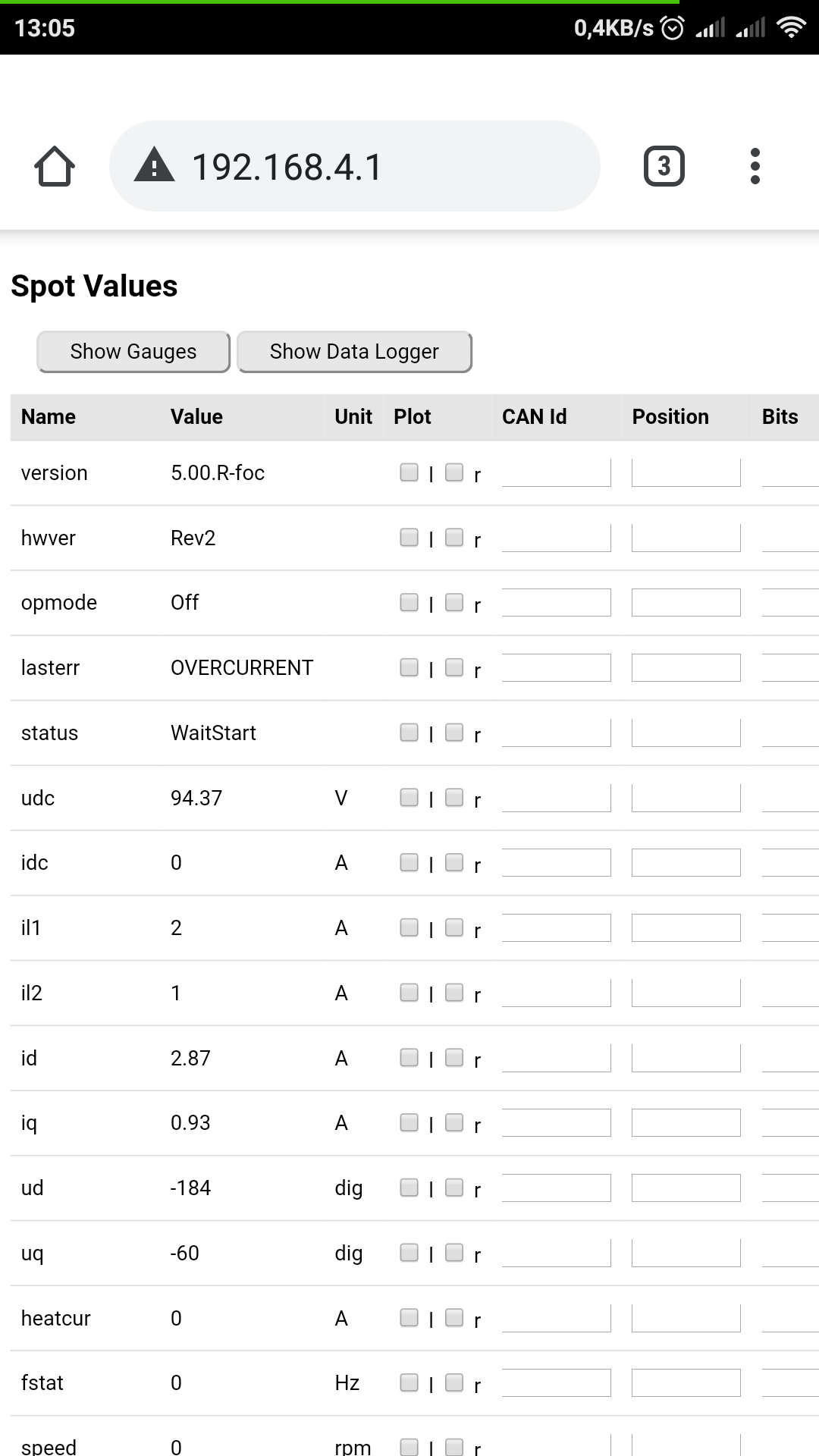

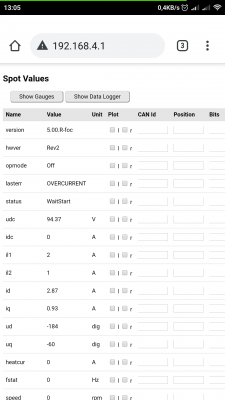

Ok, i tried to see what FW shows.johu wrote: ↑Tue Apr 06, 2021 9:10 am There are no different pin assignments in FOC. How is your board detected (hwver)?
PC9 is the desat input and PA0 used to be a separate UVLO input. In V3 I also disconnected emcystop from the NAND gate because I thought one external hardware shutdown pin (mprot) should suffice.
For the primary side it shows 5.0 FOC on rev2 hardware
For the secondary side it shows 4.9 Sine code on rev2 hardware.
screenshots attached...
