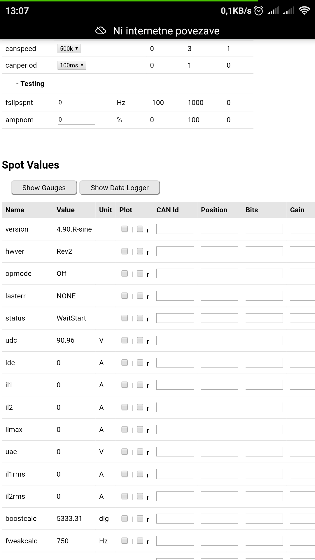

Ok, i tried to see what FW shows.
For the primary side it shows 5.0 FOC on rev2 hardware
For the secondary side it shows 4.9 Sine code on rev2 hardware.
screenshots attached...
When i attached Wifi module i immediately get OClimit on the brain to which wifi module is connected. I guess it draws just too much for the AD to be stable. I am waiting for 3V3 LDOs. I actually made provision for separate 3V3 supply.
So in FOC code what happens with the PC7 and PA0 pins? You dont show them connected so...?
