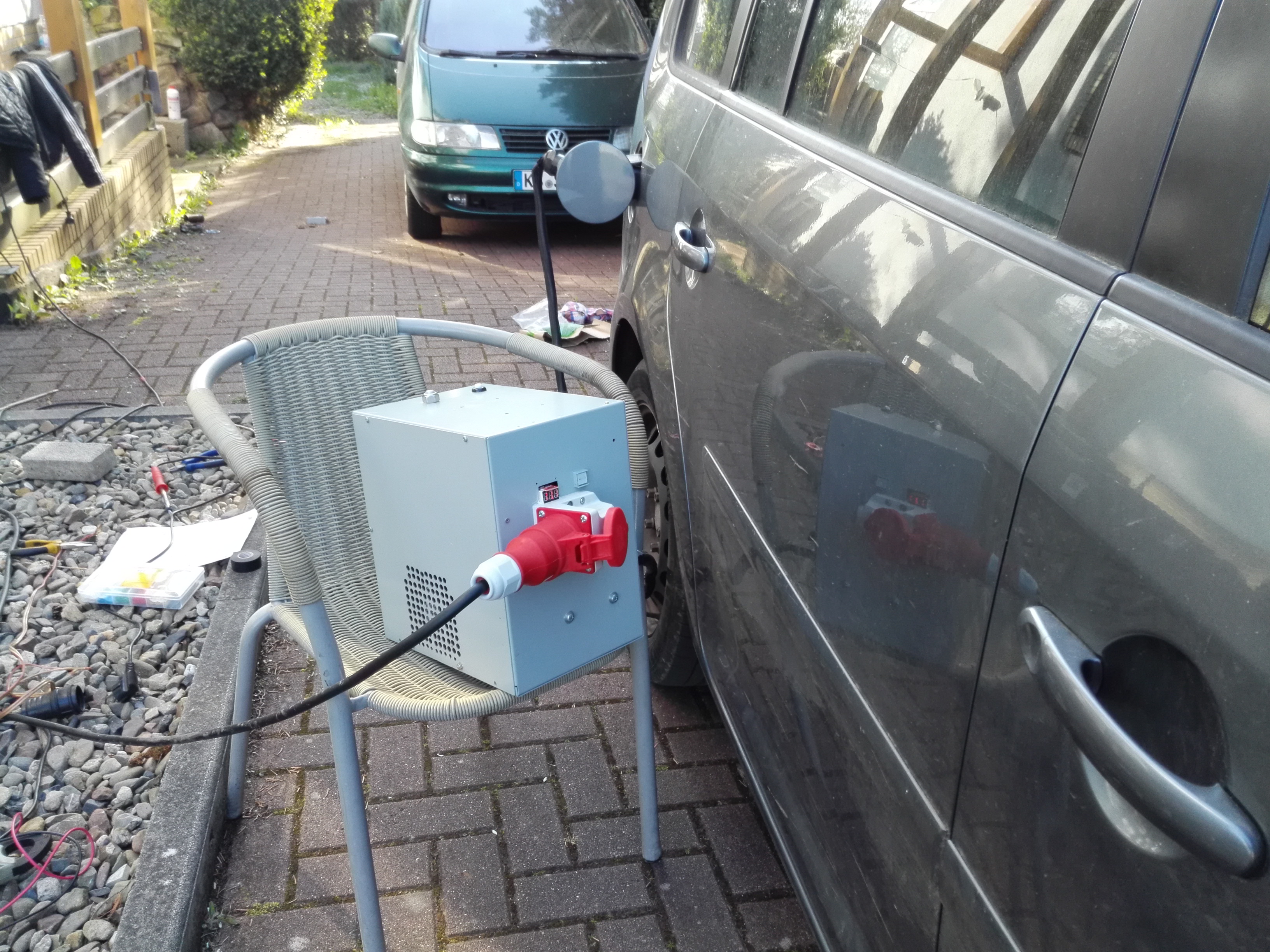

So since Touran has no built-in AC charger at all I created various hacky ChaDeMo chargers to still be able to charge it at home. For sake of completeness I will present the 3-phase version as well.

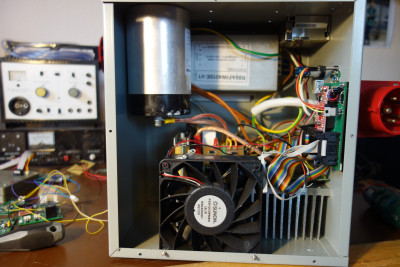

Power path: grid filter -> 3-phase rectifier -> buck stage -> output.
Let me walk you through this electric mayhem - again
Ingredients
  • Metal enclosure that has to be lurking about in your basement (don't buy new)
  • Heat sink (must also be left over from a previous project - EMW charger in my case)
  • Fan (large 120mm from EMW charger)

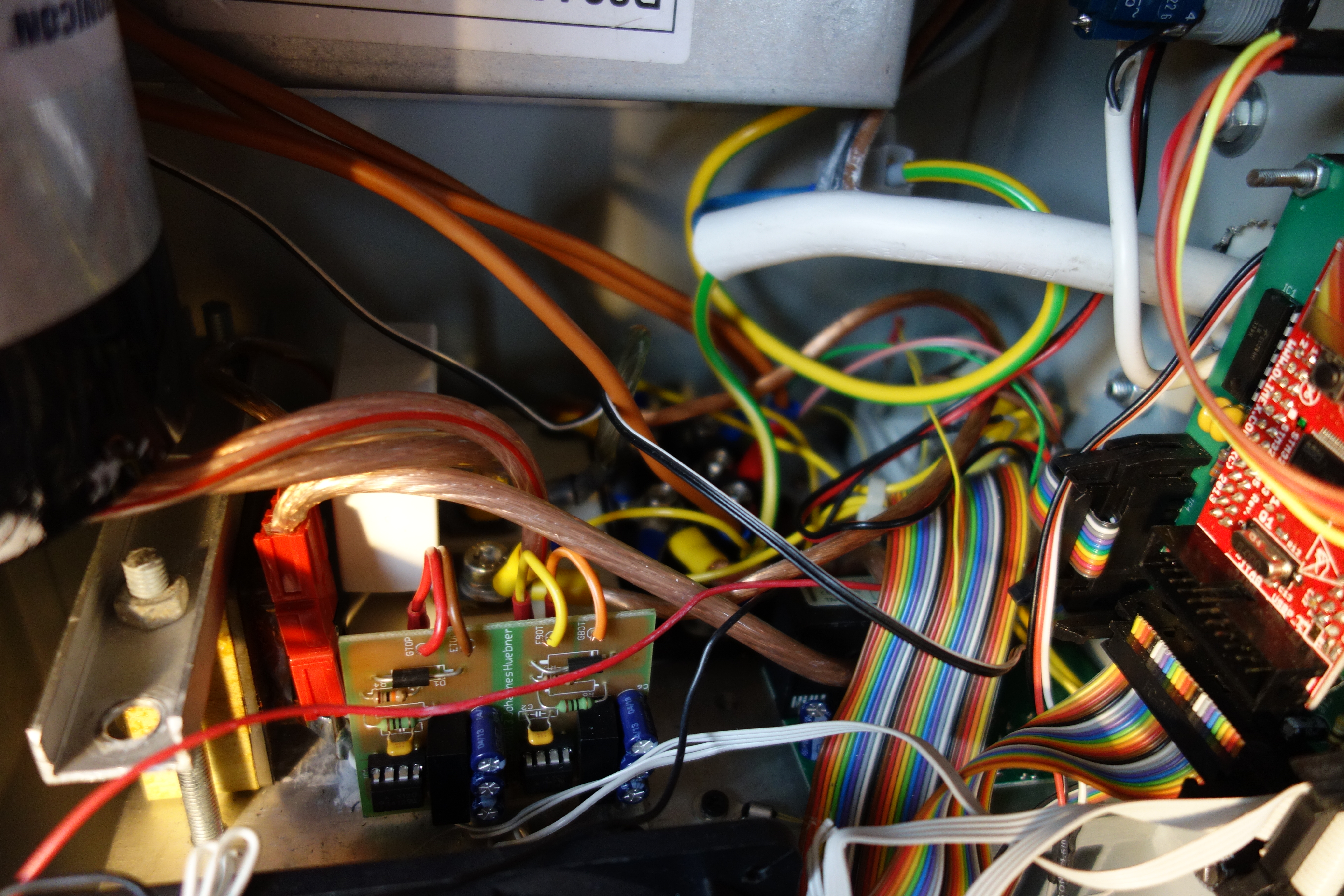

  • Rev2 or 3 inverter brain board
  • Rev2 gate driver - half populated
  • About 50A IGBT brick, 1200V! (in fact I use a 400A brick)
  • 100A or so 3-phase diode rectifier (cheap as chips, these)
  • an EMC grid filter (or your fuses will sing, also we want to be nice to the grid)
  • Current sensor (here: half populated legacy sensor board)
  • inductor (buck inductor from EMW charger)
  • A 420µF film cap and a precharge resistor, discharge resistor (ooops, forgot about the latter)
  • IC sockets (that are hot-glued to the Anderson connector to carry the ChaDeMo control signals)
Update: the IC sockets were bullshit, replaced them with a separate 7 pole connector left over from, guess what, the EMW charger.
Operation:
  1. Plug in ChaDeMo (best do this first, as the output goes live as soon as you plug in - who needs an output relay :evil: )
  2. Plug in mains, hit start
  3. The cars battery relay is closed
  4. The configured max charge current is transmitted via ChaDeMo
  5. The current command from ChaDeMo is obeyed
I have no idea if the power factor is any good, but it runs fine at 9kW for prolonged time. I took it up to 11kW (28A battery). The fan is temperature controlled and has to go mighty quick (and noisy) to remove the heat. Bucking seems less efficient than boosting.
If you're interested I can upload the software to github. Works the same as the inverter software. Web interface, CAN mapping and all that. It's the same software as the 1-phase version.
But strong disclaimer: this charger is a mayhem, it offers multiple chances to be electrocuted - don't do this at home.
