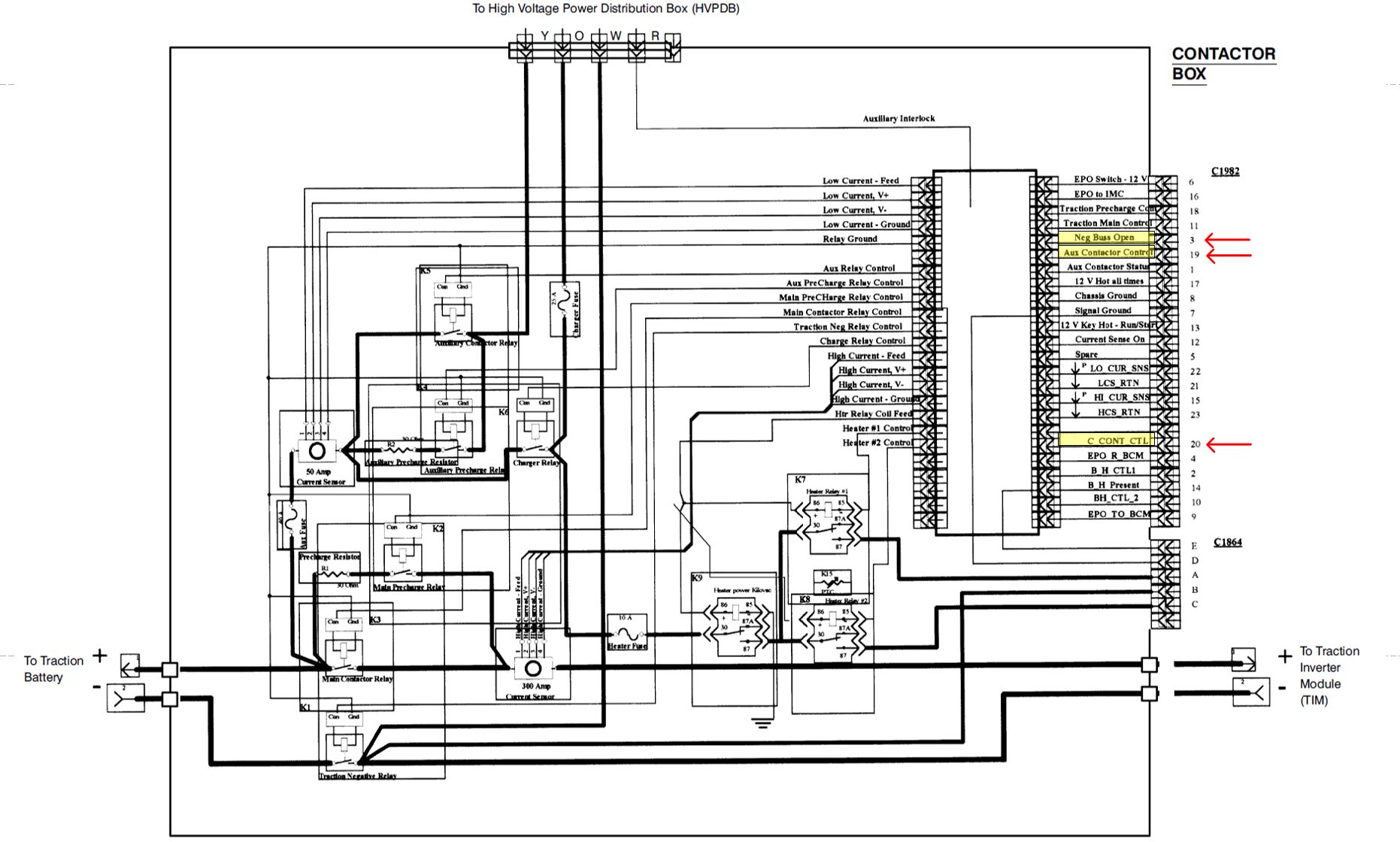

riii
Posts: 21
Joined: Tue Jul 30, 2019 2:18 am
Location: Oakland California USA
Re: Ford Ranger Inverter board Support Thread
Post by riii »
Hi joromy,
It's been a long time old friend. It's also exciting to see you have new fine-tuned parameters that I am anxious to try out.
When I finally got around to opening my contactor box about a month ago I found a blown up pre-charge resistor. The issue you mentioned here
viewtopic.php?f=16&t=186&start=25#p6725
and here
viewtopic.php?f=16&t=186&start=25#p6938
and more recently here
viewtopic.php?f=16&t=186&start=50#p11207
in which I believe this:
"IAA module could command the power steering and DC/DC to start and draw power before the HW aux relay has closed.
This will burn the precharge resistor after a while. (I burned mine this way)
This happens because the IAA module has almost immediate startup, much faster than the BMS!!"
is what happened to my precharge resistor.
We may have never made the IAA mod you suggested but I will do so this time around before installing a another OEM contactor box to replace the blown up one.
Where are all the wires routed through the middle hole in the IAA board in this photo terminated? On the connector pins then routing back your BMS?

Nice to hear from you again.
I have to think long and slow to remember this :)
It's not that complicated, the picture is for the instrument mod and battery heater/cooler also!
You need only two wires and a small signal diode. (The diode is obsolete, I can't see that it is needed anymore?)
Wire from pin 42 AUX relay control is (internally) going to "26" AUX relay status and trace is cut.
This is only a feedback for the IAA, that the AUX relay is engaged.
Then the pin 26 is free to be used for the new IAA enable signal that goes to pin97 run/start, an fires up the IAA.
Remember to cut outside wire going in to pin 97, this is so the IAA never gets started from the ignition key!
You can also do this externally if you don't want to open/cut traces, but then you need to reroute an extra wire from BMS to IAA pin 97.
This way the IAA will not command AUX relay on before the BMS has done the precharge and closed main contactors.
I would not use the contactor box/contactors, it should be possible since it have drivers for the contactors, but have not dug into this.
If you look at my complete schematic (tesla battery and Simp BMS) you will recognize the connections. (first page in this tread)

Thanks joromy,
What do you mean by "I would not use the contactor box/contactors, it should be possible since it have drivers for the contactors, but have not dug into this " ?
This is how I was using the EMUS BMS to control "NEG BUS OPEN" "AUX Contactor Cntrl" and "Charge CNTRL" in the OEM contactor.
I see on your simp BMS Tesla charger schematic you are using the AUX RELAY ENABLE function of your BMS to enable the IAA via pin 26 and then the IAA enables the the AUX contactor relay via pin 42. Since my BMS was driving the aux relay directly before, I need to reconnect the IAA's original wire that enables the aux relay.
I'm not sure what was controlling the precharge relay in my setup. That would be good to know. Maybe I was relying on the inverter to control it? Or would the IAA have a hand in that as well?

Joromy, one last pestering question. How did you figure out it was the IAA starting up before the BMS that burnt out your pre-charge resistor? I am mostly assuming my resistor blew up for the same reason but I want to consider other reasons that may have happened in case I can make other efforts to mitigate it from happening again.
joromy
Posts: 371
Post by joromy »
It's probably OK to use the old contactor box.
It's just that I have spendt many MANY hours on testing/measuring and blown up stuff, to get my own setup to work. And I'm not so keen on start on a new configuration/setup.
The contactor box electronics is measuring the voltage before it close the contactor.
So maybe you don't need to think about precharge, I'm not sure?
But I know the IAA is closing the AUX relay to fast, if it get "enable" signal (pin 97) directly from the ignition, before the BMS/newTIM has closed main contactor.
The way I found out the sequence of precharge, AUX and main contactors was putting LED on the contactor/relay coils.
Then you can see that they close in the right sequence. (you may have to take a video)
But you also have to measure the voltages to see if the precharge has happened.
You can hear the vacuum pump speed up an extra notch when the DC/DC get HV form the AUX relay, if you don't hear this then the AUX relay is already engaged.

That looks very sane, the precharge (pin 18) is only for the main contactors, controlled by the TIM.
The precharge for AUX relay is done internally in the contactor BOX.

Hi Joromy,
I have implemented the modification to allow the DC-DC CTRL output of my BMS to act as the IAA enable. I made the mods by cutting the original "aux ready" circuit of and near to the connector 1982 of the original contactor box and repurposed that to act as the DC-DC CTRL/IAA enable (assuming the the old contactor box does not need feed back from the IAA?) routed to pin 97 of the IAA. Please see the drawing below:
I was hoping it was going to be plug and play but unfortunately the aux relay is not kicking on probably because there is not 12V+ coming from the BMS that would run/start the IAA. I think that would actually require a relay since it should be expected the IAA would be powered exclusively by the BMS? Either that or the BMS output is broken. It says it's on but I see no 12V+ from the DC-DC CTRL output. I'm a little wondering if all my outputs are not functioning as they say they are. In charge mode I can activate and talk to the charger but it is not seeing voltage from the battery because contactors are not closing.
While the IGN key was on at one point I applied 12V from the 295 circuit to pin 97 of IAA (after the diode) which activated the IAA but did not activate the aux relay as far as I can tell.
Also, I'm still getting a precharge error from the TIM. Perhaps I should open up the TIM and see what's going on in there. Is there a function using the Huebner inverter manager that clears errors that allows the inverter to function? :?
Ideally, what should the sequence of precharge and contactors closing be for the truck upon start up?
Based on the clues provided above can you think of reasons for my malfunctions? Sorry for all the questions.

riii wrote: Mon Dec 28, 2020 1:18 am Ideally, what should the sequence of precharge and contactors closing be for the truck upon start up?
The basics behind contactor and startup sequence.
Drive:
1. Negative contactor close. (By BMS)
2. Precharge relay for TIM close, and charge up the capacitors.
3. Inverter will close Positive contactor (if voltage has reached volt settting "udcsw")
Drive/AUX equipment (DC/DC A/C heater):
2. Precharge relay for AUX circuit close. (for preset time, or on Simp BMS when < preset current)
3. AUX relay close.
Problems:
If negative contactor is controlled by the BMS, it MUST be on before all other relay/contactors!
Since there is no communication between the Inverter and BMS (normally) The Inverter could try to precharge before the BMS has closed negative contactor, and will give precharge error.
Temporary test solution:
Short the negative contactor, or energize the coil.
Adequate solution:
Run the negative contactor directly from ignition.
Would not recommend this, because then the BMS will not be able to shut down the high voltage if it detects an error.
Best solution:
Be shure that BMS start first, then the AUX (IAA) and Inverter.
I say it again, if you have access to the relays/contactors, put LEDs on them, and check that you get correct sequence.
