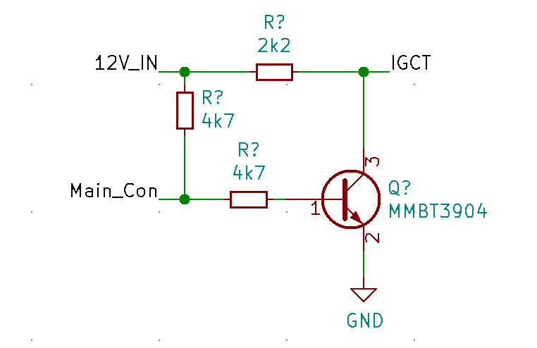

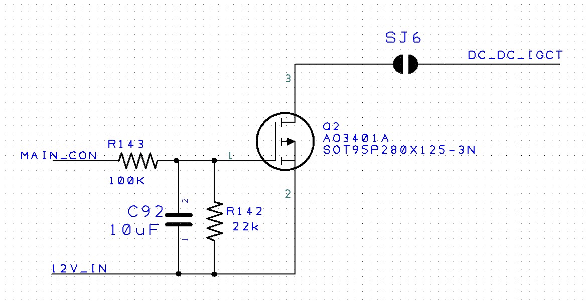

In my testing today, I ran into problems with the precharge vs DC/DC converter in my Yaris inverter.
I'm using a 140V pack voltage connected to the HV-bus side. Using a 40ohm precharge resistor.
I also have a short program in the 328p to set the high-side IGBT ON in the buck/boost, to supply power to the DC/DC side (input DC bus). This is done at startup so the precharge will include the capacitor here as well.
Problem is that when using a jumper on the CONN3, the DC/DC starts immediately and starts drawing current thorugh the precharge resistor and the main contactor is never set due to to low bus voltage.
To fix this I removed the jumper (CONN3) and instead placed a P-FET over the CONN3 pins and connected the gate to the Main contactor control IC (IC8). And also added some RC-delay at around 100ms so that when the main contactor is triggerd there is a further 100ms delay before the DC/DC is allowed to start, to ensure that the DC/DC does not start before the actual main contactor contacts are closed.
How have you solved this problem? Or have I missed something and solved a problem not needed to be solved? Or should something be implemented on the logic boards in the future? Or some other means of controlling the DC/DC?

Thats a good idea. I'll add it to the design for the next rev.

You might figure out something better but here is my solution.Jack Bauer wrote: ↑Sat Sep 26, 2020 7:23 am Thats a good idea. I'll add it to the design for the next rev.
Re: DC/DC converter in Auris/Yaris and Prius Gen3 inverter
Going to try your idea out on some logic boards. As you say there are probably countless ways of doing it but to reduce the chance of error I have copied exactly as you have drawn. Shout if you can see anything wrong or would recommend doing it differently.

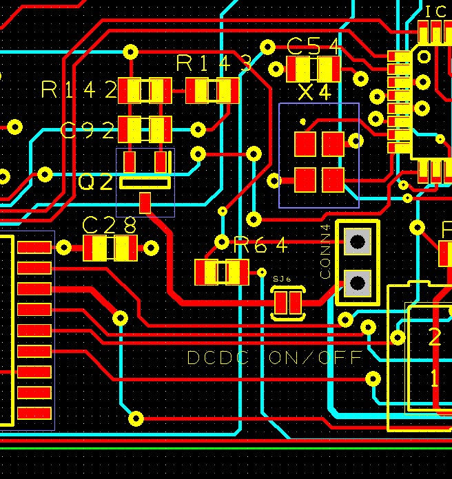

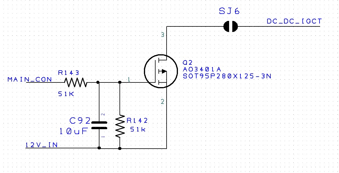

The P-fet you have selected have a lower VGSth of typically -0,9V as compared to the one I used which, if I remember correctly, is typically at -3V.180jacob wrote: ↑Wed Nov 25, 2020 12:17 am Going to try your idea out on some logic boards. As you say there are probably countless ways of doing it but to reduce the chance of error I have copied exactly as you have drawn. Shout if you can see anything wrong or would recommend doing it differently.
This will result in a shorter delay-time. Depending on what main contactor you are using it might be a good idea to adjust the RC-delay or select another p-fet with higher threshold voltage.
Yes I did think it was going to be a bit brief but it was getting too late at night to think about it and that was the only P-fet in JLC's basic parts list in a SOT-23 package. I will have a think what some more preferable values would be or squeeze a different package in there, would rather not use extended parts for a feature not everyone will use.bexander wrote: ↑Wed Nov 25, 2020 8:03 pmThe P-fet you have selected have a lower VGSth of typically -0,9V as compared to the one I used which, if I remember correctly, is typically at -3V.180jacob wrote: ↑Wed Nov 25, 2020 12:17 am Going to try your idea out on some logic boards. As you say there are probably countless ways of doing it but to reduce the chance of error I have copied exactly as you have drawn. Shout if you can see anything wrong or would recommend doing it differently.
Thanks for the advise.

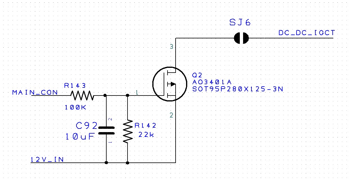

Ok I've decided to stick with the sot-23 p-fet, and have changed the resistors to 22k and 100k giving a VGS of -2.1V and delay to the -0.9V VGSth of about 100ms, could swap the cap for 22µF to be extra sure its long enough I suppose. But 10µF, 22k and 100k are already on the BOM so keeps the cost down.

Adding a useful delay without increasing BOM, to me, that sounds great!180jacob wrote: ↑Wed Nov 25, 2020 10:43 pm Ok I've decided to stick with the sot-23 p-fet, and have changed the resistors to 22k and 100k giving a VGS of -2.1V and delay to the -0.9V VGSth of about 100ms, could swap the cap for 22µF to be extra sure its long enough I suppose. But 10µF, 22k and 100k are already on the BOM so keeps the cost down.
I think 100ms is quite enough. The conntactor datasheets I have looked in (Kilovac LEV200 and Panasonic AEV) have a set (on) time of 50ms or less.
If someone have a very slow conntactor it is possible for them to adjust the component values.

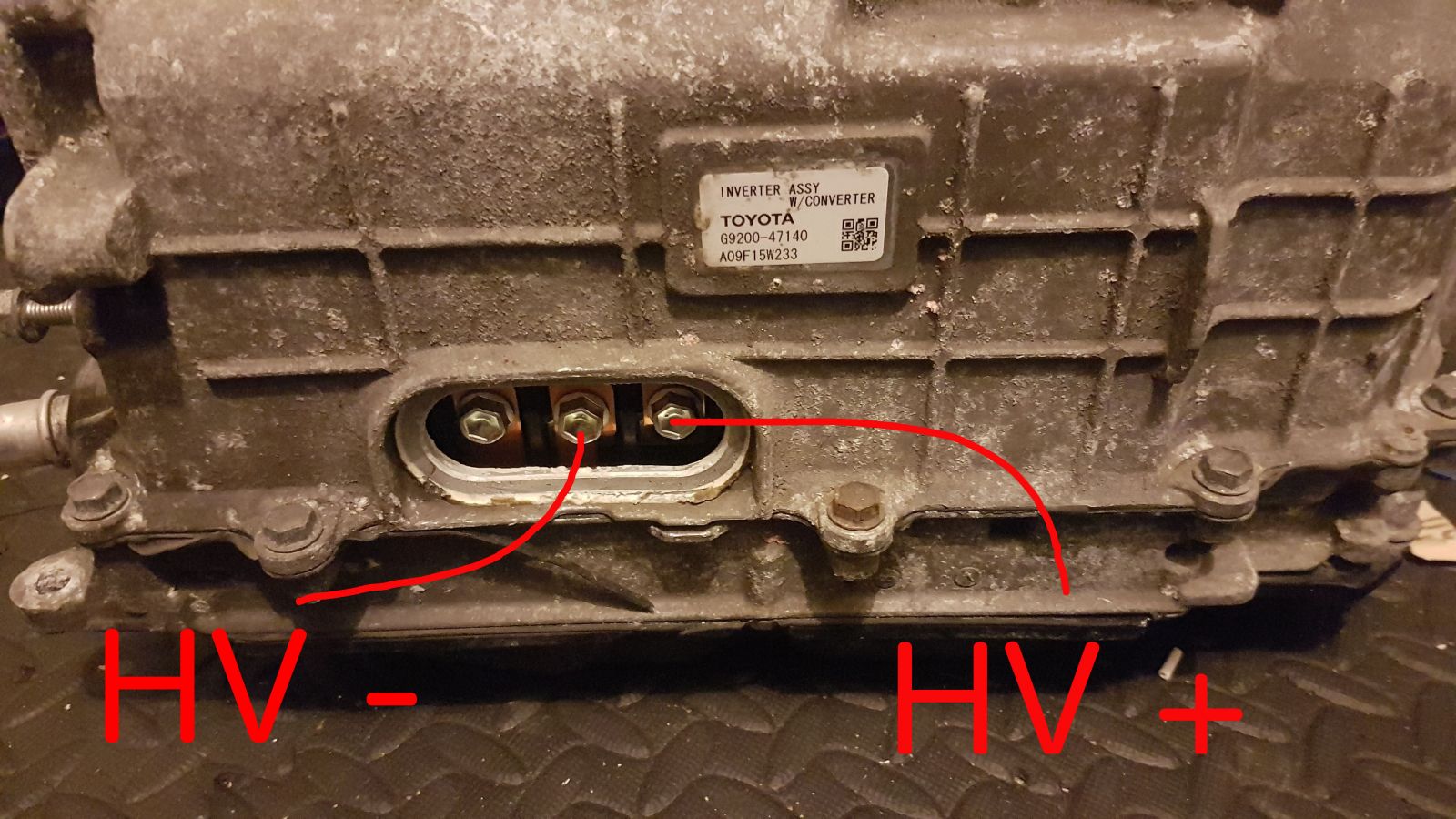

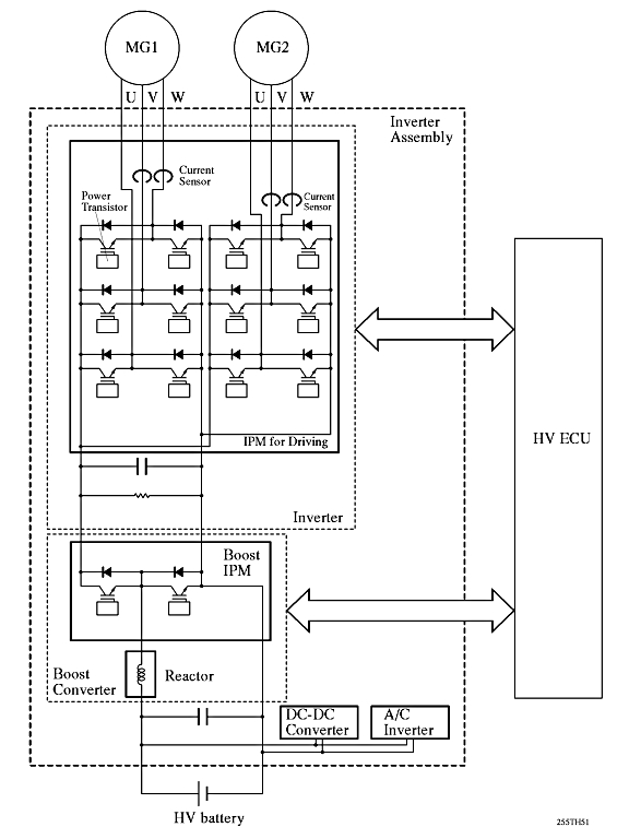

Here is an overview of the toyota inverter.
If connecting the battery to the "Inverter", center of the picture, you will need either to set Hi-side IGBT on in the boost converter by using my code in the 328p and modding resistors in the DC/DC OR using a bridge connection between the unmarked screw (the left one) and HV+ in Bigpie:s picture to bypass the boost converter and modding the resistors in the DC/DC OR use JackBauer:s code to use the boost converter as an buck to reduce the voltage feed to the DC/DC, no mods needed to the resistors in he DC/DC.
If connecting the battery to the "HV Battery", at the bottom in the picture, you will feed the DC/DC directly and resistor modifications are required if you are to run 360V.If connecting the battery to the "Inverter", center of the picture, you will need either to set Hi-side IGBT on in the boost converter by using my code in the 328p and modding resistors in the DC/DC OR using a bridge connection between the unmarked screw (the left one) and HV+ in Bigpie:s picture to bypass the boost converter and modding the resistors in the DC/DC OR use JackBauer:s code to use the boost converter as an buck to reduce the voltage feed to the DC/DC, no mods needed to the resistors in he DC/DC.

There are already a note and a link to this thread on the wiki regarding the DC/DC. Should I try and extend the information given on the wiki regarding the DC/DC? Might be better to wait until a permanent fix is in place?
What do you want me to submit? I think it is better if we can use the STM32 to generate the VLO signal but that will require some work from johu or someone else as I only can write code for the 328p.
