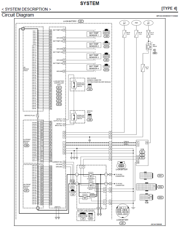

Magically the Nissan BMS now no longer displays the interlock error. The interlock bit is still low on the CAN bus but DTC is gone. Hmm. Not sure how to figure out whether it balances. People on the web seem a bit unsure. For the Leaf BMS fanboys: I'm reading group 6 but it seems to return all zeros.
Well it's not all magic, I actually traced the interlock signal. It is a 3.3333333Hz 50/50 PWM on the source. It is then routed via the various interlock switches back to the LBC, through a transistor to the MCU. Behind the transistor the signal was swinging between 4.5 and 5V which didn't seem right. So I beefed up the base voltage divider. Now a nice 0-5V swing is generated. Not sure what the deal is.
Anyway I'm getting a meaningful charge and discharge limits now. It's about 1°C outside and when I started I had a 3kW charge limit and a 75kW discharge limit. Just by waiting a bit it climbed to 6kW/90kW.

I've noticed a difference between the 'white' and 'grey' versions of the LBC wiring on connector LB11 (top left).
The grey wiring loom has empty slots at pin 4, 11, 16,17,18,19,20,21,22,23,24.
The white wiring loom has empty slots at pin 2, 7,11,14,18,19,22,23,24.
The 'present/interlock' signal is (according the schema) populated between pin 8 and 21.
So pluggin in the white loom in grey LBC (and vice versa) doesnt fully work.
According schema (white LB11 connector) pins are as follows

And the wiring loom with grey connector is as follows:

One method I used to verify that the BMS was hooked-up correctly was with a bluetooth dongle and the LeafSpy app. There's an option in the app to only perform BMS communications. Using the app, you can see all the output data from the BMS. Here are some details:
http://www.electricvehiclewiki.com/wiki/leaf-spy-pro/
I have been wanting to read the balancing signals manually over can-bus, but never got around to doing it. But I do see on LeafSpy that the cells are balanced periodically when the BMS is active.
I believe the all-white connector BMS are from 2011-2012 models, and the ones with white/grey/black connectors are from 2013-2016. I've attached the wiring diagram from the 2013 BMS that I used in my car.

Great, thats valuable information (diagram) for the grey connector version LBC's.
So now we know why Johu gets a different result on the interlock signal when using the white or grey LBC on the same loom because they changed the pins from 8-21 on white to 8-6 on grey.

Oh you're right! That is really strange. When I remove the connection between 6 and 8 the BMS sets the discharge limit to 4.5kW and I think it displays some error. But now I see they just tie pin 6 to 12V - permanently or on ignition? When is pin 5 activated?

I see that according diagram pin5 is enabled by the VCU and i guess when you plug the charging connector it enables the BMS in 'charge' modus and probably onyl then starts to balance ?

Success! or rather: one step forward, one back.
I've changed the interlock return to pin 21 now and finally I get a "1" on the interlock bit. But now I'm back to the 4.5kW discharge and 0W charge limit with DTC 0x254d or 0x4d25. I have removed my special resistor on pin 6, will put it back in.
I was hoping it always balances. At least it stays on for a while after pin 5 and 6 are disconnected.

White loom:
Pin 6 is only +12V when IGNition on, pin 12 is constant +12V.
Pin5 is only +12V when charging

I did a bit of checking. So supposedly on the "all white" BMS the current sensors ground lead is connected to Pin 7 as opposed to pin 15 on the grey BMS. But all components that pin 7 goes to are unpopulated and the pin is floating. So I left the sensor on pin 15 which is solid GND.
Concerning the 3rd temp sensor I think I've found the place where it forks off to the processor via a series resistor (R59). So I will remove that and bridge it over to the 4th channel behind R62. Now I hope the 4th channel is just copied onto the 3rd.
- Been thanked: 1913 times
Re: Nissan Leaf BMS
Ok, tried that but no real luck. DTC had different values. one byte is always 77 (0x4d) and one had different values on different attempts: 37 (0x25), 10 (0xa) and 93 (0x5D). None of the combinations show up in the service manual. I wonder if there is some encoding.
I'm also rather surprised the DTCs changed on every power up today. Yesterday it was 77 37 pretty consistently.
