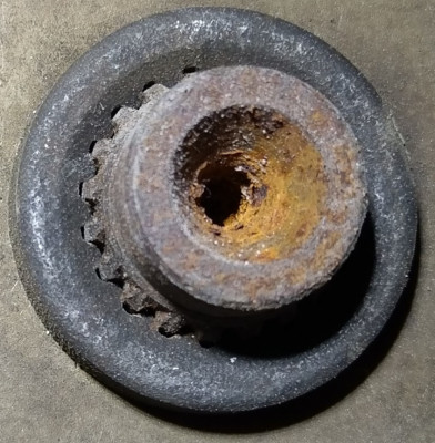

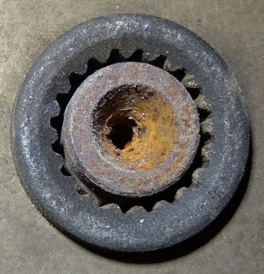

The ghetto Leaf coupler is a Blue Print ADC43101 clutch disc or similar. It fits a bunch of japanese and korean vehicles and is cheap.
It's a loose match and probably different spline profile, but I've been running it for almost 30 000 km in my minivan so far just fine. There is enough meat in the splines. I assume the quite soft motor shaft will adjust to the very hard clutch profile over time.
If anything, at least it's taking a whole lot of time for anyone to be able to tell me "I told you so". 8)

celeron55 wrote: Fri May 08, 2020 4:46 pm The ghetto Leaf coupler is a Blue Print ADC43101 clutch disc or similar. It fits a bunch of japanese and korean vehicles and is cheap.
I smashed two blueprint Mazda center pieces couple of years back. It is not very hard too.
If I may suggest you put two center pieces in line and weld them in your coupler. That way it will definitely hold.
Torque is transfered along the shaft length...

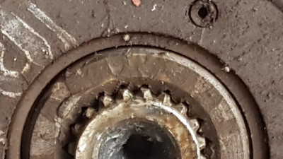

Here is how the 1.6l Fiat Multipla centre spline fits the Leaf output shaft

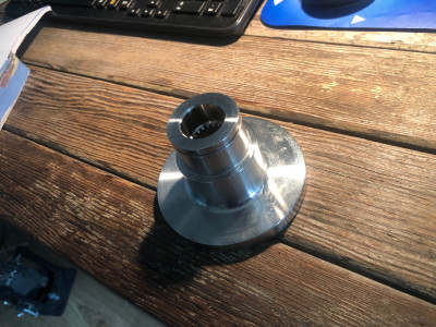

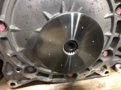

Some time later :)
fits like clockwork

Bratitude wrote: Sat Jun 06, 2020 5:10 pm Some time later :)
fits like clockwork
Wait. Are you putting a flywheel and clutch on this? If so...hmmmmmmm...How can I get one of these in the US?

I'd love to purchase one of these from you. I have a CNC machine so I'm planning on making my own adapter plate and would integrate the same spec'd angular bearing.
Are you in a position to start selling the coupler?

designed the coupler to be as universal as possible, so yes with the angular contact bearing you should be able to mount a flywheel.
few more days and I’ll start taking orders

Hi everyone. This is my first post. I accidentally came across a clutch from suzuki samurai. What do you think about this? 20x20,1x23,1
Multipla has 20x20,2x23,2
