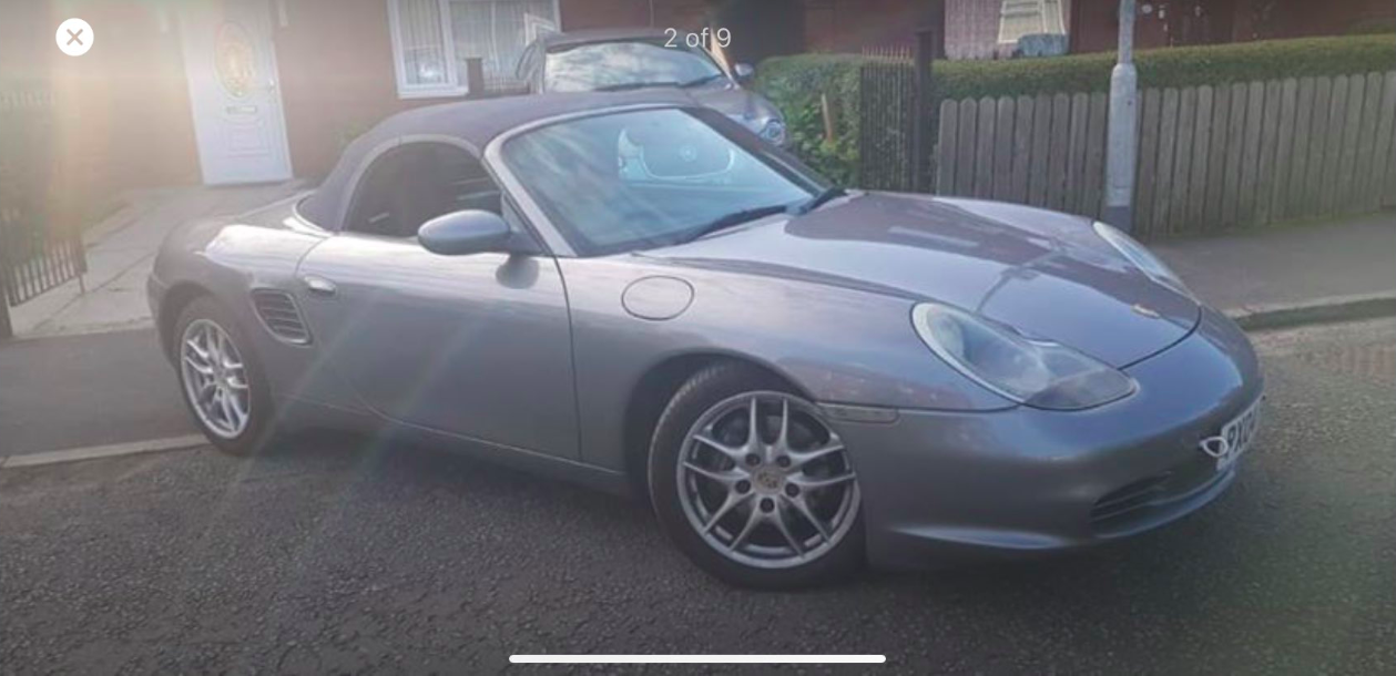

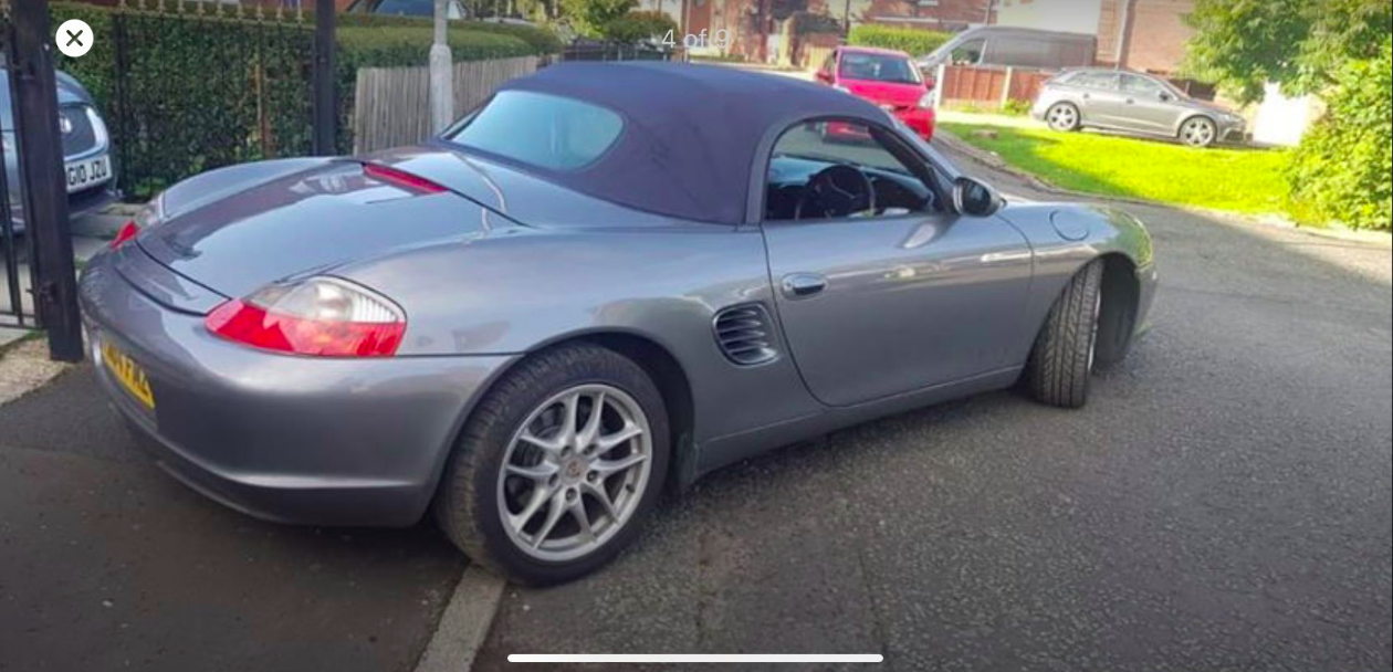

Zero EV (here) have announced a Porsche Boxster build that they will document as a four part mini series on their YouTube channel (here).
The build will use their commercial version of the open source inverter controller developed by Damien and Johannes. They will also use the Tesla 11kW Charger, Tesla DCDC, and a 36kWh Tesla battery from the Smart 8-)
They have also announced that a bolt in kit for the 911, 930/964, and 993 is in development.

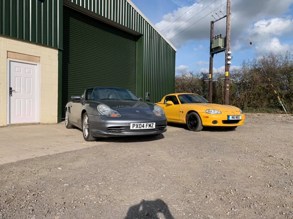

Google, google and then some more google. If that does not work you need to start can captures and changing one thing at a time and hunt for the values that change.
The Boxster is now out and driving around, she will easily do 80 miles on a charge. Keep in mind this is an abused pack that is quite out of balance and the car is not being driven conservatively.
To celebrate we got a new project in the shop a Gen 2 Mazda MX5.
