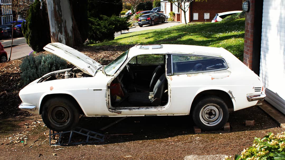

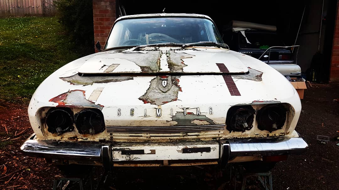

Hi folks,
I'm converting a 1971 Reliant Scimitar SE5 to electric drive train, using the Lexus GS450H transmission as demonstrated by Damien Maguire at the New Electric Ireland course I attended. I've been collecting the parts I think are required and last week my 4 battery packs arrived (each containing 60s Kokam 100216216H cells) so I'm trying to copy what Damien's been doing but to be honest I'm a bit clueless so any help or advice appreciated. As an example of how much of a novice I am, I opened up the first of four boxes of Kokam cells to discover I don't have any of the necessary tools to remove the BMS boards! (Have been shopping online for some new screwdriver bits etc, so hopefully in my next post I'll have been able to get some of the BMS boards out). Can anyone offer advice on what boards on OpenInverter would be helpful to read?
Once I've got the bms boards out, what would you do next?
(Don't worry, I've got a mechanic booked in to do the work on restoring the Scimitar, whilst I try to get my electric drivetrain working)

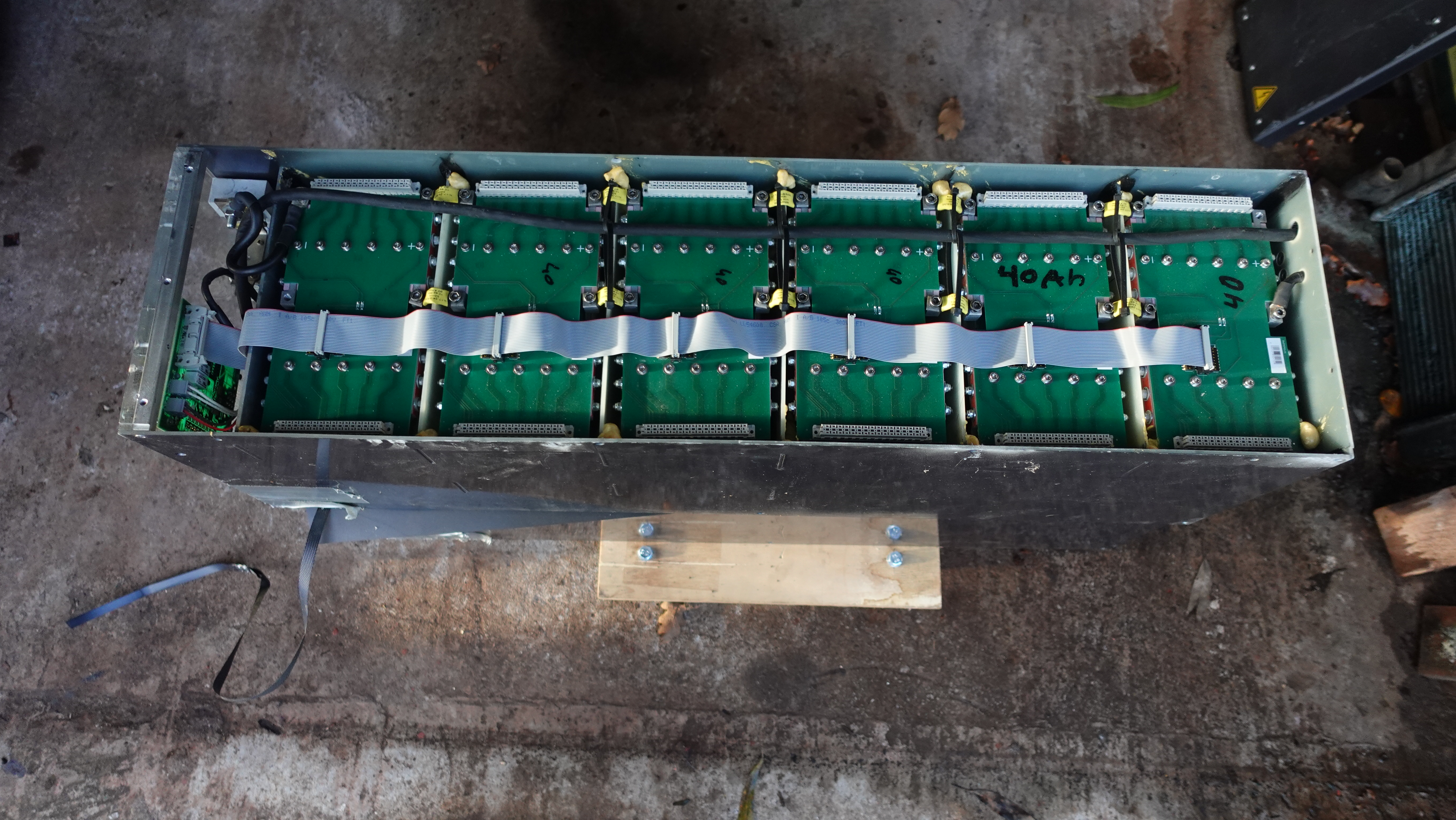

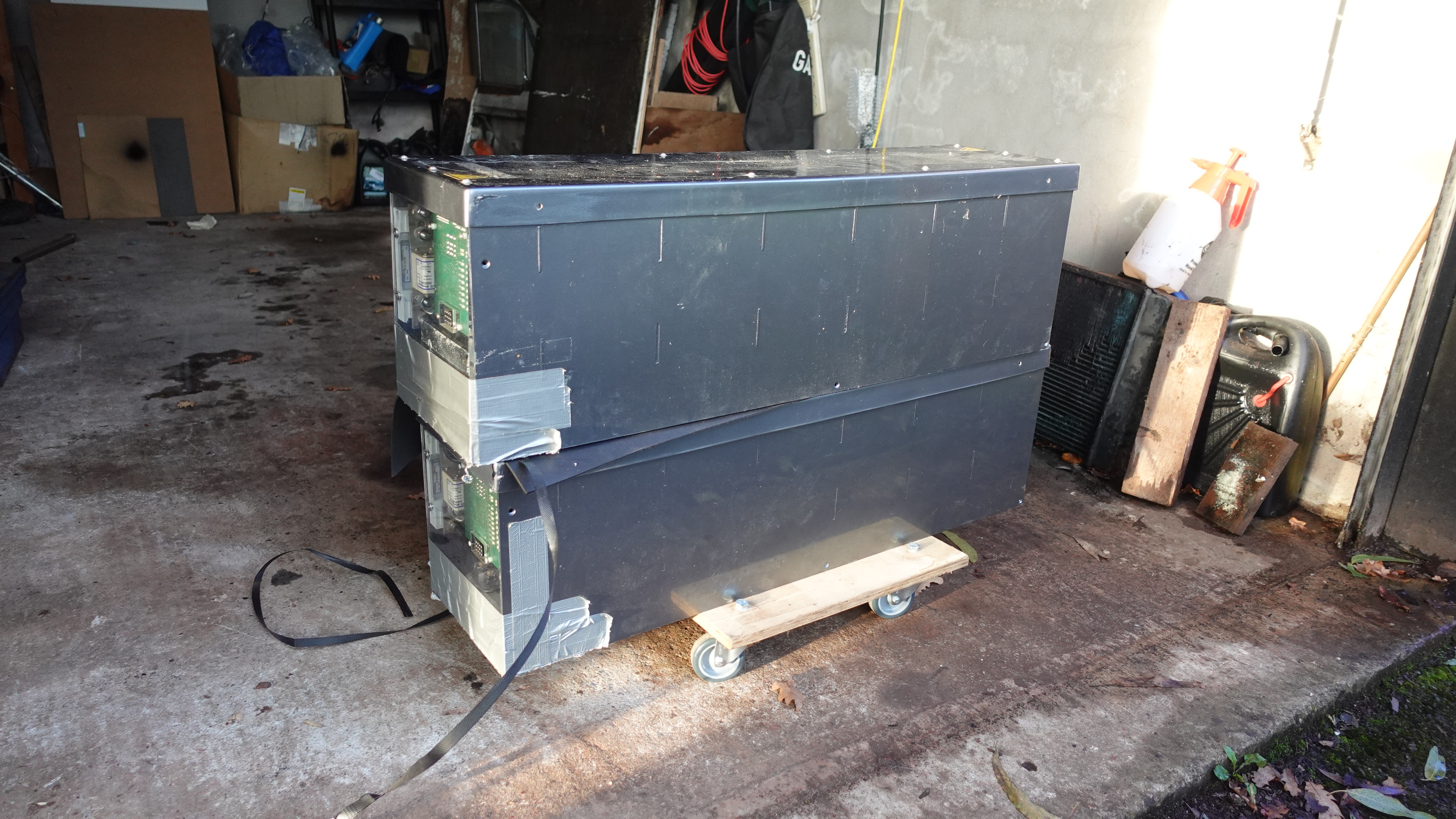

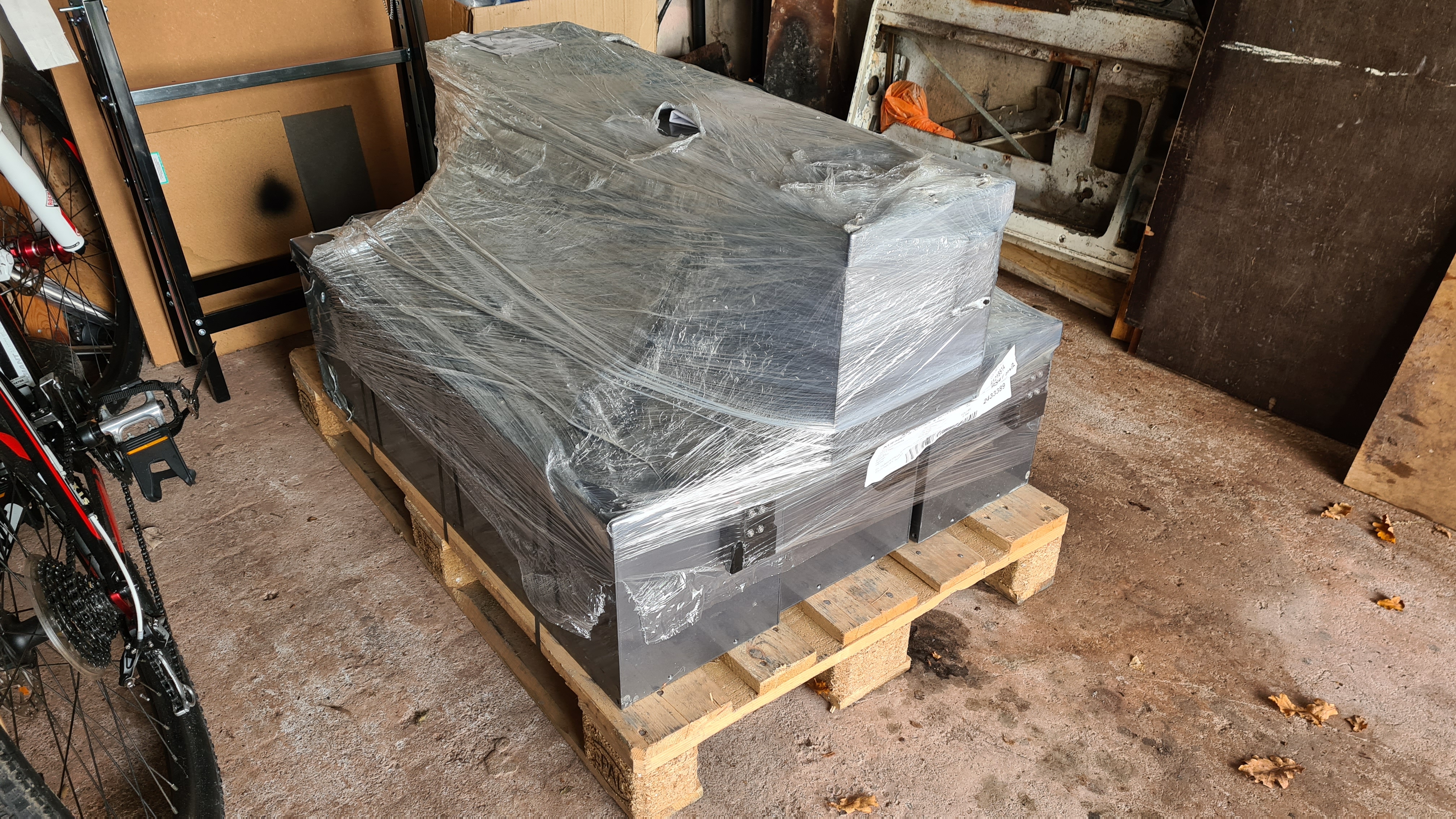

So far I've gathered
4 battery packs (each containing 60 Kokam cells SLPB100216216H, which I reckon ought to be about 35kWh)
Oil pump for the above transmission
Toyota Inverter for the above transmission

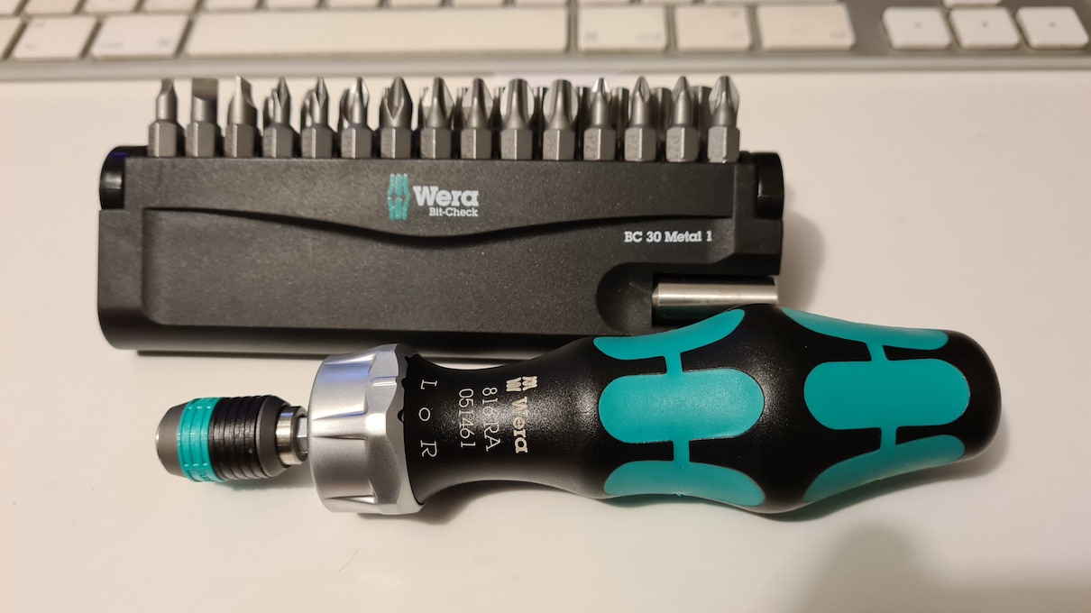

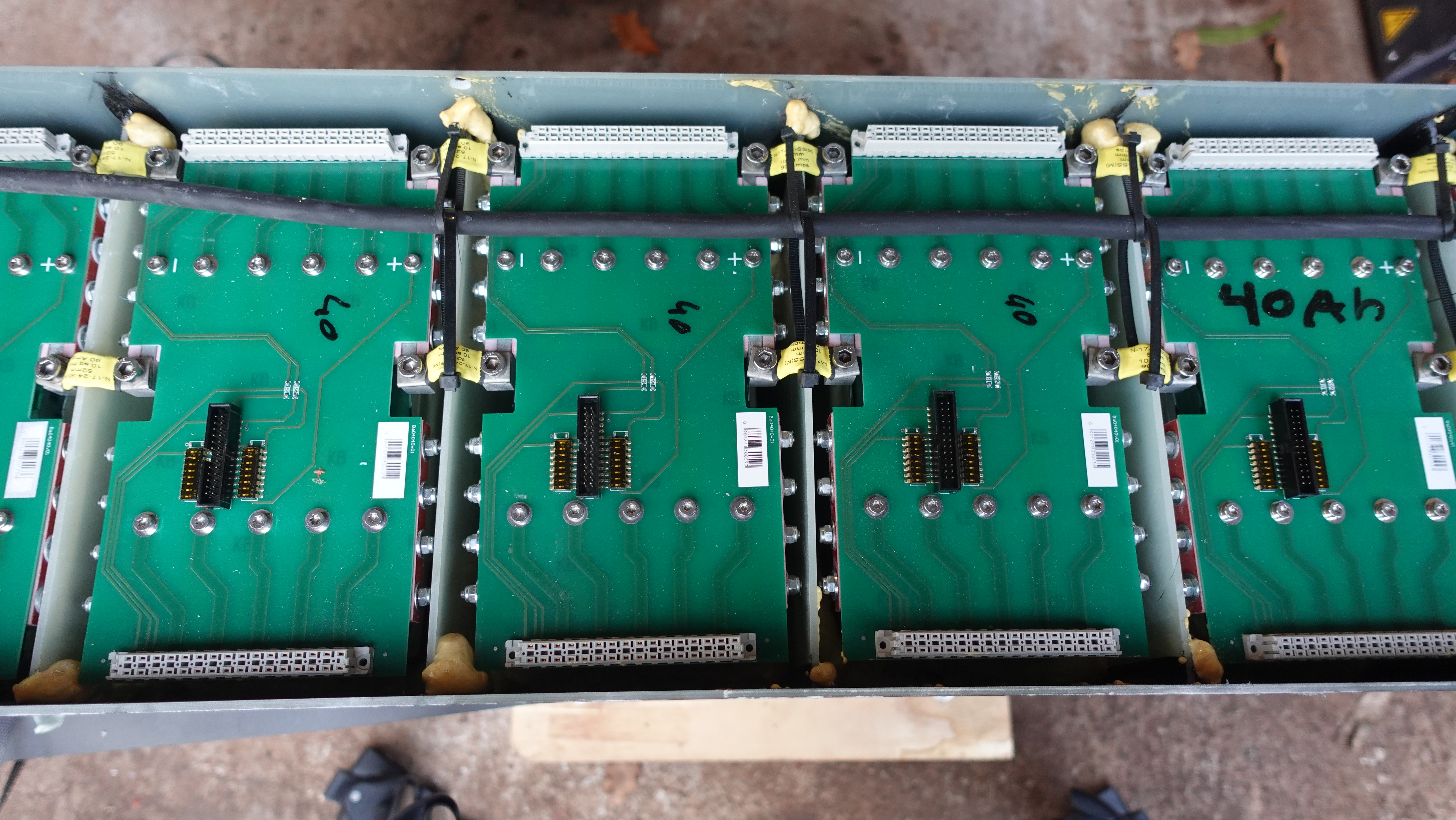

And now that my new tools have arrived I can make a start on removing these redundant BMS boards
(Rookie mistake #2: I thought the boards themselves selves were a BMS! Well it's a relief that I don't need to rush the removal now)
The high voltage insulated tools were out of my budget range so I'll just need to be extra careful!

Use selective covering of adjacent components, so that a dropped tool is unlikely to cause a short.
Use heatshrink to make you own insulated tools.
Never get complacent.
This should be a cautionary tail to all; http://evdl.org/pages/plasmaboy.html

I like his description of using uninsulated tools being "like changing a fuel filter while smoking a cigarette". Bad idea all round...

Good question! Ideally I'd like to keep everything looking as original as possible so my initial thought was to move the transmission forward until it fits in the tunnel. I should do some measuring soon to see how much room I have to play with. Do you have any thoughts on this dilemma with your MG?
I'm getting some professional help with the restoration of the Scimitar and his advice was to modify the tunnel to fit the Lexus transmission.
This has the added advantage of making more space for battery packs and therefore keeping the weight as much as possible between the wheels, and low down (He suggested this would improve performance, sounds logical to my inexperienced ears!)

Thanks SciroccoEV. I'll read that linked article before I even look at my batteries again!SciroccoEV wrote: ↑Thu Nov 26, 2020 5:20 pmUse selective covering of adjacent components, so that a dropped tool is unlikely to cause a short.

I think you will struggle to find a cheap working Jag lsd nowadays but this isn't too pricey ; https://www.rallydesign.co.uk/product_i ... s_id=25503
However the Scimitars rear suspension is very good and you can go a long way with an open diff, I used to sprint a 265bhp 302V8 powered SE5 and rarely had trouble getting the power down.
Unfortunately the front suspension is crap and they roll badly with the std antiroll bar- fit a second std bar piggy back or get a heavy duty one made. Uprate all the bushes and the brakes as they are hopeless too.
I think the chassis will limit how far back you can push the transmission but don't worry about cutting the tunnel, it's not structural but you might have to junk the heater, something you'd probably do anyway.
The fuel tank sits well back and quiet high and the handling would change quite a bit depending on how full it was, so I'd avoid putting too many batterys there.
The engine sits back behind the front wheels and you can trim a lot of the body from around the engine bay to make room for batteries up front.

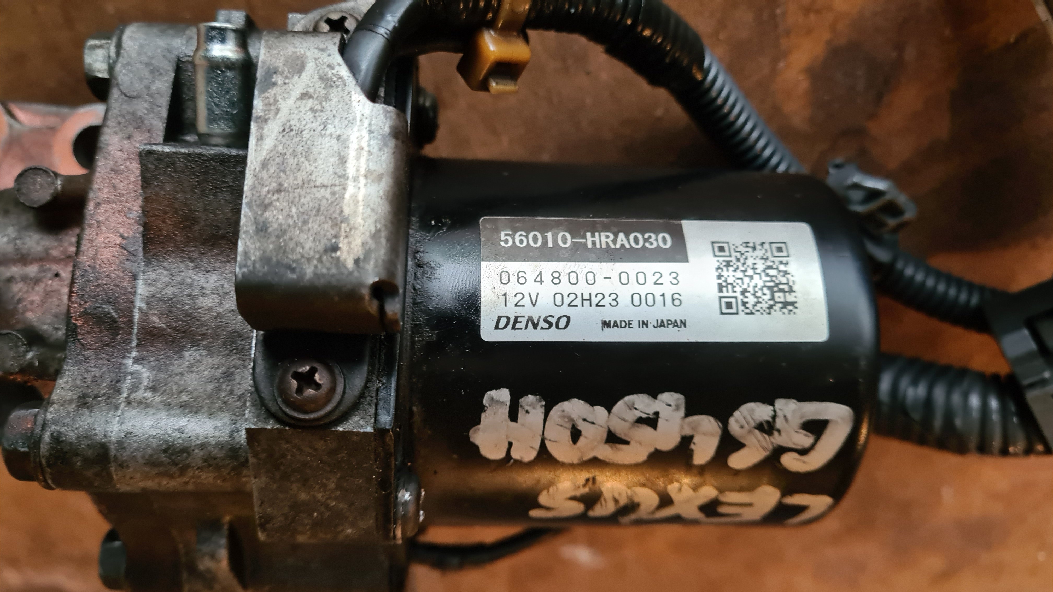

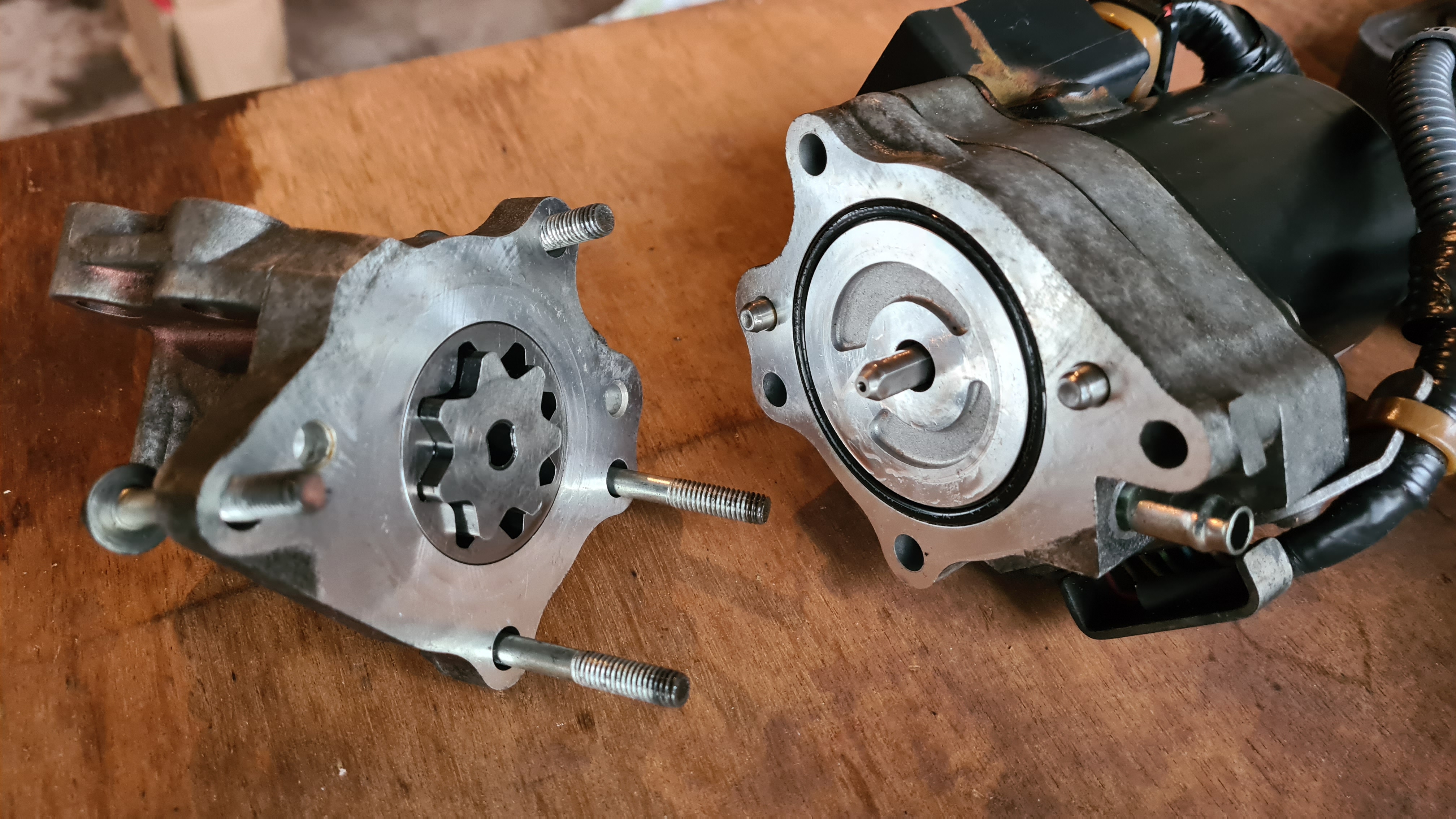

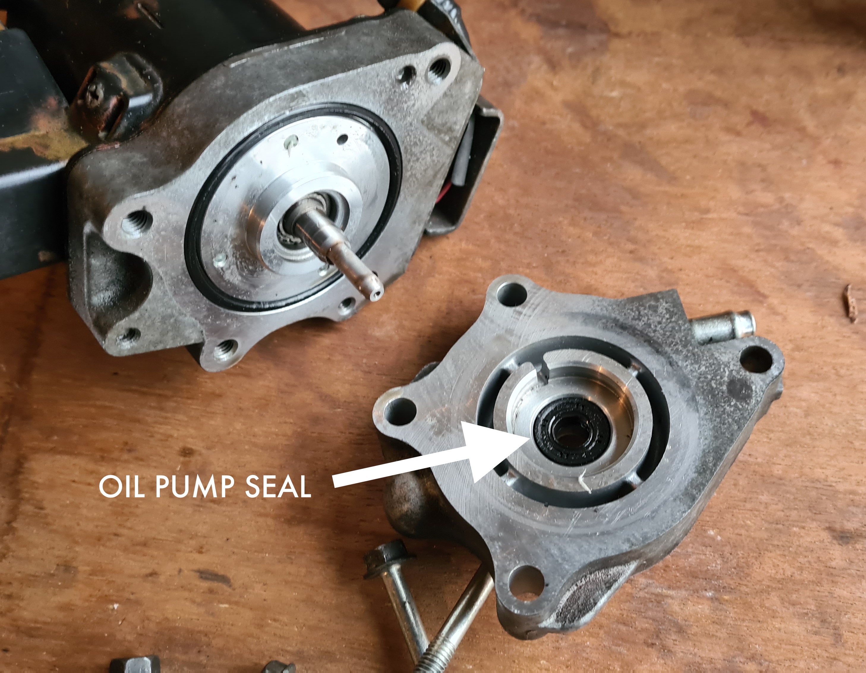

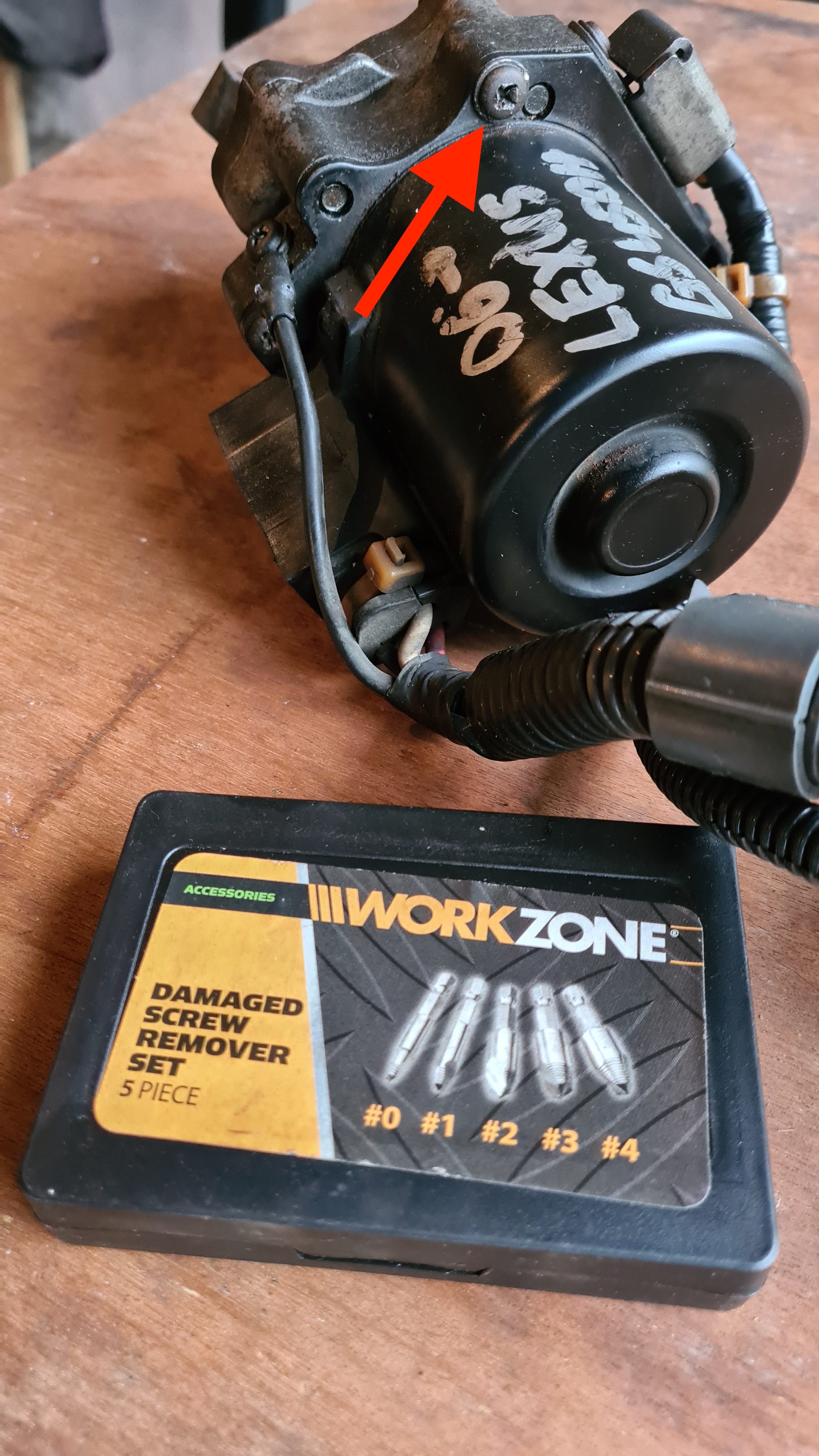

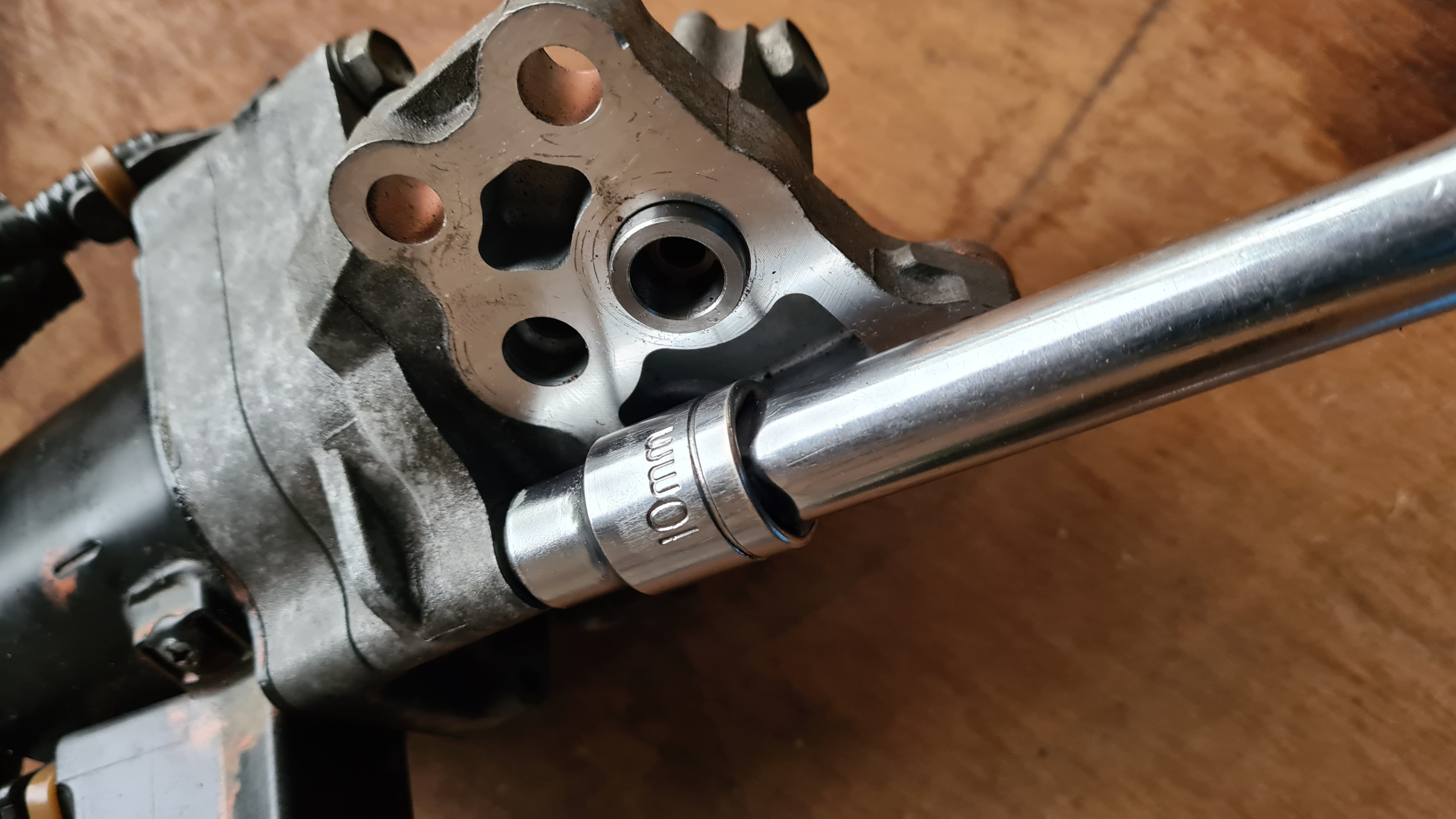

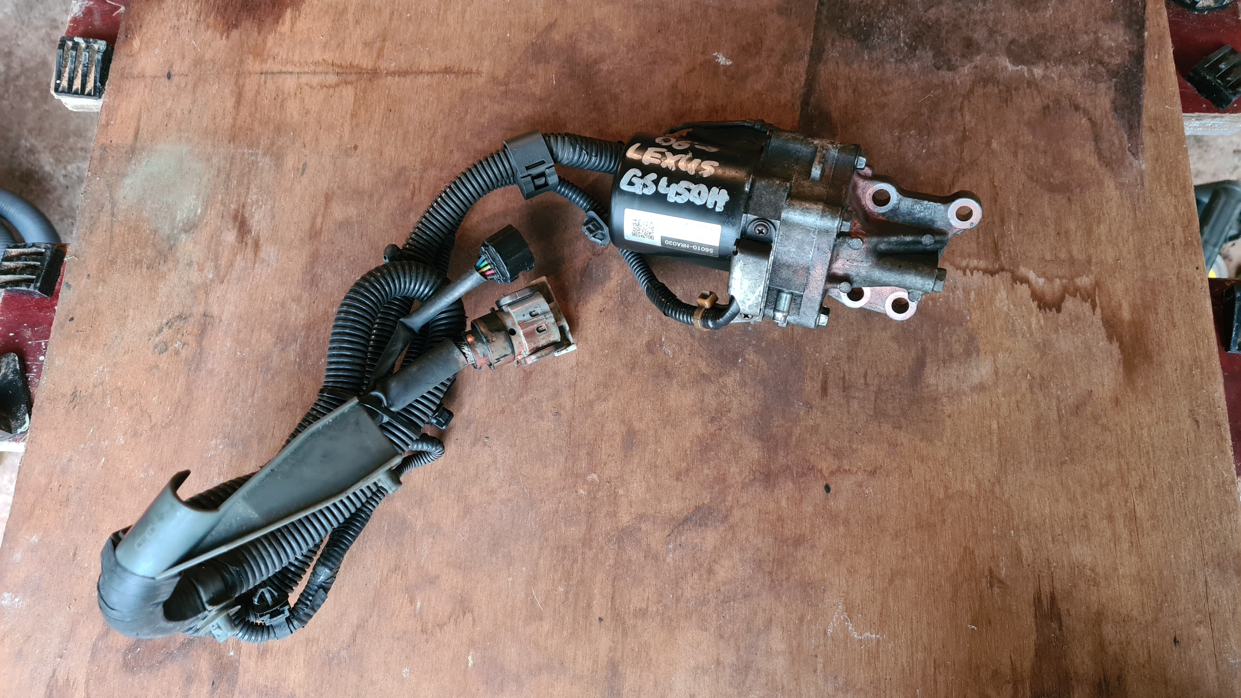

In the meantime, I'm having a go at restoring the Lexus transmission oil pump.
I've got the replacement bearings suggested on this wiki...https://openinverter.org/wiki/Lexus_GS4 ... ansmission
But I've already managed the strip the + screws! Will post some photos later so I can show others how NOT to do it!

Re: Reliant Scimitar SE5 (1971) with Lexus transmission

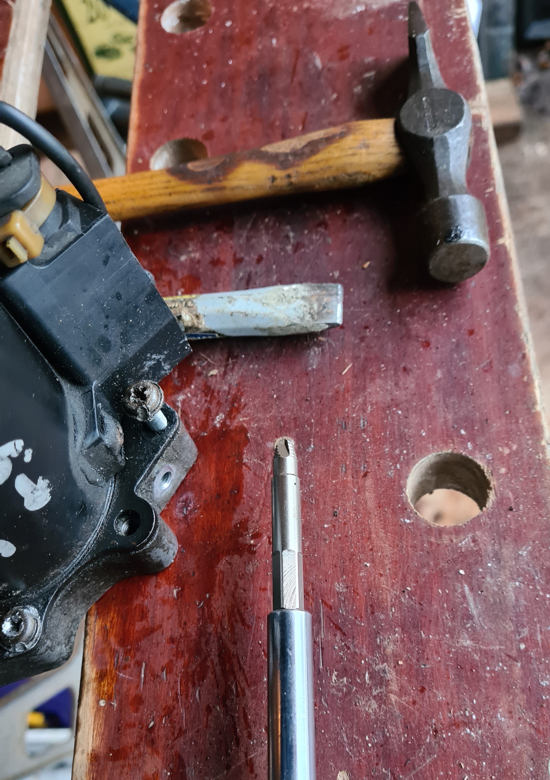

Ha, I hear ya on the oil pump screws. Had two to do and the first one disassembled lovely, job done. Second one the screws were solid and ended up stripped too. Thought I had messed it up, but drilled the screw heads slightly to smooth them out, wd40, then used an opposite hand drill bit on slow speed and they loosened up handy enough.

I don't think tagging works here (it didn't last time I tried) but most forums use @slanceley (did that work?).

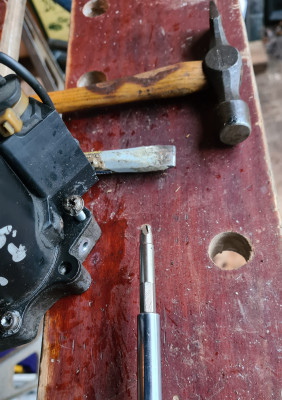

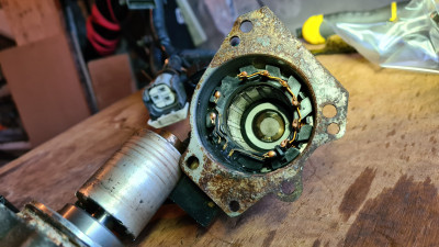

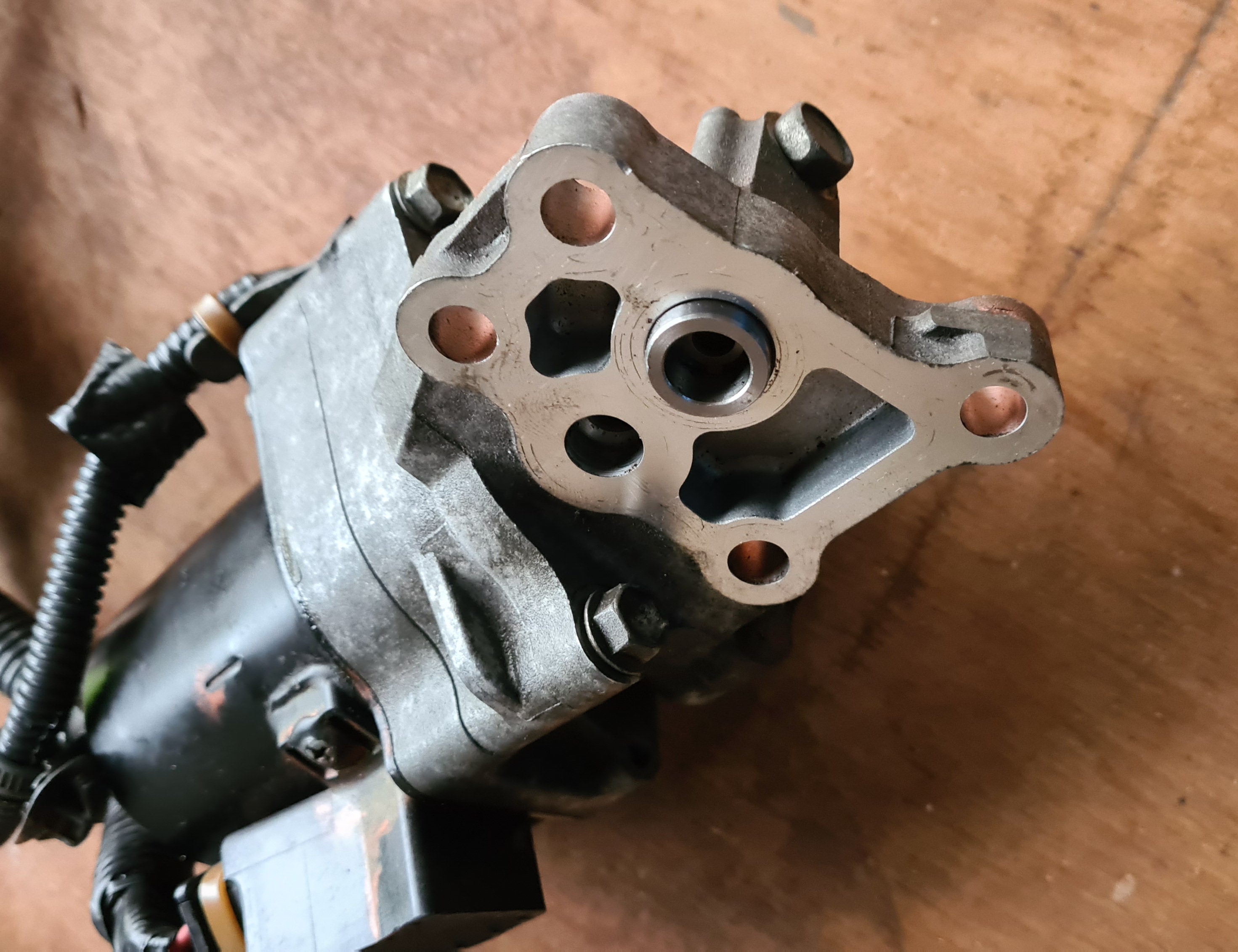

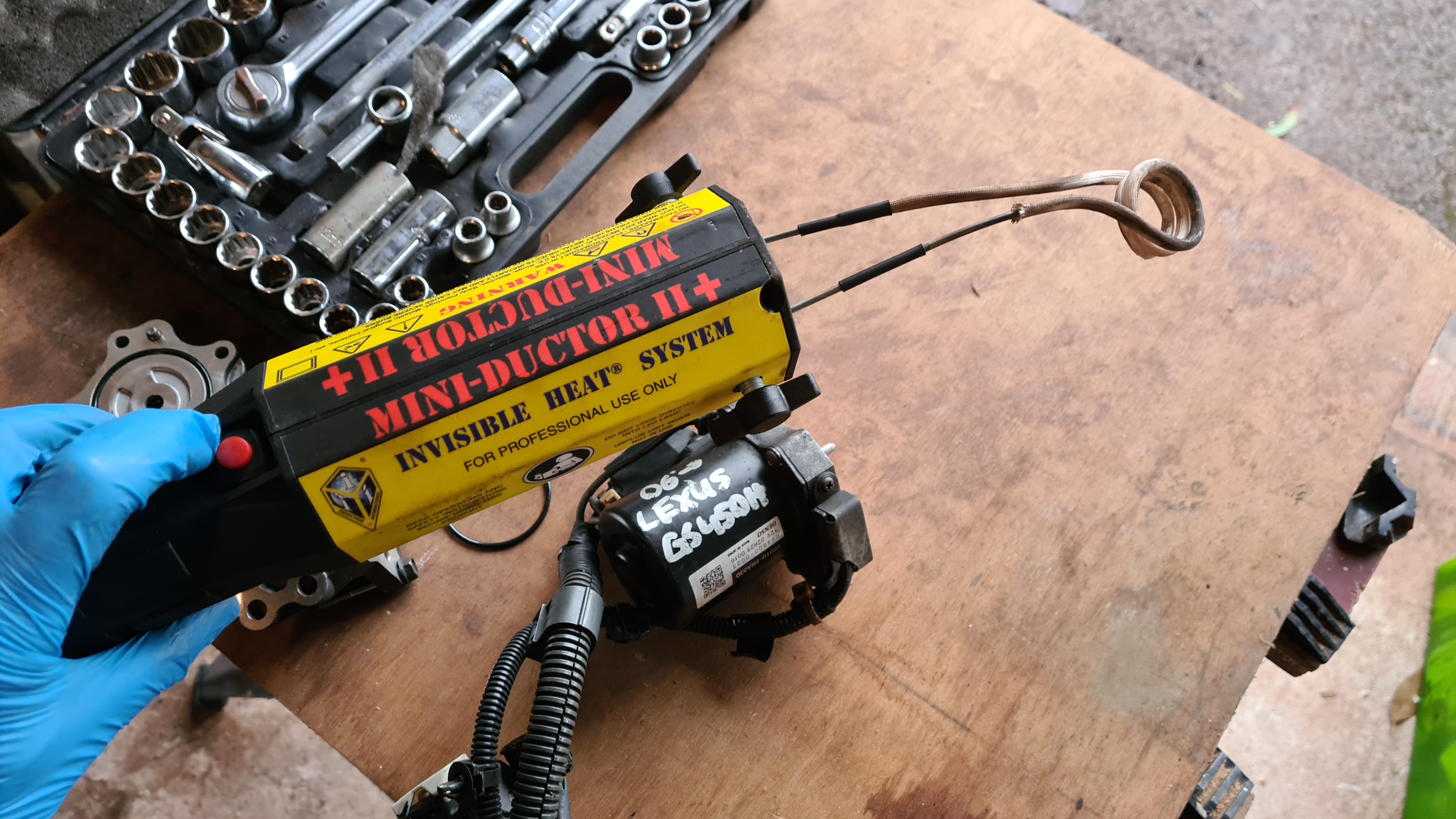

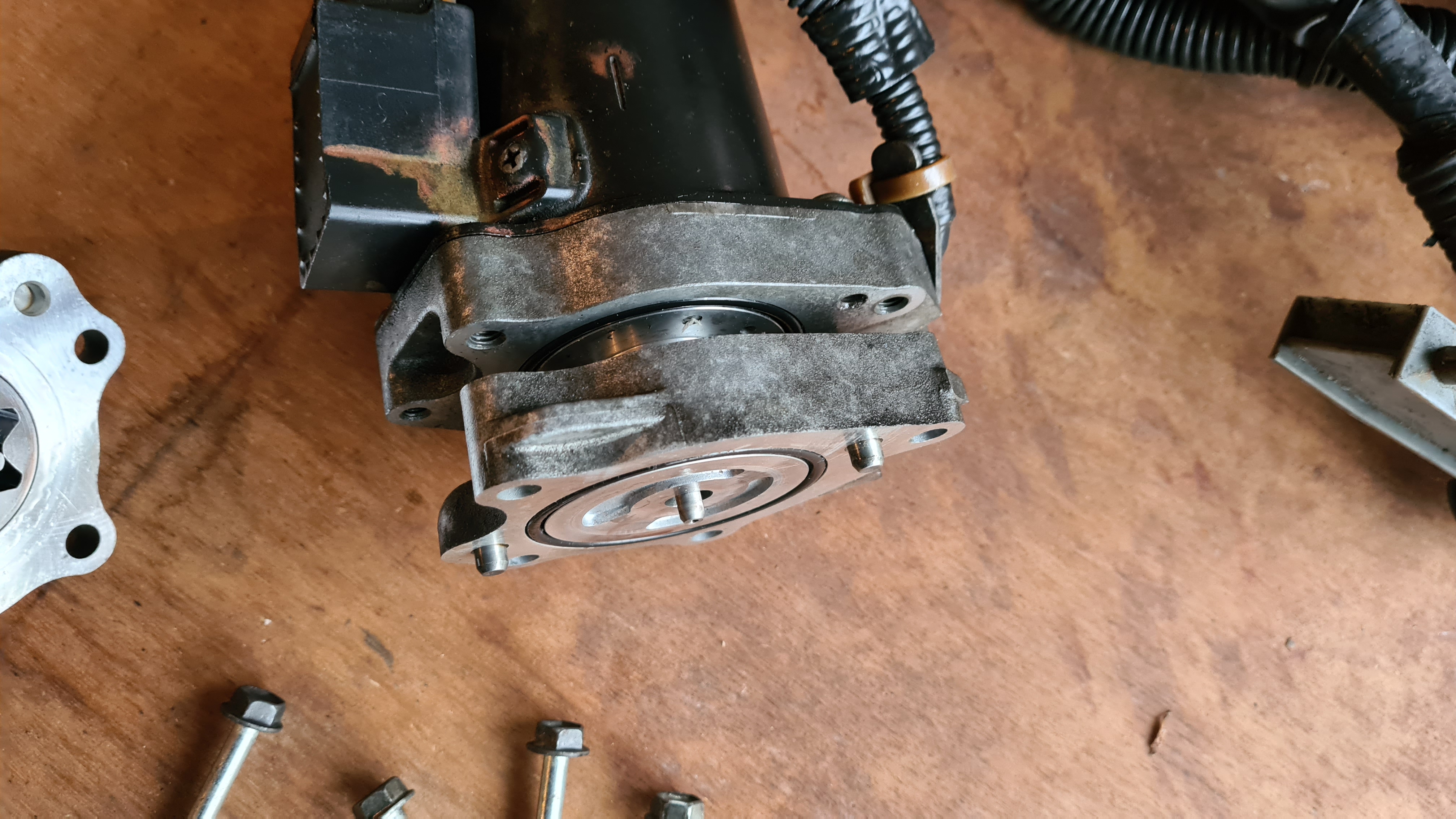

Decided to tackle this "easy" first job on my conversion, refurbishing the Lexus GS450H transmission oil pump that I had to buy (naively bought a transmission without one)
It has been a swine so far. Hope the other jobs on this conversion aren't as tiresome! (I enjoyed it really) The four bolts (10mm hex) came out no problem... but the three cross head screws were totally seized and I manage to strip them. Oops Out came my now indispensable induction heater and plenty of WD40... ...still no joy so I resorted to cold chisel (making a little notch first and then angling the chisel blows to eventually turn them enough to use a "damaged screw remover" bit. Bingo!
Oh that sounds like a great trick! Opposite hand drill bit... hang on this isn't like 'tartan paint', a replacement spirit level bubble or a long weight is it?

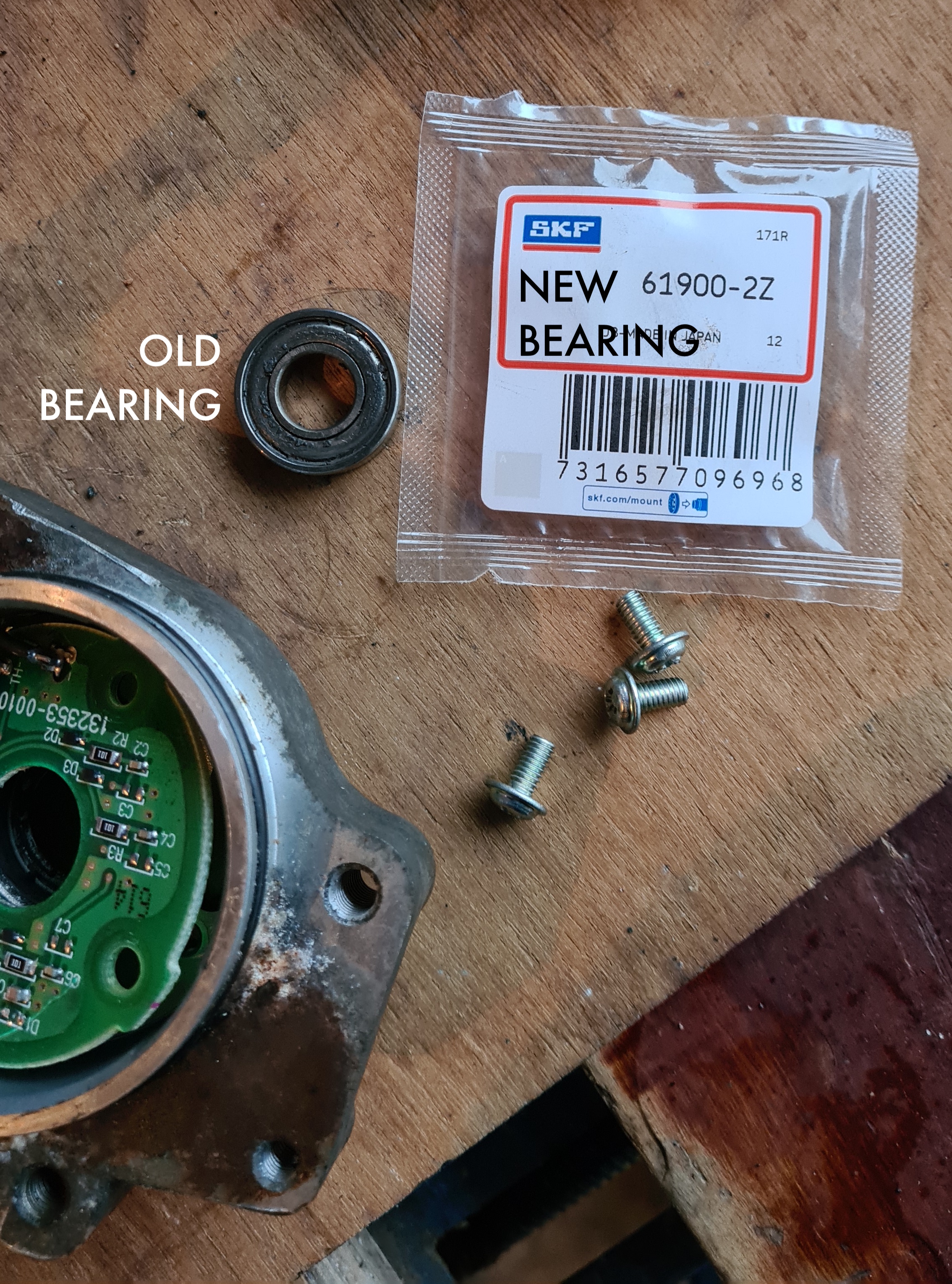

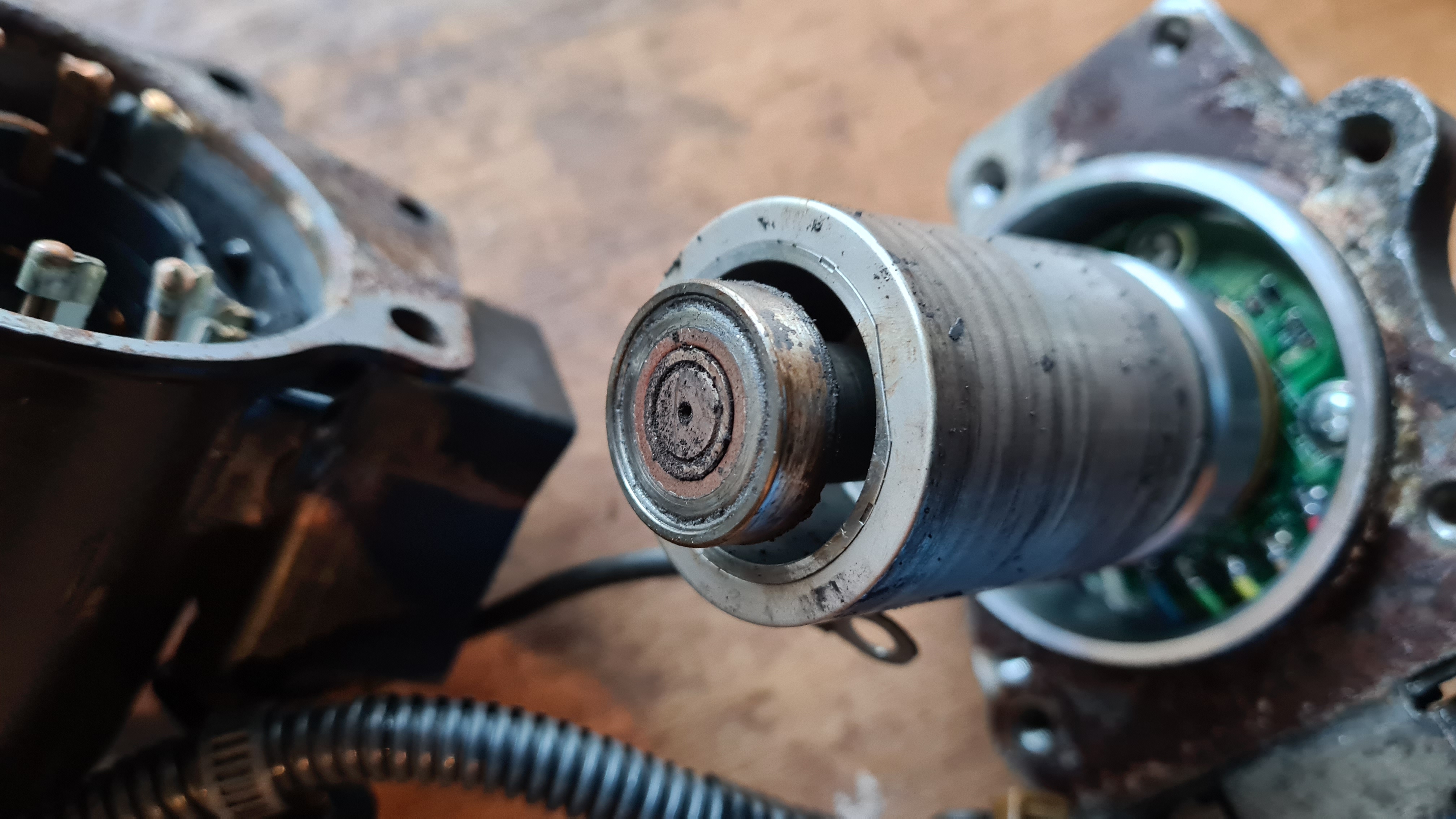

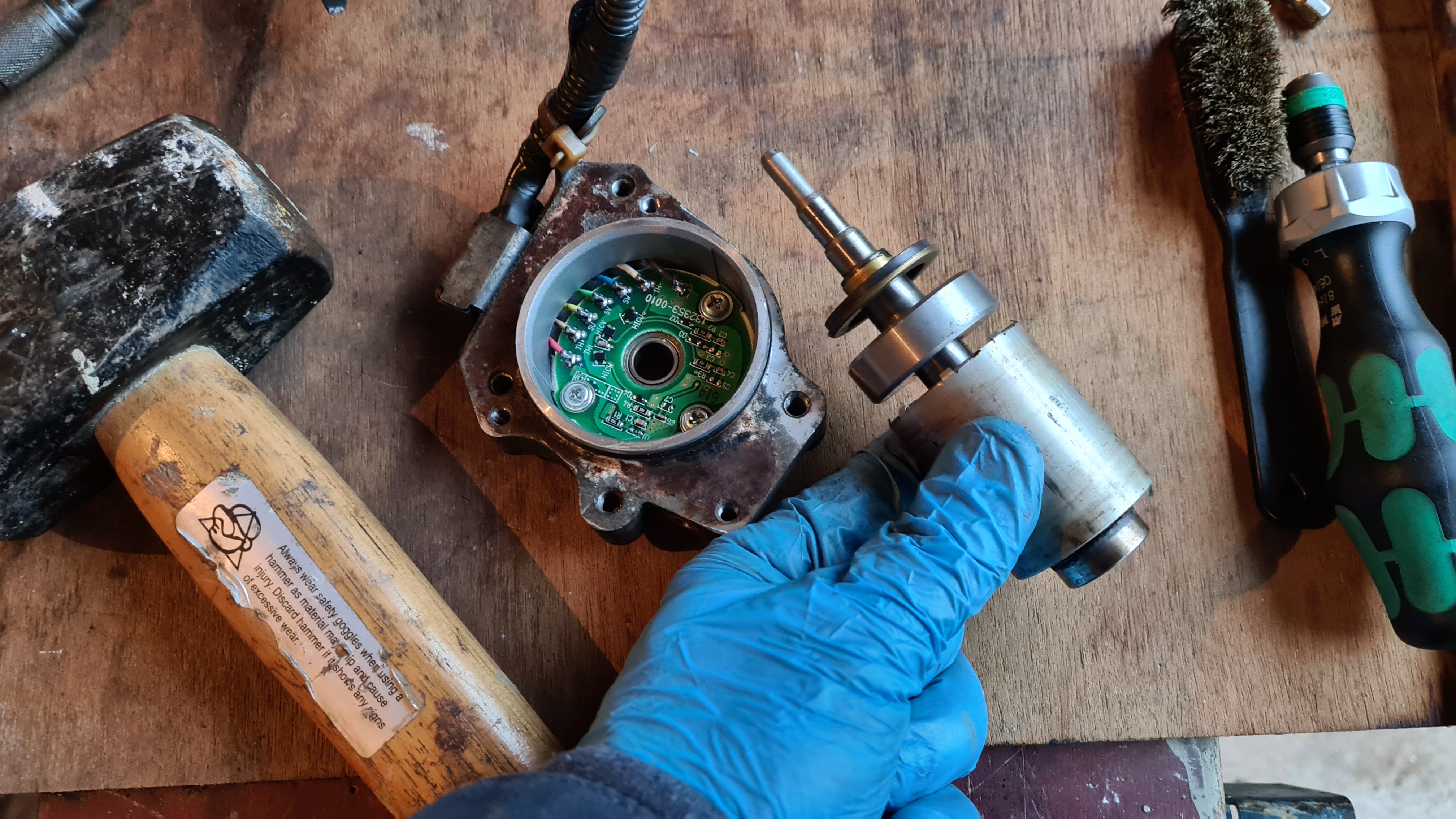

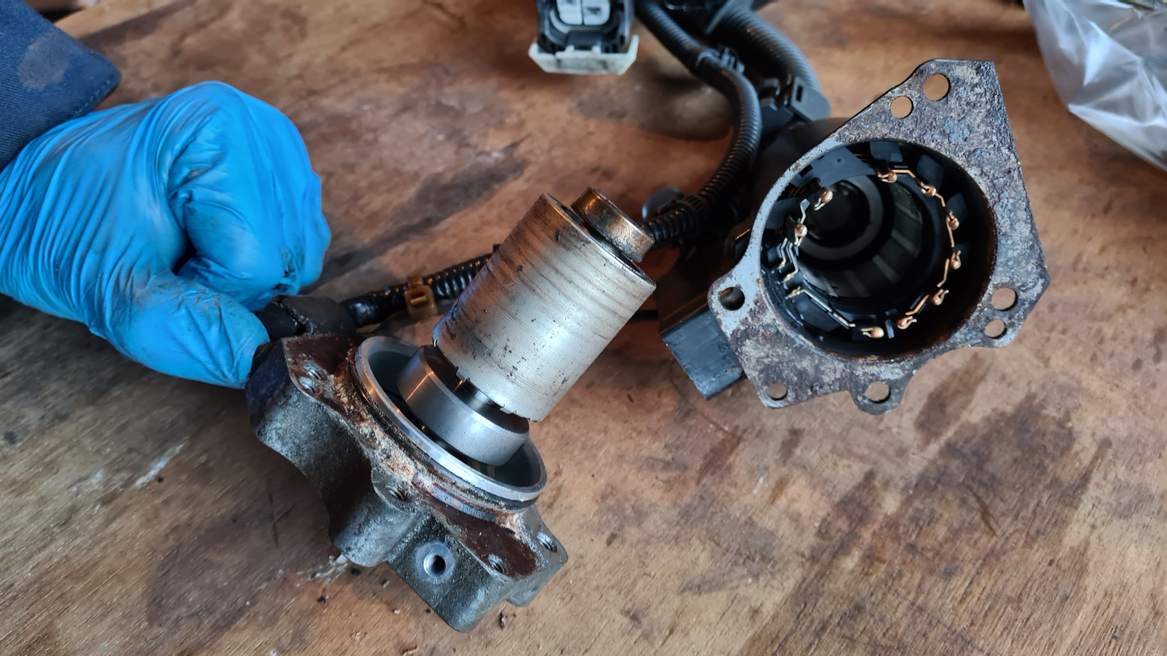

I think I might be going overboard with my photos so by all means let me know if this is too many!

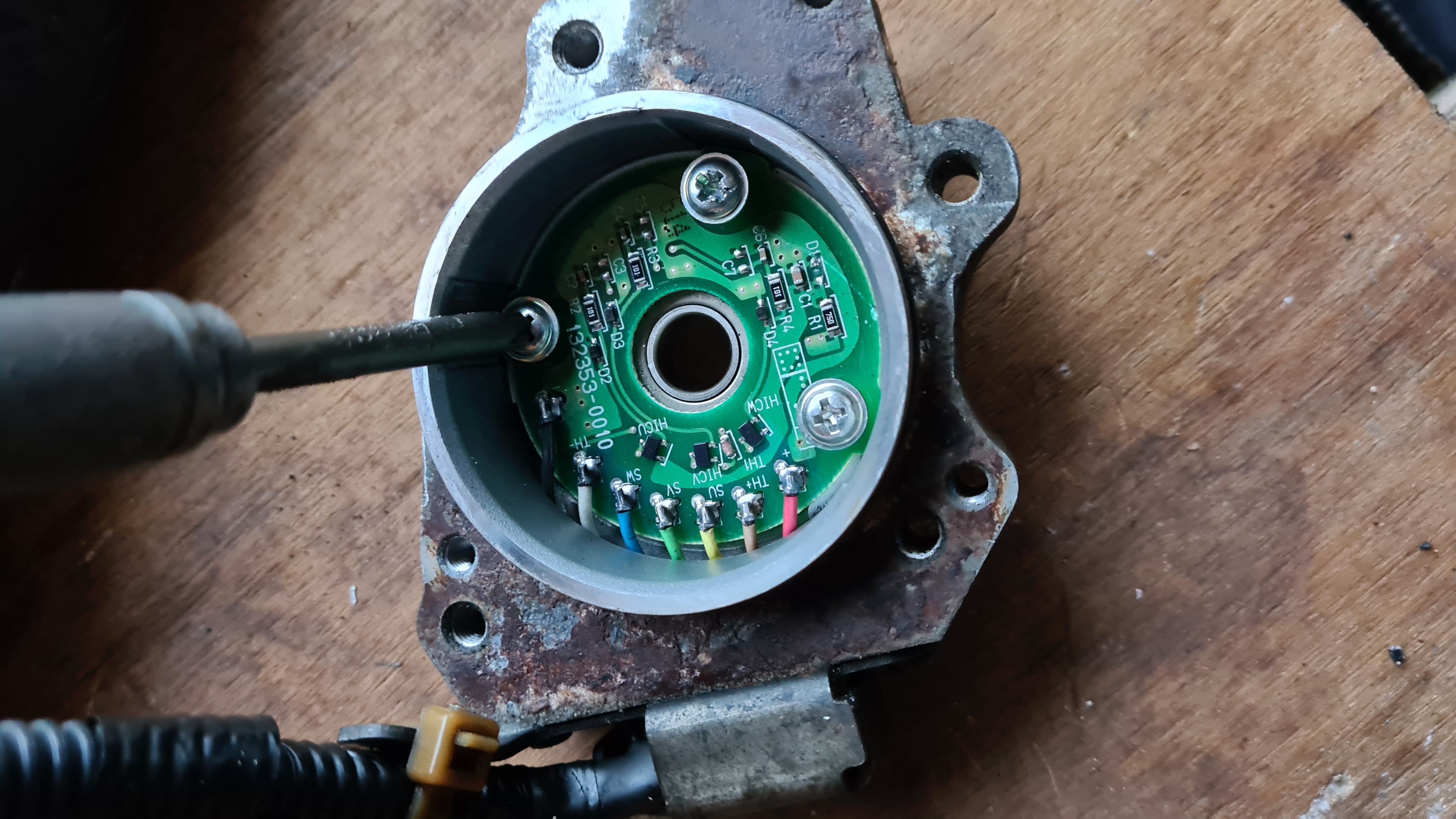

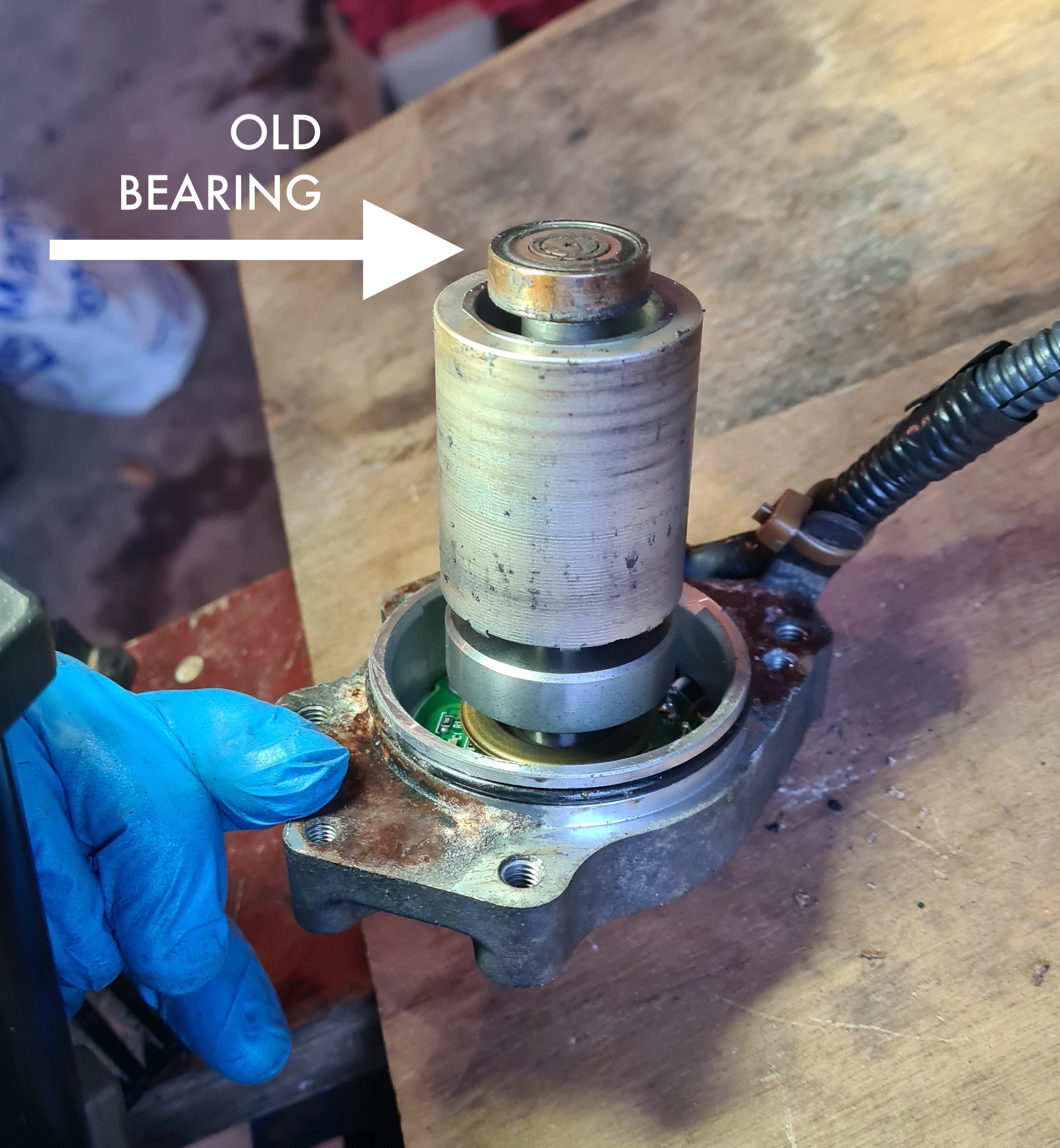

Then "gently" tapped the rotor to get it out
Unscrewed the three screws....
And checked the new bearing was correct (according to the wiki, two different bearings need to be replaced). It seems like the one under the circuit board is the 61900-2Z.

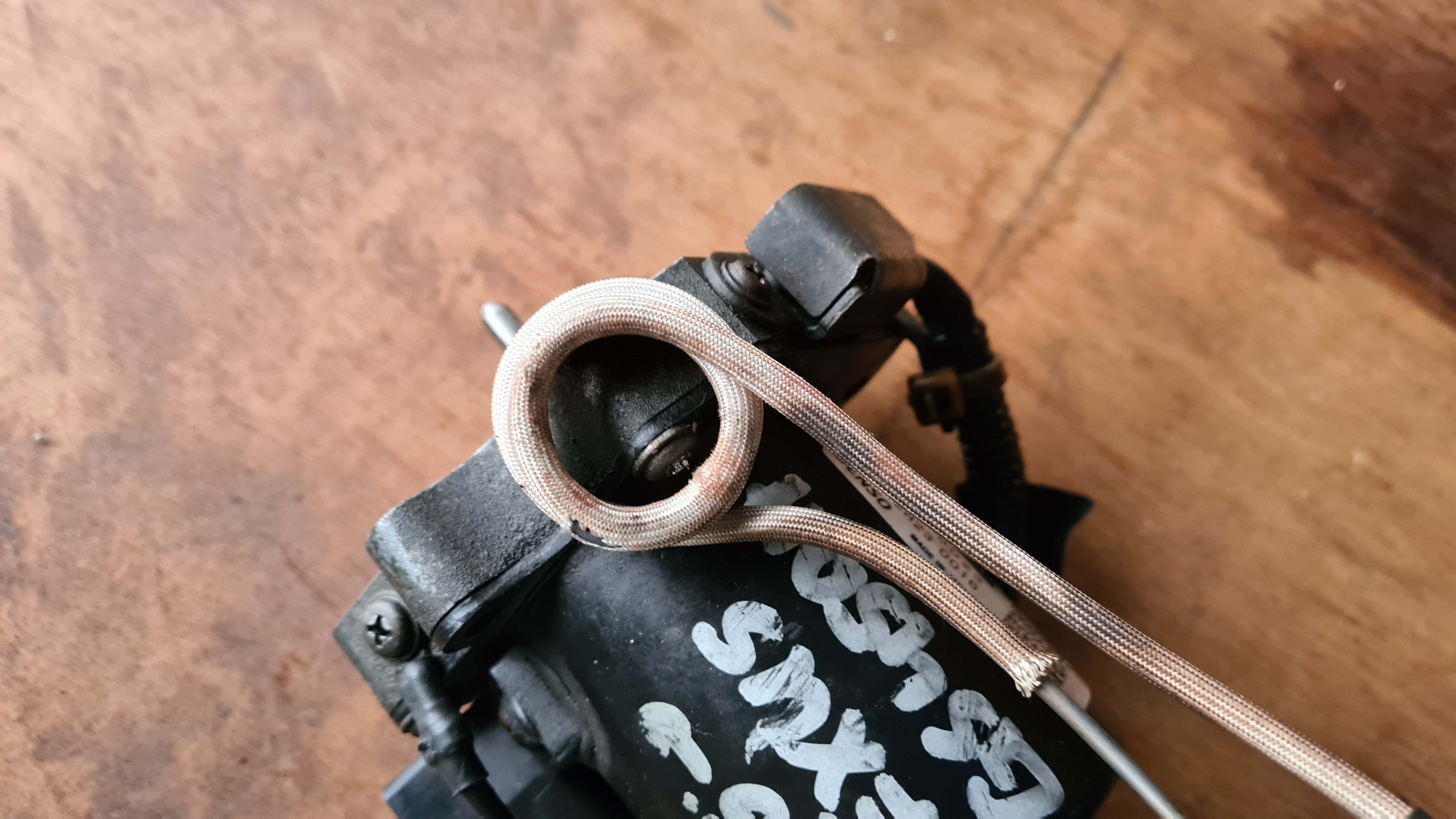

Next I need to get some replacement O rings (as some corrosion had breached the pump housing and damaged them - you can see in the photo that the metal is a little corroded too, I guess I ought to sand/brush it clean. Any tips for this?).
Sounds silly but when you are a newbie you soon find every little thing needs to be ordered in! eg rubber O rings, replacement screws that I stripped taking this apart, etc
Oh and the plastic seal thing, anyone who's done this refurb job already on the oil pump... did you replace the plastic seal thing? Can you point me in the direction of the correct part please if so? And any tips for how best to get the other bearing off (the rotor)? And lastly for today... am I right in thinking there's a gasket between this oil pump and the transmission? Any tips on how to do that/source one?
[/quote]
Ha, no not a rubber hammer suggestion. It grips in the opposite direction. Similar to the dedicated tools for the job. Doesn't always work that great though.

I've changed the bearings on two of these pumps but didn't have to change the seal you mentioned so can't help there.
For getting the bearing off the rotor, I found these weren't overly tight. I let them soak up some wd-40 for a bit, then used two flat screw drivers opposite sides of the bearing pushing on the rotor (maybe not the best anchor point) but worked slowly and kept an eye for any issues. Once the bearing started to move it came off handy. A small bearing pullers would be better solution possibly but more bits to buy for one off jobs!
For the seals, one of the pumps came with the seal. I can't find a pic from when I removed it. Was a profiled plate seal, so I refit that. Wasn't one on the second pump so I used a small bead of gasket sealant instead. I couldn't find the correct seal to buy any way handy. Not tested with full oil pressure yet though!
- SciroccoEV
- Posts: 370
- Location: Luton UK
- Been thanked: 16 times
You need a puller plate, something like the one I made for overhauling Morini starter motors, you can see it shortly after the 3 minute mark;
Ah thanks nkiernan, appreciate your input. I've asked a Lexus parts place for the gasket but if i don't hear back from them, it sounds like i might have to use the gasket sealant idea.
