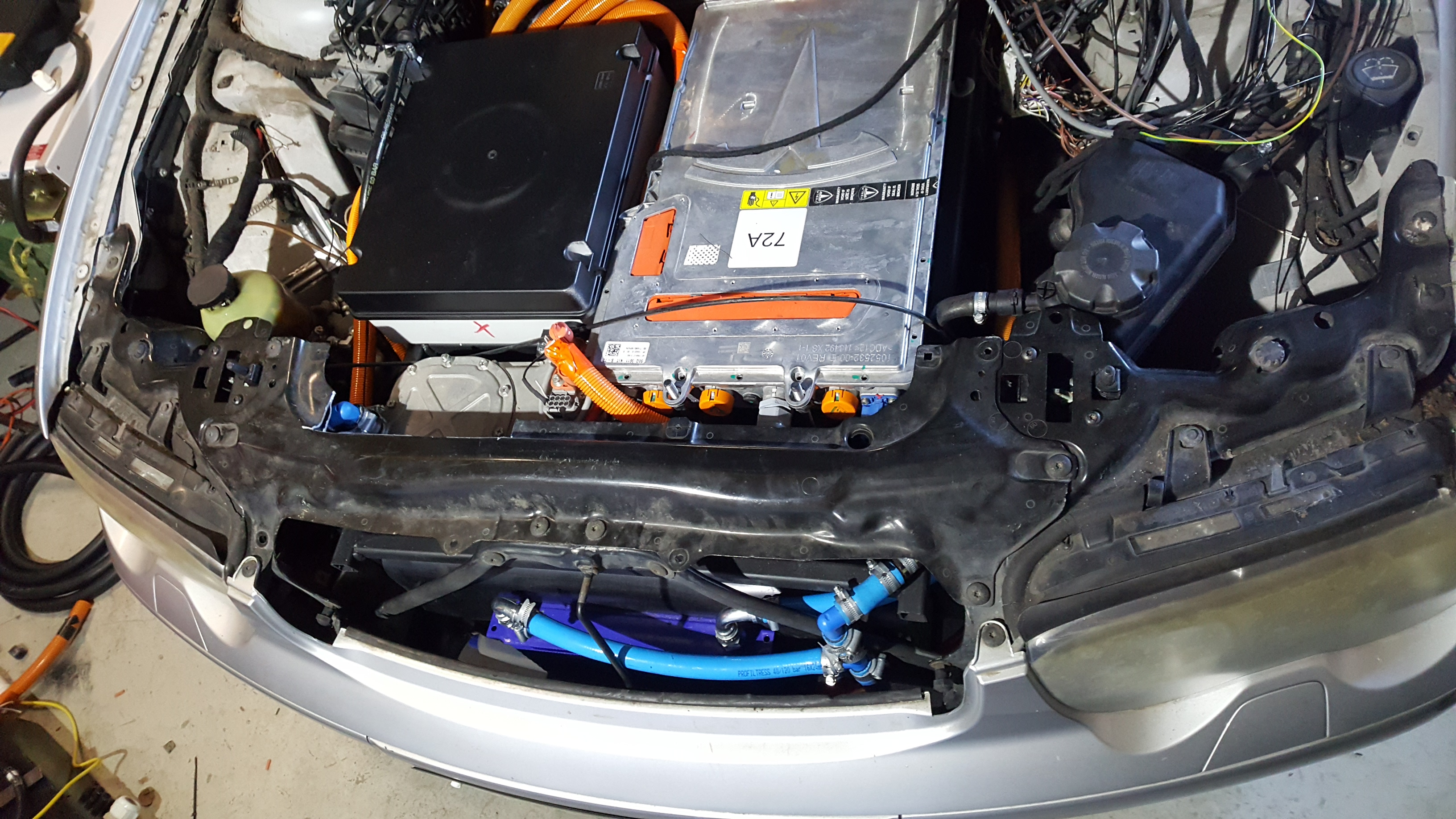

- Posts: 4000
- Been thanked: 1114 times
Re: The SuperYacht BMW E65 7 Series
Front of the car all back together. Next up wiring in the V2 VCU with Wifi and ISA Shunt interface.

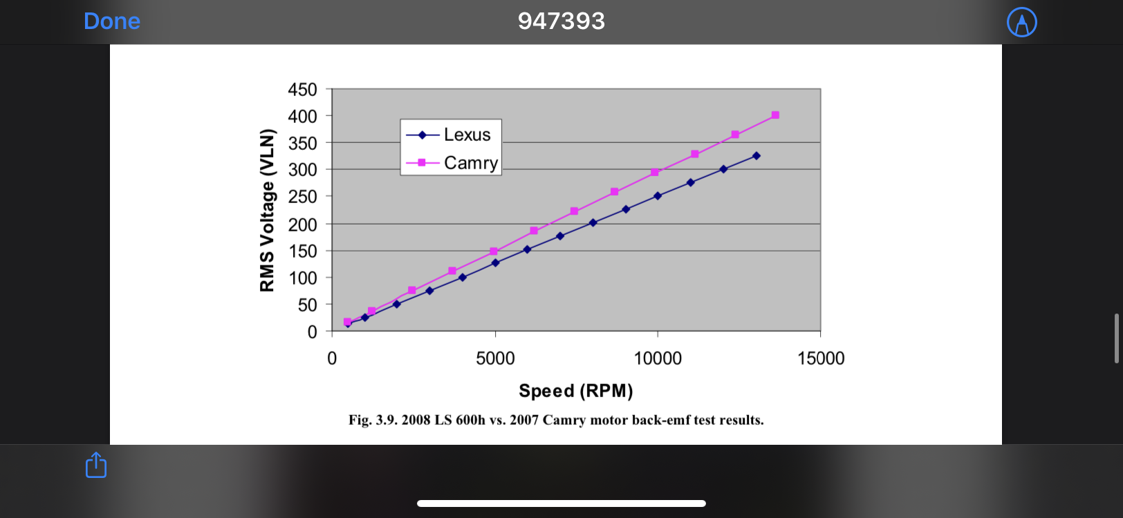

Also it appears (just as Damien said) that voltage won’t be an issue to run the full 10,230 rpms. Here are the back-EMF test results.
Ah, that's interesting, I missed that bit.
I can't understand why they bothered to run 650v in the actual car, it seems unnecessary.
Unless the high voltage actually for MG1 rather than MG2. I think in the Prius MG1 is very low torque but high RPM.
I estimated that with the input shaft locked in the GS450h transmission, MG1 should be running in the region of 2.5x the speed of MG2 due to the planetary.
