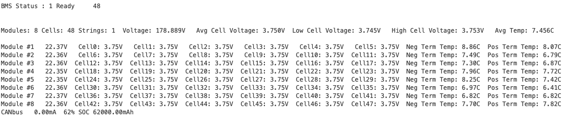

I recently loaded the Tesla modules into the 'belly' battery box and spun up SimpBMS. Impressive to see that after two years on the shelf the difference between high and low cells on 8 modules is 8mV :o

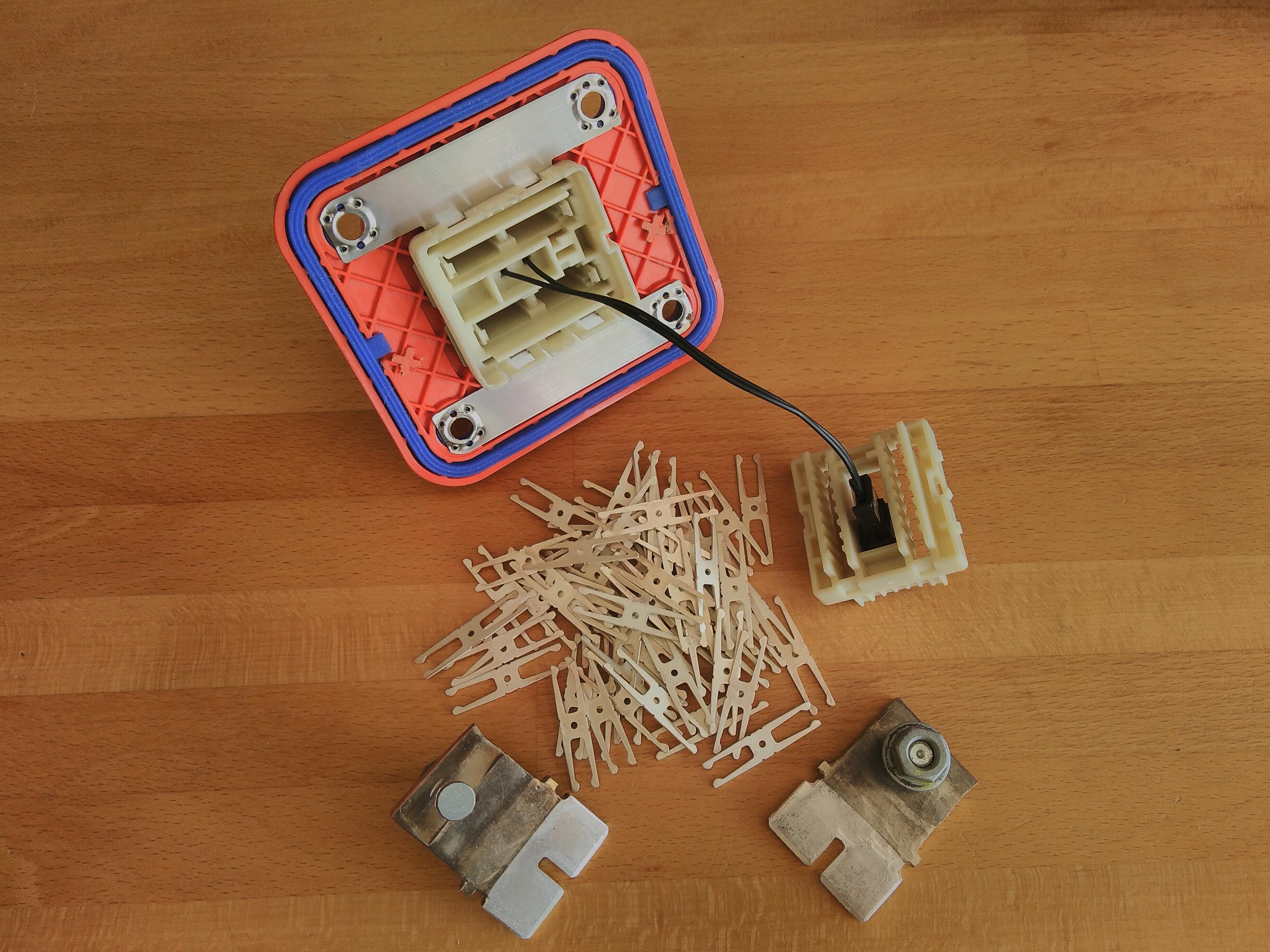

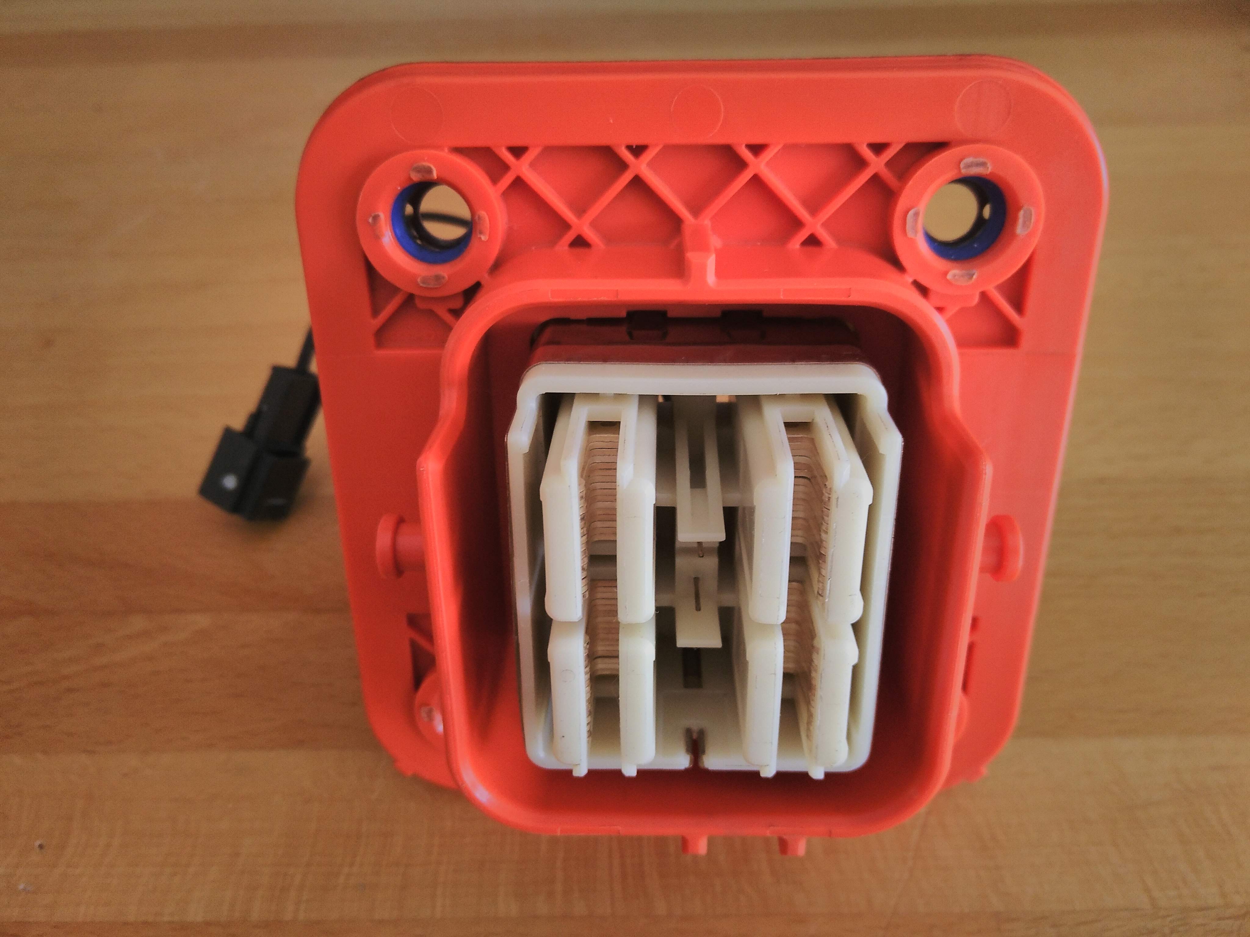

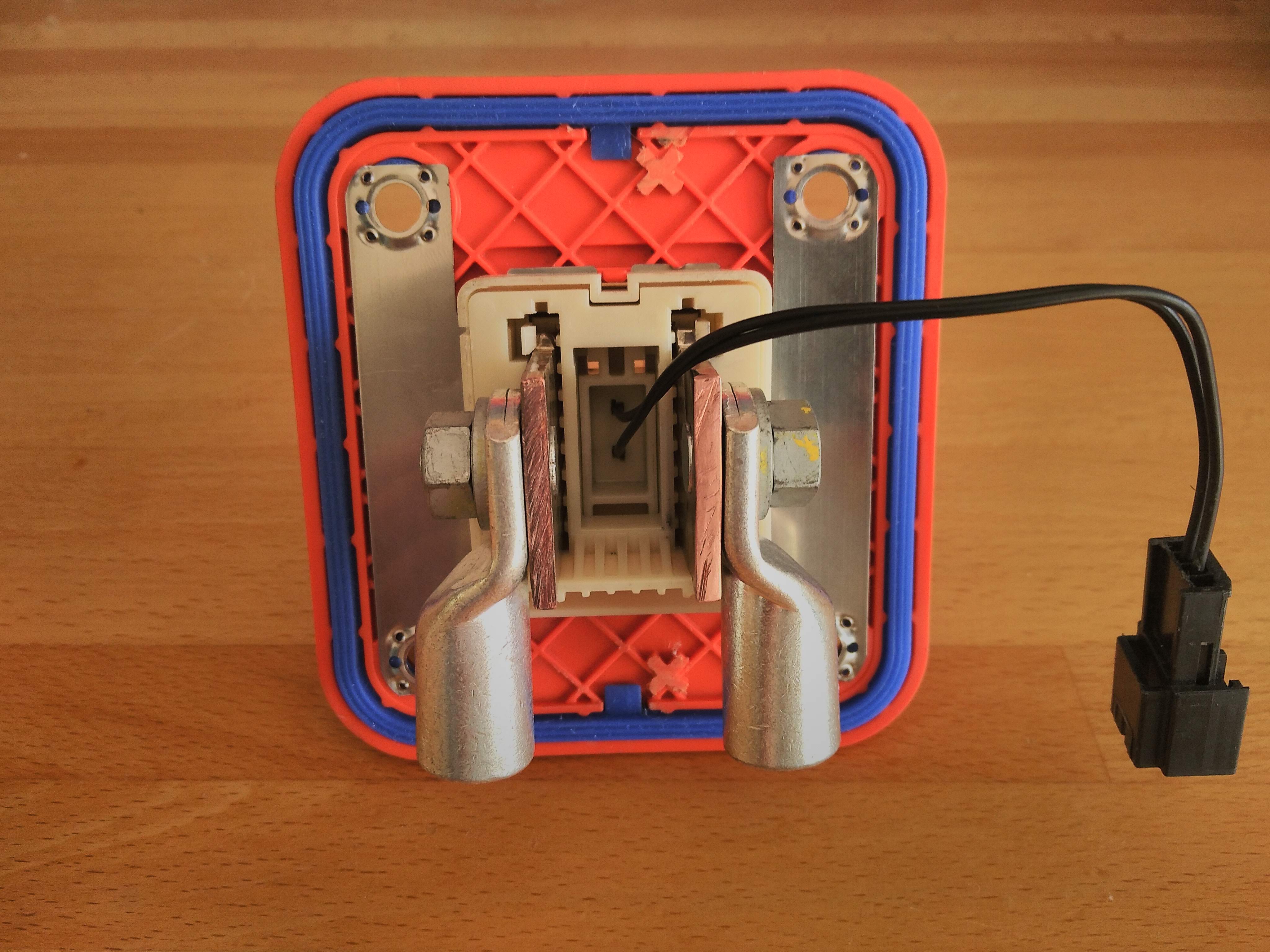

Had some fun modifying the Tesla Model 3 HV connector ready for final assembly of the "belly" battery 8-)
Happy to report you can anneal and straighten the ~4mm copper without damaging the 'tin' surface used in the connector wiper area.

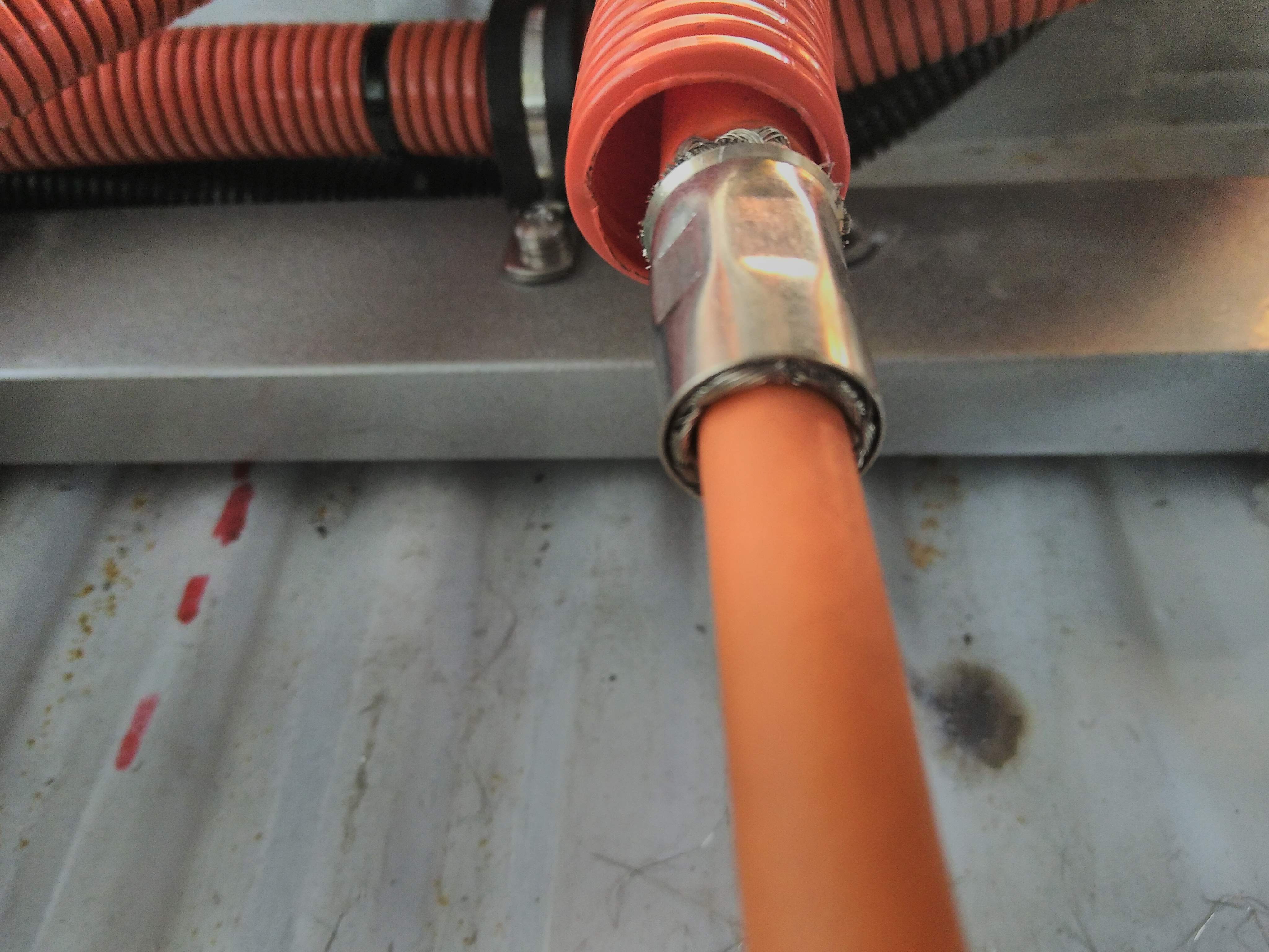

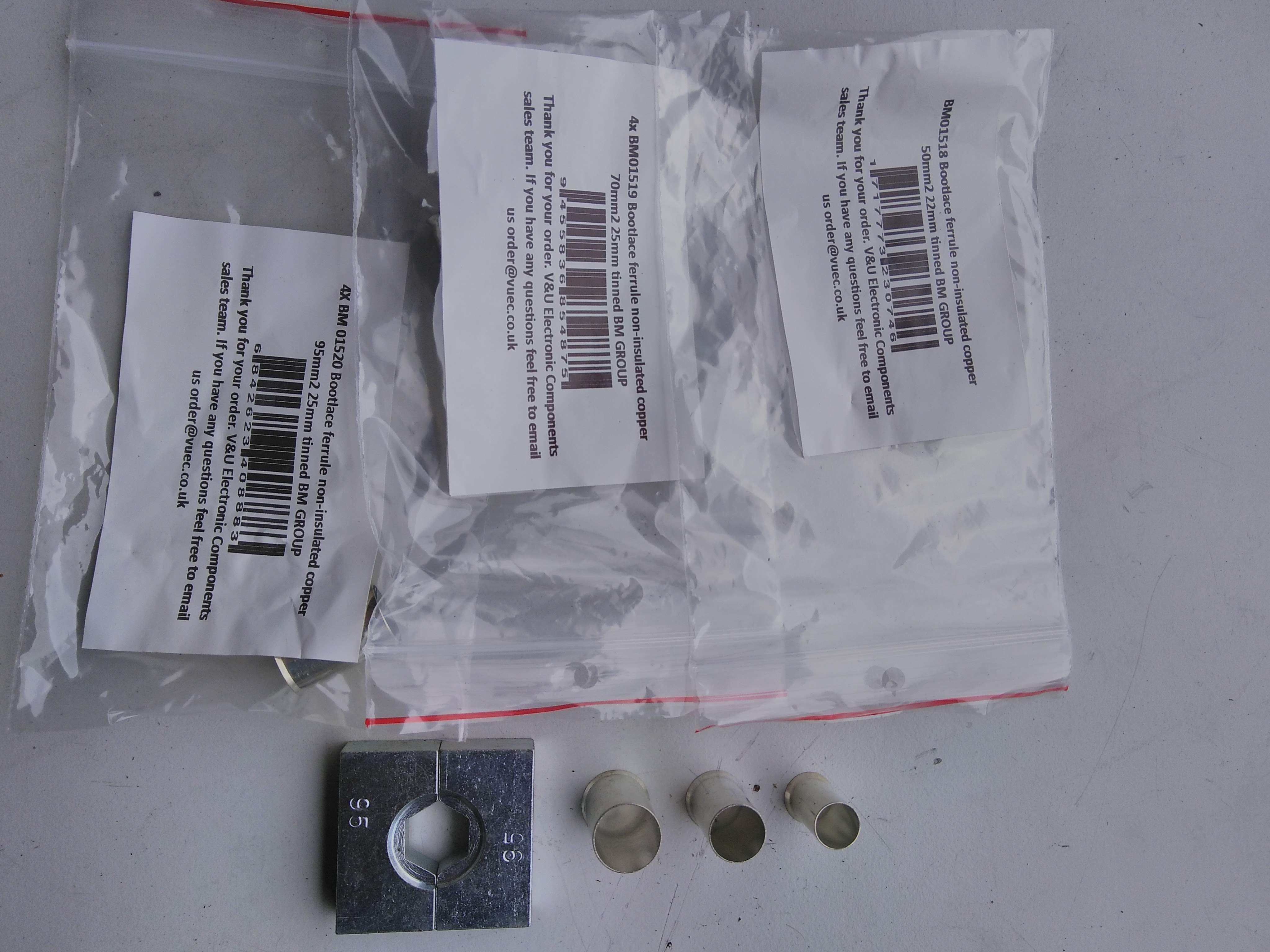

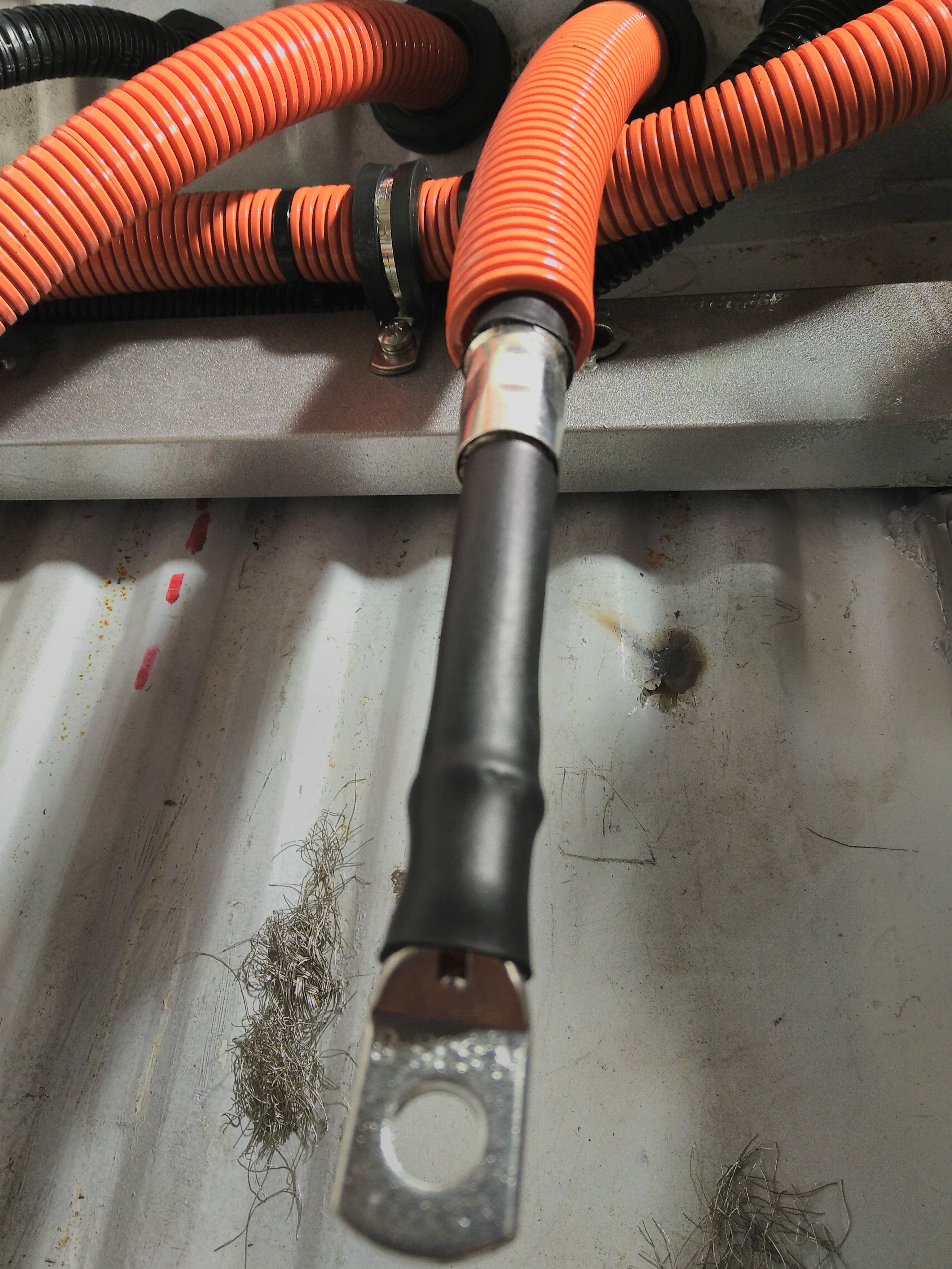

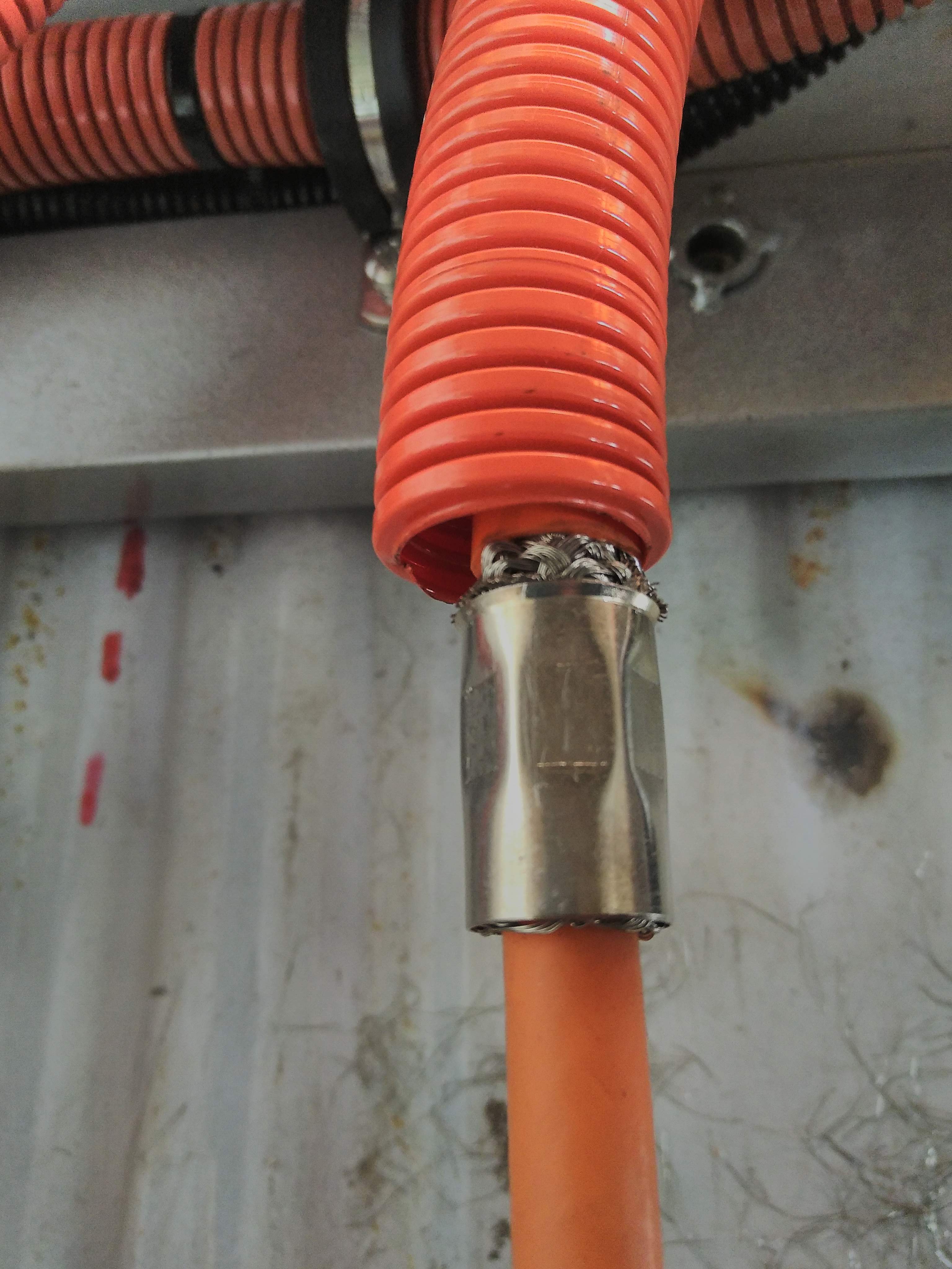

I've been experimenting with terminating the screens on Tesla HV cables.
For the 35mm2 SDU cables I used three ferrels which had the screen braid sandwiched between them. This sandwich was gently crimped with a 95mm2 die (being careful not to damage the insulation of the central HV cable) and then heat shrink was applied to both ends to make the assembly look neat. The end result makes a good electrical connection to the screen and fits nicely in the Tesla HVJB.
When I get time I'll try some of the larger Tesla cables.
DaveH
Posts: 93
Joined: Sat Jun 13, 2020 9:04 am
Location: Hull, UK
Been thanked: 11 times
Re: ICE Breaker - 1967 VW Splitscreen Bus with Tesla Drivetrain/Battery
Post by DaveH »
How is the screen itself terminated to ground? Via the glands?

DaveH wrote: Tue Aug 25, 2020 4:40 pm How is the screen itself terminated to ground? Via the glands?
The glands are clamped into the Tesla HVJB just like the original cables.
