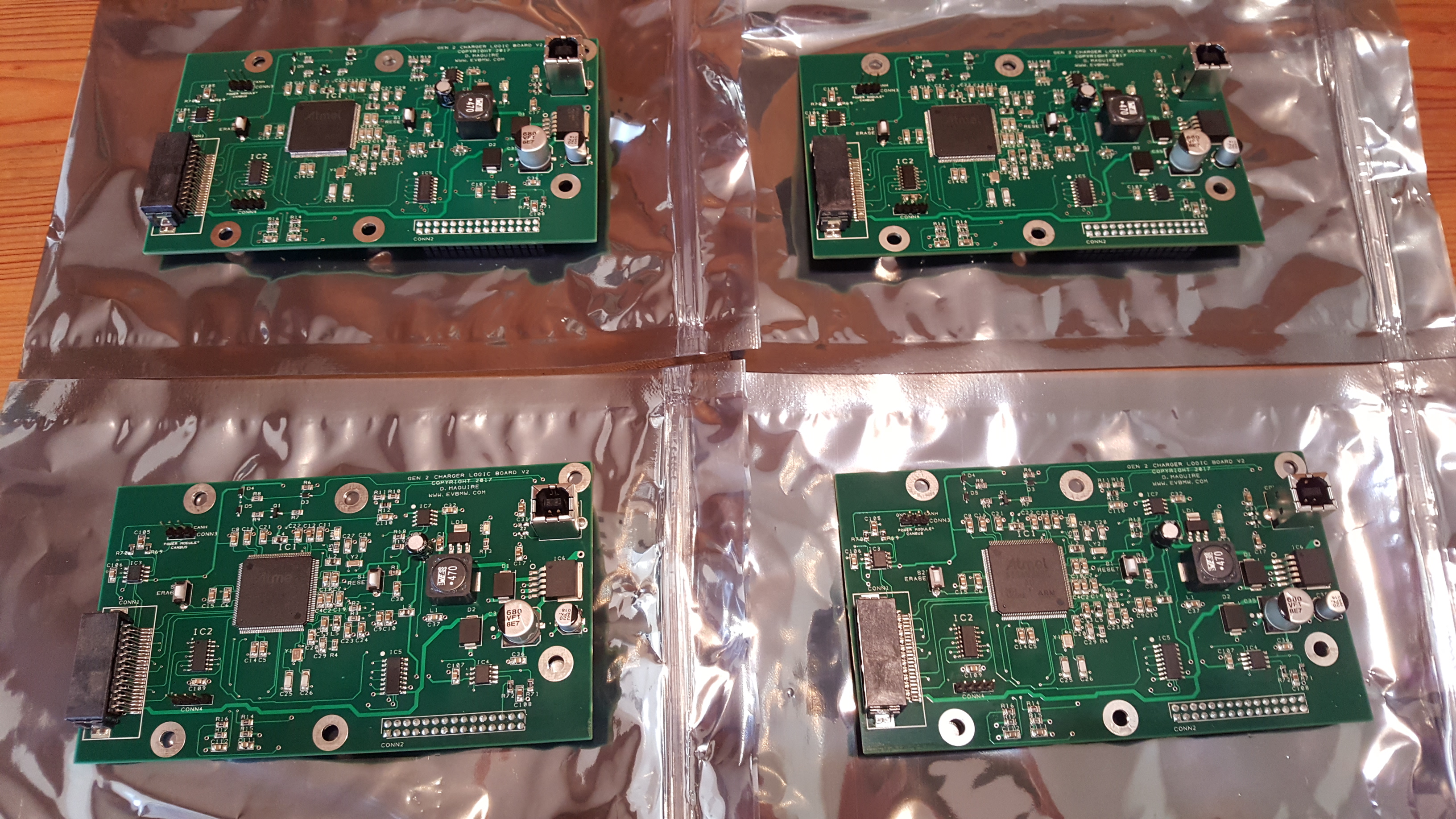

Last of the Gen2 logic boards before the upgrade just in.
New rev will include :
SW CAN for future compatibility with Tesla destination and supercharging and Tesla Chademo adapter. I'm ignoring any legal/moral issues here regards using Tesla charge points. Just making the hardware future proof.
Extra I/O for controlling HVJB.
Onboard Xilinx XC2C64A Coolrunner 2 CPLD for handling extra functions including a BIT (Built In Test) routine and shutdown / wake of the main 5v rail.
ESP32 WiFi header for future upgades. e.g. web interface.
DS1302 battery backed RTC (real time clock) for scheduling charging.
Onboard LEDs to indicate fault states.
Mini USB connector.
Expecting to release in around 6 weeks once tested. Fully backwards compatible with existing software.

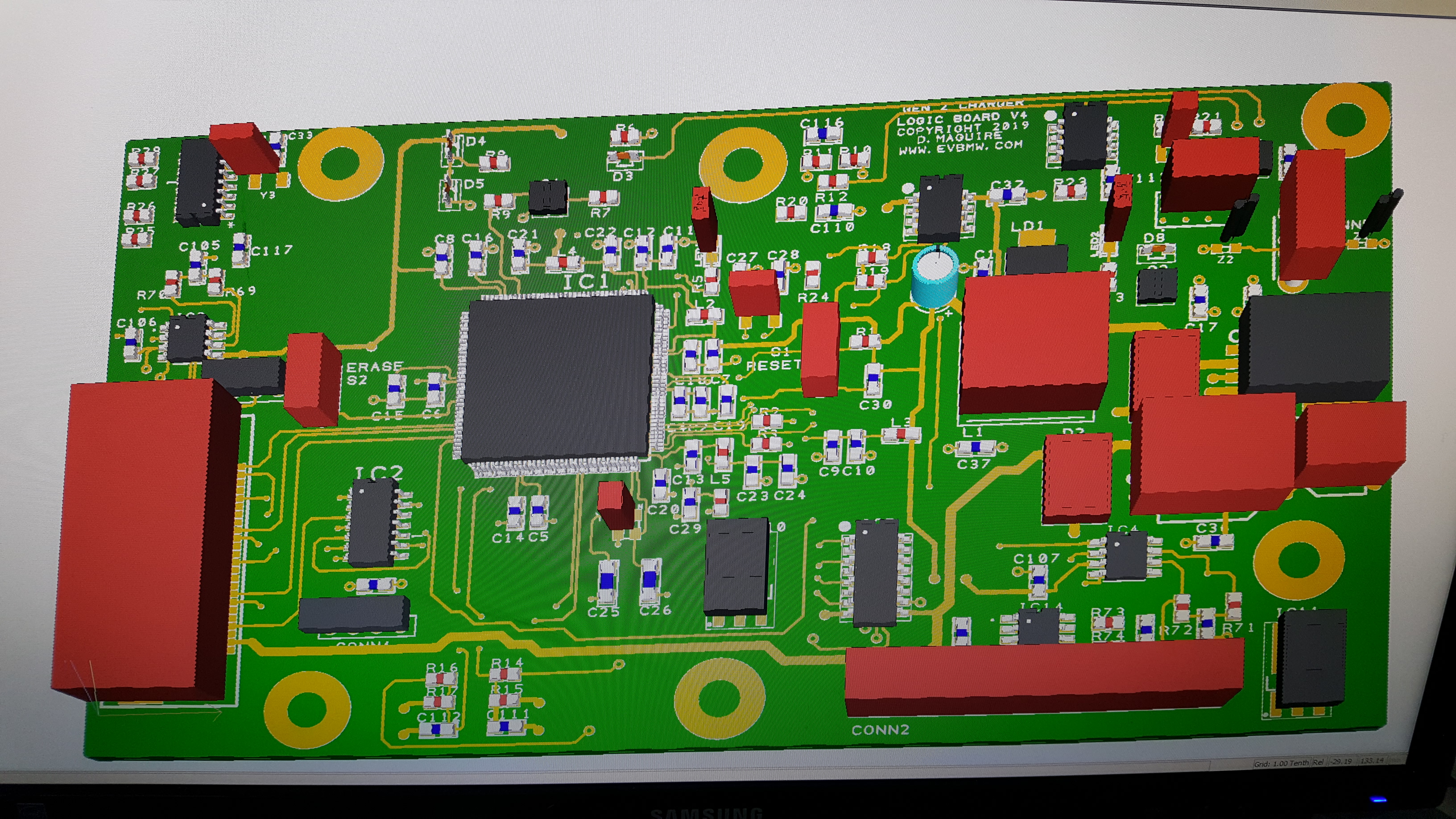

Design and pcb layout done. Schematic in PDF format up on Github :
https://github.com/damienmaguire/Tesla- ... ematic.pdf
Design files will be released as soon as I confirm pinouts on a few parts are correct. Particularly the USB socket:)
all comments / suggestions welcome.

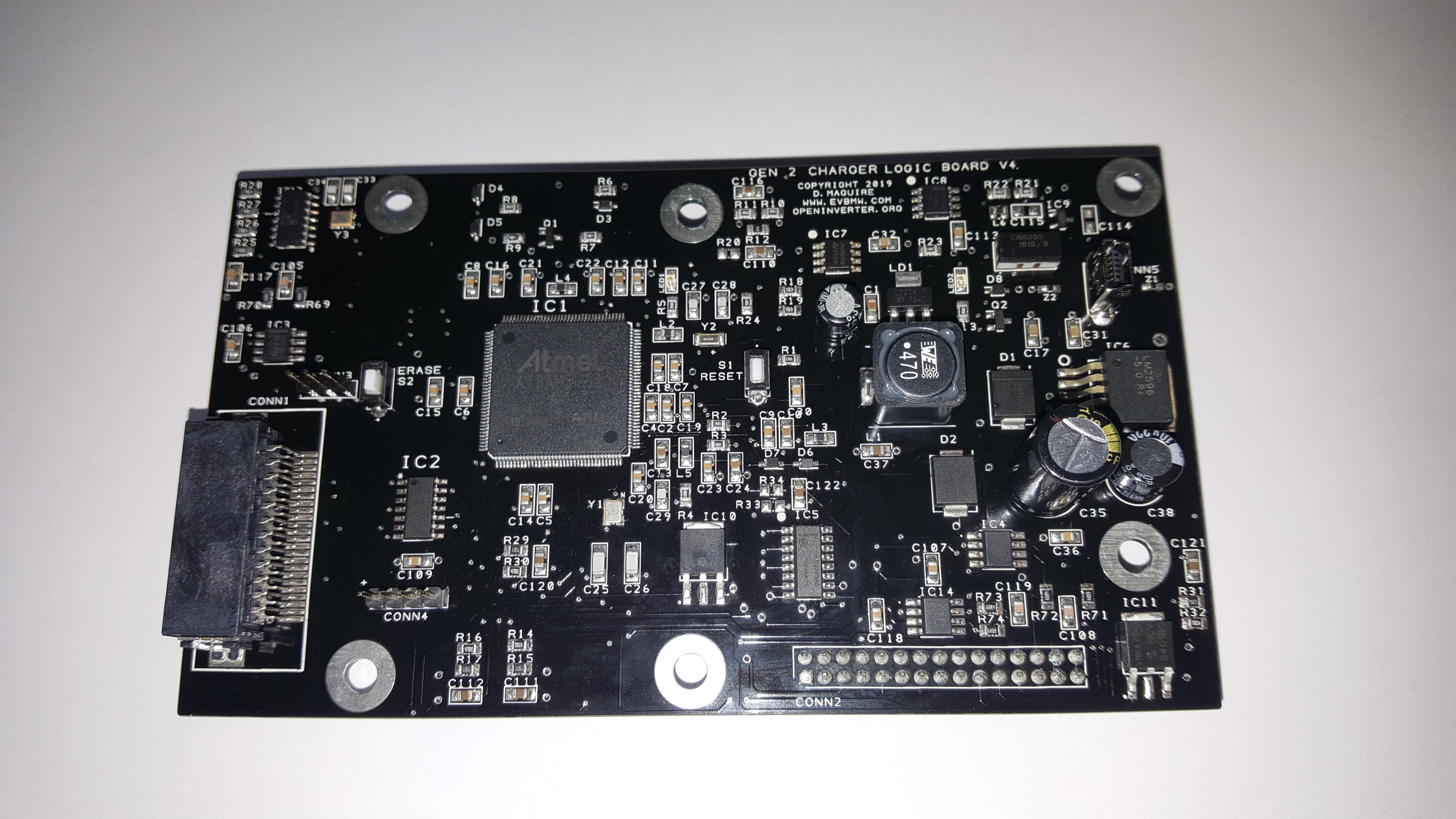

Naturally the library part for the USB connector had the pins assigned wrong. That would have been fun. PCBs ordered and design files released.
https://github.com/damienmaguire/Tesla- ... gicBoardV4

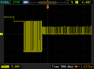

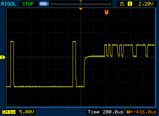

As promised, this is what a charging session between a Model 3 and TWC 4.5.3 looks like:
- Charger idle @ 12V.
- Plug Inserted @ approx 700mS. Signal pulled down to 9V by car's 2.74k resistor ('Vehicle detected').
- Approx 1.3s. TWC starts generating 1KHz CP signal.
- Approx 2.6s comms switch to SWCAN
- First 1KHz pulses have positive peaks at 9V ('Vehicle detected')
- Car then switches in 1.3K. Peaks drop to 6V ('Ready/charging')
- 11 pulses later, switches to SWCAN
- It appears line is released (not driven by TWC) shortly after 11th pulse.
- SWCAN starts shortly after. Its not yet clear which device starts talking first.
I wonder if this is why some third party vehicles refuse to charge.
More to come....

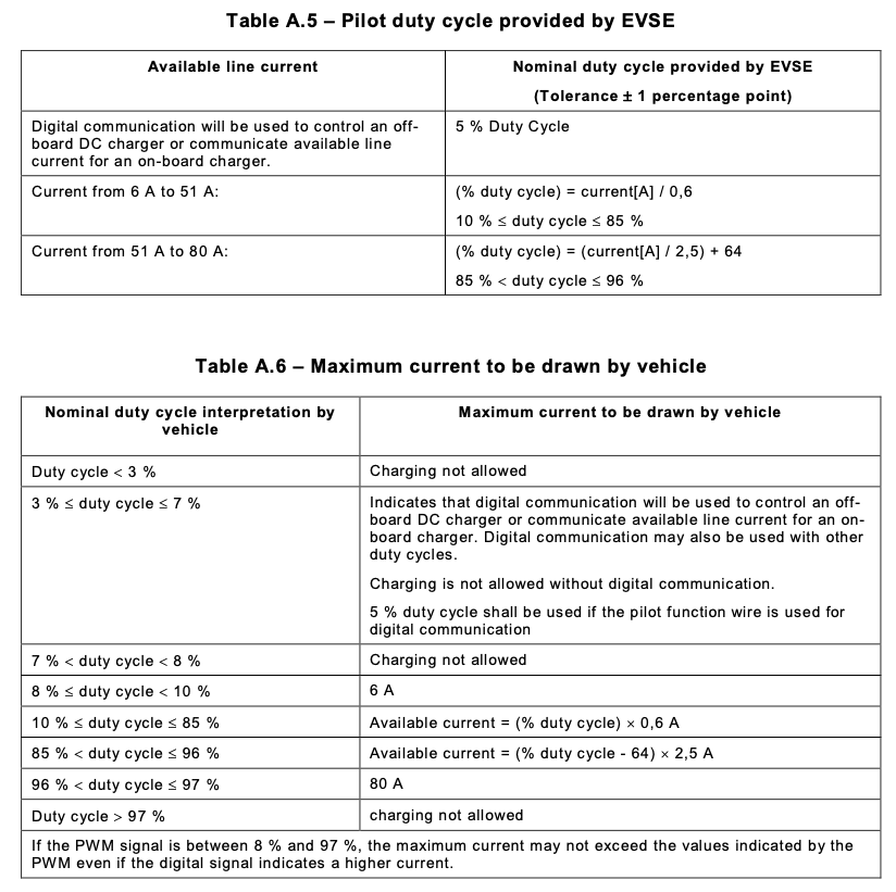

Re: New Tesla charger board
5% duty cycle indicates digital communications. Here's an extract from IEC61851-1{ed2.0}
It's possible that cars have bugs or that Tesla are doing something strange in the TWC. Certainly early Model S had issues when the EVSE commanded 6A.
Thanks.Kevin Sharpe wrote: ↑Sat Jun 06, 2020 6:02 am 5% duty cycle indicates digital communications. Here's an extract from IEC61851-1{ed2.0}
What does IEC61851 define as digital comms? I believe it is ISO 15118-3 HomePlug Green PHY for talking to DC fast chargers.
