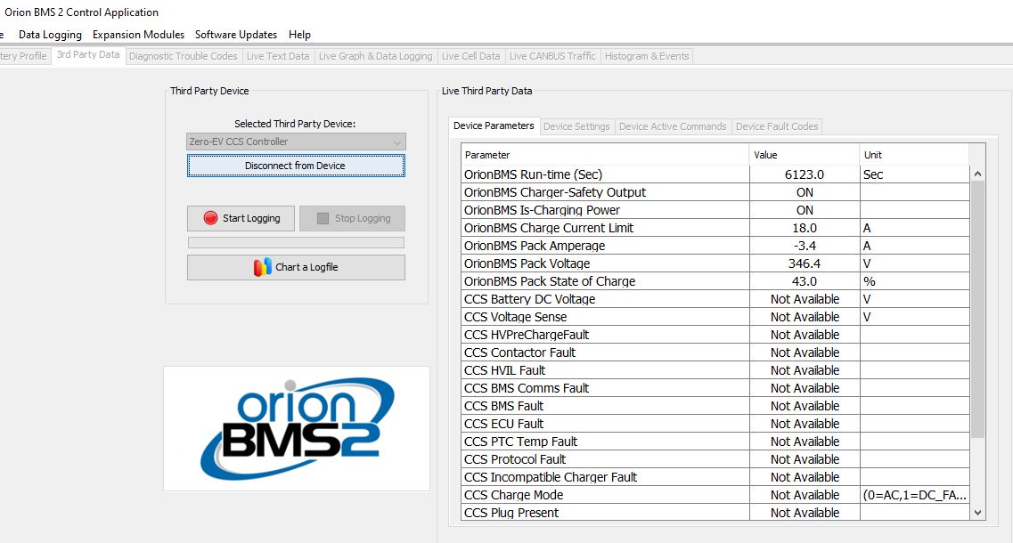

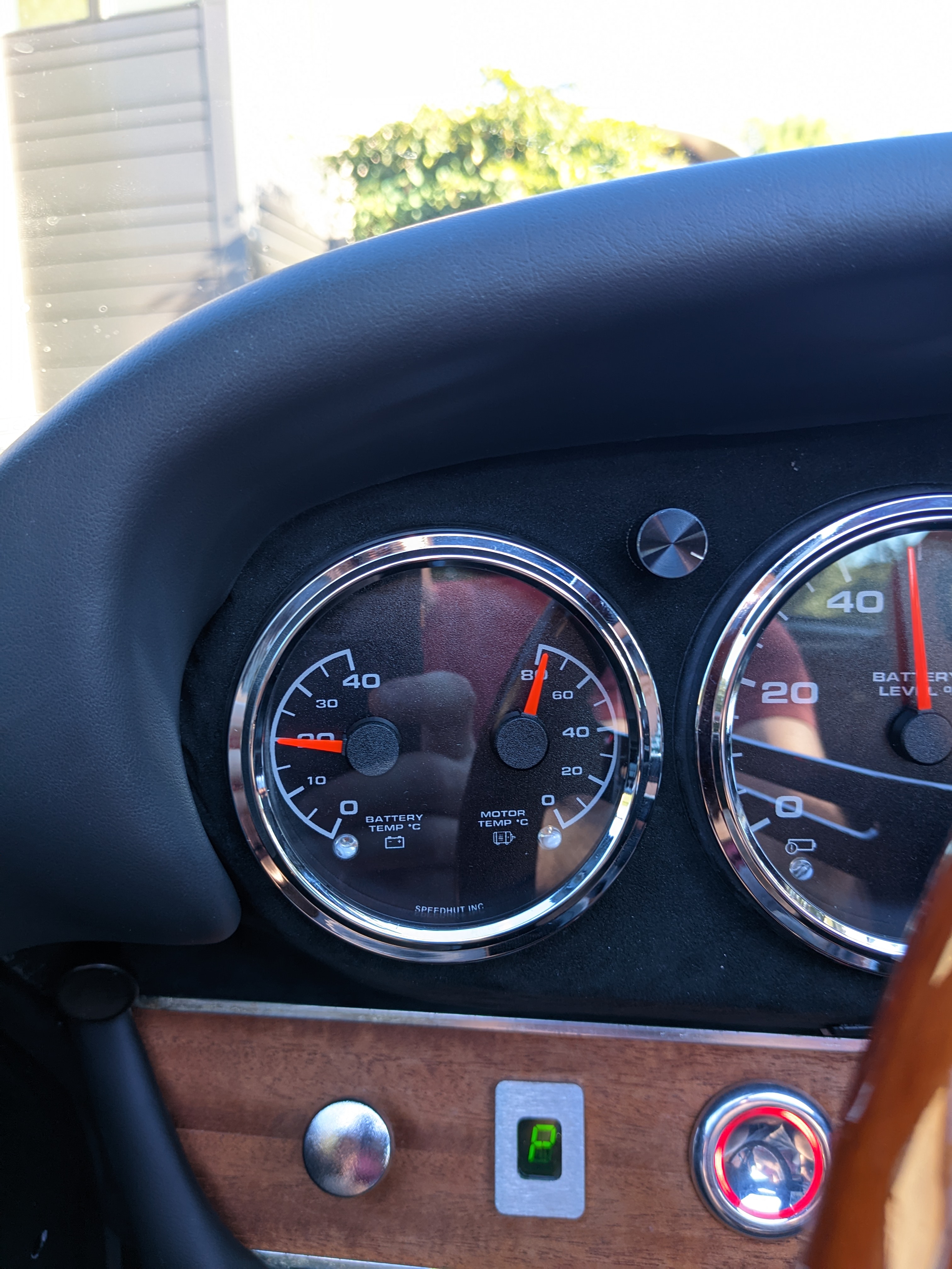

Hello,
Thanks for all the help this forum has provided. The electric Fiero has achieved about 800 miles with the SDU, OI board, charger interface board and Orion BMS. Only a few pesky kinks, one of which is CAN messaging from OI board.
I have Speedhut CAN Gauges and all but the motor temperature are working. Granted, all the working ones are getting their messages from the Orion.
Can anyone offer suggestions on what I may be missing? Based on BMS screenshot, I'm feeling like no CAN traffic is coming from the inverter. Do I need to manually insert a line for this rather than the CAN mapping already done?
Thanks, in advance, for any help here.

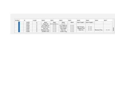

I have confirmed CAN speed at 500K. Attaching JSON for any other suggestions.
I must access CAN wiring from under car with weather shield removed (yes, design feature we won't repeat) so I haven't gotten there yet (with CAN sniffer, that is).
While looking at JSON, if there are any settings you'd suggest changing to improve the startup jitter, I'm all ears. I've smoked IGBTs on the tuning process a few months back and still having PTSD due to it.

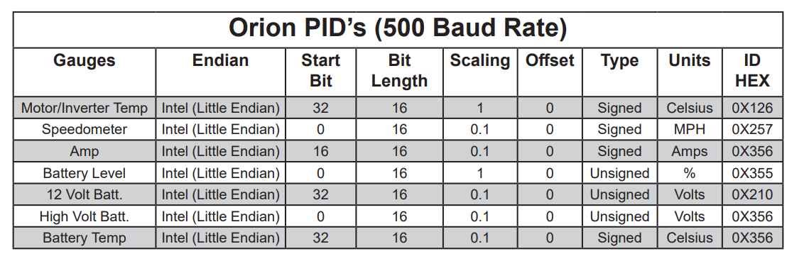

I've got Speedhut gauges and it took a bit to get things working from my LDU. One thing to note: you need something else on the bus other than just the drive unit and the gauges. I think since their EV CAN gauges are based on their OBD2 gauges, they don't acknowledge the messages (so that they don't freak an OEM car out, they just silently observe), so the drive unit doesn't keep sending. It sounds like you do have the Orion on the bus, so that's likely not the issue.timbradley wrote: ↑Wed Sep 06, 2023 2:11 pm I have Speedhut CAN Gauges and all but the motor temperature are working. Granted, all the working ones are getting their messages from the Orion.
To the best of my knowledge, they don't have separate Inverter and Motor temp gauges. The Inverter message looks correct, based on the attached table, but I'm not sure what you're sending the motor temp to.

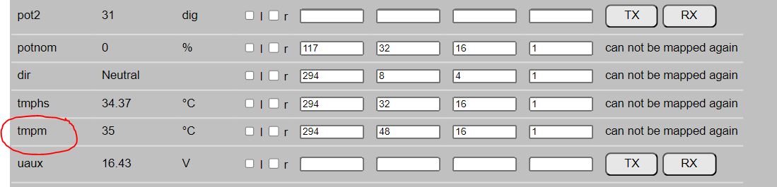

Hi Tim. I am not sure if you are still working this out on the inverter temp gauge issue. I have the ORION 2 BMS and Speed Hut gauges. As a side note, I went to Speed Hut in 2019 to get them to help me make custom can gauges for my EV project and they were super reluctant and I had to pester them to work with me. I then connected them with ZERO EV to develop the EV modified gauges for my project. I am glad that it took off like it did
I am not sure if my settings carry over to your setup, but on the OI firmware, I am not using tmpm at all but only tmphs with 294 32 16 1 as you have done. The ORION and Inverter CANBUS are tied together in the ZERO EV lv junction boxes, but you could connect it all up yourself I assume. Here is a screenshot of my canbus settings in ORION as well but I don't think motor temp is addressed here or needs to be. I have inverter temp/battery temp on one gauge. (disregard the temp reading on the inverter in the photo, as this was when I was dealing with a coolant leak on the inverter reeking havoc on that gauge

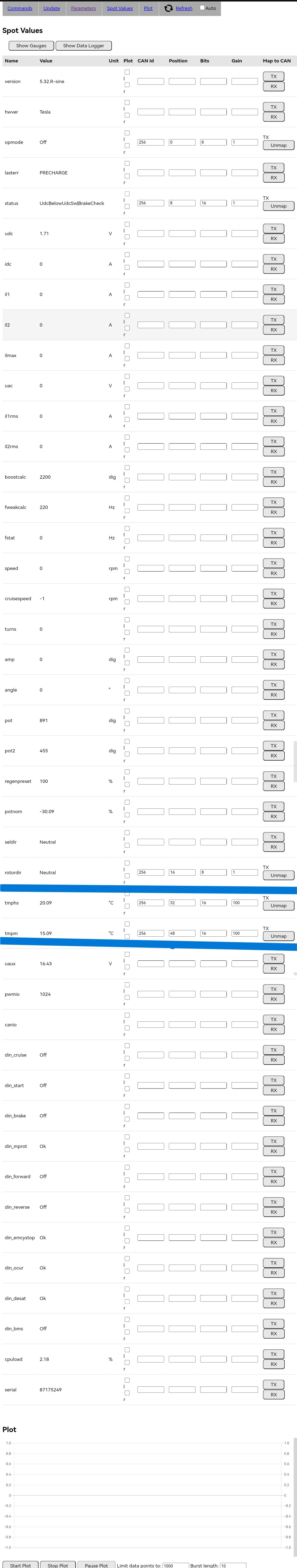

Hello.
Could somebody please give me a hint where am I going wrong here?
In the attached screenshot WebUI reads motor temp = 15.09C and heatsink temp 20.09C, but on the receiving end of the CAN bus, I'm reading motor temp = 12.80C, heatsink temp = 20.21C. Both SDU and my teensy talk at 500k.
This is my code on the receiving end:
Drive_HtSnkTemp=(uint16_t)((incoming.buf[5] << 8) | (incoming.buf[6])); // scale 1/100
Drive_MotorTemp=(uint16_t)((incoming.buf[7] << 8) | (incoming.buf[8])); // scale 1/100

You're indexes are off by one and you're decoding big endian. Try this
Drive_HtSnkTemp=(uint16_t)((incoming.buf[5] << 8) | (incoming.buf[4])); // scale 1/100
Drive_MotorTemp=(uint16_t)((incoming.buf[7] << 8) | (incoming.buf[6])); // scale 1/100
