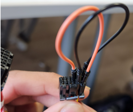

When connected with cables with one module and the loopback at the end of the cables.
How does your signal on the RX-pins look?

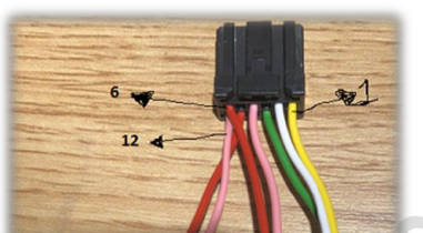

To me it looks like your pinout for the loop-back is wrong?
From the CMC documentation: And looking at your loop-back: Seem like loop-back is connected from pin1 to pin9 and pin2 to pin7?
