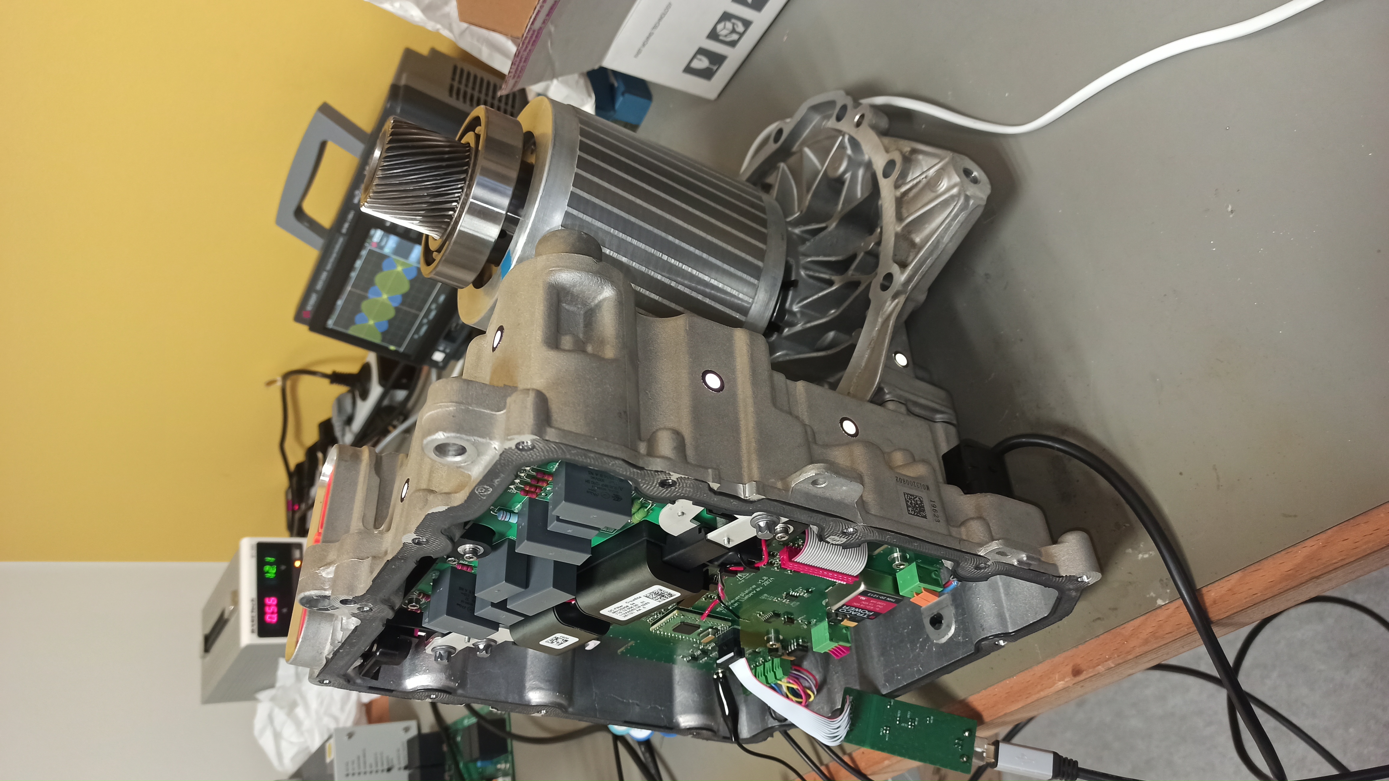

After some time of silence, I would like to get back to you with a small update.
I was able to drive the asynchronous machine in a U-f control system using the driver board and control board. The next steps are to connect the drive to a braking machine so that I can measure the electrical parameters ...

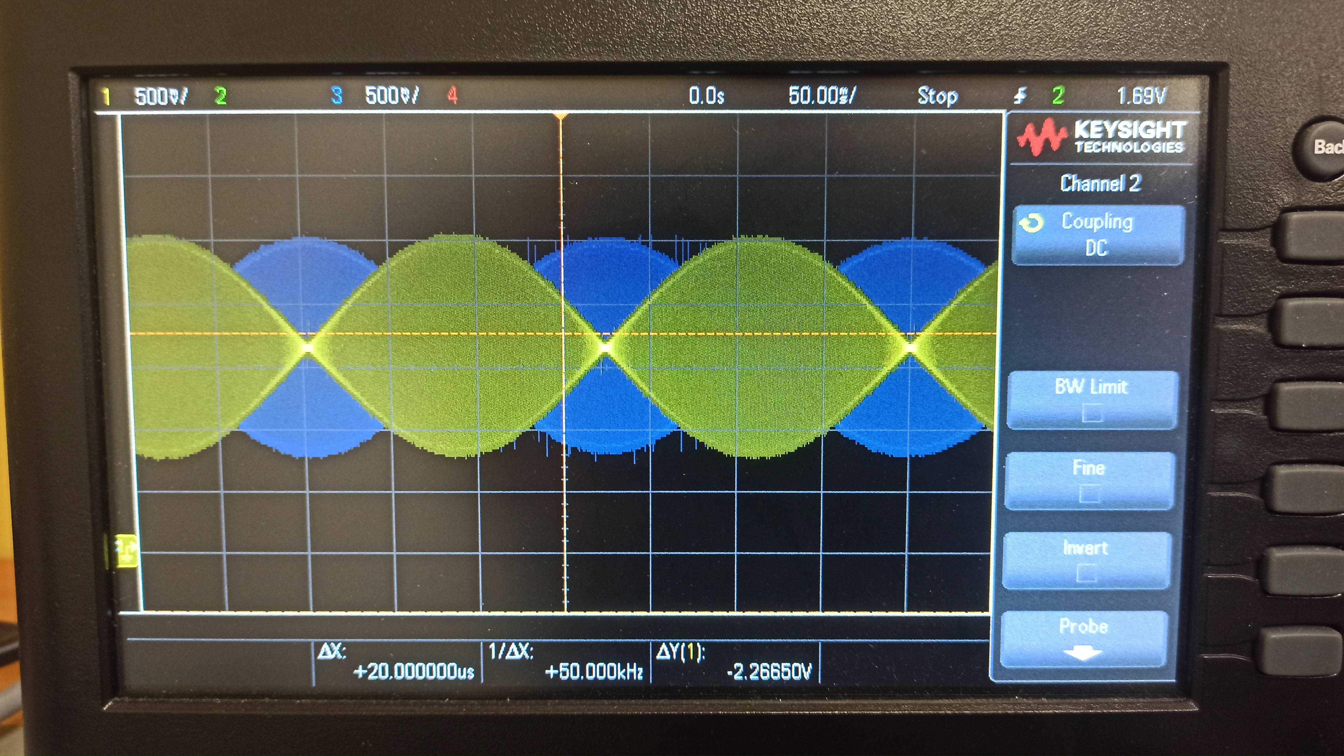

Re: [WIP] 1975 Barkas B1000 with MEB Front Drive
Thank you!
I based the excitation on a design suggestion from TI.
tidrvx9.pdf
However, I have adapted my circuit diagram slightly and will be happy to share it here.
Resolver_schematic.pdf
As a driver for the excitation winding, I used the ALM2402 circuit, which is advertised for this purpose ...
tidrvx9.pdf

Small status update: Resolver excitation and position measurement is working.

There is news again. Since my last post I have designed a control board, which is now manufactured and assembled. It fits well into the inverter housing and is already connected to the encoder and temperature signals from the motor and the DC voltage measurement. The biggest challenge here was ...

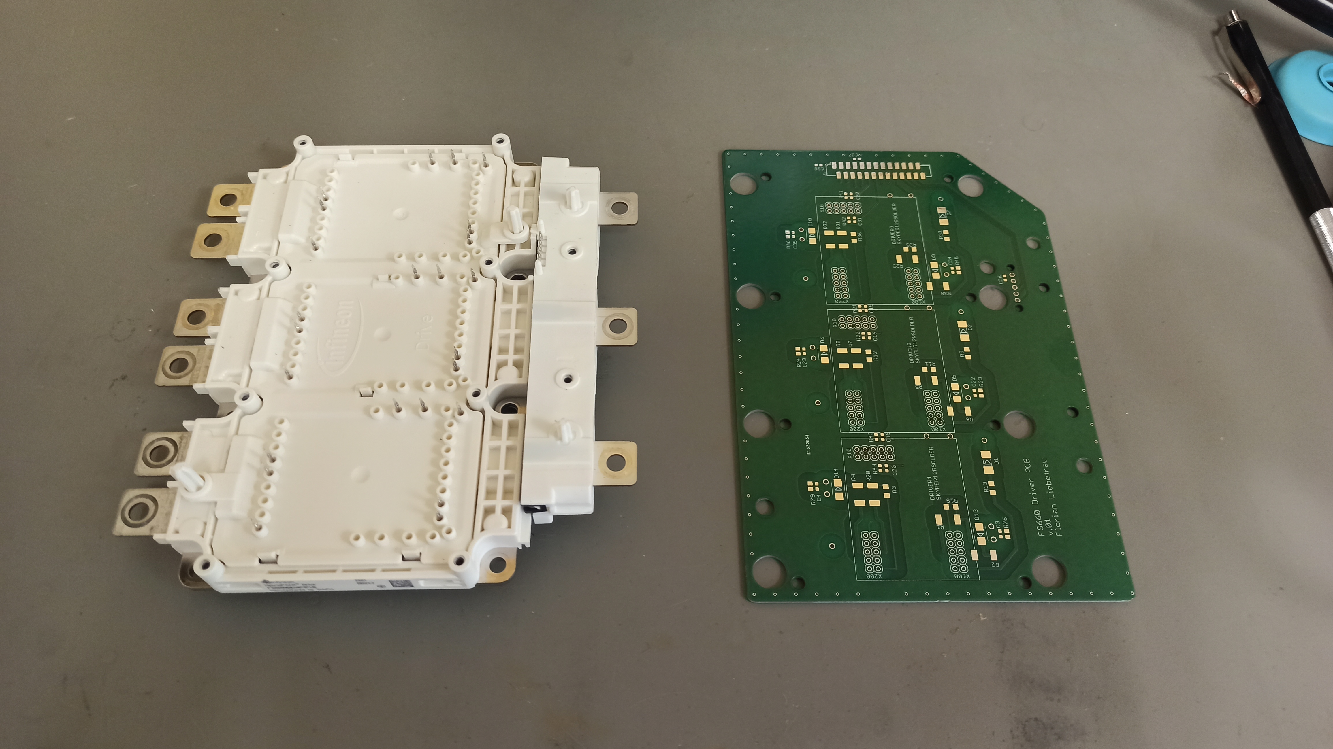

Reverse Engineering of the Schematic of the existing driver board (Parts, Connections, etc.) is way more complicated for me than just design an equivalent driver board. Some ICs don't have a part number and i don't have a x-ray machine to follow the signal traces.

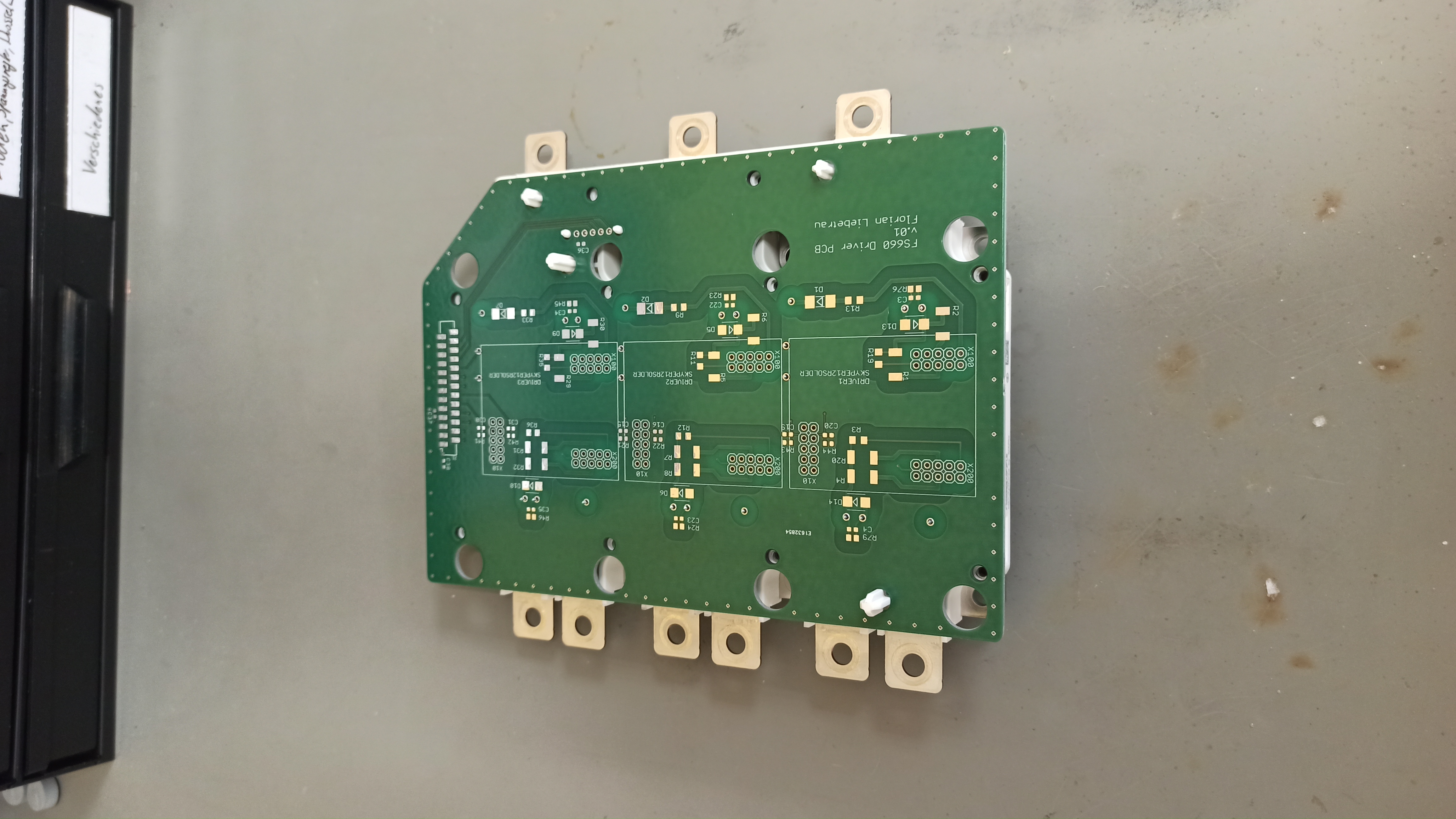

To the phase output side it is so large because of the mounting of the current sensors. On the DC-side i could have spared some millimeters, but it was easier and quicker in the design process to just make a rectangular shape. And the cost of the PCB isn't increased very much. I think it also helps ...

The adapter boards arrived today. After a short moment of tension, the certainty that all the holes are in the right place

Small update: I have finished designing the replacement driver board version 1 for the IGBT module.
Piggybacked onto this board are SKYPER 12 R drivers from Semikron. I also managed to remove the original driver board, which was pressed on using a press-fit connection, without ...
