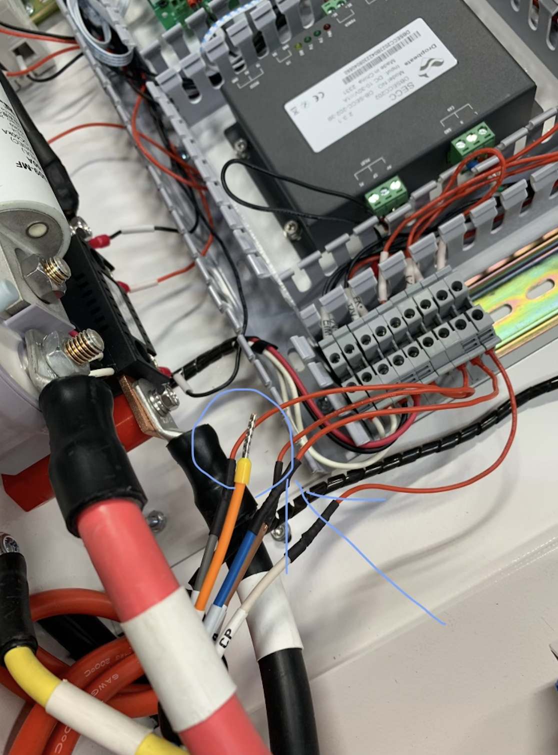

Re: First-Time Config of FOCCI And CCS1 vehicle charging
Opened the charger. Looks like the PP line was disconnected completely from the factory (on both chargers). Supplier seems to have confirmed that this is not intended. Will test again tomorrow and hopefully this fixes the issue
Just to be sure, "sharing the same PE" means, that the following signals are together:
- Ground of Foccci
- Ground of the 12V supply that feeds Foccci
- PE of the CCS socket
- minus of the multimeter if you measure the PP voltage on car side (around 4.5V if nothing is connected).
- ground of the ...
And there is also confusion regarding CCS1 and CCS2. The thread topic says "CCS1", also the picture shows a CCS type 1 plug. On the other hand, I read "Qingdao Penoda Portable DC CCS2 Charger. I knew there are differences between CCS1/2 (I did not order this charger)". So maybe we talk about ...
Managed to secure access to another portable charger and I seem to have found the source of connectivity-recognition issues. The charger that worked was providing 12V across cp-pp.
resistanceproxpilot danced around 830ohm. CP was still 0 but that's because I hadn't activated the charger (with an ...
Does the charger provide 12V between CP and PE if just sticking the multimeter probes into the CCS plug?
This was showing 0v. Across the inlet, CP-PP was reading <5v.
Just flashed the new clara pushed. Thanks for the update, will test.
Edit: Tested. Charger is still showing 0v ...
