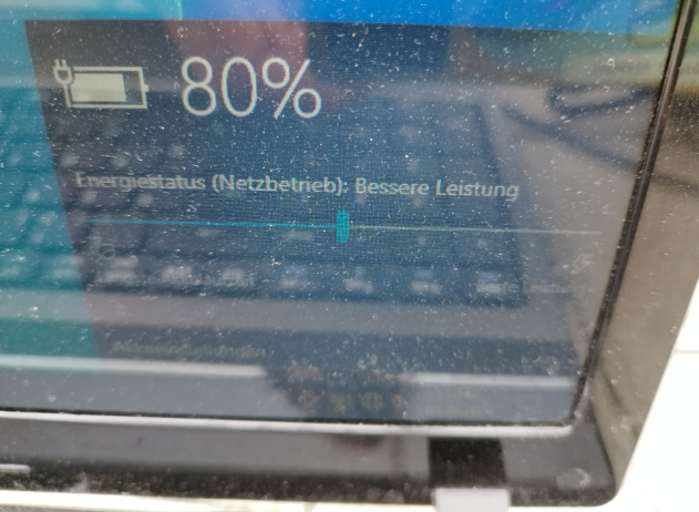

The laptop power supply had no problem with the DC current.

For powering your laptop, it's cool; so a simple usb chargeur should be able to recharge the powerbank (or a internal battery).

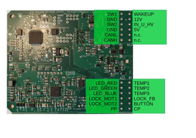

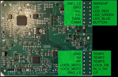

On another note I wanted your input on this. Here is the current pinout:
The two contactor outputs are on different plugs. The LEDs and button are not on the plug that is more charge port oriented but on the car oriented one. Now I thought it would be more stringent to arrange like so:
That way all wires going towards the charge port are in one common harness and so are the ones going to the car. I'd assume the voltage sense board to be mounted with the charge port contactors.
celeron55
Posts: 804
Has thanked: 38 times
Been thanked: 136 times
Re: Develop a QCA7000 board?
Post by celeron55 »
That new pin ordering makes a lot of sense. The contactors and the voltage monitor are likely to be located in a junction box that is very much a "car side" thing. Are all of the pins other than LOCK_MOT1 and LOCK_MOT2 referenced to ground? This would mean the only signal you need to bring to the charge port in addition to the "charge port side" pins would be ground, which is reasonable enough.
Posts: 6772
Has thanked: 385 times
Been thanked: 1595 times
celeron55 wrote: Sat Apr 13, 2024 8:00 pm Are all of the pins other than LOCK_MOT1 and LOCK_MOT2 referenced to ground?
Yes exactly. PE should be solidly connected to the chassis not far away from the charge port so that would serve as a ground reference for the signals
I guess the design is still young enough for shuffling pins
