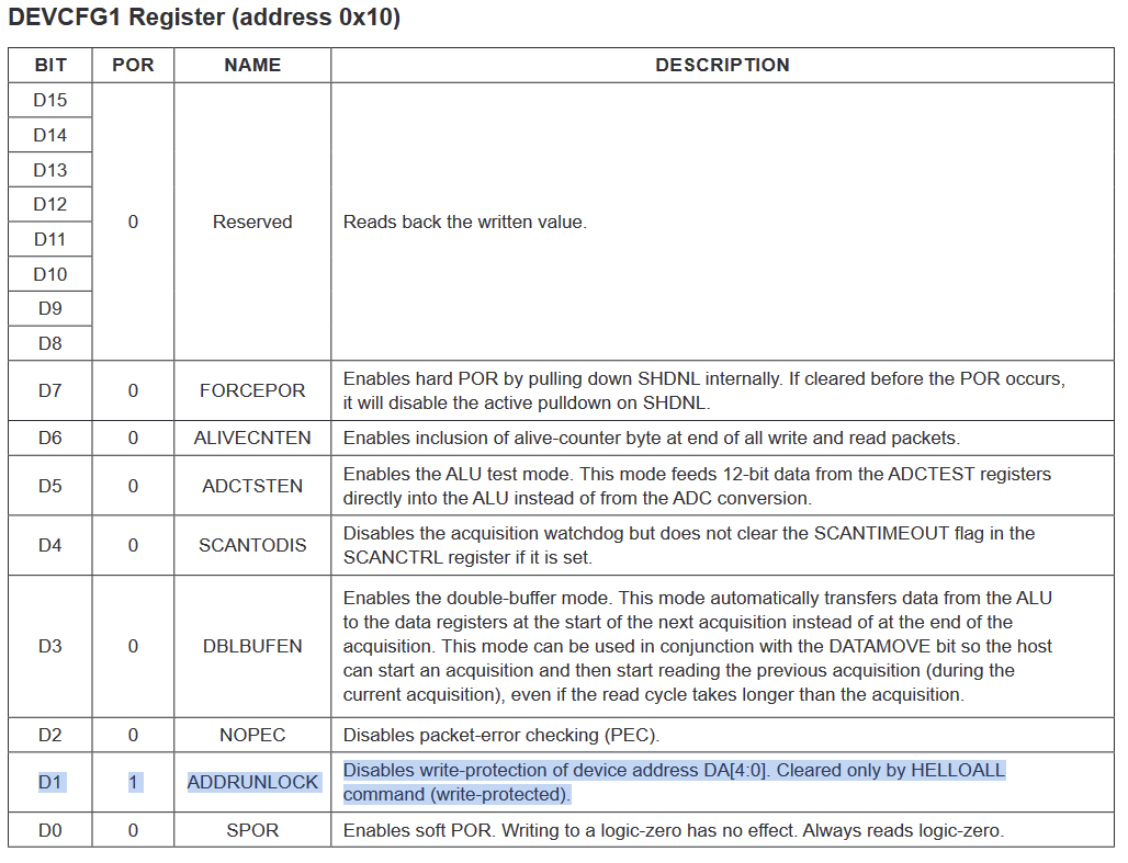

Thu Oct 24, 2024 10:11 am
Forum: Hyundai/Kia
Topic: Kia Niro BMS
Replies: 292
Re: Kia Niro BMS
I think DEVCFG1 should fix this, unless it's already fixed: ADDRUNLOCK Disables write-protection of device address DA[4:0]. Cleared only by HELLOALL
command (write-protected)
by evdc
