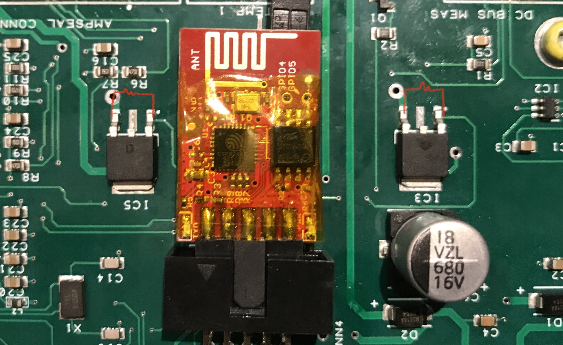

At IC10 I have the following:
1,2: ~5V
3: 3.82V
4: .7V <--
5,6: ~5V
8: ~5V
11: ~5V <--
Looks like 4 and 11 are not as expected.

I spent some time searching the forum for others with overcurrent errors and reading the Wiki to make sure I wasn't missing something obvious. Came across the troubleshooting page for LDU board and followed the steps to diagnose there.
When measuring the two test points adjacent to R45 and R58 (no ...

I took it back apart and verified all my soldering for the connectors just to be sure I didn’t bridge something and miss it. While having the lid off I observed this behavior for the inverter board, (which happens regardless of having the contactors connected or not) Where the red LEDs on the ...

I'm having an interesting issue with the states of the contactors. When I power the system up it appears that all of the contactors are energized simultaneously for a moment, then upon start signal the positive is energized only briefly before opening again. I've made a video to illustrate this and ...
