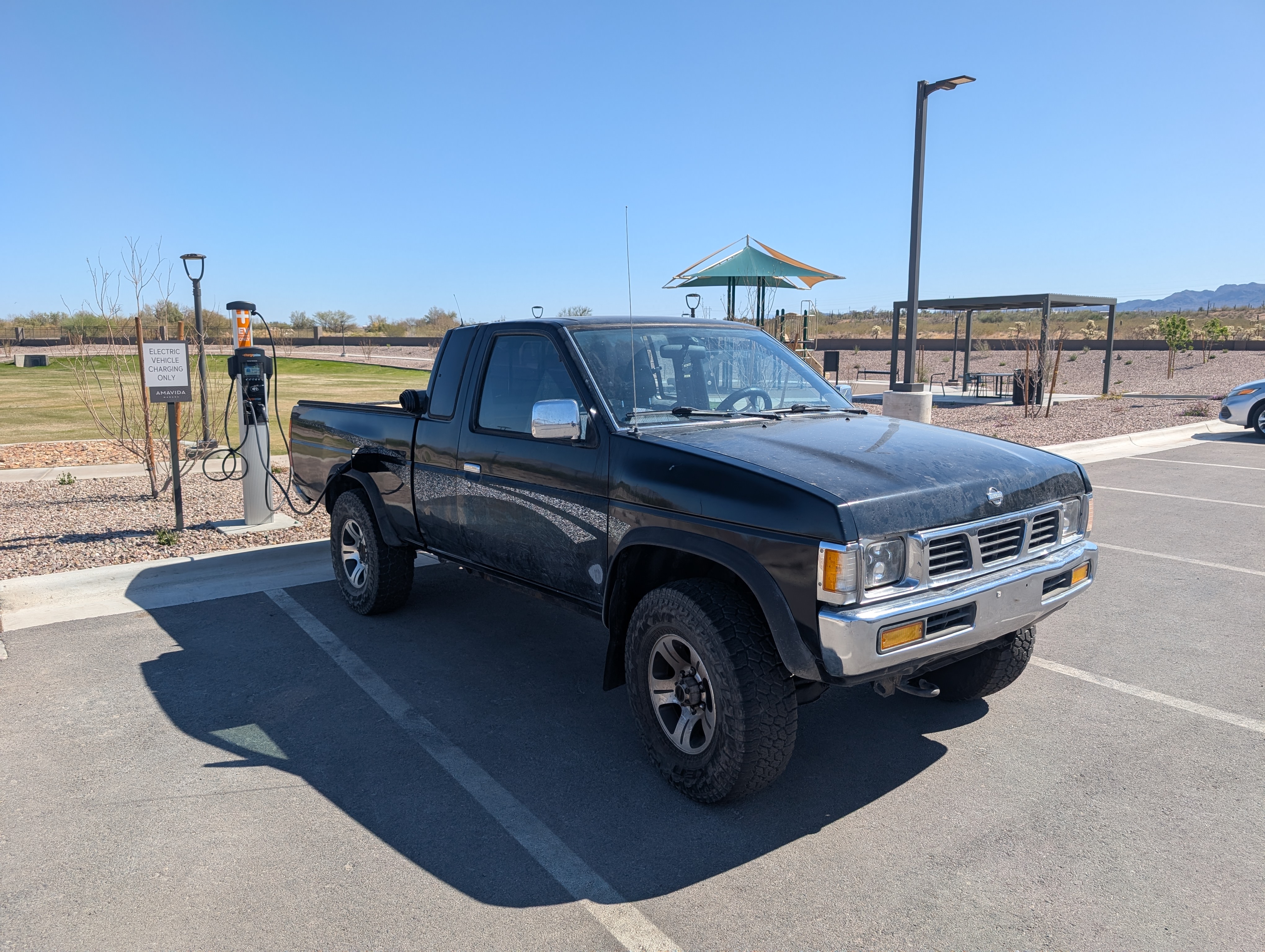

I don't have much in the way of updates, but I have been using the truck around town frequently. I seem to have worked out all of the j1772 charging issues.

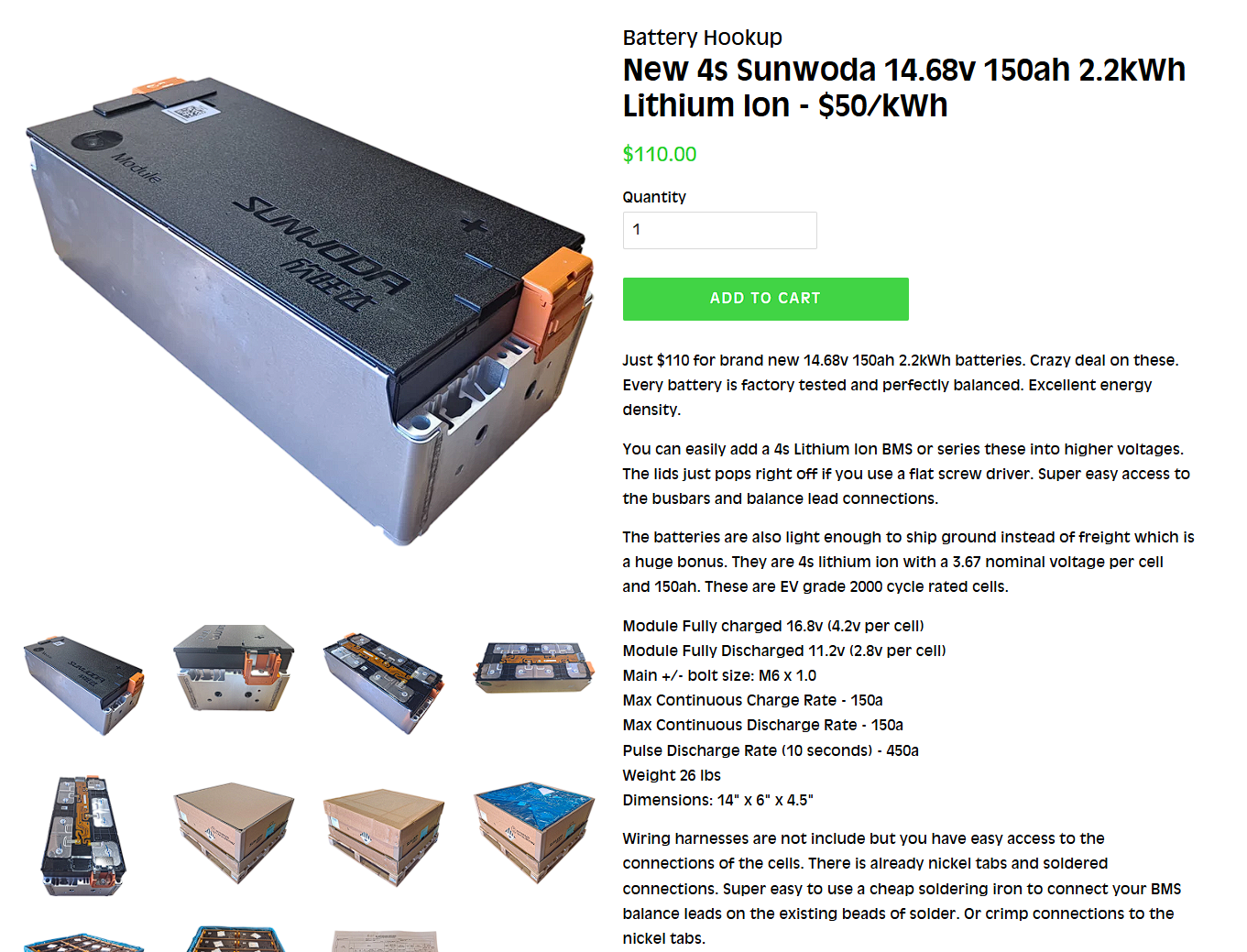

Yes, they are from Battery Hookup. The site claims 150 amps continuous and 450 amps 10 second pulses. That is about 1C continuous and 3.4C pulse. Will that be ok for general use?

I replaced the old extended j1772 port with a Phoenix Contact CCS1 port at the gas fuel door. This fixed the charging issue, which seemed to be a bad pp line.
I got 24 4s1p Sunwoda 2.2kwh vda355 modules for a ...
