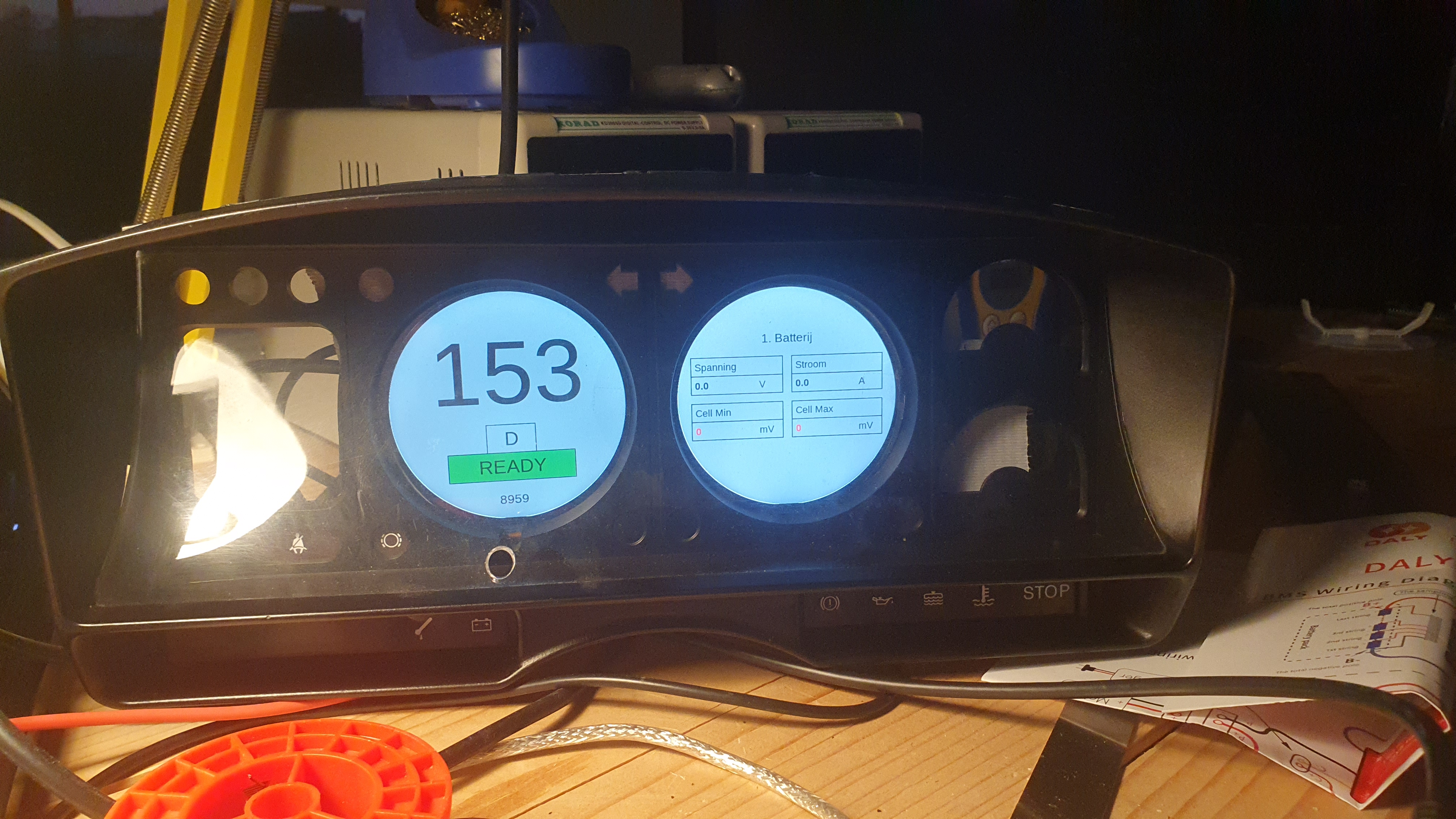

Little update on the dashboard.
I found 2 round lcd screens that fit in the place of the speedometer and rev counter.
The screens are controlled by a Rasberry Pi Zero and all signals are read via CAN
(Still renovation my house, so no futher updates on the car...)

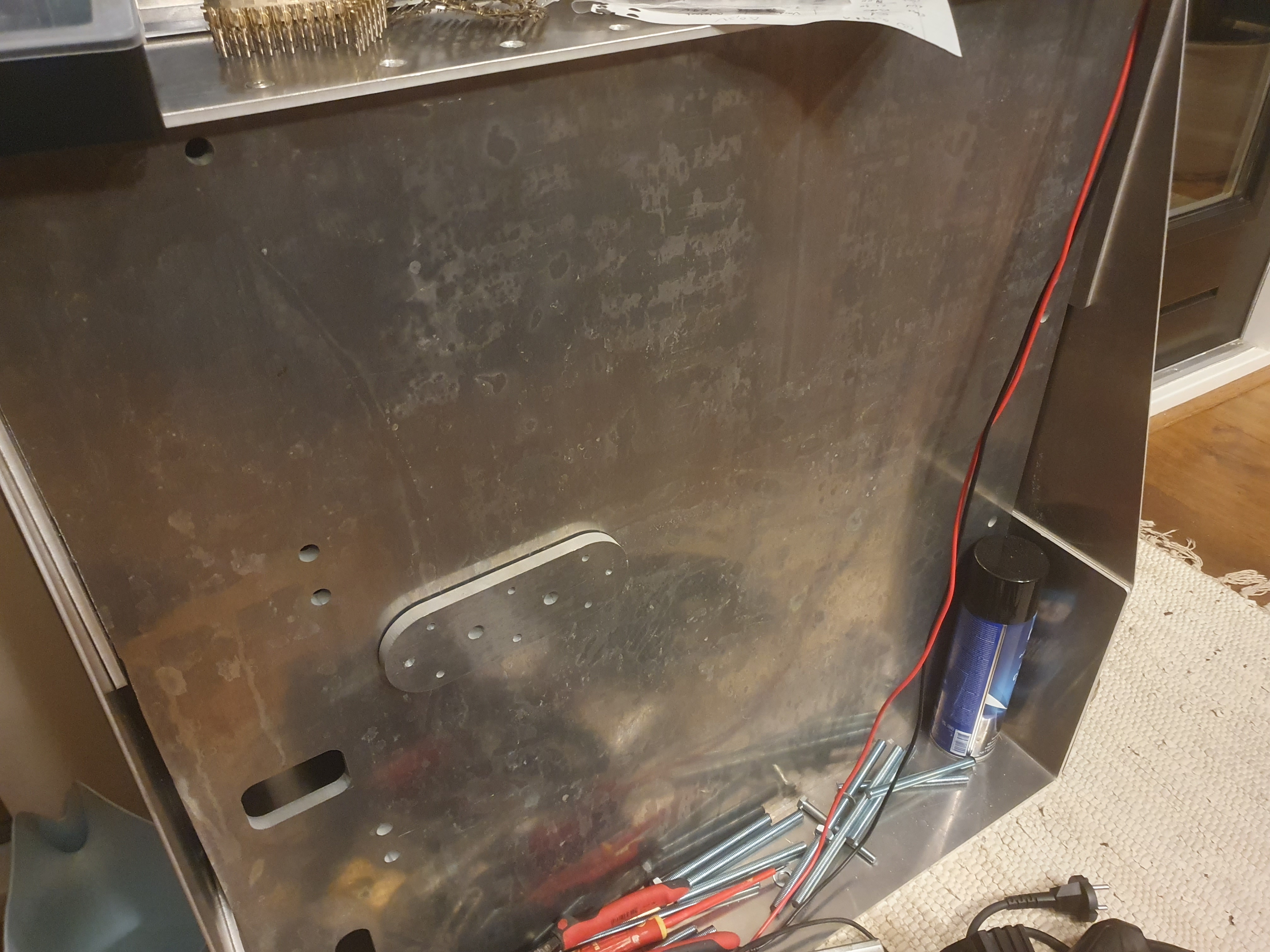

Some progress, drive unit still not working, but my priority is to charge the batteries first.
The rear battery box is now finished and installed where the old fuel tank was before.
High voltage cabling is in underneath the vehicle, charge port installed.
Next thing to do is installing/routing the ...
