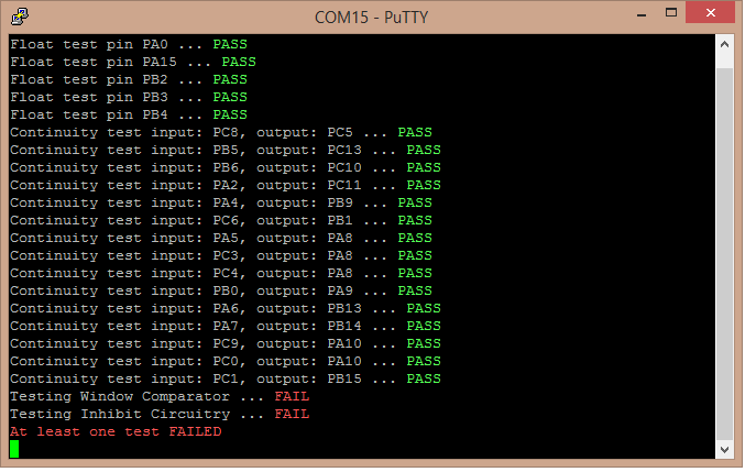

Re: Testing Newly Soldered v3.0 Board
Ok, i swaped resistors in the divider and now i have 1.2V at PA5, PB0 at the comparator inputs. Output of the comparator is 3.7V. But on the 3rd pin (PA3) NAND I have 0V. PA3 on the microcontroller in the test mode working as input or as output? If it's works as input, maybe i need connect SIG_MPROT ...
If you apply 5V as indicated on the test board, then the pins P5, P3, P4, P8 of the test board will be 5V*(10k /(47k+10k))=0.88V. But when we installed the inverter, then we get the following diagram:
The chart shows that at the input of the inverter, there is one more voltage divider ...
Thanks for the tip. I checked the test board, everything is fine. The resistors correspond to the nominal values, all the necessary pins are connected.
The inputs of the comparator 2901, have the following readings:
5 - 0.26v
4, 6 - 0.82v
7 - 0.26v
8 - 0.26v
9, 11 - 2.46v
10 - 0.26v
accordingly, the ...
Hi!
What is a Window Comparator and Inhibit Circuitry?
