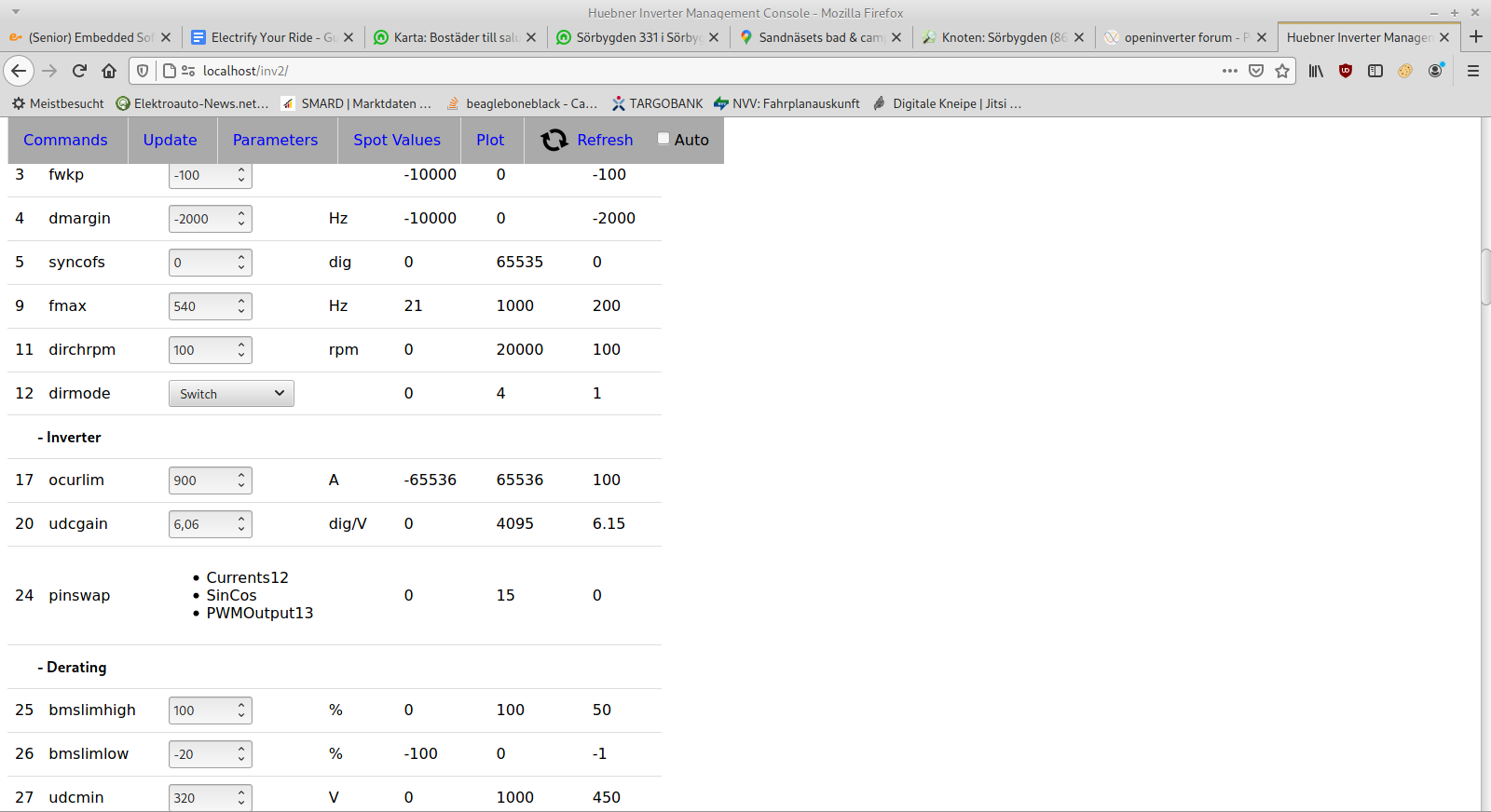

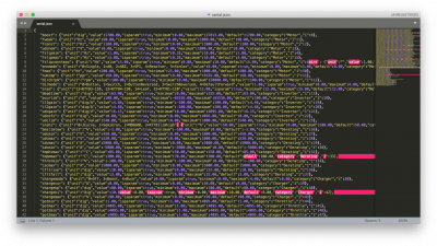

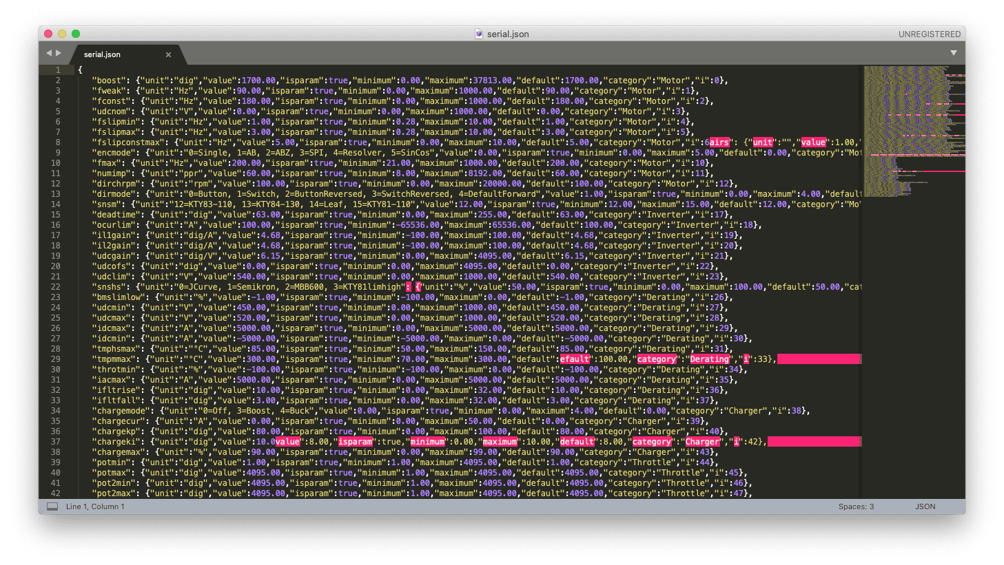

Maybe I should include the parameter index in the json command so that it can be displayed in the web interface.
Posts: 6969
Has thanked: 455 times
Been thanked: 1771 times
Re: Send CAN message help
Alright, some late night hacking: "json" now produces for parameters
"manualid": {"unit":"A","value":0.00,"isparam":true,"minimum":-400.00,"maximum":400.00,"default":0.00,"category":"Testing","i":73}
Note the added "i".
Added that index before parameter name. Note the skip from 12 to 17 between motor and inverter parameters because of 5 hidden parameters.
Also handling "flag parameters", pinswap being the only one. As soon as multiple flags are selected the parameter is just displayed and can't be modified. Maybe I should just add check boxes instead. Later.
esp8266 github updated.

Posts: 574
Location: Connecticut
Post by jon volk »
Excellent! I updated the firmware and saw the index value of throtramp was different than my previous version. Quick change in my VCU code and we're off and running. Great addition.
