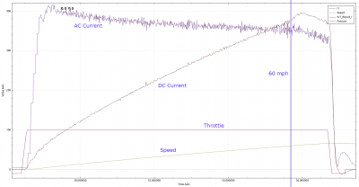

I wanted to start a thread to document my efforts to tune the SDU using log data and charts. To begin with, I will focus purely on full-throttle 0-60. The goal is to have flat line of motor current (i1) and DC current rising consistently to a safe maximum (ideally around 450A). My first run uses the following paramaters (I believe these are the only paramaters that are relevant at full throttle:
Voltage: 300V
Boost: 2700
Fweak: 250
fslipmax: 4
fslipconstmax: 4
idcmax: 500

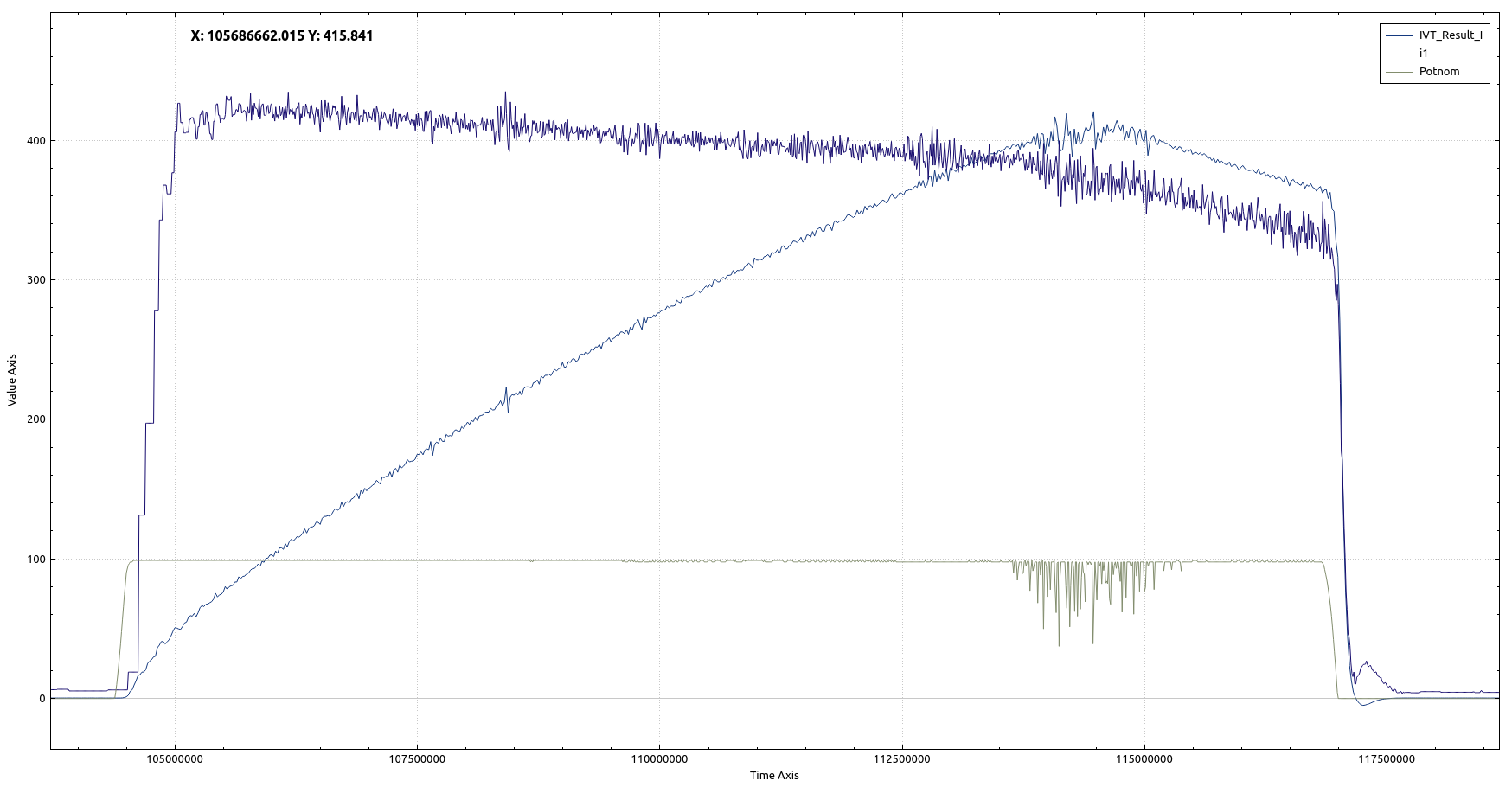

Using SavvyCAN, I can chart the AC and DC current, along with potnom.
It can be seen from the first run that the ratio between boost and fweak isn't quite perfect, as the AC current reduces as the car accelerated. This isn't significant enough to be a problem, and may in fact be desirable (see below).
More dramatically, it can also be seen that aggressive derating is occurring when the DC current reaches 400A.

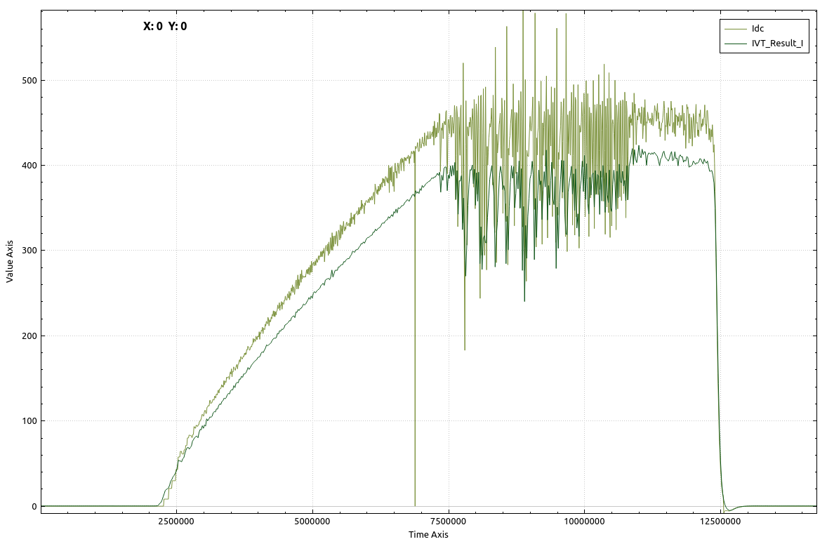

By comparing the Idc (from the inverter) with the current data from my ISA shunt, we can see that the DC current is being slightly overestimated by the inverter, hence why the 500A limit is being triggered (just a little) prematurely.
With this in mind, I need to decide whether to increase the DC current limit, or try to reduce current. While the first option may be acceptable and within the specs of the motor, I would prefer to save my batteries, and instead reduce current.
I will experiment with doing so, either by adjusting fweak to reduce voltage at higher speeds, or by adjusting fslipmax, which should reduce current at all speeds. It is difficult to know which of these to adjust as both will likely have an impact.

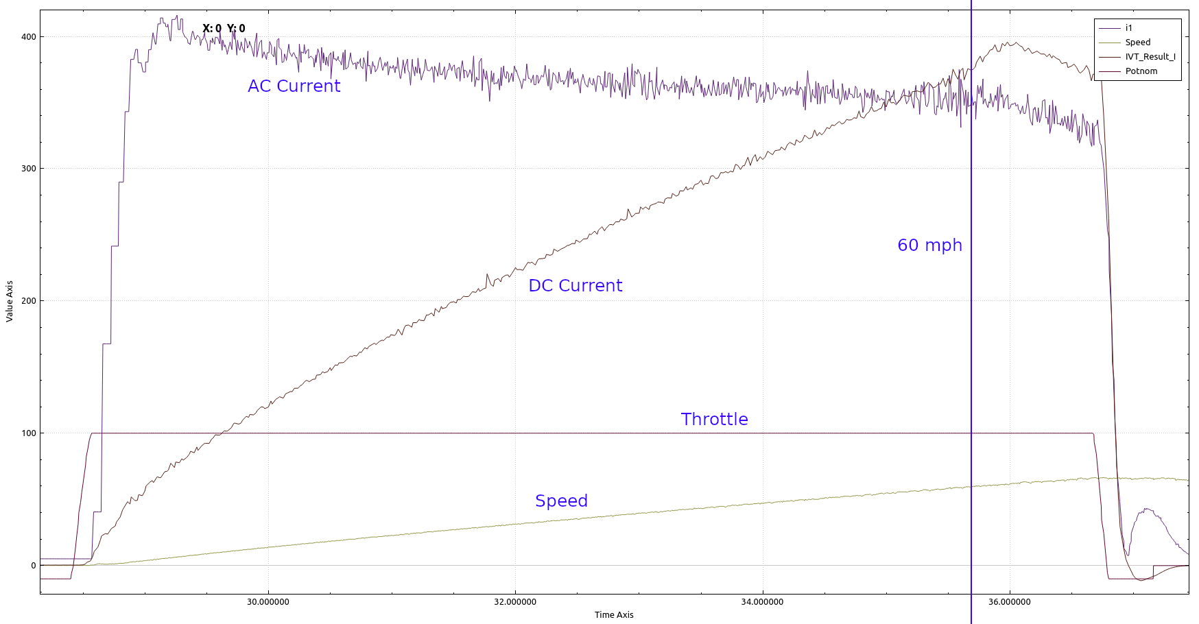

Run 2 - I've changed the parameters as follows:
Voltage: 300V
Boost: 2600
Fweak: 280
fslipmax: 4
fslipconstmax: 4
idcmax: 500
The decrease in boost from 2700 to 2600 causes a reduction in the starting current from reduces the initial current at 0RPM from 480A to to 420A. At the same time, the increase in fweak reduces the current at 60MPH from approx 450A to approx 390A. The overall result is that the DC current limit is still reached, but only barely, and much later.
This also increases the 0-60 time from 7.5s to 8.5s.

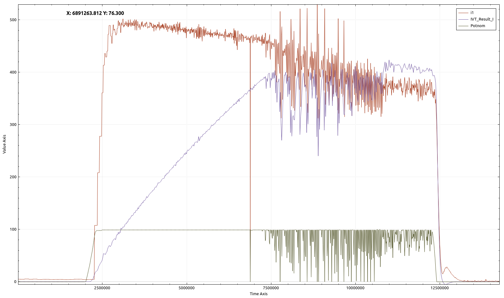

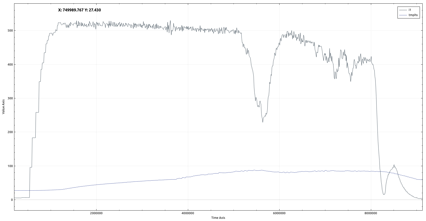

So today I looked at changes to fslipmax. As expected, higher values of fslipmax cause an increase in current, however I quickly ran into a problem - inverter overheating.
Pushing 400A-450A through the motor phases, the inverter heated from 27C up to 70C in 7.5 seconds. I don't think this is a problem with my cooling because it cools down again just as quickly as soon as I let go of the throttle.
I increased fslipmax from 4 to 5. The the result was an increase in current to 520A (nice and consistent / expected result). Unfortunately, the inverter temperature then rose from 27C to 87C(!!) in 4.7 seconds(!!).
With this in mind, it seems that I can't realistically push more than 400A through the motor. I will instead look for ways I can get more torque in exchange for that current. I will continue to experiment with slip values, but at much lower voltages, to see if I can find some efficiency gains without melting my IGBTs.

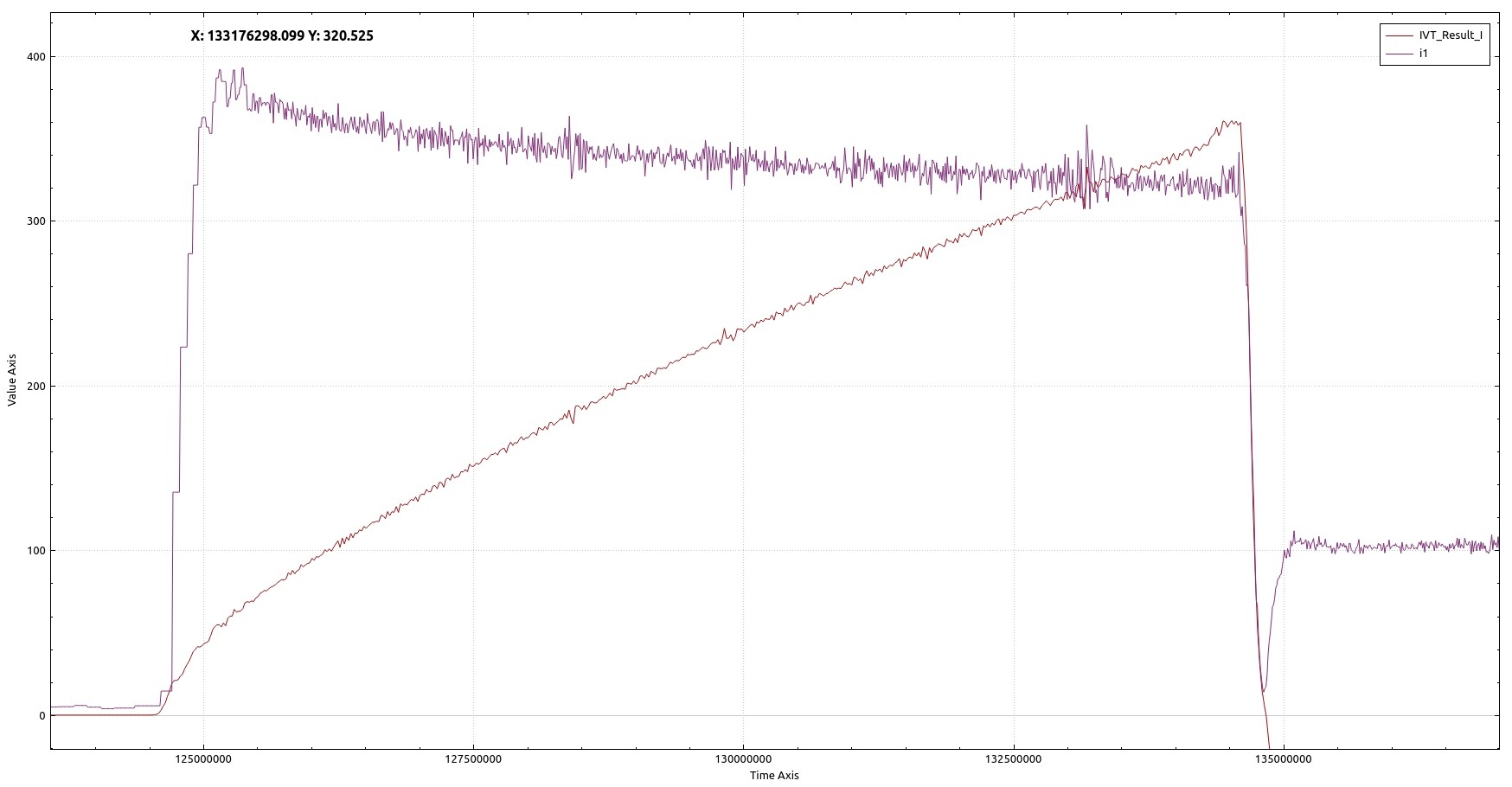

Comparing higher higher slip vs higher voltage, there is a clear winner:
slip=4
boost=2650
fweak=290
Time: 9.1
AC: 420A to 370A
DC: 0 to 350A
Temp: 70C
Regen: -42A to -33A
vs
slip=3
boost=2800
fweak=280
Time: 8.8 seconds
AC: 392A to 326A
DC: 0 to 323A
Temp: 55.6C
Regen: -40A to -36A
It would be worth doing more runs to be sure, but it seems clear that a slip value of 4 is too high to be optimal for my SDU, and 3 is better, performing a faster acceleration with less power.
With a slip value of 6, I could barely do anything without smashing into derating limits.
I think that's enough test driving for today, but I will come back to this. What's particularly interesting here is that I'm *nowhere near* the performance that others like Peter are achieving with the SDU, but when I try more extreme value like slip=6 that others are using, I immediately draw way too much current. However with this more optimal slip value, I think I have the ability to push the voltage quite a bit higher.

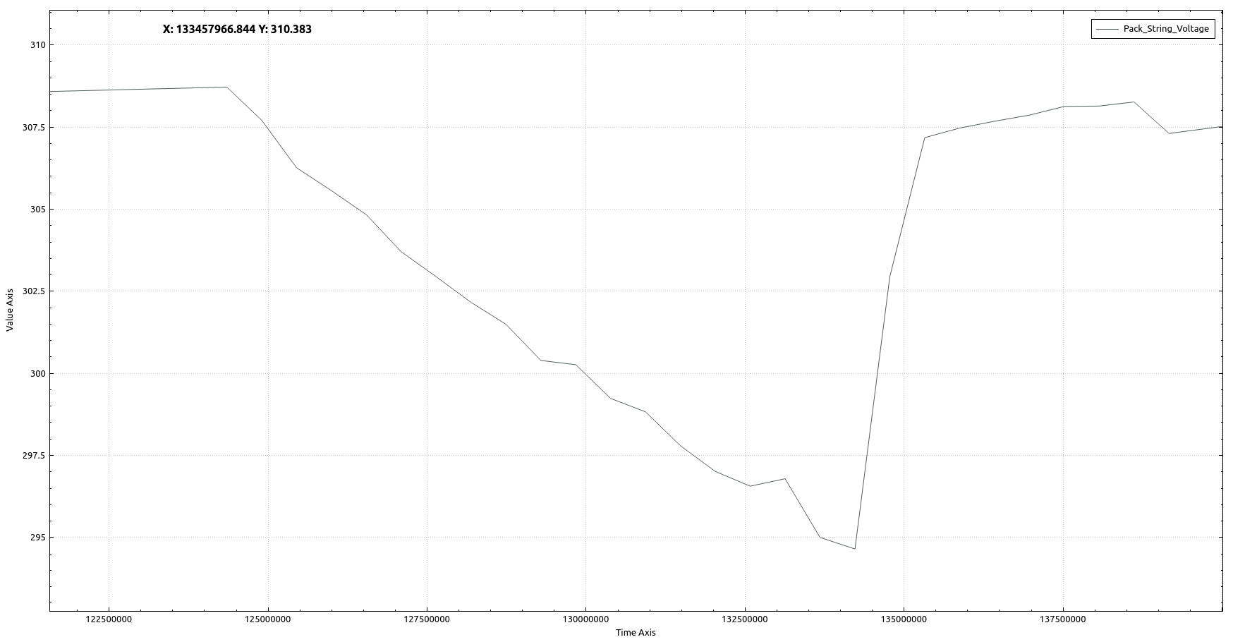

With regard to voltage sag, here's a graph matching the previous run. The voltage drops from 308.5V down to 294.7V as the current rises to 350A. It's not negligable, but it's also "factored in" to my process, as I'm adjusting fweak to give consistent AC current anyway.

Ok that's like 4.5% on the limit i would say.
13.8VDC @ 350Amps = 40mOhm is that your battery resistance?
Do you have a measurement near the battery? Same Sag?
104kW of DC input Power.

EV_Builder wrote: Sat Jul 30, 2022 6:20 pm Ok that's like 4.5% on the limit i would say.
That voltage data was from my BMS, so that's the voltage directly at the cells. I don't log the voltage reported by the SDU.
That certainly implies that the pack resistance is 40mOhm.
The pack is rated for 120kW for 15 seconds, which is why I'm choosing to limit myself to 400A DC at full power.
Note: in these tests, the the voltage is always being limited by the inverter, not the battery. My fweak setting of 290 means I won't send the full 310V until 69mph. If the voltage is too low (which I suspect it is), it's only because it's *set* too low.
What we're attempting to do here is to find the right balance between current caused by increasing fslipmax, and current caused by adjusting boost and fweak. If it's out of balance in either direction, the excess just gets wasted as heat somewhere in the system.

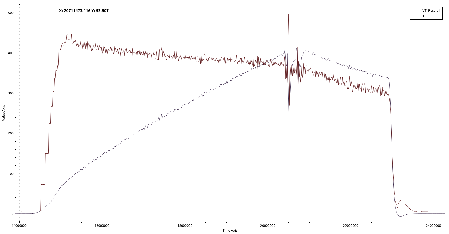

A new day, a new test run. This time pushing the voltage a lot harder to make use of the new found efficiency:
pack voltage: 309V
fslipmax: 3
boost: 2900
fweak: 240
AC current: 438A - 358A
DC Current: 0A - 400A (hit limiter)
Temperature: 25C - 54C
0-60: 6.35s
This run hit the DC current limiter, but definitely getting closer now.
One issue is that 3.0Hz was a totally arbitrary choice. I've proven that it's better than 4.0Hz, but it may still not be optimal. Unfortunately it's simply not practical to test every frequency.
