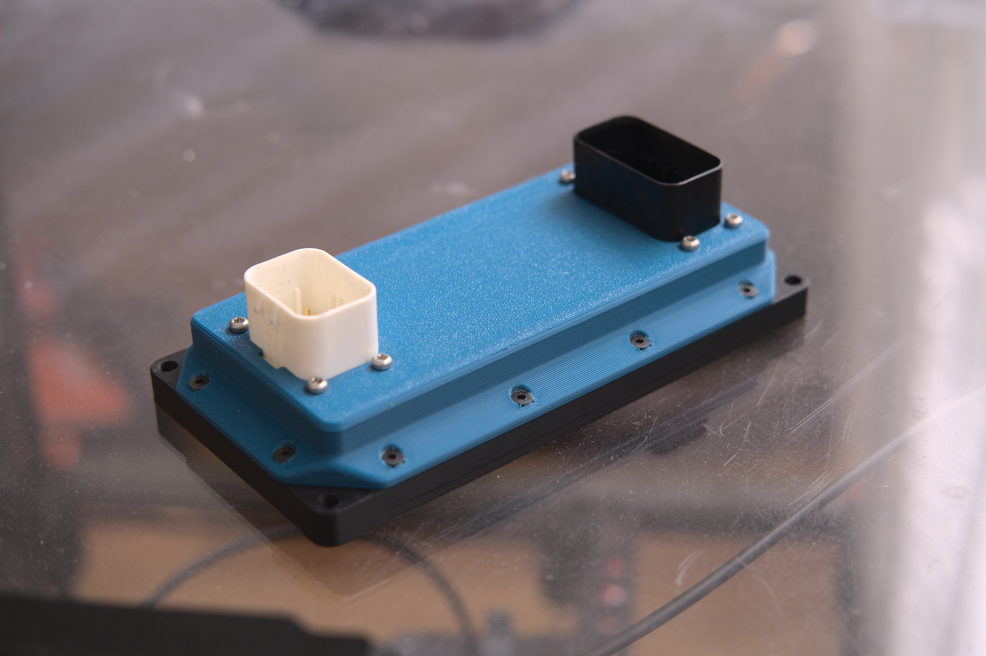

I created a remix of the gen2 prius board:
https://github.com/ksmola/PriusG2
I built it around Ampseal connectors and made a 3D printed enclosure for it (I can upload some photos later).
It features the bigger 100pin F103VBT6, mostly because the 64 pin was already out of stock @jlc, however changing it to any F103 is a pretty simple change.
There is an ESP32 on board, which means jlc can build the whole thing (sans connectors)
Next to the tag connect it also has a 10pin cortex debug header for flashing/debugging.
Since I'm not a fan of eagle, all the source files are KiCad 5, 3D printable STLs are included as well. Prints ok without supports.
This was tested with Gen2 inverter, leaf motor and resolver, analog and CAN throttle.

Took some pictures of the board today: (have a cutout on the lower case so I can debug/probe the board if necessary)
