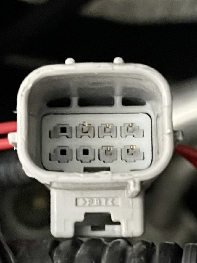

I'll see if I can get the DCDC to work. From what I read on the forum about the Prius DCDC converter, it should not be hard. The Camry connector also has 5 pins like the Prius, only it's smaller.
Prius DCDC:
https://openinverter.org/wiki/Toyota_Pr ... _Converter

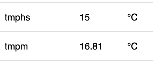

I got a new Zombieverter board with the Wemos connector. My temperatures now work!

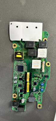

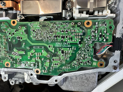

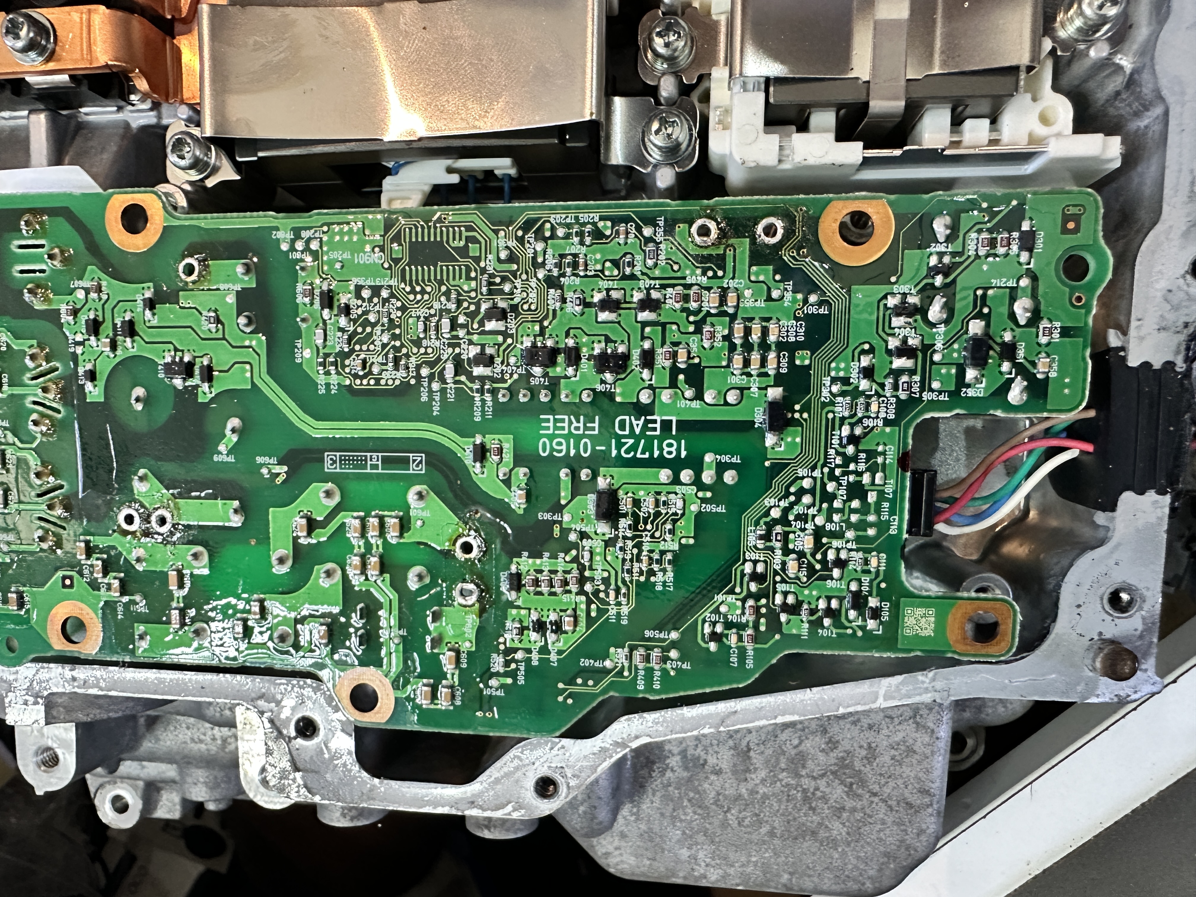

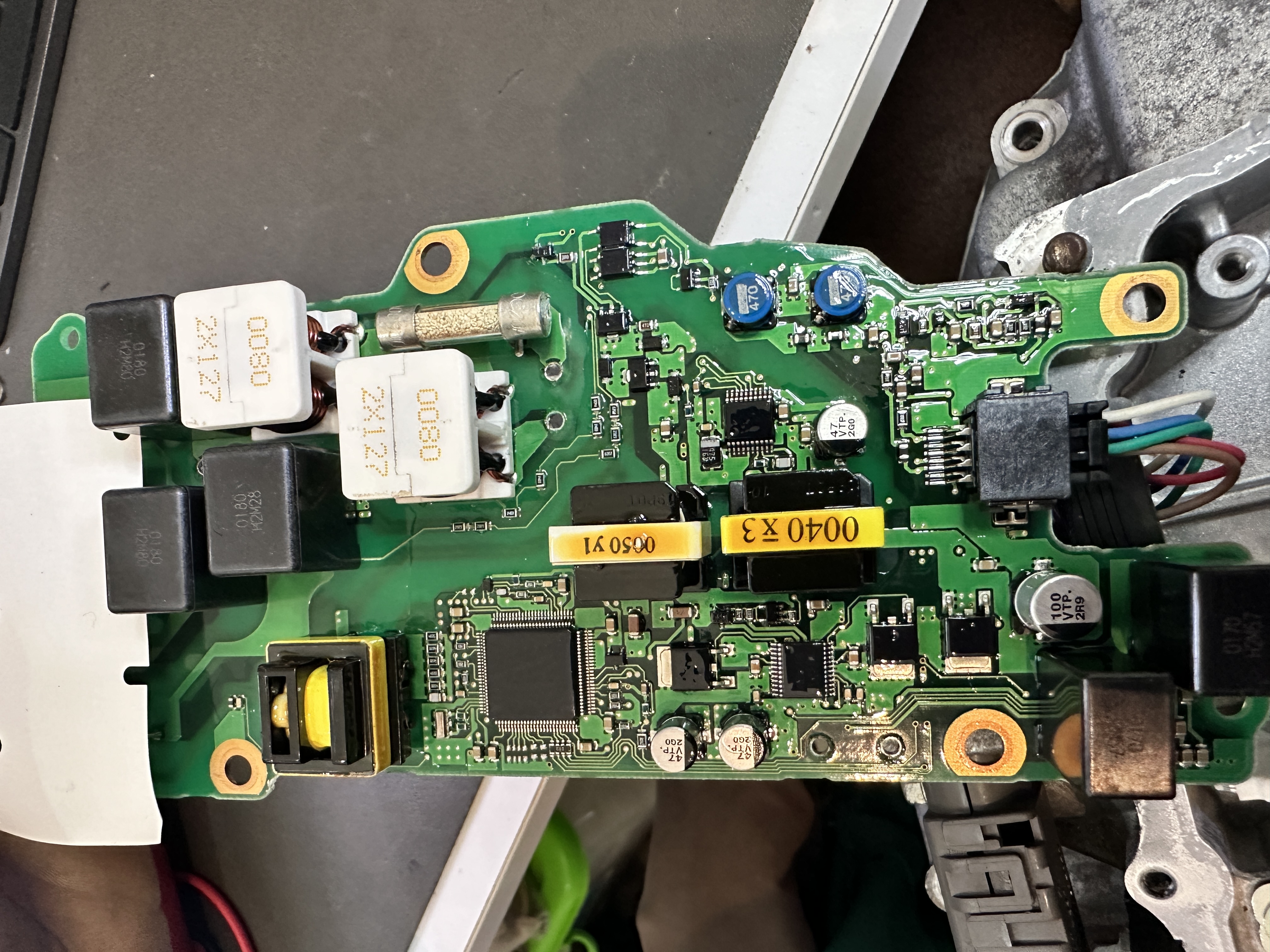

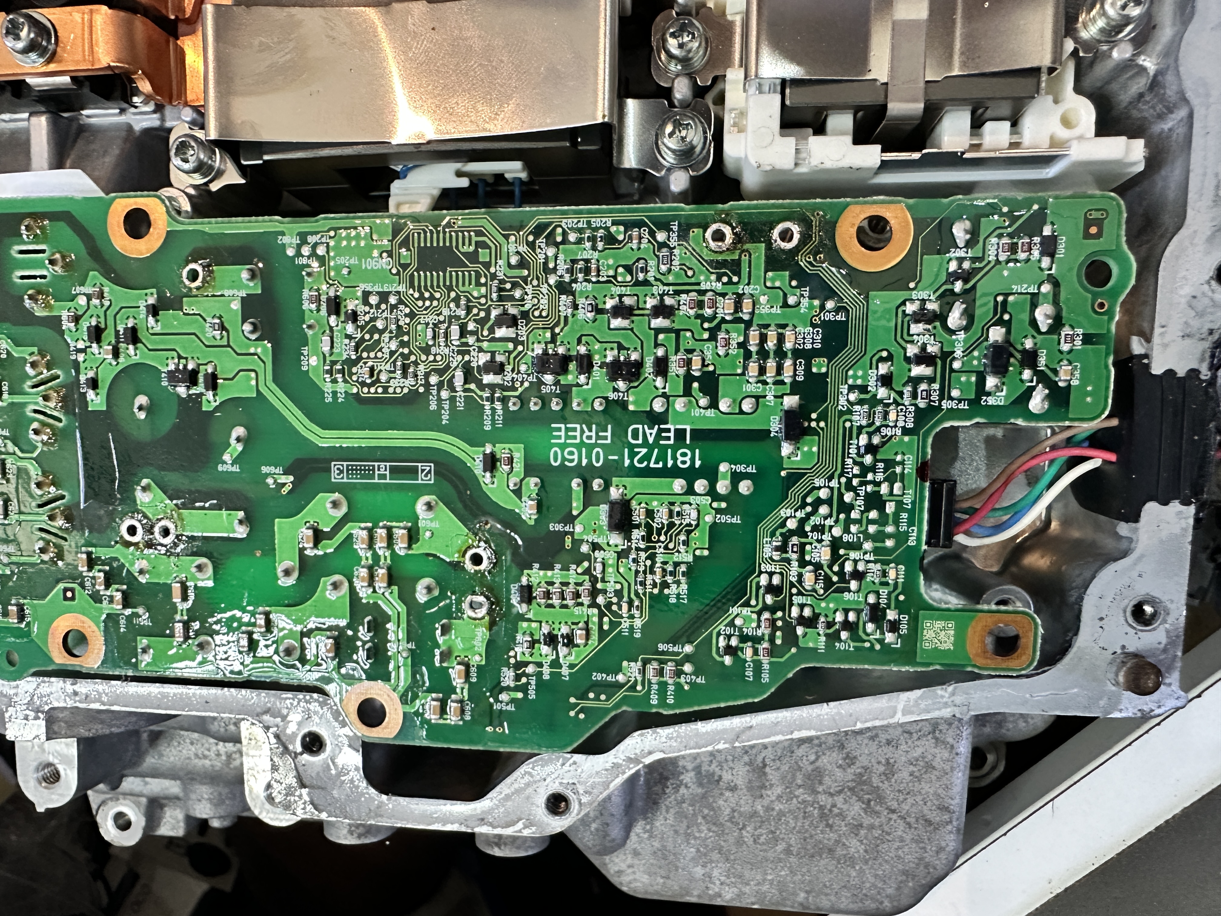

I managed to remove the DCDC converter motherboard from the G9200-33171 inverter
took a few pictures, thought i'd share the here
i know nothing about reverse engineering... but i think red and white should be pulled to +12V to enable it
